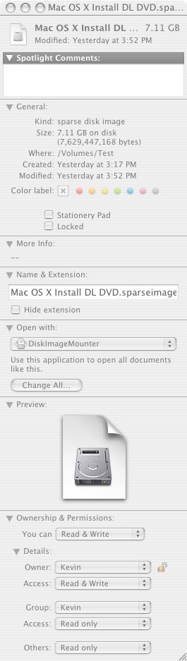

sorry but that didnt help me at all. i made an image of my disc, used terminal to geto the osinstall.pkg, hacked the code. now where im stuck is how to get the newosinstall into the image to burn.
SeVen it sounds like a permissions problem. With the image unmounted, highlight the spareimage and type :apple: + I. That will bring up the info for the image.
Now, expand the Ownership and Permissions section. There you will see different sections. The first one deals with the owner. It probably isn't you right now, so click the lock to the left of the owner box, you should have to authenticate.
Next, select your username and select read & write for the access. Close the box. You should now be able to edit the image. If that doesn't there may be a problem with the way the image was made. I will help you with making a new if that is the case. You can use the new .mpkg of course, so at least that will be done.
I am attaching a picture for reference.
