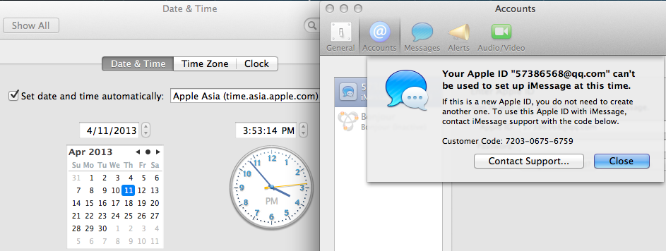

Still can't login iMessage
Thanks for reply.I'm in ShangHai(China)
last night till now ,less 12 hrs passed
Still can't log-in(try to Re-install many time)
Have you try log-out and re-login?
PS:remember backup your system HD to a dmg file, use it when if can't login again
Now iMessage working again
Because I try log-out iPhone's iMessage,and re-login, then .... MacBook and Hackintosh auto fix ^_^

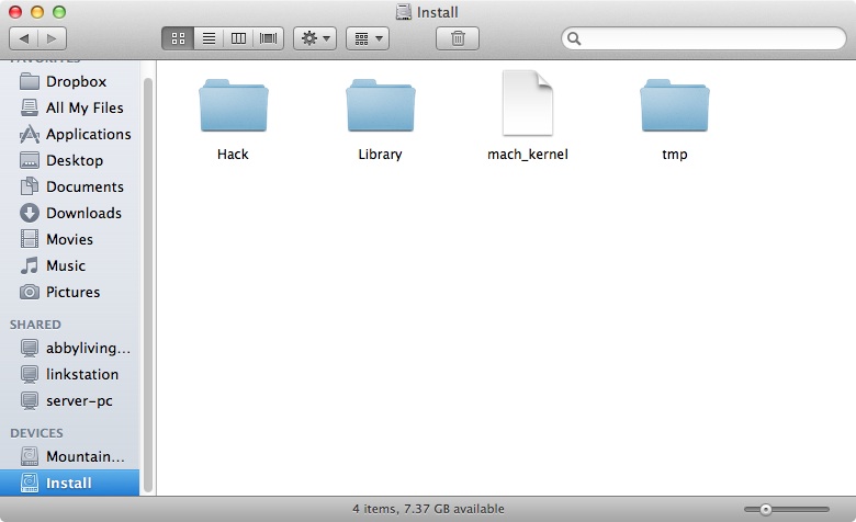

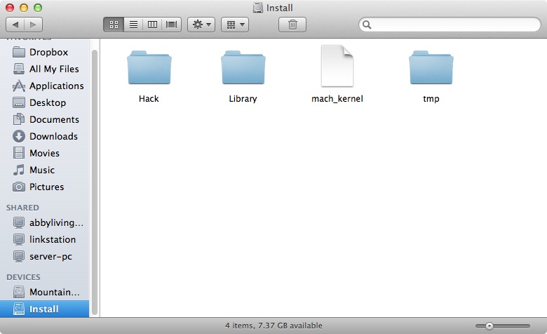

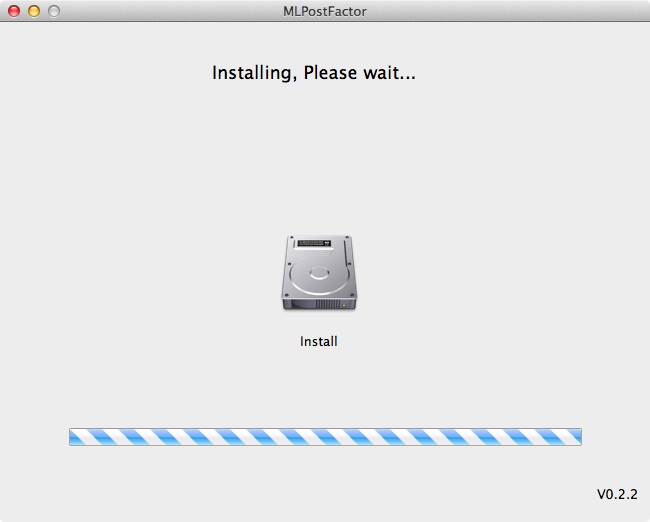

I am still having an issue. I deleted everything, and re downloaded Mountain Lion, and MLPostFactor. I have both files in my Application folder.
I have set up to drives, one INSTALL (8GB) and one MOUNTAIN LION (20GB).
I click on MLPostFactor from the application folder, and pick my INSTALL drive from the drop down list. It prompts me for a password and then runs, I then get a successful message.
When I look in my INSTALL drive I now see the following - HACK, LIBRARY, MACH_KERNAL, TMP.
I shutdown, and then restart holding the option key, and I only see my main drive and recovery drive.
I have Mountain Lion 10.8.3, and MLPostFactor 0.2.2.
Any help would be appreciated, and from reading I don't seem to be the only one having this issue.

You probably didnt format the USB as GUID partition table & Mac OS X Extended Journaled. MLPostFactor will restore the DMG for you.
Well, something isn't working right then. I did format the USB as GUID partition table and HFS+ Journaled as you can see below, but MLPostFactor won't restore the DMG. All I get there, and on an internal partition which I meanwhile created, are the files and folders derickjsmith mentioned in his post. I've attached a screenshot where you can see that as well.
I'm downloading MLPostFactor again and I will try again after deleting all the system preferences associated to it.
UPDATE: I've attached a screenshot of what I get on the USB drive now. Not even all the files I get on the internal partition.
Thanks again for all your work on this.

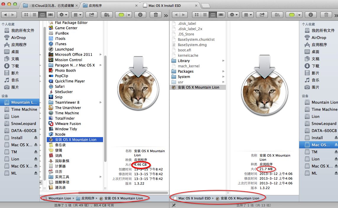

try recheck:
update :I see , Because You have same name Install partition name,Change the one of Built-in hard disk Install partition name , This Work
otherwise:
1、 4.XXGB Mountain Lion.app is REQUIRED to be in the Applications Folder.(ISO/DMG useless)
2、copy it (4.XXGB Mountain Lion.app)to your Applications folder.
3、Make sure system language is English(I'm a Taiwanese Chinese,When I first time in Chinese language mode,doesn't work.

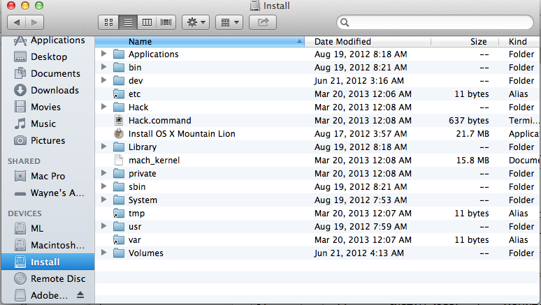

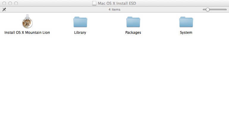

Thats not right at all. Many files should be copied into the partition. The 8GB partition would left less then 3GB
This is what it should look like
This is what it should look like Image

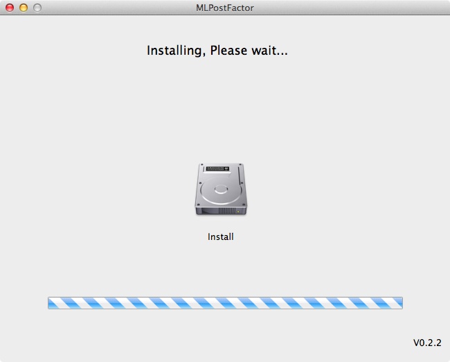

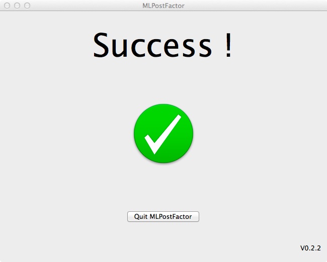

Then that is where the problem is, my MLPostFactor isn't coping the files over. I get no errors, here is what I see.
Thank you for the reply.

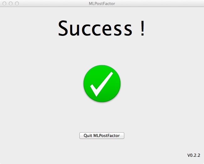

1. Use Disk Utility to format your 8GB Install partition as Mac OSX Extended Journaled.
2. The App "Install OS X Mountain Lion" must be 4.xx GB
3. If 1 and 2 is correct, you'll create a 8GB Installation Partition that is almost full.
4. Use Startup Disk App to reboot into Install partition.

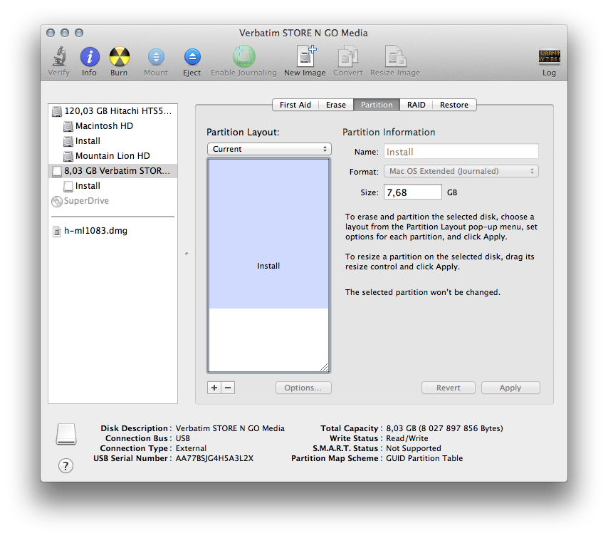

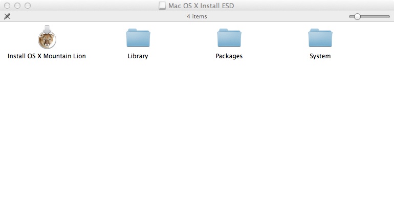

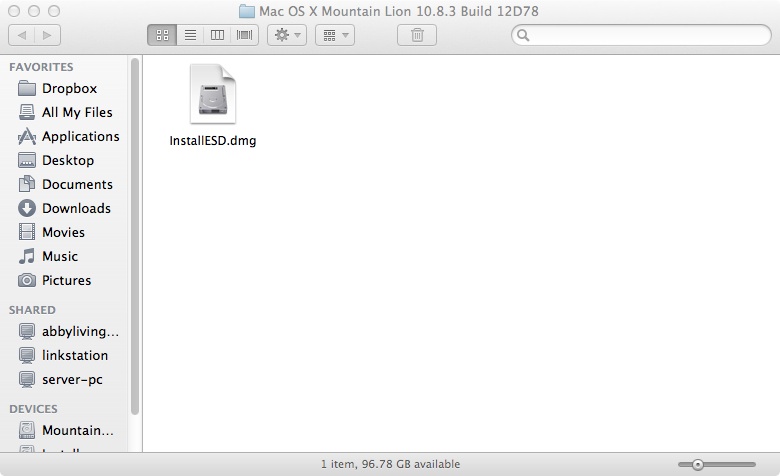

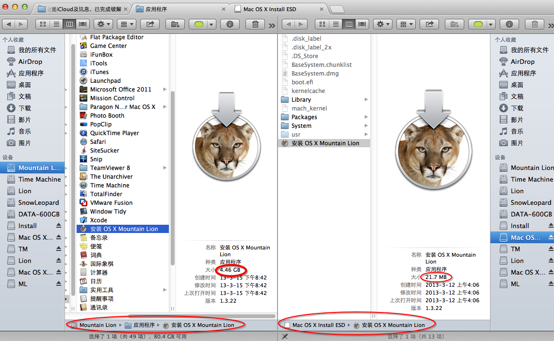

My format for the INSTALL (8GB) drive is Mac OS Extended (Journaled)
When I get info on my install OS X Mountain Lion from my application folder, it is only showing 24.1MB in size. (the dmg file that I downloaded is 4.44).

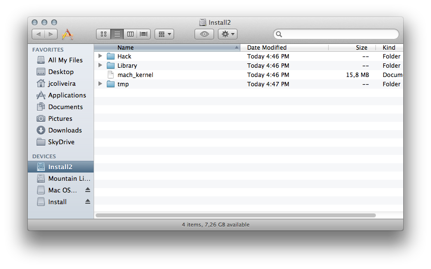

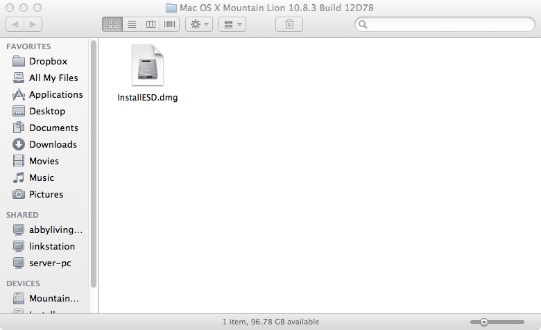

Inside my dmg I have Install OS X Mountain lion app, Library, Packages, System FOLDERS.
I don't think all the files from my install DMG are being copied over to my Application folder, just the app is.
Seems you copy a wrong file , look below picture:
