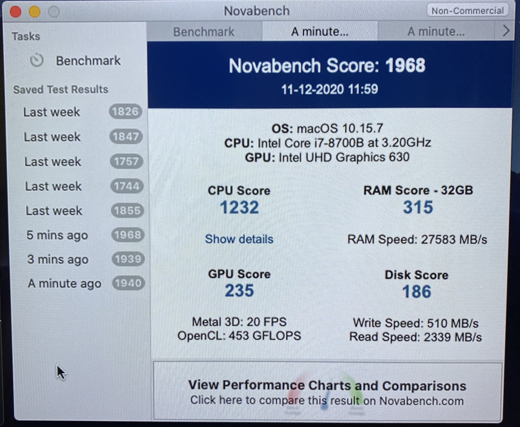

I went with Corsair Vengeance CMSX32GX4M2A2666C18 2X16GB and it’s working great for me.
System definitely feels more responsive, and judging by benchmarks, tests - it gained around 15-20% performance in adittion to having more ram itself.
I was concerned a bit that CL18 ram would have some stability issues, however, after initial stress tests it seems to be working fine.

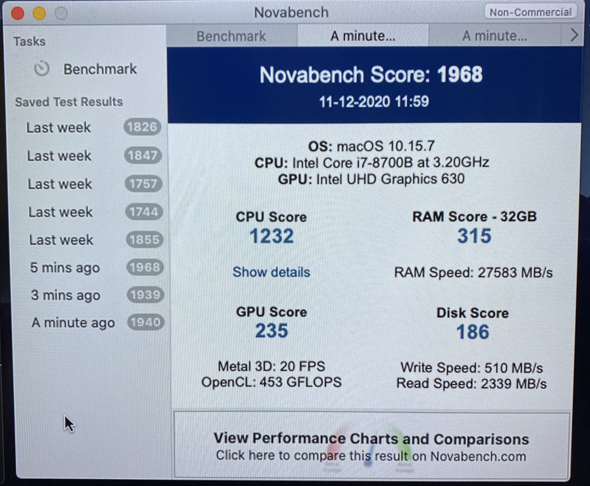

Is it possible to compare Novabench scores with you and some other users as well? I would like to know how different brands of ram / timings impact the performance. Specifically interested in RAM speed and OpenCL GFLOPS.
This is Corsair Vengeance CL18 kit tested on 10.15.7 (Working great and no stability issues encountered):
