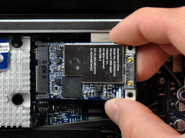

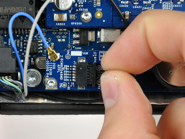

I have a 24" Early 2008 iMac that was pretty awesome in 2008, but less so now. I'm planning on replacing the hard drive with a nice new Samsung SSD soon. I figure that if I was going to go through all the trouble of taking the computer apart, I might as well update to bluetooth 4.0 while I'm at it.
I know I need a new card because my Computer doesn't support the direct wifi technology that Airdrop/Handoff requires (not even the old AirDrop will work)
After looking around I realized that the 2008 iMac actually appears to have 2 cards: One for wifi that uses PCI and another for bluetooth with a separate connector. NOTE: this information is from ifixit for the 20" iMac, because the 24" doesn't have any info on wireless cards.
GlBCKwNRnYiZBVbJ.medium
F6VYKfqVJ4a3YRXg.medium
My actual question:
I know I need an adapter to covert the new Broadcom card's mini-PCIe to the iMacs PCIe slot. I plan on using this adapter with this card. But what do I do about the current Bluetooth card? Just ignore it? If I plug the antenna attached to the current Bluetooth card into the new card, with the iMac just magically switch to using the Bluetooth off the new card? Do I need to change anything (drivers/kexts?) to get the new card to work?
Has anyone done this upgrade on a 2007/2008 iMac that can share any information on what adapter they used and how it works?
