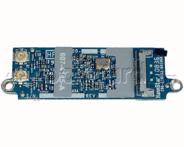

suposedly mid 2009 MBP are also upgradable (referring to first post)
but I don't understand how that should be done?
I compared the pictures of 2009's bluetooth chip with BCM94331PCIEBT4CAX
2009's card's got 2 cables - the BCM94331PCIEBT4CAX got 4 … is this going to work?
2009's card's got 2 cable - the BCM94331PCIEBT4CAX … is this going to work?
That doesn't look like the same connector or antenna arrangement so I wouldn't suggest it unless someone shows me directly that they have that working.
