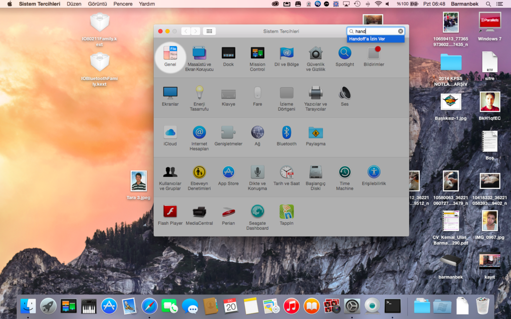

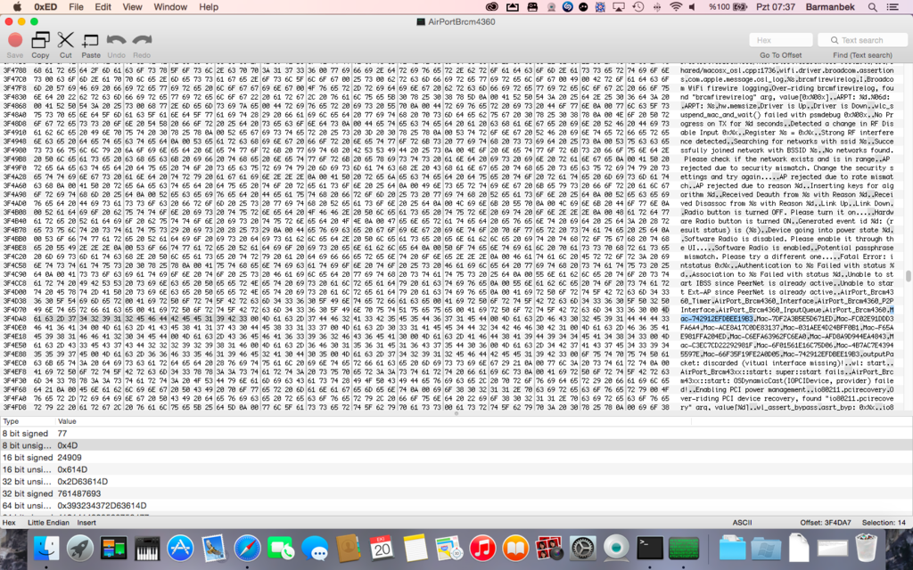

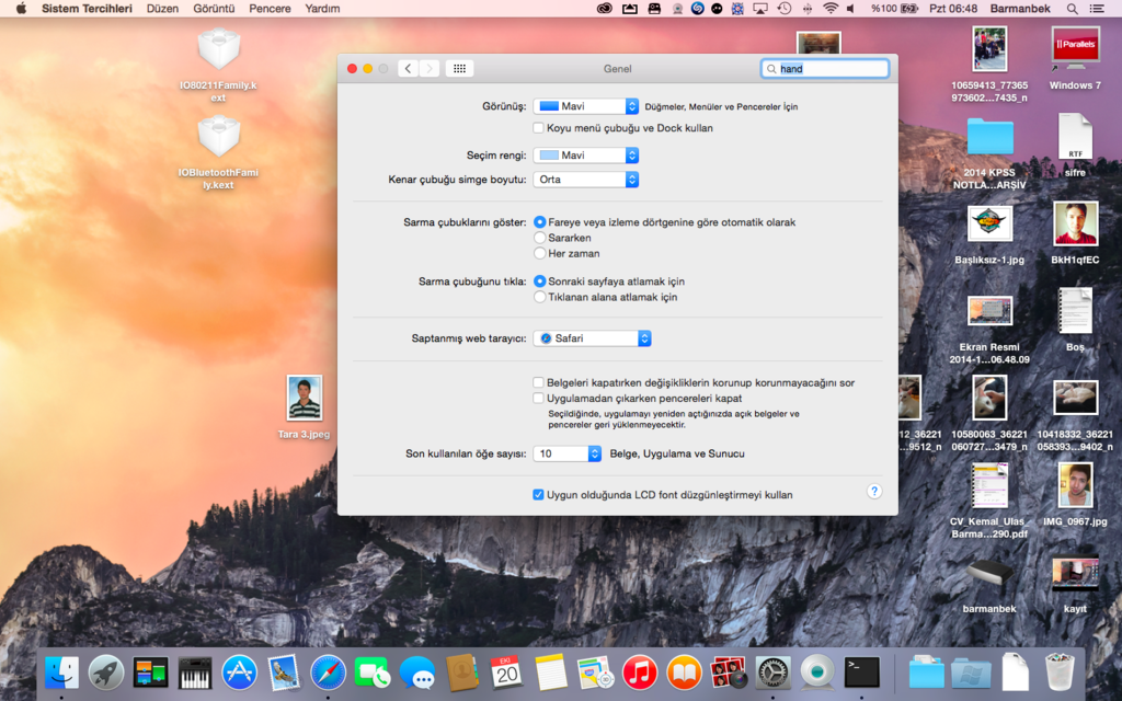

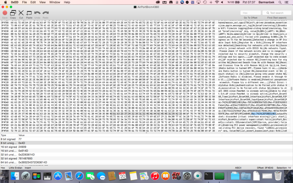

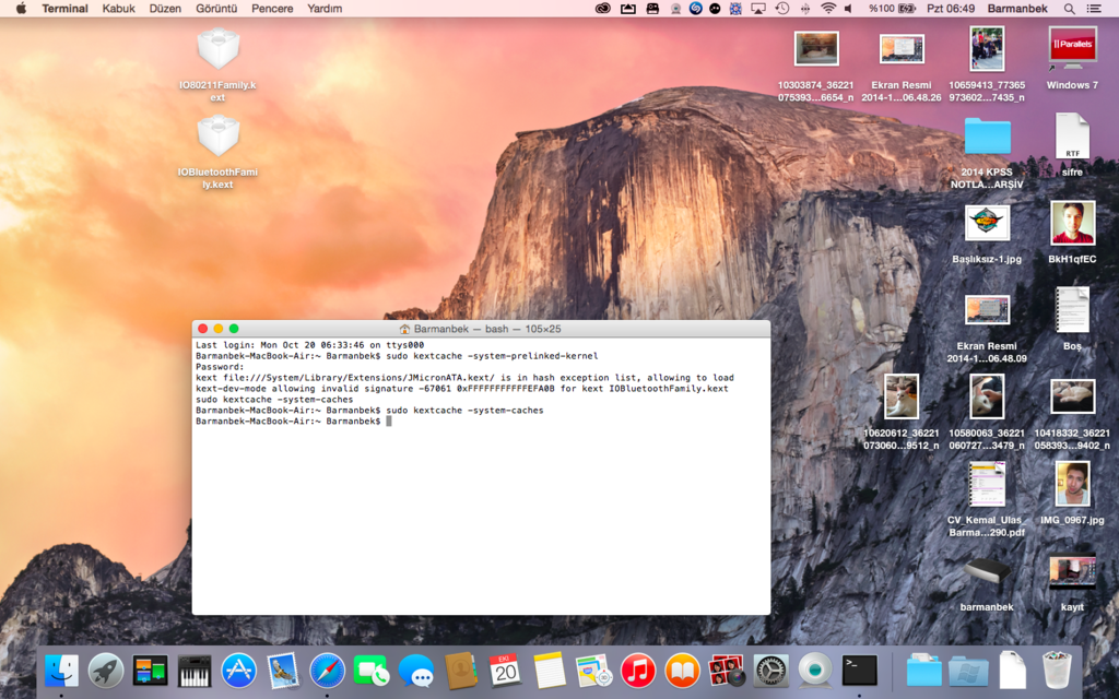

Hello,I'm living in Turkey. I apologize for my bad english.
I am a user in mid 2011 MBA. I did everything written here. But I have a problem. "Go to > System Preferences> General, click ENABLE handoff at the bottom." No handoff in section! but when I typed in the search box handoff option turns out, I will set the general tab leads. What is the problem? To help you better pictures as you've installed. pleas help me
Judging by the last screen shot the IO80211Family kext was not done correctly. Something went wrong.

Greetings from Turkey!
First of all, many thanks to UncleSchnitty for the excellent work here.
I have followed the instructions several times without success.
Finally I deleted two original kext files from /System/Library/Extensions/ folder (after a safe back up for sure!) before dropping the modified ones as suggested by vobb.
Now handoff is working smoothly on my mid 2011 MBA.
Deleting original kext files should go between steps 6 & 7.
When proceed with step 7, you will receive several error messages which reads kext files (with regard to bluetooth) cannot be found, do not worry!
After rebooting bluetooth will not function, if you check system report, you will see there is no bluetooth device is present. In this case, that's exactly what we need.
Follow the remaining steps, then voila! bluetooth will be back and you will have "three yes" for bluetooth function in system information: LE, handoff support & instant hotspot support.
For steps 11 & 19
If you are having difficulties with the desktop path in your local language; you can simply right click on kext files, choose "show package contents" and follow the path as stated in the tutorial to find out the file which needs to be modified.
Last but not least; command on step 7 should be as previous, i.e. without "ran" (as it is causing "command not found" error.)
