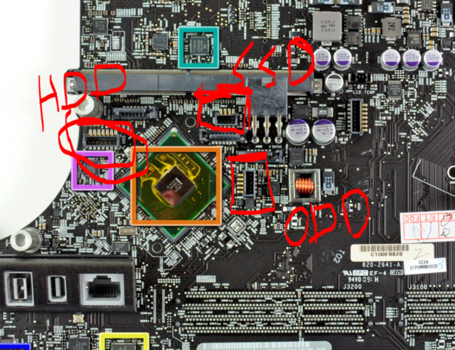

Has anyone succeeded installing the sata cable to ssd-sata port on logic board, without removing the logic board on 2011 27" iMac?
I thought about buying 90 degree "left angle" SATA-cable, and have a try, if it's not impossible. Power from HDD with SATA-power splitter.

I didn't take out the whole board but you need to take the screws out so you can lift the board.With some patience you can get the data cable in the right place.

I have not done it, but I have read everything on this and other forums regarding ssd installation on imac mid 2011 21.5 . The cable you show is for 27 inch only, not good for 21.5.
You need:
* ssd data cable, which is a standard sata data cable
* ssd power cable which is non standard. Part number is 922-9862 and the only place I found that sells it is http://www.welovemacs.com/9229862.html and here http://www.ebay.com.au/itm/iMac-21-...ple_Desktops&hash=item2566344bb1#ht_582wt_922
.You can also try to make one yourself, see here https://forums.macrumors.com/threads/1159154/ post #141
*Some velcro or adhesive tape to secure the ssd to the imac chassis.
The only place that has imac 2011 21.5 teardown instructions is ifixit http://www.ifixit.com/Teardown/iMac-Intel-21-5-Inch-EMC-2428-Teardown/5485/1
You surely have to lift the logicboard a little, as the sata data and power ports are on the back side of the logicboard as you can see here http://i419.photobucket.com/albums/pp280/dschlessman/6ce6eef9.png
I don't know if you have to remove the logicboard completely.
You have to put the ssd behind the optical drive. There is enough space there.
As I said before, I have not done it but I am pretty sure this is all the information that is available for mid 2011 21.5 ssd installation, all in one place.
If you do decide to do it, don't forget to document everything with fotos and video and post here your experience.

According to the ifixit teardown and some other guy I read on macrumors who opened up his own mid 2011 21.5 iMac, the ssd Sata port on the motherboard is like the one shown here http://i419.photobucket.com/albums/pp280/dschlessman/6ce6eef9.png , that is it is actually two separate connectors, one for the ssd power and one for the ssd data.
Now, the data connector is a standard Satan cable connector, but the power one needs the special cable I refer to above.
That is what I have read, I haven't opened my 21.5 mid 2011 iMac to check it but I have no reason to doubt it. Please do it and let us know. As I said above there are no other differences, just a different cable.
