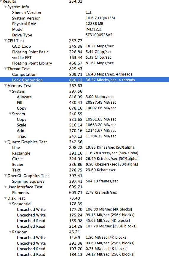

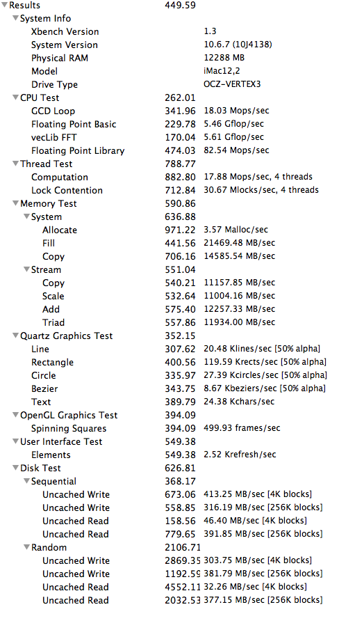

Hey. Just wanted to let you know that I made it!!
I installed the SSD in addition to the stock 3.5" in my 27" 2011 iMac.
Even though after 2 hours of sweating everything seems to work flawless I would NEVER recommend to somebody doing it.
During the works I felt like "OH **** WHYYYY????". I had some difficulties to get the Mainboard out. Getting it in was not the biggest issue but having the cables in order was quite tricky. In fact now my Data cable for the SSD is positioned quite ****** so that the screen almost did not close perfectly. It seems like I lost 1 tenth of a millimeter because the glass does not close 100%. Nobody would even notice but again it is maybe 1 tenth of a milimeter in the middle of the top of the screen. I just hope there is no "Force" pushing the screen too much from he inside to the outside (if you understand what I mean).
Besides that, XBENCH is telling me with my cloned SSD:
3.5" Overall Score: 254
SSD Overall Score: 4626
Disk Test on the SSD: 626 (HDD: 73)
Sequential: 368 (HDD: 178)
Random: 2106 (HDD: 46 !!!!)
I will do a geekbench later today and submit results. Unfortunately I just formatted the 3.5" ;((
System Profiles by the way tells me I am connected 6GB/s.
Furthermore: The HDD is now spinning down when not in use. That is quite nice because it makes the iMac then almost 100% quiet.
I attached both Xbench reports (SDD vs. HDD) from my 2011 27" 3.1Ghz i5 with 12GB RAM.
HDD: 3.5 1TB vs Vertex3 240GB
