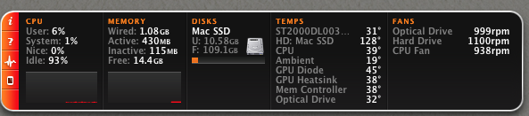

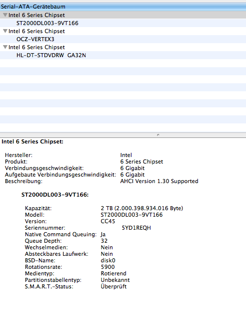

My Config
1. Vertex 3 / 120 GB
2. Seagate Baracuda LP / 2TB
No Fan Issue:D

Nice... I'm planning to add an SSD once my current 2011 iMac is replaced (yellow display).
BTW, why is your SSD temp showing 128 Deg? Is it normal?
Yes, it shows, but the vertex is cold. Either the vertex shows the wrong or the widget has a problem with it and it is related to the Y-cable. Anyway, I have no failures due to overheating.
What I forgot:
The AHT test was also passed.

However I have come across a small problem. My HDD sensor is showing a temperature of 3 degrees. Obviously this is wrong and I imagine it has something to do with the power splitter.
However the SMART temperatures are also being reported. The SSD is wrong and is showing 128 degrees however I am not bothered about that as the SSD is cold to the touch and is obviously a software glitch.
The more serious problem is the 1TB HDD still in the system. It's showing a temperature of 52 degrees which I feel is pretty high. As the HDD temperature sensor is showing only 3 degrees the fan speed is not increasing. Without increased air flow the temperature is only going to keep rising.
I have paid for and installed HDD Fan Control like suggested in this thread however it sets the fan at full speed because it's reading the 128 degree temperature from the SSD.
I tried installing SMC Fan Control and this seems to be working in raising the fan speed slightly however the temperature doesn't seem to be dropping. I also use Bootcamp regularly and during this the HDD fan won't be getting regulated.
My questions are is there any way to solve this issue and secondly what is a normal HDD temperature range?

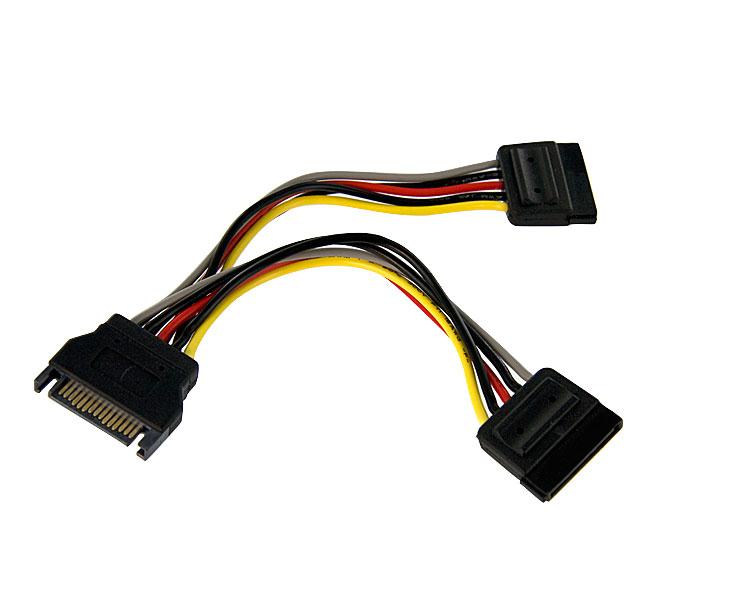

Links to cables, please
I could have missed it, but I've read this whole thread and I don't see any links to the SSD Y-splitter power cable or info on what length SATA cable (right angle to straight).
I prefer buying my cables from monoprice, and the 'original Apple part' that another how-to linked to seemed over priced for something that's not going to have the correct fan controller jumpers anyway.
Can any old sata power Y-splitter work? What length? I've bought my Torx screwdriver kit and suction cups and SSD (haven't bought the iMac yet but soon) and just need the correct cables.
Input/help/links appreciated!

The y-splitter is a very generic SATA Power Splitter like this one:
As for the SATA data cable, I personally added a cable with a 90 degree connector at one end and straight at the other like this one:
Thanks for that. I just bought two cables like that from monoprice. $1.50 and $3 I think, plus shipping. I was a bit worried about what lengths, but seems 18" was about the max they sell so went with that.
