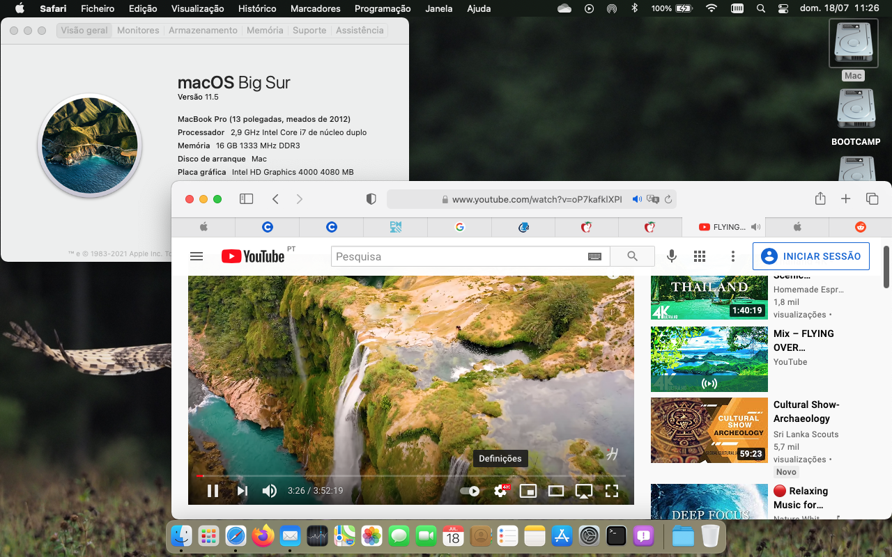

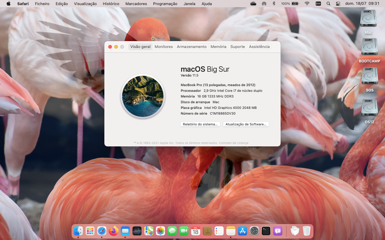

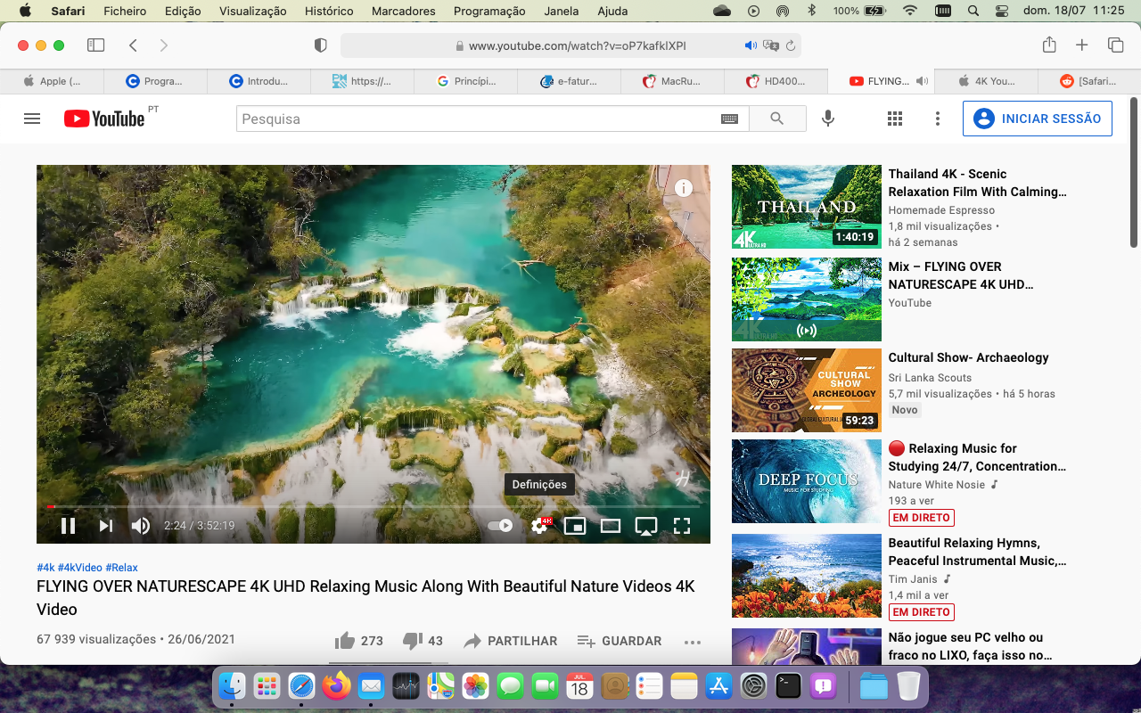

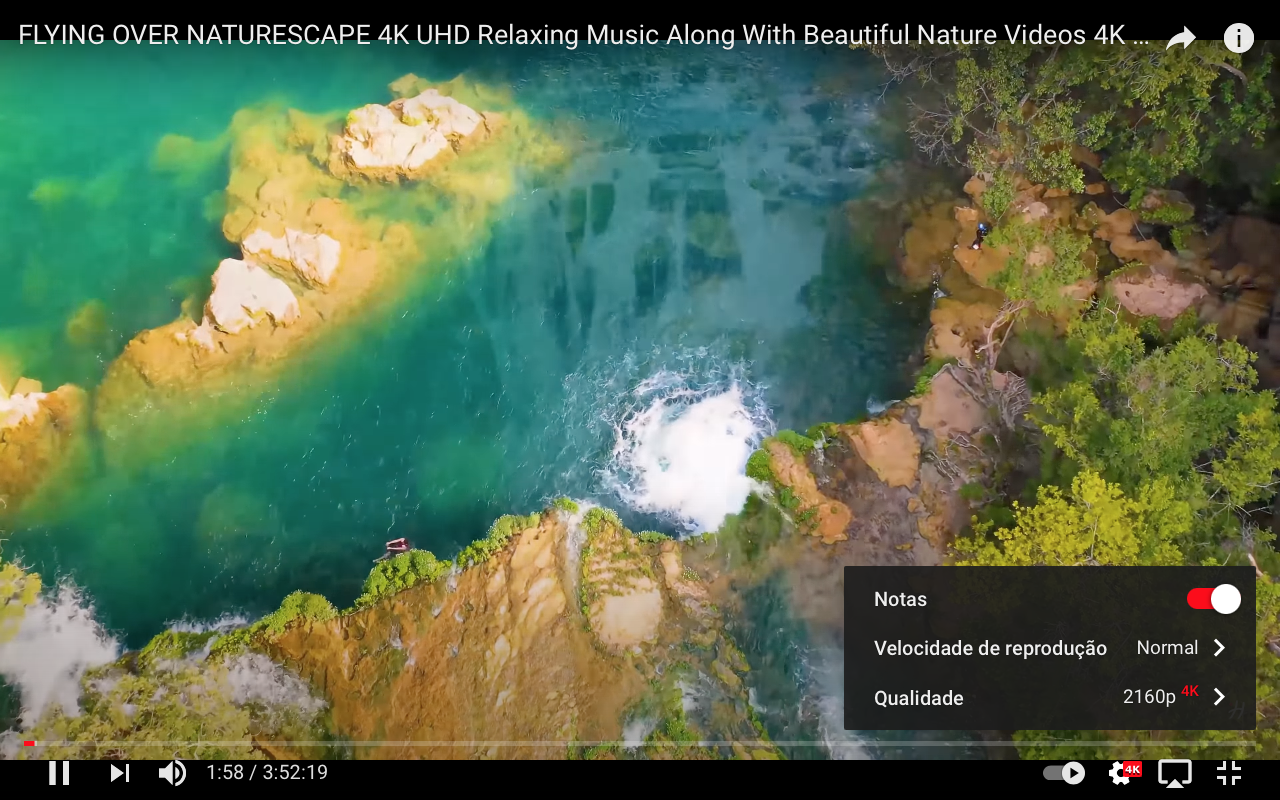

Thanks @jackluke with 4GB playing 4K video in YouTube on Safary

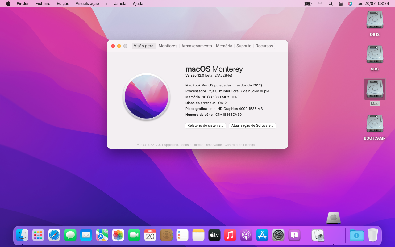

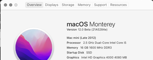

It does not show any error message , even I've make it on BS11.5 that works on Monterey does not show up VRAM memory. I am now reinstalling Monterey with OCLP 0.2.4 and see if it works
Tested and works

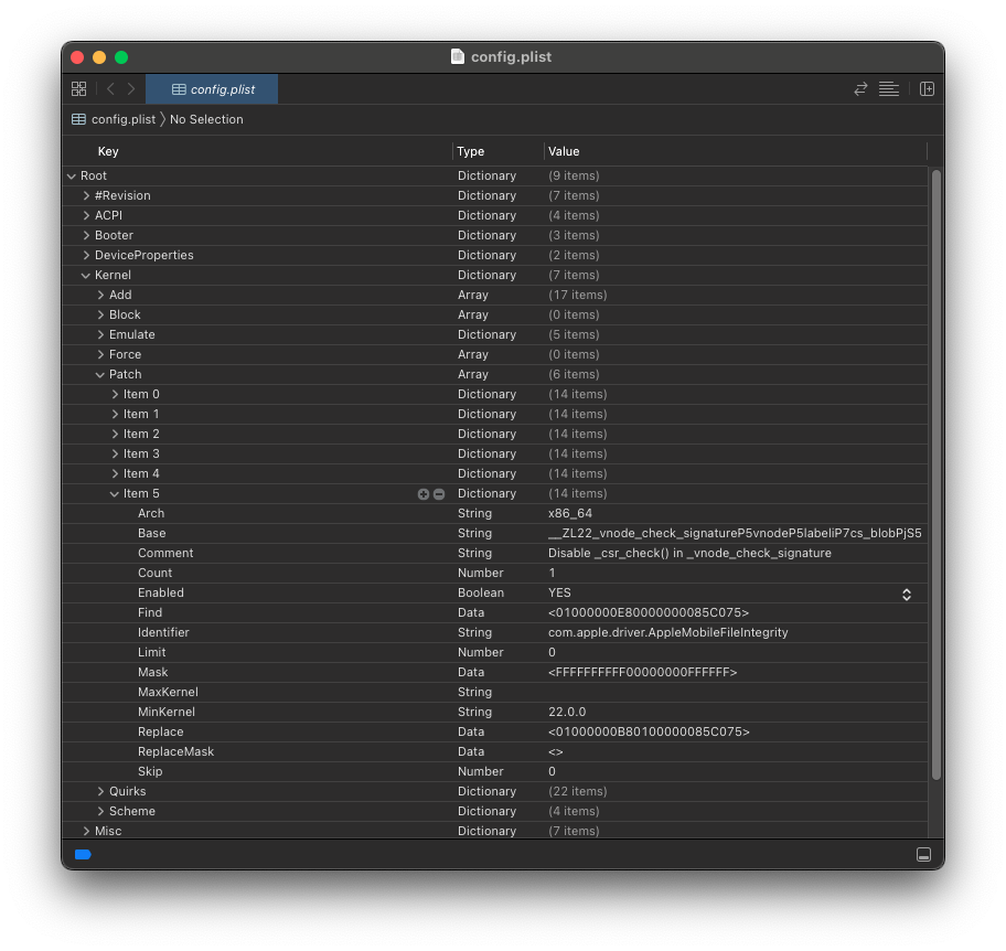

Okay, I understand better. I thought you were talking about the config.plist that is in the OCLP source folder, but you are thinking of the config.plist of the EFI OC folder.
I guess you're thinking of a patch in the style of item 5 of this window.
Reactions: deeveedee
@sinbad21 Yes. I did a quick search of the AppleIntelFramebufferCapri binary and found multiple instances of the "Find" hex sequence, so you will want to specify Count = 0 in the kernel patch (allow the patch to revise all instances of the hex sequence). This is different from Count = 1 in the example you cited.
Reactions: sinbad21

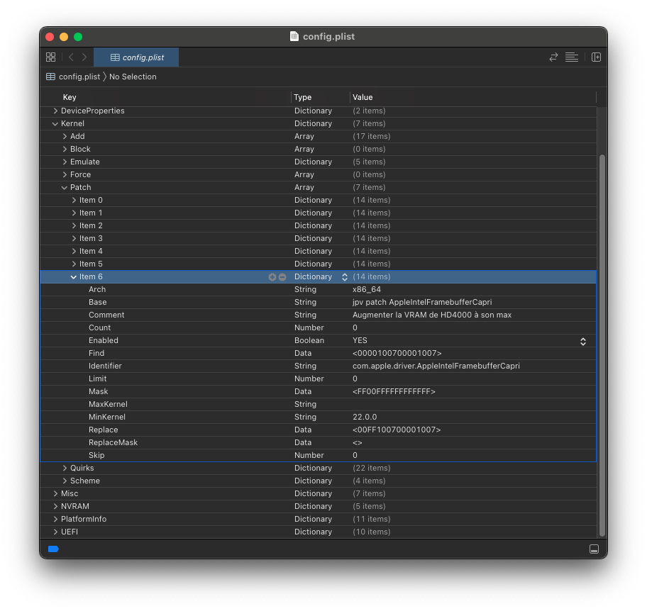

Something like that:
