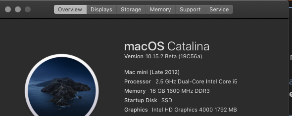

Thought I ask you to know what the X.. setting is for 1792MB, found out myself, it's x70, works great on a 2012 Mac Mini.
As in
cd /S*/L*/Ext*/AppleIntelFramebufferCapri.kext/C*/M*
sudo cp AppleIntelFramebufferCapri AppleIntelFramebufferCapri.backup
sudo perl -pi -e 's|\x00.{1}\x10\x07\x00\x00\x10\x07|\x00\x70\x10\x07\x00\x00\x10\x07|g' AppleIntelFramebufferCapri
sudo chmod -R 755 /S*/L*/E*
sudo chown -R 0:0 /S*/L*/E*
sudo kextcache -i /
sudo reboot

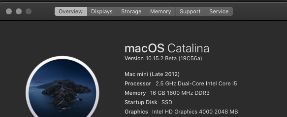

It amazes me how smooth my Mac Mini is right now, went from the default 1536 MB to 1792, scrolling is almost buttery smooth, going from a space to the other one as well.
I, in the beginning thought it was an illusion but after a few hours of sitting behind my Mac I know for sure it made a huge difference.
Another Edit, have 2048 MB now

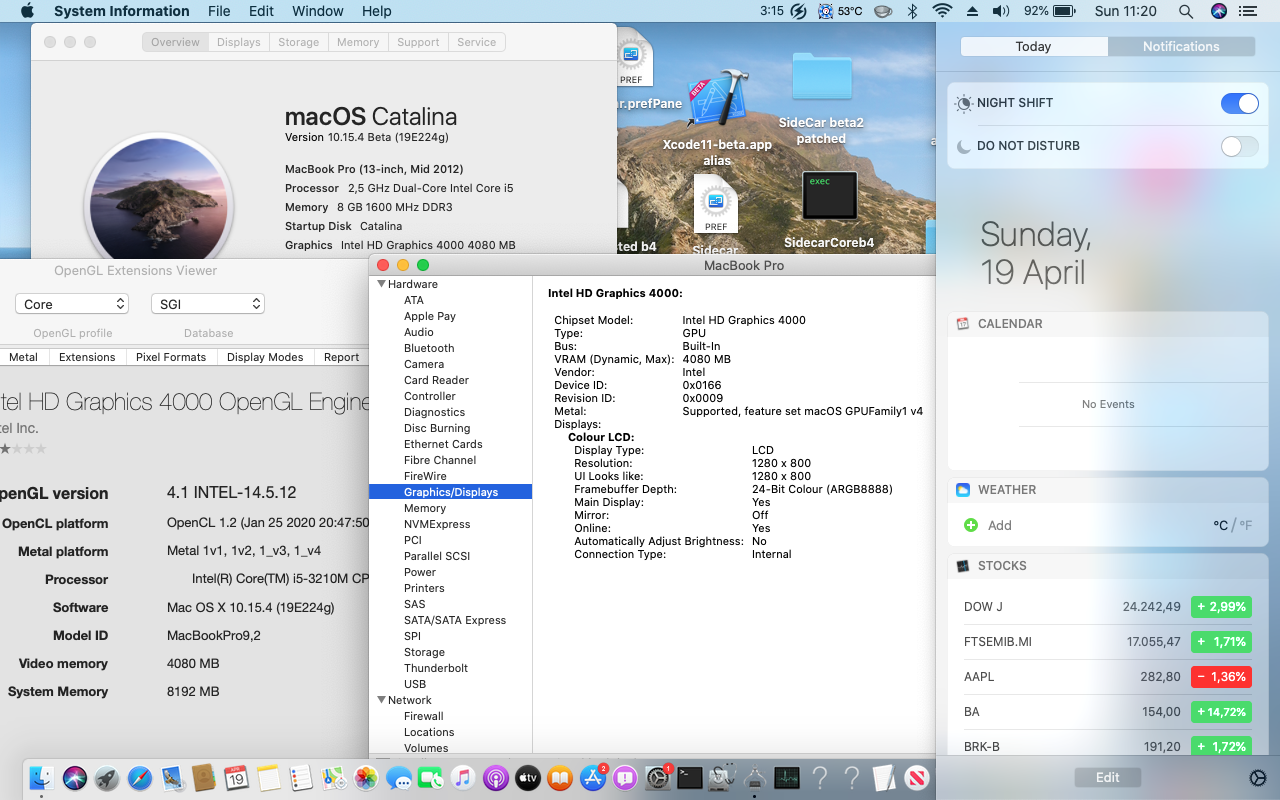

Considering that using hex values:
10 = 256MB of RAM
18 = 384MB of RAM
20 = 512MB of RAM
30 = 768MB of RAM
40 = 1024MB of RAM
80 = 2048MB of RAM
then
FF ≈ 4 GB of RAM
sudo perl -pi -e 's|\x00.{1}\x10\x07\x00\x00\x10\x07|\x00\xFF\x10\x07\x00\x00\x10\x07|g' AppleIntelFramebufferCapri

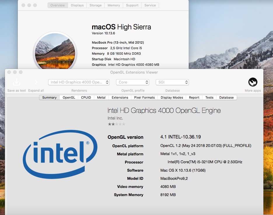

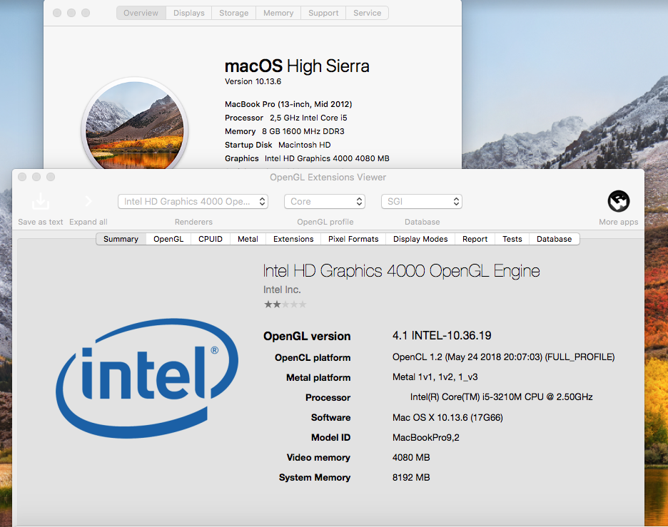

Before doing this you need at least 8 GB RAM, open a terminal and copy/paste:
Code:
cd /System/Library/Extensions/AppleIntelFramebufferCapri.kext/Contents/MacOS
sudo chmod -R 755 /S*/L*/E* && sudo chown -R 0:0 /S*/L*/E*
sudo kextcache -i /
sudo reboot
After reboot you should have 4 GB VideoRAM.
Reactions: avz and FlorisVN

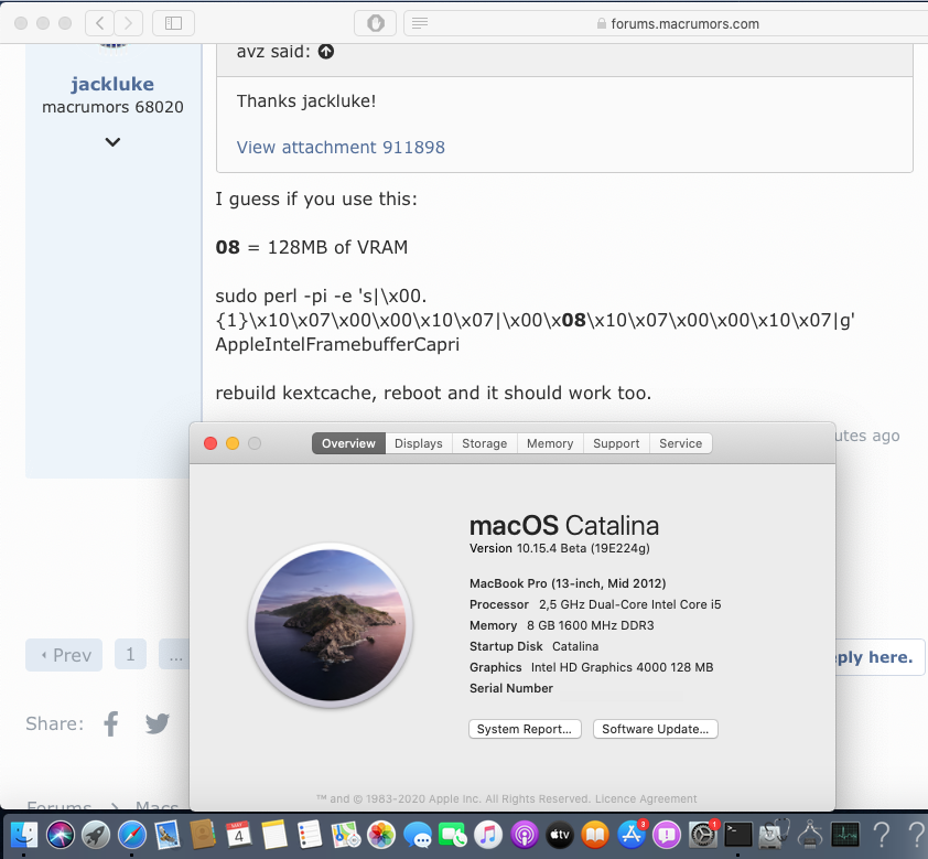

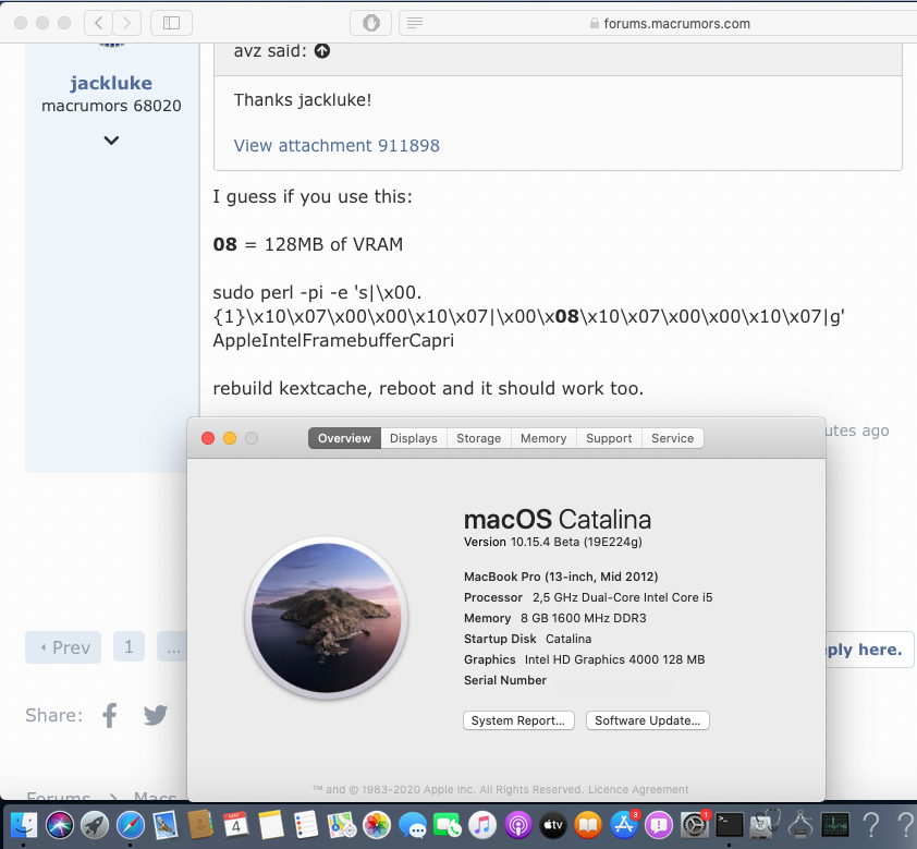

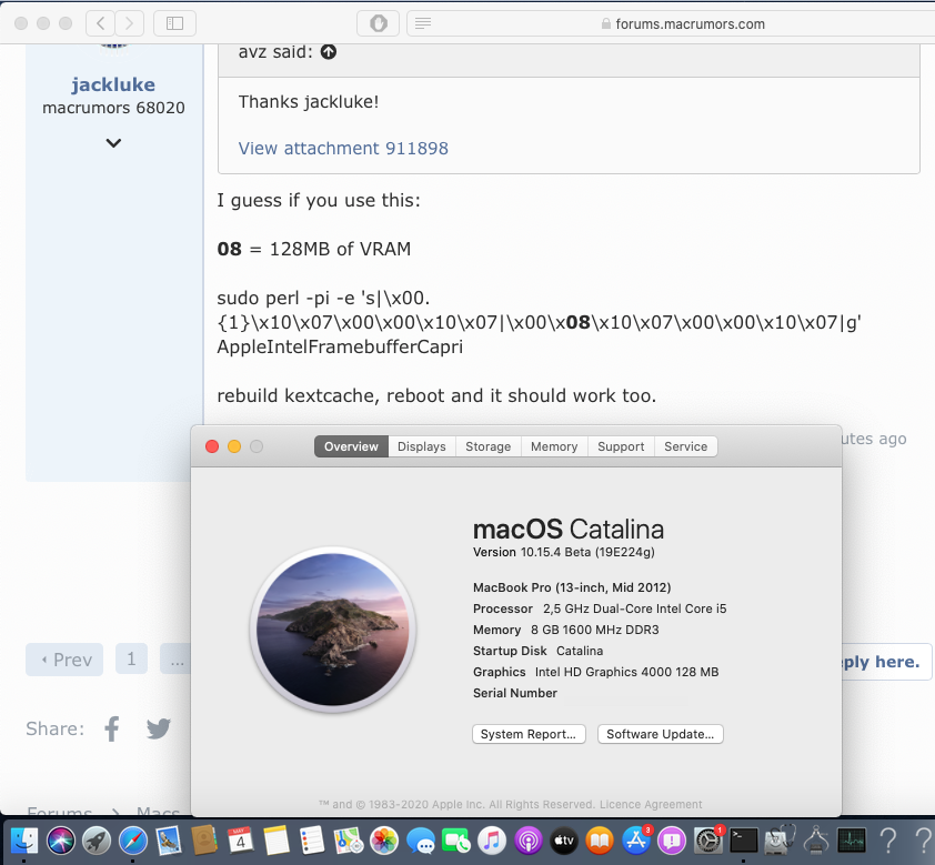

The IntelHD4000 VRAM size is also customizable for example to get 144 MB VRAM = 01 + 08 = 09
The minimum VRAM value that allows to boot Catalina is 128 MB .
Reactions: avz

Does anyone know how to increase even more. I want my 4GB VRAM to try to run some games.
This may lead to system instability - I think 2048 or 2GB is the real max.
