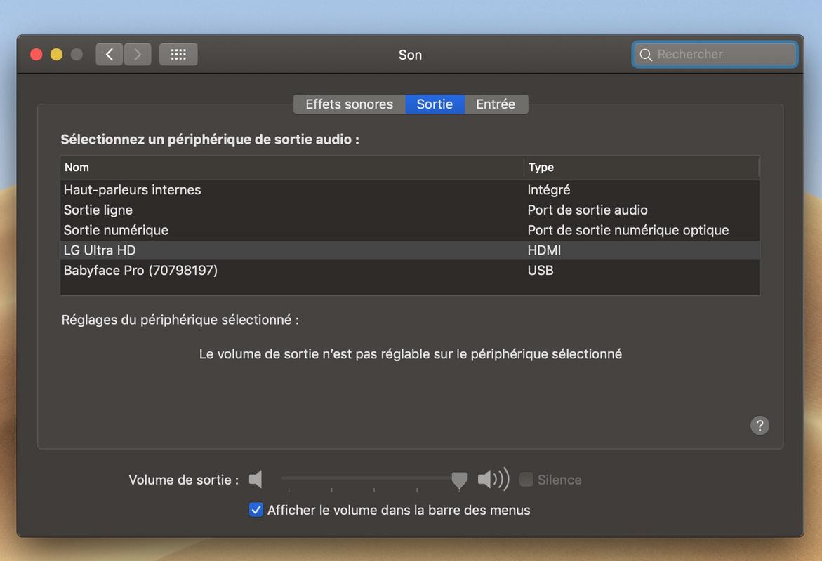

My only problem is not volume control from my keyboard at the moment now......I read about installing SoundFlower, any better options before I try that?
https://staticz.com/soundcontrol/

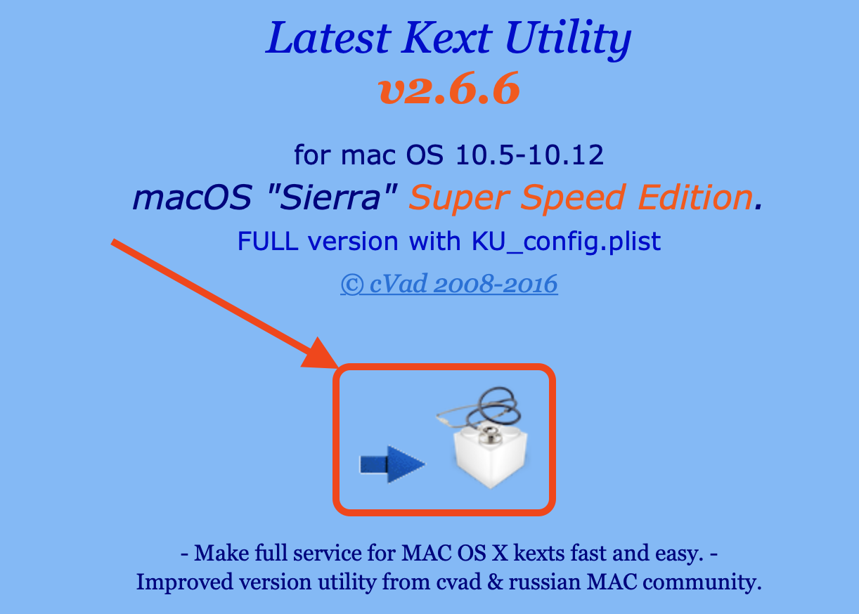

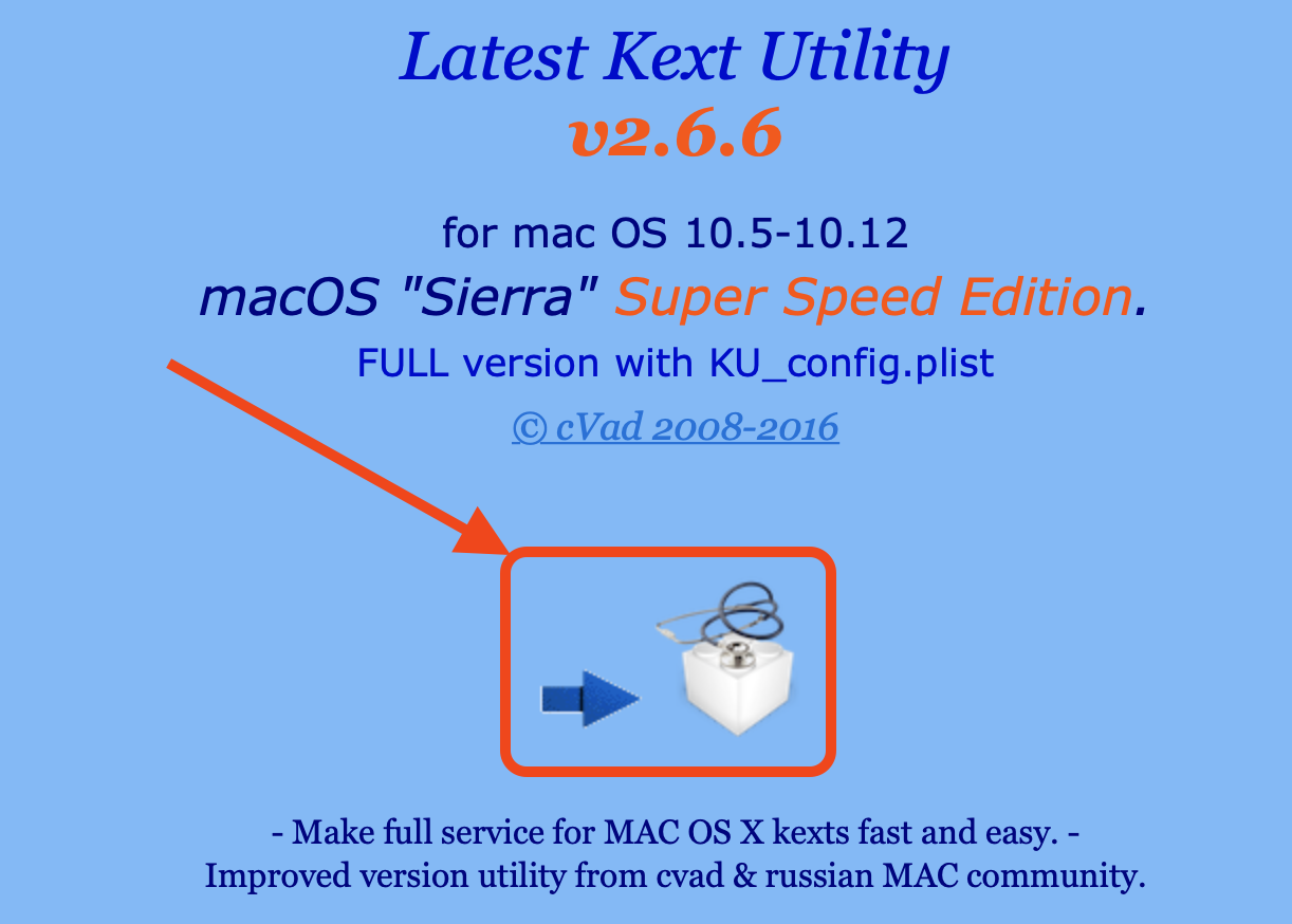

This link now goes to fake links and improper content. (Download KextUtility V2.6.6 (Link)
Is it possible to obtain it elsewhere?
Thank you.
