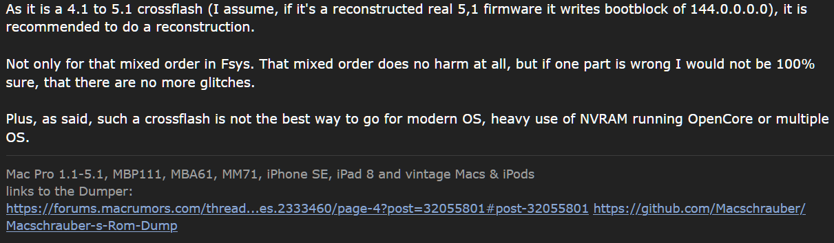

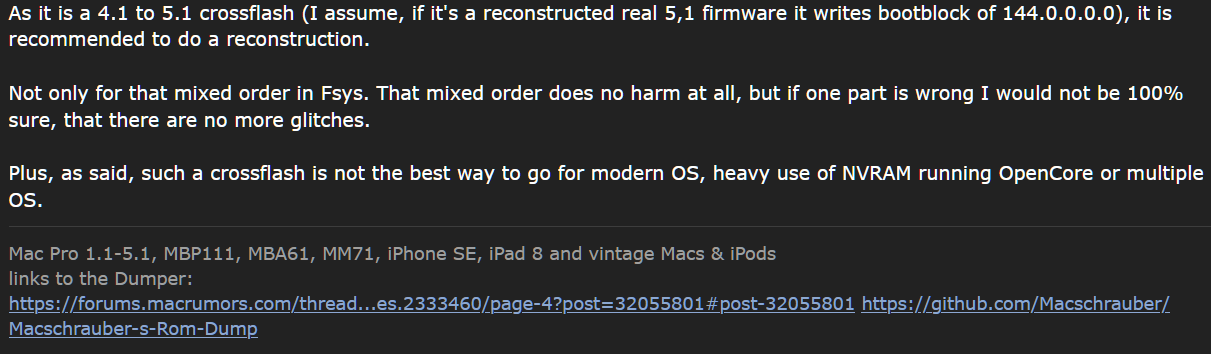

I read post #178,
You mentioned something about heavy use of the NVRAM running Opencore or Multiple OS.
I'm running both, multiple OS's and OpenCore.
Please forgive me it was not firmware related.

I read post #178,
This is a general data point, the more variables are in the NVRAM, the more often Garbage Collection runs.
Using multiple OS will fill the NVRAM more, a more populated NVRAM will do Garbage Collection more often than running a single, even supported, OS.
I refer to crossflashes, from 4,1 to 5,1 with the Netkas script / method. They tend to suffer more from NVRAM damage. More GC, more risk, GC could fail.
This is the logic behind that.
If you have a bootscreen capable GPU (EnableGop or EFI doesnt matter) and you are concerned about filling the NVRAM with a lot of variables, just do a deep NVRAM Reset (hold cmd-alt-p-r continuously until it chimes 3 times) before changing OS.
You will need to re-select OpenCore as initial bootloader, after a deep NVRAM reset, so the bootscreen helps a lot.
There is no general need for that, but it will keep the amount of Garbage Collections as low as possible.
Here is the post, showing what NVRAM Garbage Collection is: https://forums.macrumors.com/posts/32100306/

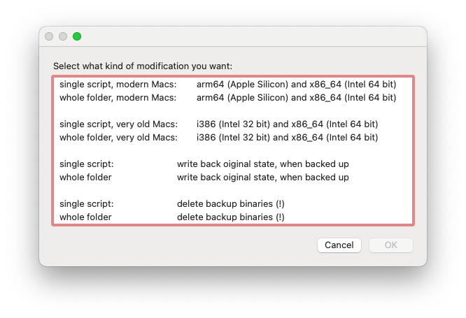

Changelog for version 13-9-2025​
All Apps:​
changed AppleScript binaries to Intel 64 bit + ARM, so the tools are faster on Silicon machines.

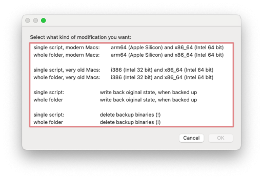

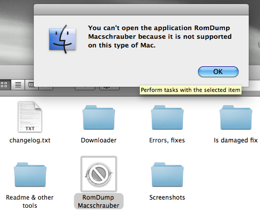

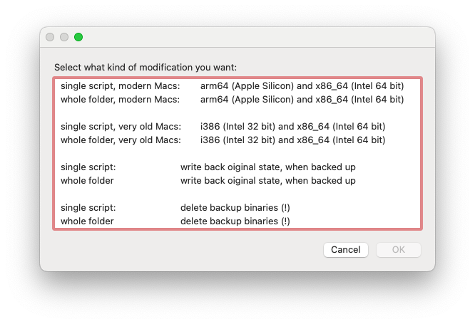

For ancient 32 bit Macs, like those with Intel Core Duo:
There are no Intel 32/64 bit + ARM AppleScript binaries.
I added a tool <32bit or ARM AppleScripts> to swap binaries for AppleScripts, when 32 bit compatibility is needed.
Also useful for Silicon Macs, running AppleScripts what are not compiled on the latest OS. When ARM binaries are missing they run X86 code in Rosetta 2 emulation. So just run the tool and use the Intel AppleScripts natively.
