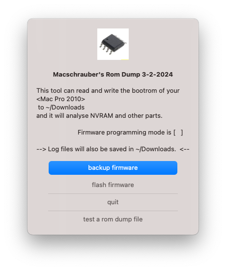

If you dump with my tool there is no menu to choose what chip. In the background it assumes a chip we know from experience and probes with it.
Anyway, if the dumper is asking for a chip on a Mac Pro 4.1 or 5.1 something is odd. I send you a conversation to give me some log files what are not for the public.
Edit:
Mary Andrea has been using a package he found on Youtube where the Dumper and DosDude's RomTool is both included.
He is asking about DosDude's tool.
The Dumper does not need selection of the flash type. At least not on a Mac Pro.

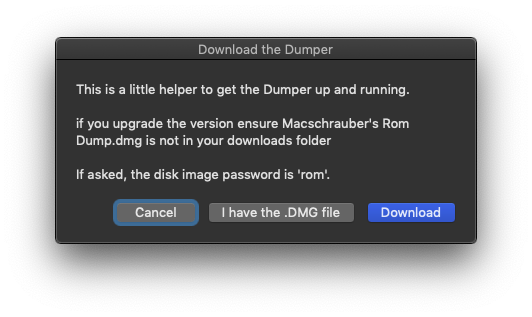

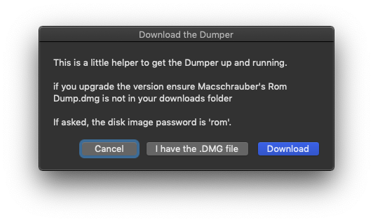

Hi Macscgrauber. I cannot launch the "Download the Dumper" app my OS (Monterey) asks me "do I want to open it" once I confirm yes then nothing happens. What must I do to get this working thanks. Sajin
just did a quick test from the dropbox download, downloaded from Macrumors, startet, worked:
try another browser, try in Terminal:
xattr -cr ~/Downloads/Download\ the\ Dumper\ from\ dropbox.app

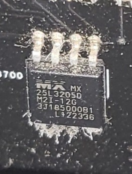

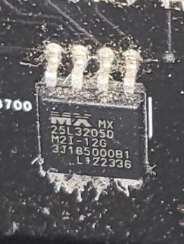

Hi Macschrauber, sorry to use a reply to get your attention on here (felt rude to me, idk).
I have a MacPro5,1 (Mid 2012) that uses the MX25L3205D
(Please forgive the pubes as I've yet to really dig into the machine and I got it from FreeGeek like a week ago
) Your dump tool defaults to the MX25L3206E which would normally be appropriate had I not had one of the rare machines that not containing one. I am concerned as I've read from other sources that this could potentially be a source of damage to the NVRAM and to be honest I have no desire to desolder the damn thing anytime soon. I hope to enableGOP my firmware so that I can have a "native" experience with my RX480. Basically my questions are as follows, am I at risk of any damage in using your dump tool? Should I instead be using DosDude1's program since it has the option to select the ROM chip? Is your program capable of testing the integrity of a dump made with DosDude1's tool?
Sorry if at any point I sound pretentions, I've been struggling for hours to merely upgrade the firmware to latest and its wayyyyyy too late. Thanks!!
(Please forgive the pubes as I've yet to really dig into the machine and I got it from FreeGeek like a week ago View attachment 2337037
In my experience (I flashed more than 100 different Mac Pros), it really makes no difference, with those 2 MX versions.
But if you feel better with it, you rename the file to match your chip version.
The Dumper checks first for the chip in the filename. For those who have not the expected chip in, or for those what swapped it with another variant.
and, btw. The tools (DosDude Romtool, my Dumper, and the tool in the background what does the real job (Flashrom) do zero changes to the bootrom.
The Dumper just reads it and scans a lot of stuff, using tools and functions from Syncretic, from Uefiextract, from joevt and from me.

Thank you very much for your reply, I renamed the file as you mentioned (for the added security [even if it exists]) and the flash was successful; computer boots, shows the entire boot process, and the NVRAM still tests nice and clean.

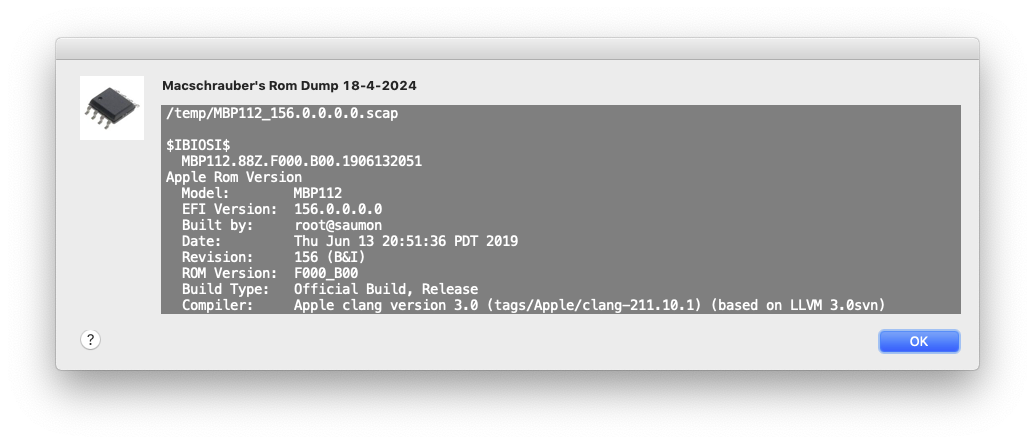

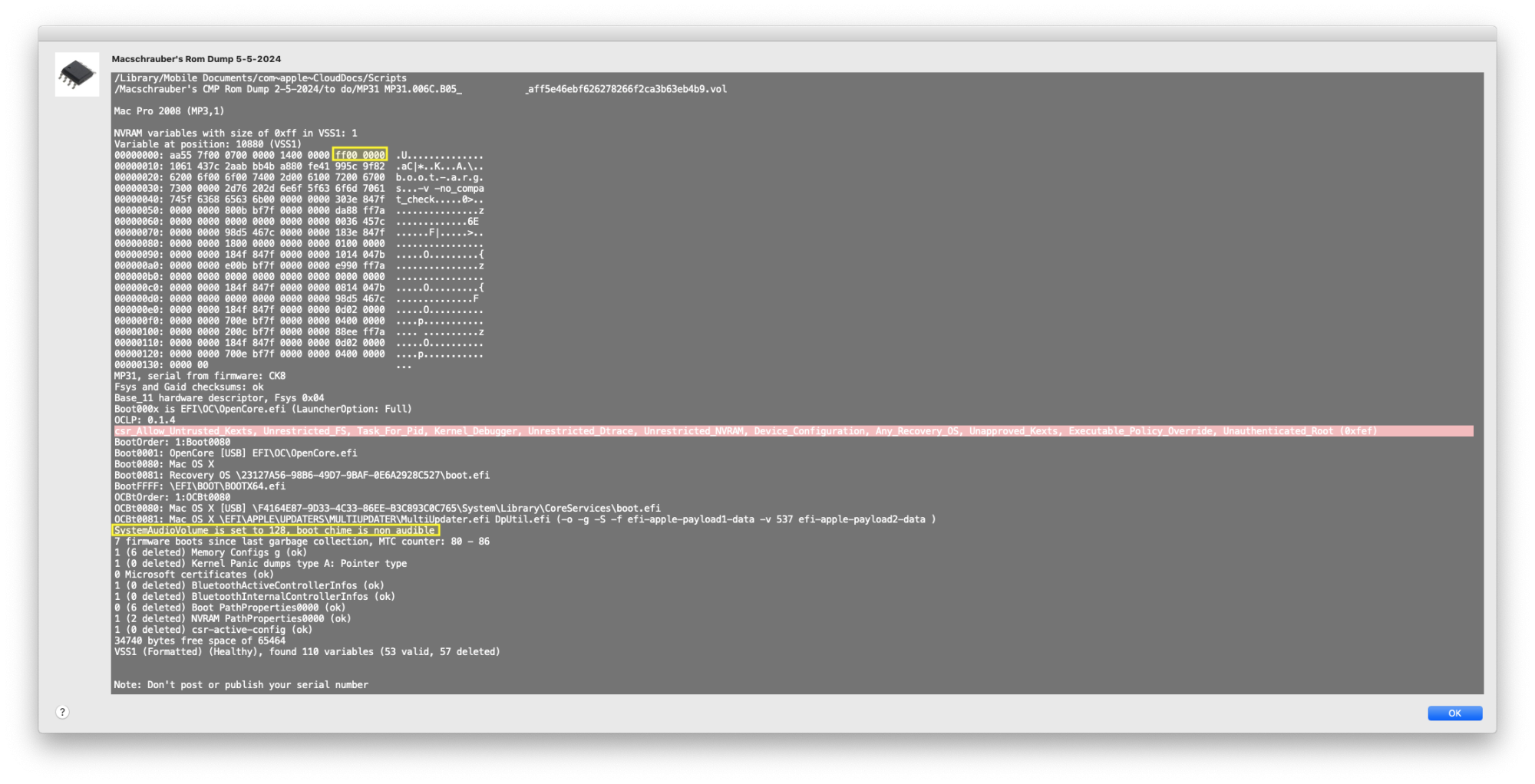

-> analyzing `.scap`files
Those are proprietary firmware capsules used by Apple to securely package and distribute firmware updates.

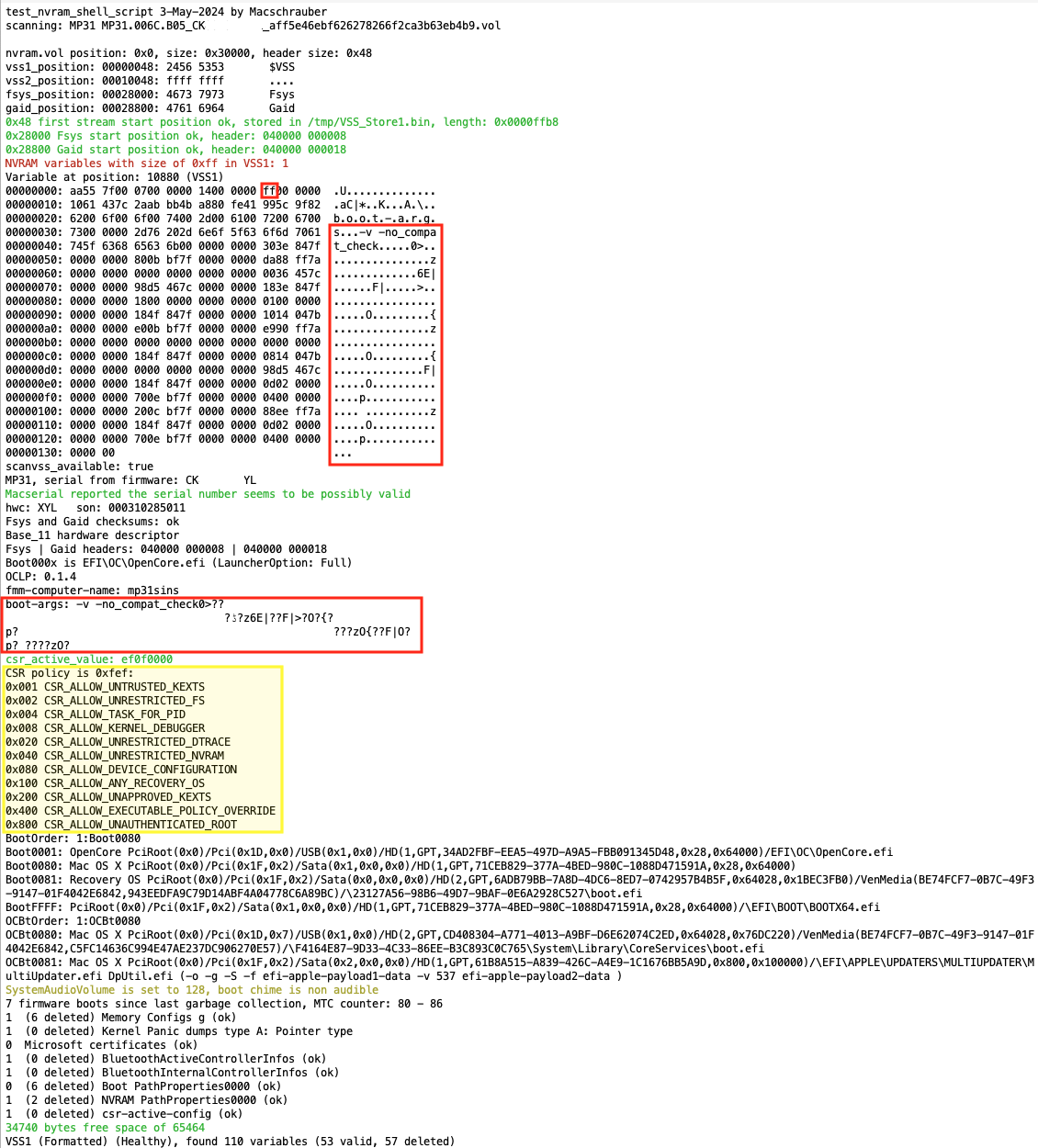

-> revisited the display of the NVRAM variables to
example: 1 (5 deleted) MemoryConfigg
-> showing some more NVRAM variables:
recover-boot-mode
sleepwake_diagxx
SleepWakeFailureString
StartupMute and SystemAudioVolume for detecting no audible boot chime
-> wildcards for the test_nvram_shell script. Like [test_nvram *.bin -showallvars]
-> multiple CRC32 errors got all UUIDs displayed

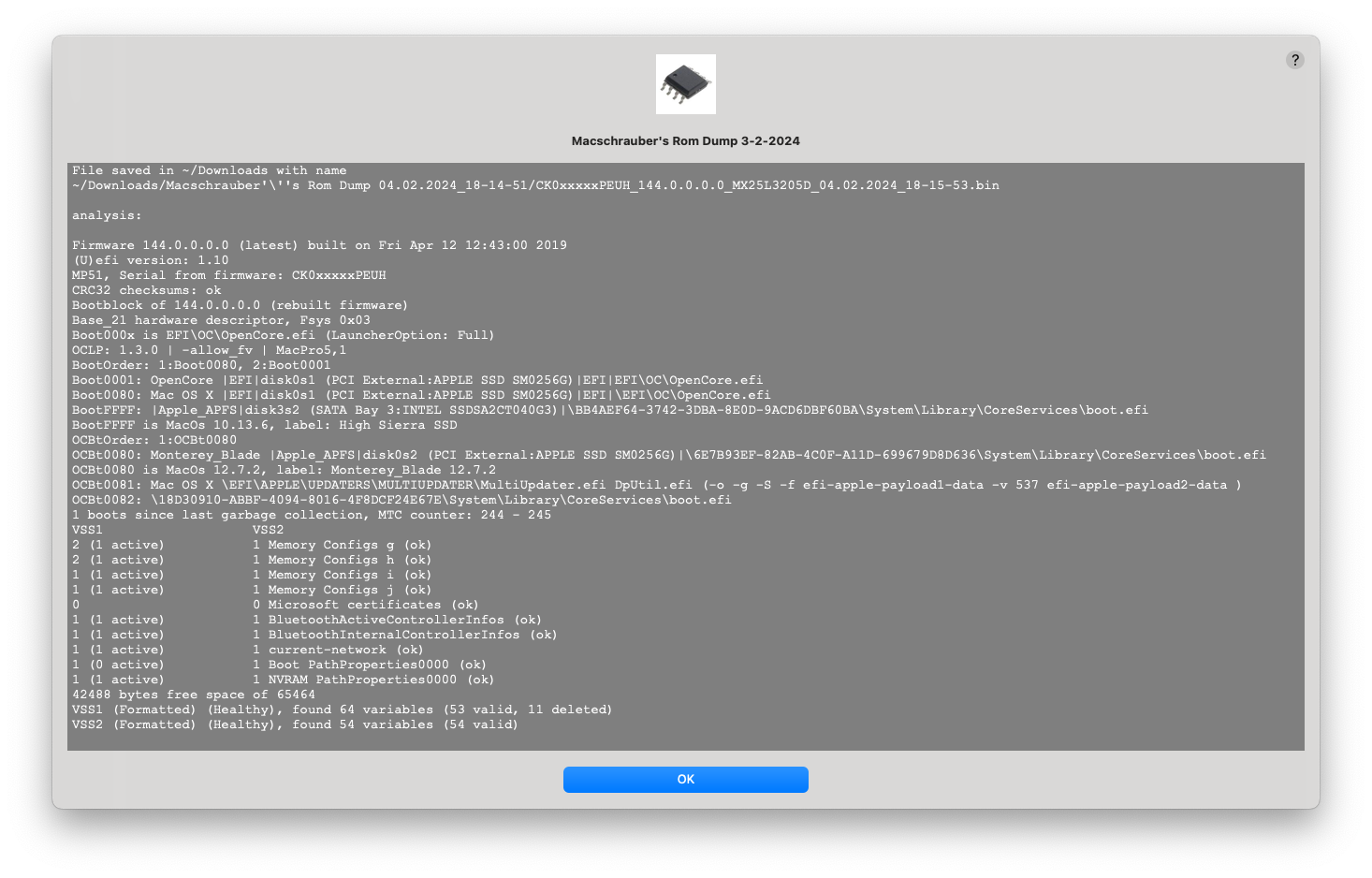

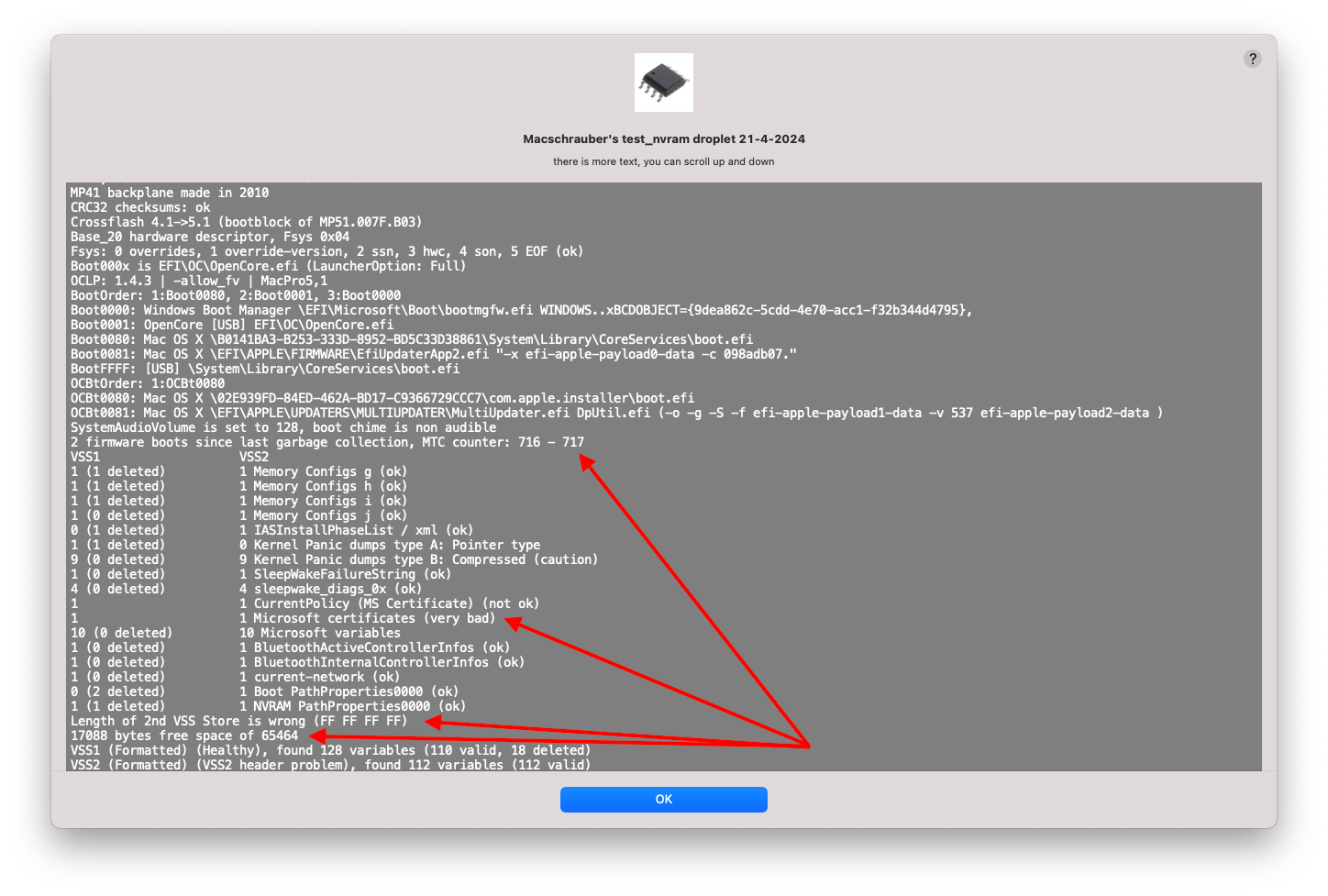

Update from 5-5-2024
-> presenting CSR values for s.i.p / rootless flags
like: csr_Allow_Untrusted_Kexts, Unrestricted_FS, Task_For_Pid, Apple_Internal, Unrestricted_Dtrace, Unrestricted_NVRAM (0x77)
-> warn for unusual var headers
like state: 0x00 or 0xff and size: 0xff
-> presenting nvda_drv=1 variable
-> presenting efi-boot-device-data variable
-> the log shows a platform compatibility test for the helper tools
fixed: security mode=none presented an alarm, tho this setting is useless it must not show a warning
Screenshot of the GUI tool:
Screenshot of the CLI usage with more details:

First off, thank you, Macschrauber for helping us keep these old macs alive and capable!
I'm trying to flash my ROM with EnableGOP. My system works great right now and has been very stable for years. My log showed a problem:
You got unusual order in your Fsys stream.
Fsys: 0 override-version, 1 ssn, 2 hwc, 3 son, 4 overrides, 5 EOF (unusual)
Do I need to rebuild? Or can I proceed?
I also saw listed:
-2 firmware boots since last garbage collection, MTC counter: 563 - 564
-1 Kernel Panic dumps type A: Pointer type
-37136 bytes free space of 65464
Any reason not to proceed?
Borowski
macrumors 6502
Oct 22, 2018
250
67
If the CRC32 of Fsys is valid, you can proceed. If entries change their position by mistake, corruption or got partly overwritten, CRC32 is invalid and needs to be recalculated.
Seems Apple or their service providers didn't always follow the same rules. I've also seen interchanged "override-version" and "overrides". It is only informational, seems it doesn't affect function.
Macschrauber
macrumors 68030
Dec 27, 2015
2,976
1,483
Germany
I also saw listed:
The machine is working with this shuffled Fsys variables order (your machine booted, so it worked, of course)
But as it is an unusual order, with overrides at the end I'd fix / let it fix it.
Some time, in the process of various firmware updates, it could have been messed up. If you have rom dumps from older versions, it would be interesting to compare it.
overrides / override-version are swapping positions, this is something I tolerate and do not warn.
Macschrauber
macrumors 68030
Dec 27, 2015
2,976
1,483
Germany
As it is technically ok (CRC32 checksum is correct) it is logically unusual. I tolerate overrides and overrides-version swapping as this is very usual.
I have hundreds of Dumps for MP4,1 and MP5,1 and I do often mass tests where I scan thru all of them. To study such data points (and to test my test_nvram analyze part of the Dumper)
