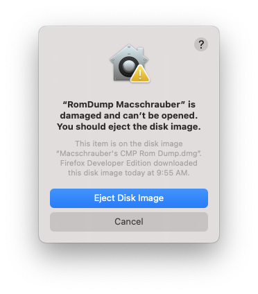

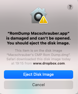

I'm having trouble with the dmg - corrupted on both mirrors, previous version loads fine.
I have tried both with Safari and they are fine. Maybe a malware removement what got triggered by included Flashrom?
To not bloat this thread we better discuss this privately until we get the solution.
another user reported: ClamXAV via Osx.Malware.Agent-6543462-0 indicates Flashrom.
That's the same issue DosDude has with his RomTool, we both user the same version of Flashrom. That's the reason he encrypted it, until now... a .dmg is ok with spreading the Dumper.

I tried both aforementioned DL (GMX and DB), and (running from the DMG) each failed (FFx, Safari). same as you w1z
Copying the contents to a New Folder, I was then successfully able to 'xattr -cr' the .app, and run it.
It may be somewhat informative to explore the folder structure of test_nvram ;)
Unfortunately, I'm not quite in a time-wise position to go the hoops to disable SIP.
Reactions: w1z
Starting the .app with ctrl-click - open gives the dialog for macOS cannot verify the developer of.
Then you can allow the OS to run the app.
But thanks for the hint with xattr -cr :)
Reactions: splifingate
Man, I sure am slow to get with these things 🙄
Think I'll get myself re-booted, today <smile>
btw, it was Macsonic, that clued me to the osxdaily xattr hint (my last usage of this was multiple turns of the Sun ago) ;)
Thanks for the reply - no malware or antivirus probs installed.
I downloaded the latest DMG by using Brave. Work flawlessly on my cMP (in Monterey 12.6.7).
Brave is my default browser and I've experienced the same issue with all browsers.
@w1z Tried downloading the dmg and worked fine with Google Chrome. Using Catalina and also worked in Mojave. Maybe you can try clearing your browser cache. Then close and re-open your browser. You may also check this article.
https://osxdaily.com/2019/02/13/fix-app-damaged-cant-be-opened-trash-error-mac/
Did that as well thinking there might be remnants of a previous failed download.
This was it! Thank you.

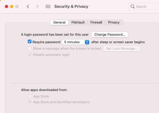

did you try just to citrl-open it?
how is your setting in the security pane in Allow apps downloaded from?
normally it's just citrl-open the .app or the scripts and allow it.
The next time it can be opened as every other .app by double clicking.

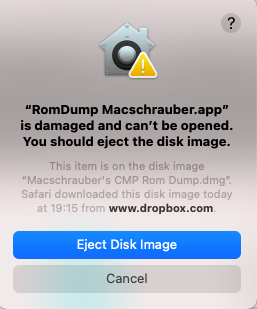

I had the (false) damaged app warning for myself:
Solution:
copy the .app into Utilities (for example)
For Utilities type or copy/paste this line in the Terminal app:
Code:
xattr -cr /Applications/Utilities/RomDump\ Macschrauber.app
need to check out what's going wrong there, never had this before.

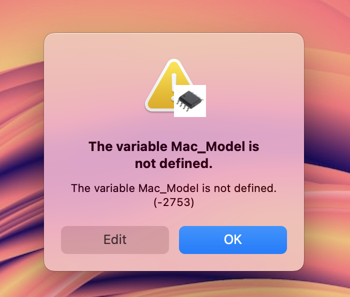

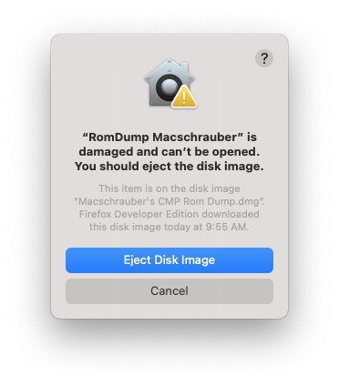

Thanks for this latest release! I noticed a bug whenever I try to flash:
I tried running it directly from the dmg through the alt link and from Application/Utilities ... SIP is disabled, for flashing.
Reactions: Macschrauber

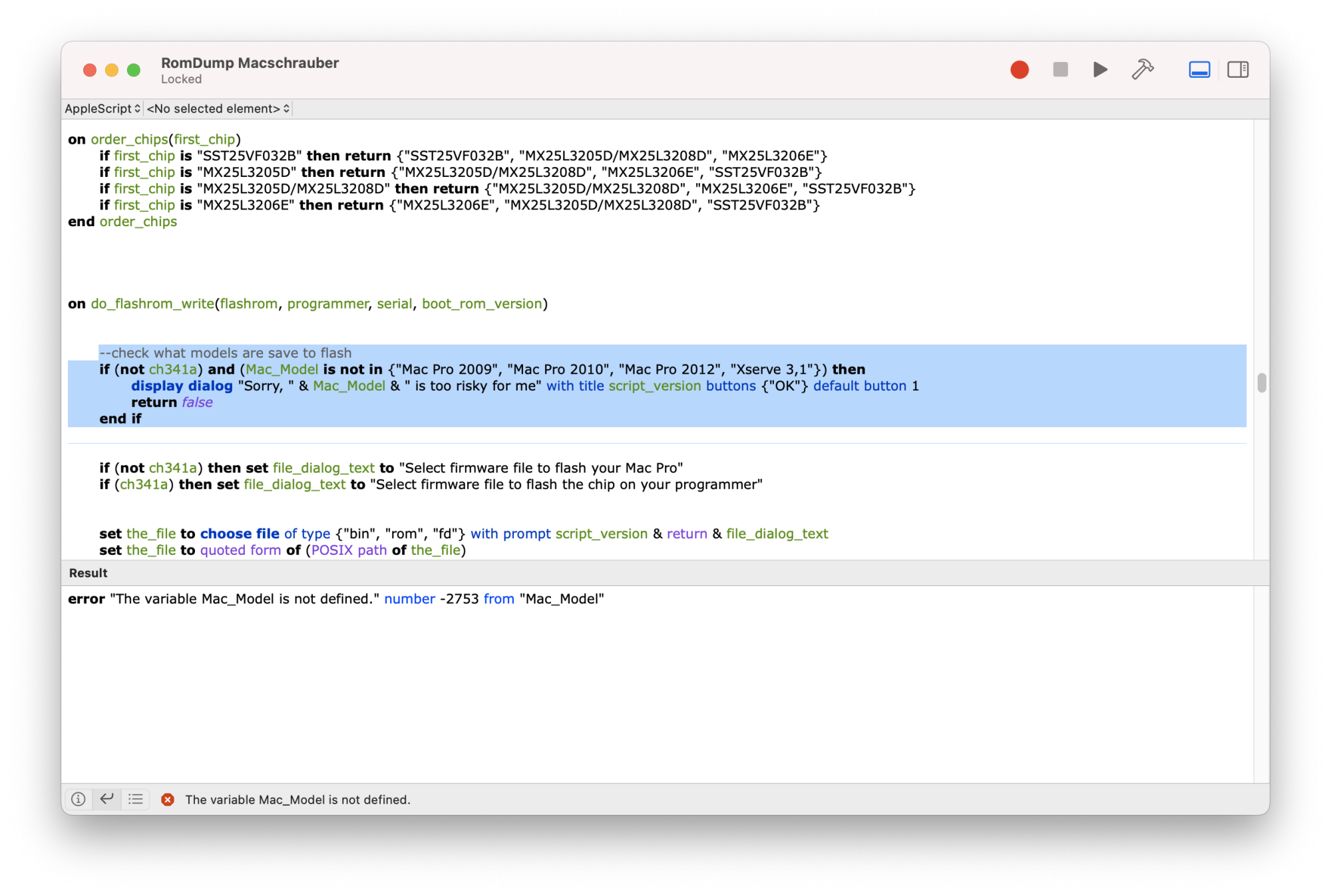

was that the latest release?
had this bug in one release what I pulled very soon.
otherwise send me the log file in a private chat I open.
found the bug in this line:
Code:
global Mac_Pro, spoofing, serial, masked_serial
change to
global Mac_Model, spoofing, serial, masked_serial
I renamed the variable Mac_Pro to Mac_Model due to the tool is no Mac Pro-only tool no more.
But for some reason it has not renamed the definition as a global variable what I overlooked.
This is fixed. As I had some more changes I will publish a new version this evening what includes that change of course.

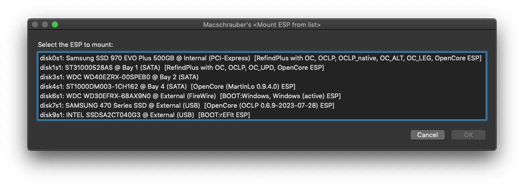

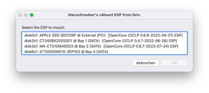

fixed,
Version from 31-8-2023
the latest version has improved ESP tools.
One I find quite useful is <Mount ESP from list>
This little tool shows the disk, the model, the position, the interface, the bootloader flavour and version if possible
disk0s1: RefindPlus/MyBootMgr with its OpenCore instances plus two OCLP instances I added
disk4s1: MartinLo's OpenCore variant, reading the version out of the config file's firmware spoofing string
disk6s1: Windows 10 ESP, (active) means that the .efii file is loadable, so to take care not to use without firmware protection
disk7s1: OpenCore Legacy Patcher, reading the version out of the config file's comment section
disk9s1: rEFIt
3 different OpenCore Legacy Patcher versions on 3 ESPs.
https://forums.macrumors.com/thread...es.2333460/page-4?post=32055801#post-32055801
