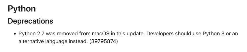

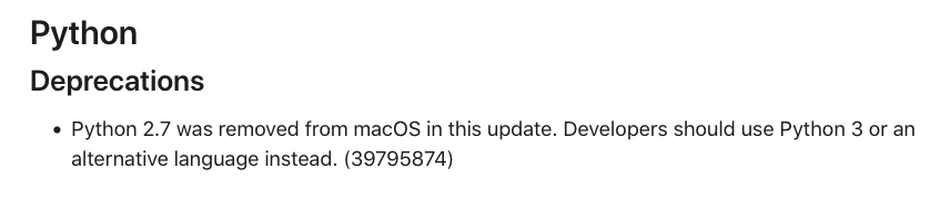

12.3 dropped Python
It didn't drop Python altogether, but just updated the version to Python 3 btw.
You therefore now need to use the python3 alias when running commands instead of the old python alias. This is unless you point the python alias to Python 3. Code obviously needs to be Python 3 compatible to work.
If I got it right you have to install Python 3 via the command line tools of xcode
it's a bit too much for just probing modifier keys in my script. I found a solution without python anyway in the meantime.

you have to install Python 3 via xcode
Yeah. Seems to be quite a barrier. Didn't realise the Python 3 version they "provided" was just a placeholder.
Strange that they would make sure a change in a minor point release and not just wait till the next major point ... or have just done it at the Monterey release to start with.
Faced the challenge of ensuring Python 3 support with MyBootMgr a while ago, as this needed to hook into a largish scripts derived from the OCLP and couldn't just use an alternative language.
Got it working, but pretty sure anyone that puts the binary through one of those much beloved but ultimately useless sites like Virus Total will get told it is malware ... same issue with the OCLP on those sites. I suppose Python now needs to more or less be avoided on Macs.
Certainly different from the the good old Apple Fan Boy "it just works" days when stuff like this did indeed just work right out of the box. I suppose the new largely iPhone sourced user base don't quite need such stuff to just work. Just chill in the walled garden and throw it away for a new one next year or so.

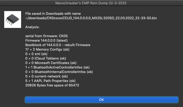

I have now taken the logical step of counting the critical nvram variables separately.
From the beginning it was not quite correct to count both streams together, but once you start with one method, it's hard to get rid of it.
One of the biggest obstacles was that the results are not comparable. I think I have now found a compromise that doesn't look quite as nice, but is workable. And that's what it's all about in the end...
17 + 2 Memory Configs -> 17 in the first stream, 2 in the second stream.
The previous version would have shown 19 memory configs. The internal evaluation has correctly considered the first stream.
The second one is something like a backup or rather a template and contains only the first instance of the variables.
The first stream grows until it is full and then there is the garbage collection. It makes a copy of the first stream after the first run into the second stream.
Everything is the same as before, only the counting is split. In other words: What is in the second stream is what is in the nvram after booting once after the regular GC.
If the second stream is empty (after firmware rebuild or manual GC) then the dumper writes that like the previous version: 4 memory configs.
4 + 0 would be a little stupid ;-)

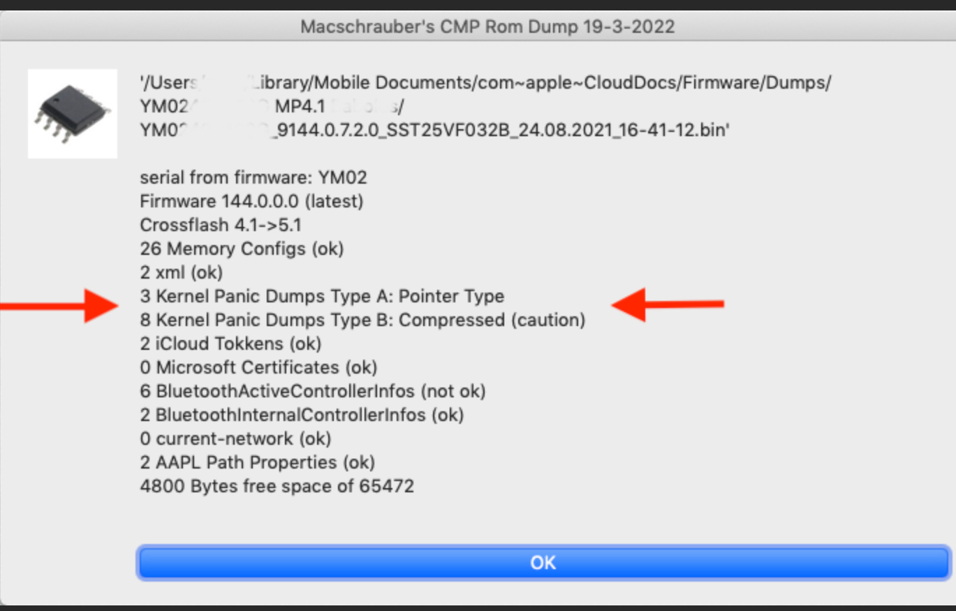

Type A: a pointer to a file, not problematic
Type B: the kernel panic text in multiple compressed parts.
In the past day, I have been experiencing multiple Kernel panics on a MacPro5,1 8-core when chain-loading RefindPlus 079 -> OpenCore 0.7.9 - > Big Sur 11.6.4, nothing to do with macOS Monterey because I have never installed it. I think it has something to do with the SIP being enabled and the OC config having SecureBoot = Default, but it was working fine before that. I suspect this because on one boot into OC -> Big Sur, I did verbose mode and saw the message "Rooting from the live fs of a sealed volume is not allowed on a RELEASE build".
On dump of this MacPro5,1's BootROM, your tool found 5 of type A panic dumps, and 20 of type B!! I already have a reconstructed BootROM from @tsialex, so I am going to flash that to clear things out.
What I want to know is: Is there a way to read the compressed kernel panic text from the dumped BootROM file?
next time you boot into a matching system you will get the screen for reporting the kp to Apple.

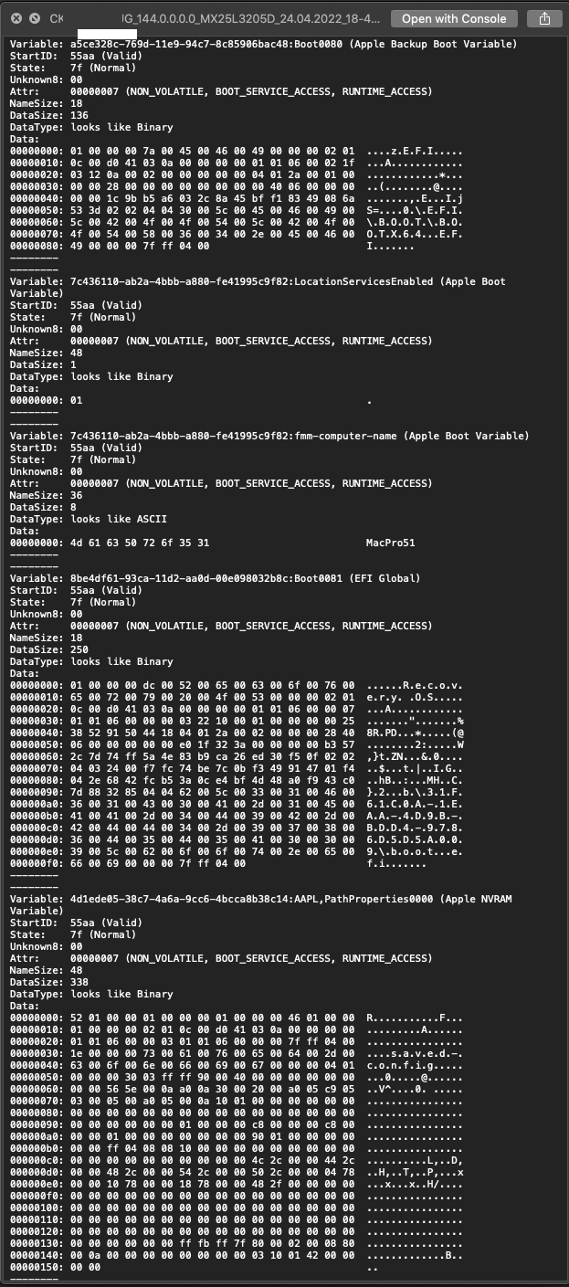

when you display details you will get the kp text.
if this happens please dump the firmware again, I assume the stored kp will be wiped after showing it.

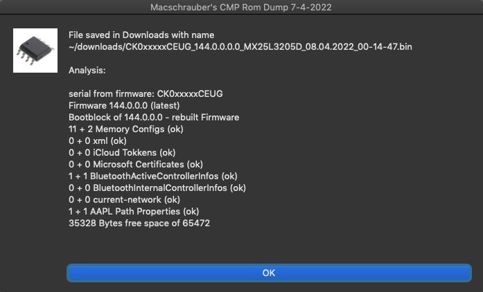

It happens all the time that users post screenshots of the dumper's test_nvram dialog with showing their full serial number.
This is not good as Hackintoshers like to use that numbers for their builts.
So masked it in the main dialog. I disliked it first as I need those serials to track dumps.
@Dayo got my attention to the simple but working solution: Just mask the dialog, keep the serial in the log and in the filenames.
what is shown is good enough to identify the model - but not good enough to use the serial for a Hackintosh.
same link

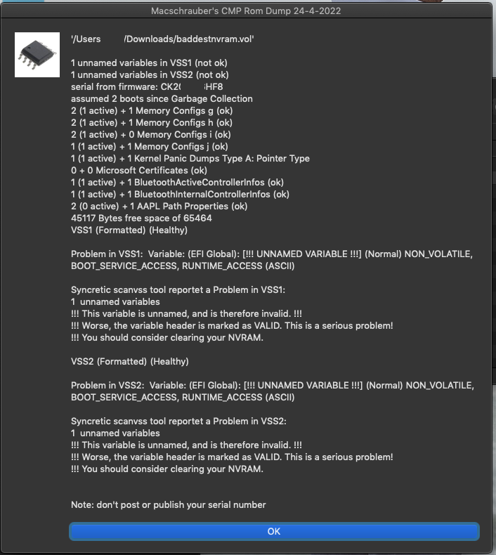

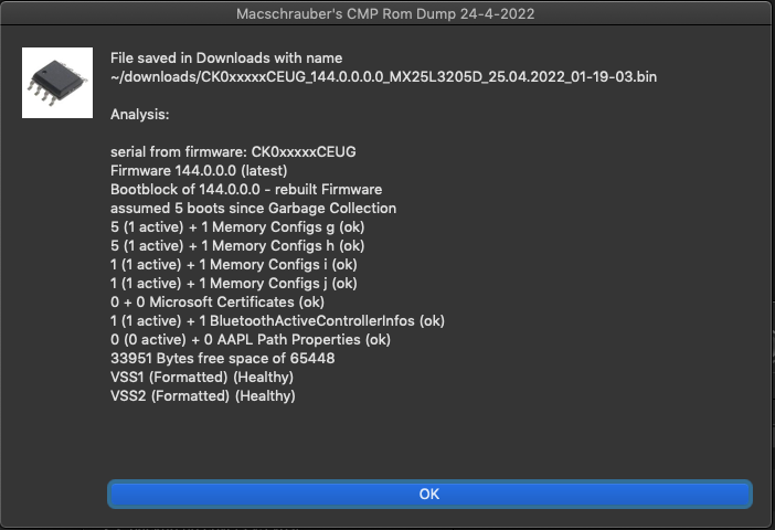

New version of the dumper.
The analysis is much more intensive thanks to Syncretic's Scanvss tool.
I am in exchange with the author of the tool, so the dumper benefits a lot from it.
Over 100 variables are checked. There is now a distinction active / passive.
The MemoryConfigs are now differentiated according to the 4 types. If there are irregularities here, it could be contact problems on the modules or sockets. Or of course a defect.
By the higher possible number of the variables only variables are indicated (apart from the Windows certificates), which have at least one entry.
All other variables with an occurrence greater than 4 are listed. This does not have to be necessarily bad. There one must still collect experiences.
In the logfiles is now a complete run of Scanvss. Keep this log very privately as it contains personal data.
a messed nvram volume:
a healthy firmware:
Syncretic's Scanvss full log:

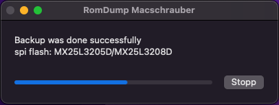

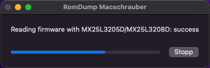

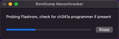

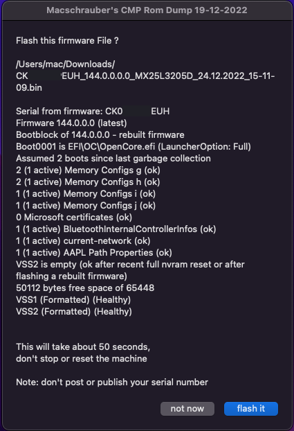

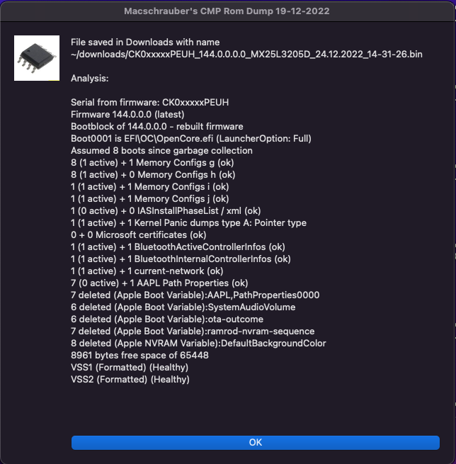

Made some progress with the Dumper:
-- it alarms if checksums in Fsys or Gaid stores are incorrect and refuses flashing
-- filenames show correct boot rom version if spoofed via OpenCore
-- added LauncherOption:Full info for OpenCore setups
-- a progess bar
-- support for a ch341a_spi programmer, detects it and switches to ch341a mode
-- hints for dealing with problematic NVRAM streams like critical low free space or certificates
-- indication of firmware password set (security-mode=command or security-mode=full)
-> as the file is too large the latest version of the Dumper is available at:
https://c.gmx.net/@899644307915413392/-dLWoaKNRdOT1yPrQ7RZsw
https://www.dropbox.com/s/kr74r2ft0nrvp7n/Macschrauber's CMP Rom Dump.dmg?dl=0
