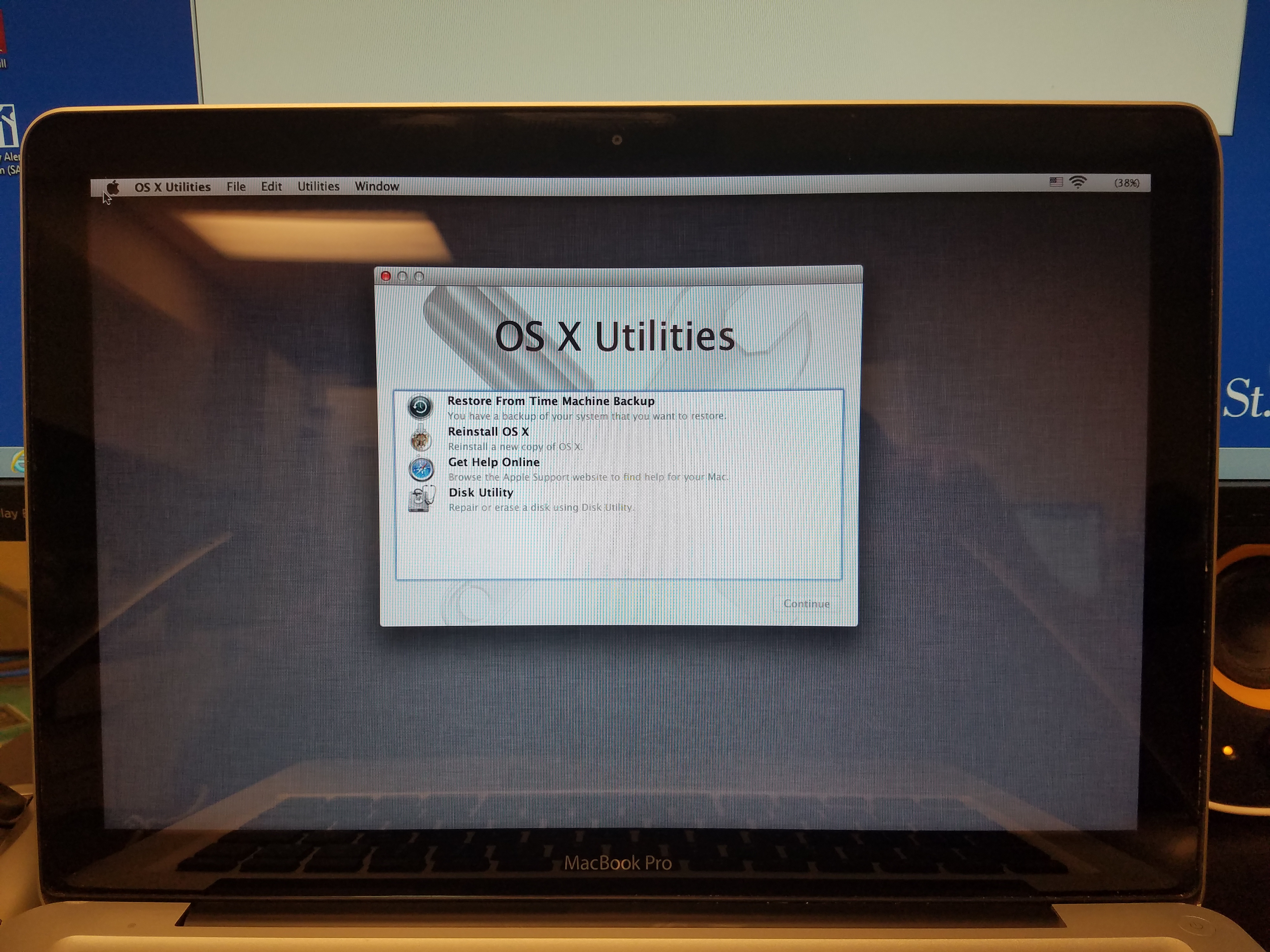

Hi
I hope you can help me to I was trying to reinstall my os x and accidentally deleted my HHD now when i try to reinstall my os x no drive showing up i dont have TM backup before the problem happened hope you can help me my macbookpro os is lion year 2011
Hi

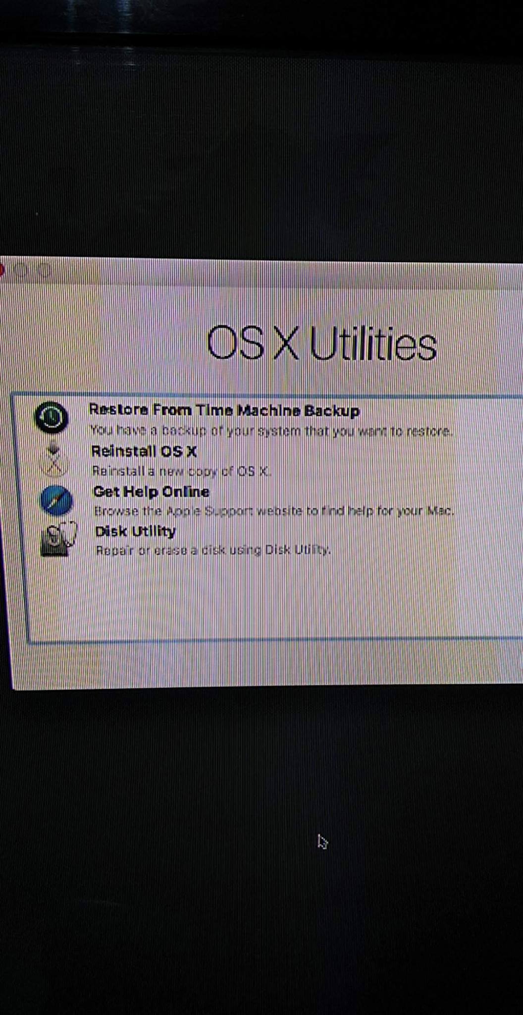

Can you command-option-r boot into Internet recovery?
Yes
You can replace the hard drive.

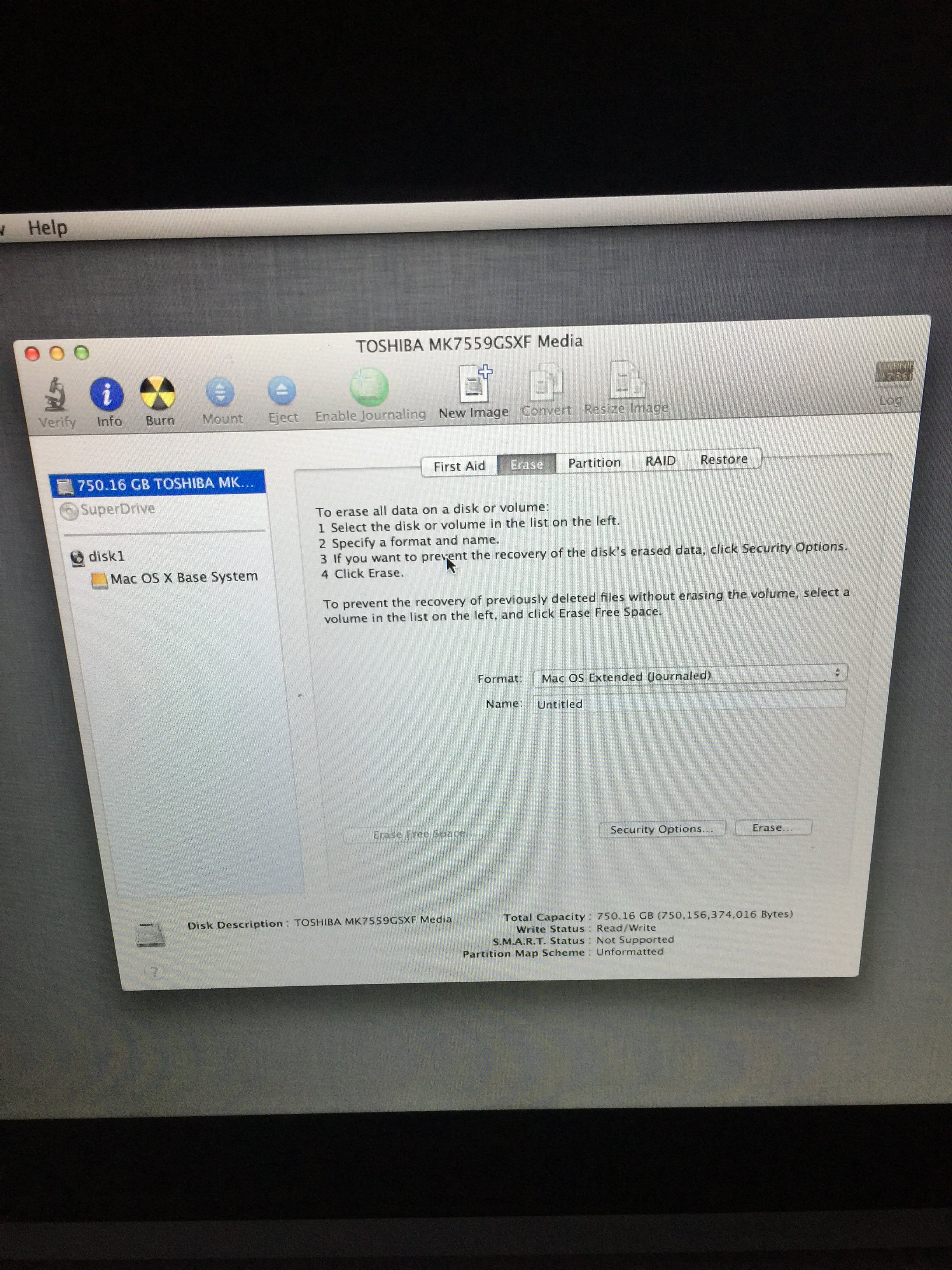

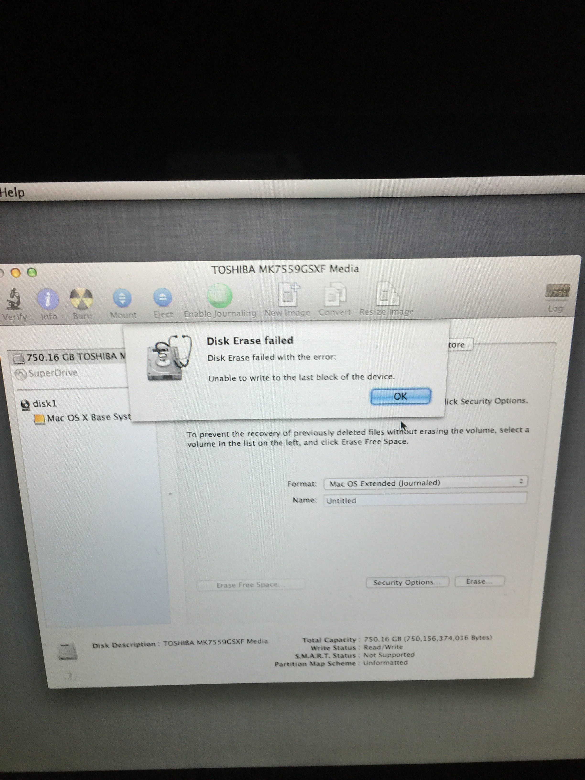

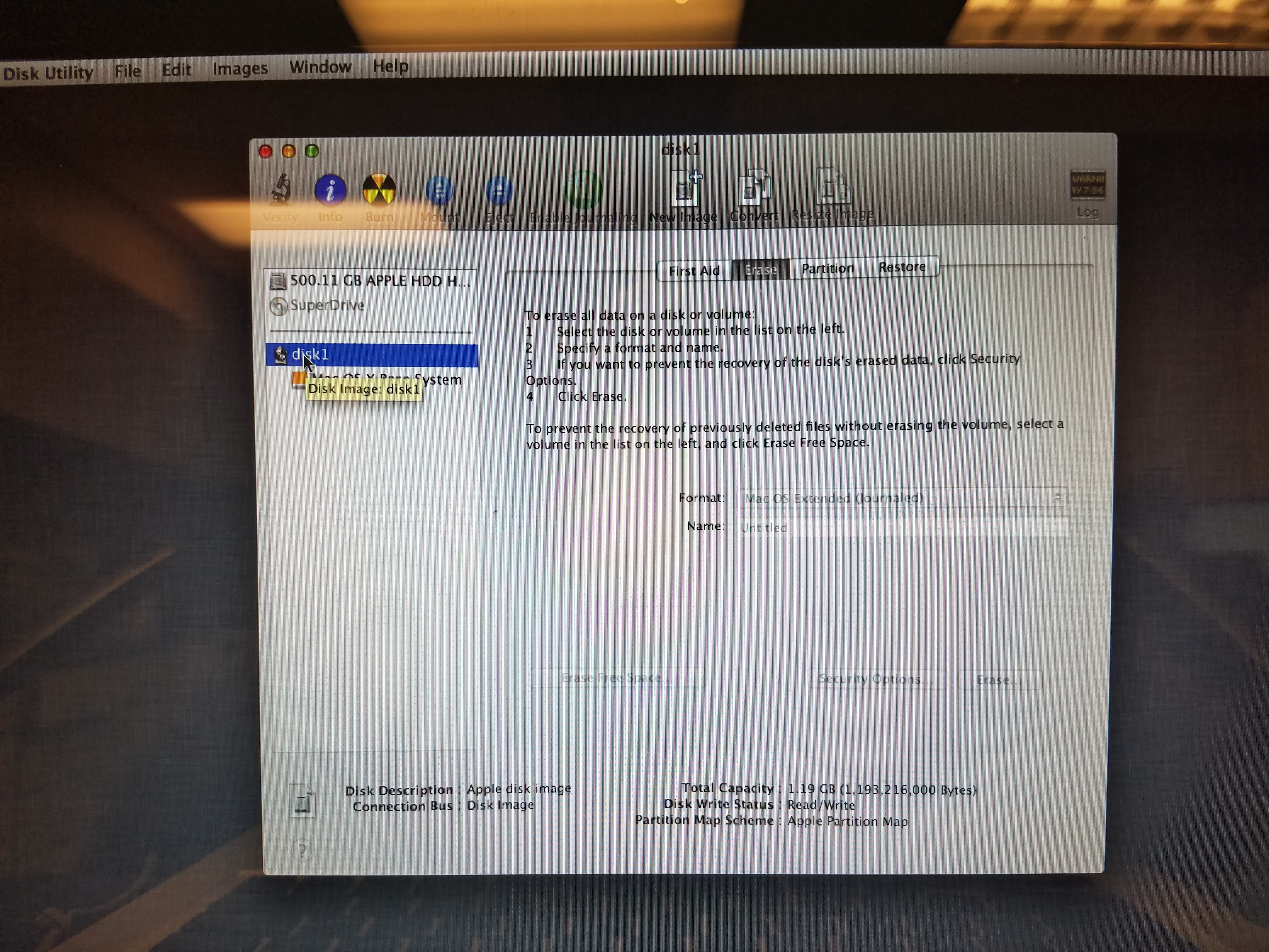

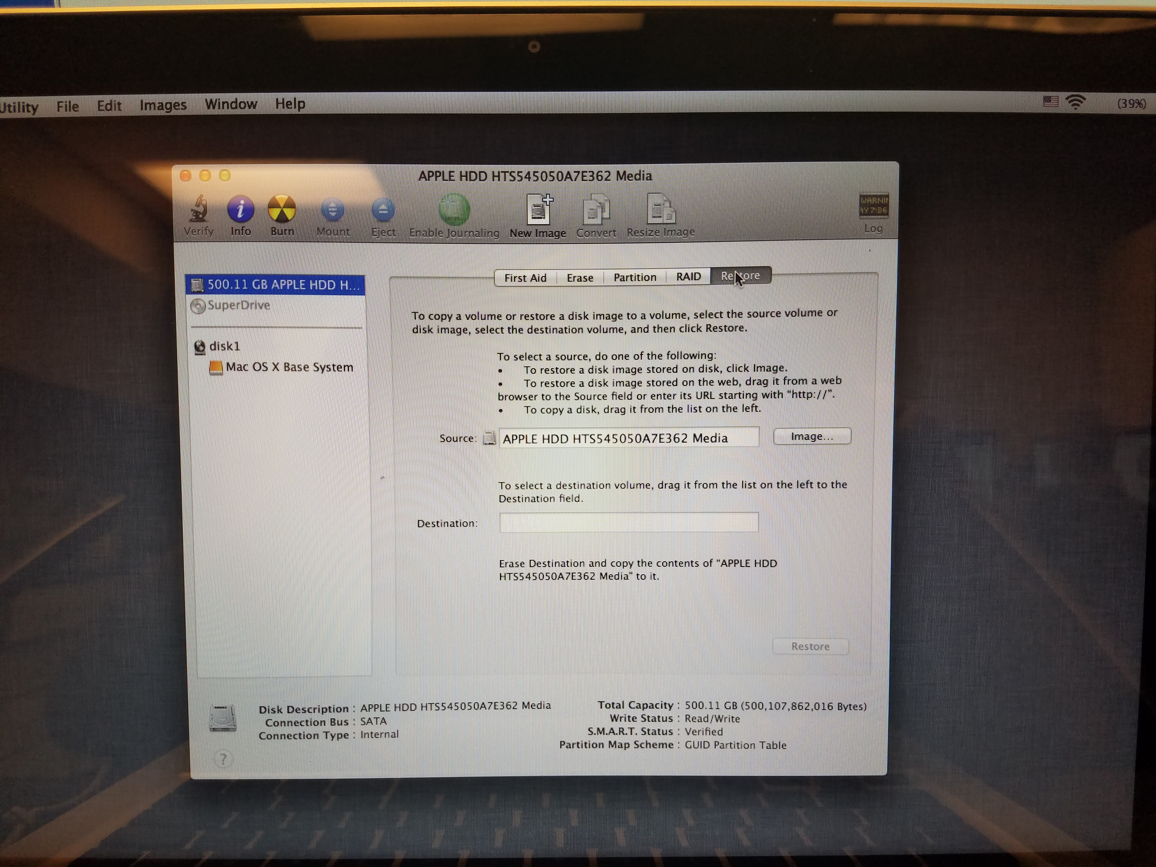

Good evening techs,
I found this thread a few minutes ago and it describes my current scenario. I received a hand me down mac book pro and it was running slow so I tried to clear to factory settings and deleted the hdd drive. I don't believe the hard drive is corrupt because it was running correctly prior to my mistake. Unfortunately I do not have the back up "disk" to reboot with and am at a loss. I attempted to partition but failed. I rad through the whole thread and was unable to resolve my issue. Ant help at this point would be greatly appreciated. I can post up pictures of needed.
Thanks
Edit. I don't care about anything on the drives
Edit/Update. I deleted the drive and it came back and all is resolved. This thread was very helpful, thank you.

What year and model Mac do you have? Can you explain how you got to this point?

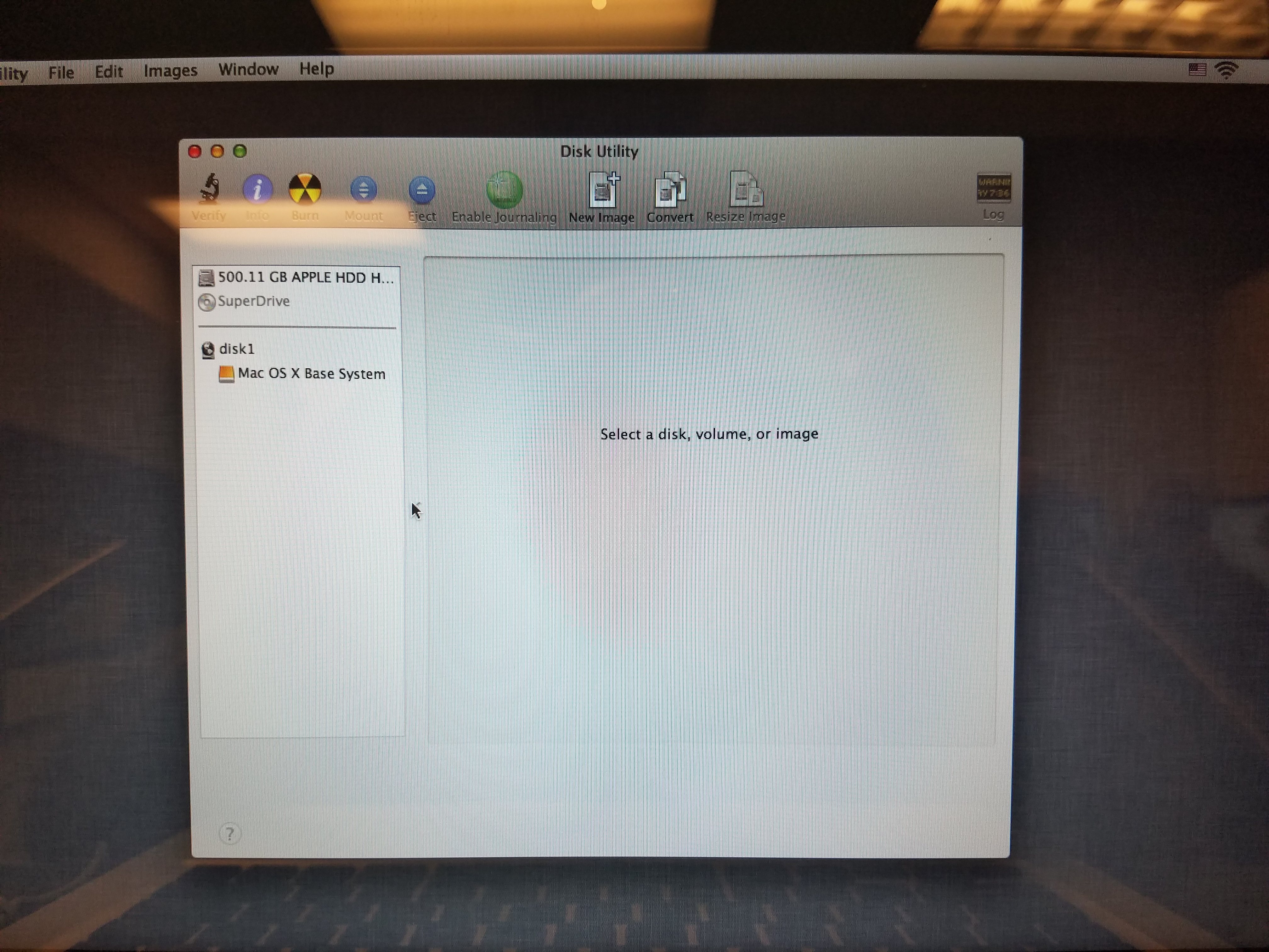

[doublepost=1500705754][/doublepost]Hi, somewhat in the same vein— hopefully you can help. I was installing a Samsung 850 500GB SSD into my mid 2012 MacBook Pro due to me original hard drive failing. When I was erasing the drive to format it as a Mac OS journal I accident did it to the "main" Samsung folder and NOT the sub folder underneath!! The computer stalled for minutes saying "unmounting" so I turned the mac off and now the brand new SSD can. It be recognized by the mac! I don't have any back ups available. The computer barely boot to the desktop, prior to the ssd install attempt, sometimes it does (once in a blue moon but takes 15 mins) I am still able to access disc utility but the ssd, which showed up initially, isn't recognized at all. Is there anything I can do short of getting another new ssd and trying again? I will be making a USB Sierra boot from a friends mac tomorrow because the mac originally came with Mountain Lion, though it was running Sierra before the original hard drive began to fail.
Thank you so much in advance for any help or advice.
That is actually the correct way to erase. You want to select the drive itself at the very to of the left column in Disk Utility then erase. To do that, you will need to be either booted to Internet recovery or an external source like a USB key. How are you booted when trying to do this?

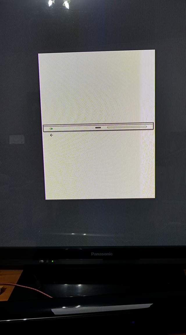

Try holding command-option-r at boot (all three at once). Does that bring up a screen where you can select your wifi and a spinning globe?
Hi Weaselboy,
Yes a globe as come up and after a bit it come up the apple logo.
After that it changing between to images that i don't know what it is.
Okay... that is a good sign because you have a new enough model that supports Internet recovery.

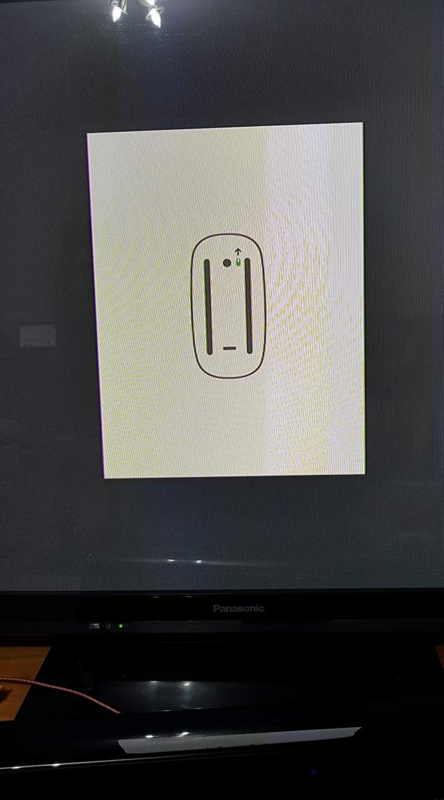

Those images are prompting you to connect a BlueTooth keyboard and mouse. What are using for both now?
I have a wired apple keyboard but i don't have an apple mouse. Just a normal mouse, will that work?
[doublepost=1505846345][/doublepost]I connect a spare mouse I had here and it says welcome! :D
[doublepost=1505846478][/doublepost]I choose language and now I've got this.
[doublepost=1505846774][/doublepost]I clicked option 2 and now it's downloading the OS X El Capitan into the hd
I presume that's a good thing :)
[doublepost=1505847070][/doublepost]42 min to know if it worked....
