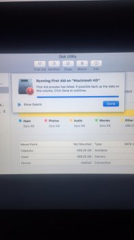

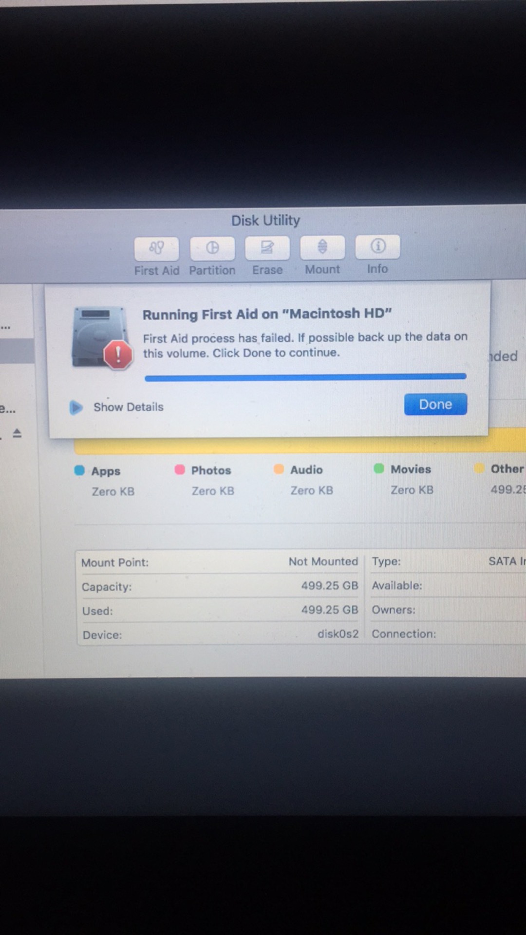

I'm now wondering if you have a failing drive.
When you have done the command-r boot to recovery... can you start Disk Utility and run First Aid on the Macintosh HD volume?
I think you have a failed drive there. Hopefully you have a backup you can restore from. Do you have a Time Machine backup?

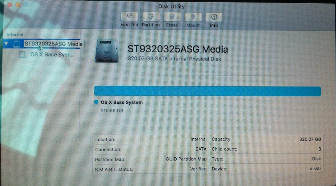

Please, oh please. I know I messed it up myself but please help me fix it!
I'm having a problem kind of similar to the people above me, but I'm afraid to try the suggested fixes because I notice some differences, and my problem started when I decided to plow ahead ignorantly without caution when in Disk Utility.
To recount what I can remember (this happened over about two weeks) I wanted to erase the data from my Macbook, essentially restoring factoring settings. I booted in recovery mode, went to Disk Utility, and from there it gets all hazy.
I think what happened was I tried to erase the data on the hard drive, but I ended up somehow stupidly erasing the startup disk. I'm pretty sure I tried to restore something, but I have a bad memory and I'm an idiot so I don't remember which disk I selected. I'm sure I was just frantically clicking things. (I know.)
The problem I'm having now: when I turn the computer on, it immediately goes to recovery mode, without me pressing any keys. When I go to "startup disk" the window shows OS X Base System. When I try to restart with this, it takes me right back to disk utility.
When I try to re-install OS X from the internet, no hard drive is available.
When I restart while holding option, the recovery HD appears, but I cannot re-install OS X to the recovery hard drive because it's locked.
When I enter disk utility, this is what it looks like:
Can you answer some questions to make it easier to help?
What got you started on this? Were you having some specific issue that made you do all this?
What OS X version are you on?
What year and model Mac are you using?
No issues, I was trying to erase my data from the computer to sell it.
I believe it's 10.11.2, but I'm not positive because I can't access the about this mac and I don't quite recall. When, in disk utility, I get info on the OS X Base System, it is 10.11.2.
It's a mid-2010, Macbook Pro 13-inch.
