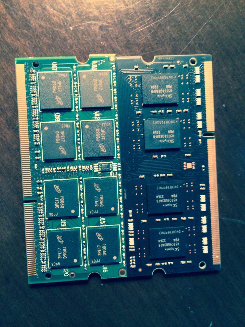

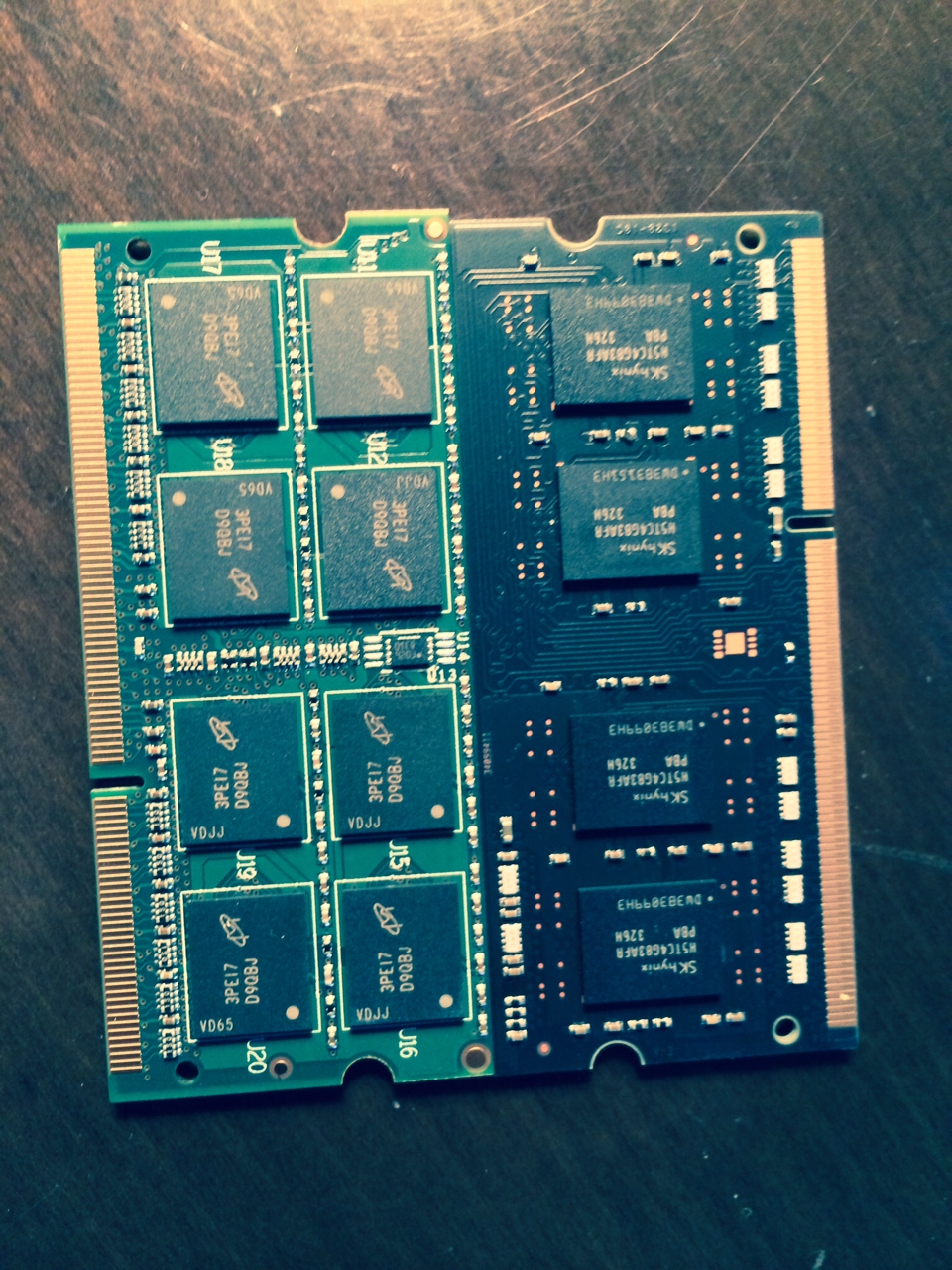

Update
OK, everyone who's been rude to the OP should apologize. I finally received my Imac and the Crucial RAM I ordered specific to the late 2013 27" imac will not fit. I took the Apple RAM out and measured them against each other and the Crucial sticks are about 1 mm longer in length than the Apple supplied memory. I just called Crucial, informed them of the problem and gave them the name of this thread. Thank God Sam and others posted and I knew better than to try and force it. Crucial rep is contacting technical support to see if they can find a firm reason for the discrepancy. I also informed them that it seems to be specific to the RAM labeled United States and not the China RAM. Lastly, I suggested they be pro-active and contact all customers who recieved this RAM.
Now I also understand why some said "it's a real tight fit, but it works." However, I refuse to force badly sized RAM into my computer and risk damaging the slots.
I'll post and let you know how they respond. They are probably reading this right now, which is a good thing as this problem needs a fix ASAP. I've ordered from them before and as many said on here, they are one of the two major RAM suppliers and this isn't an attempt to bash Crucial. If they realize the error and fix it I'll be happy to get an exchange for the proper sized RAM.
That photo proves nothing. The egde with the connectors on it looks identical length on both boards, as you would expect.
Why did you not photo them with the connectors against each other? Was it because it would not highlight the non-existant problem? Not only do you have them facing in opposite directions, you have one card with the notch towards the bottom and the other with it at the top. All your photo shows is that the back (non-connecting) end of the Crucial ram is a tiny fraction longer - something that would likely not matter at all.
Go on - indulge us. Show a photo with the cards; connectors lined up against each other so we can see they are identical.
It may or may not prove something to you.
It DOES illustrate a sizing discrepancy between the two parts.
The over-all size of the memory module is just as important to the fit in the memory slot as the asymmetrical "key" slot.
If you're not aware of that aspect, then you should not be handling memory modules or attempting to install them.
