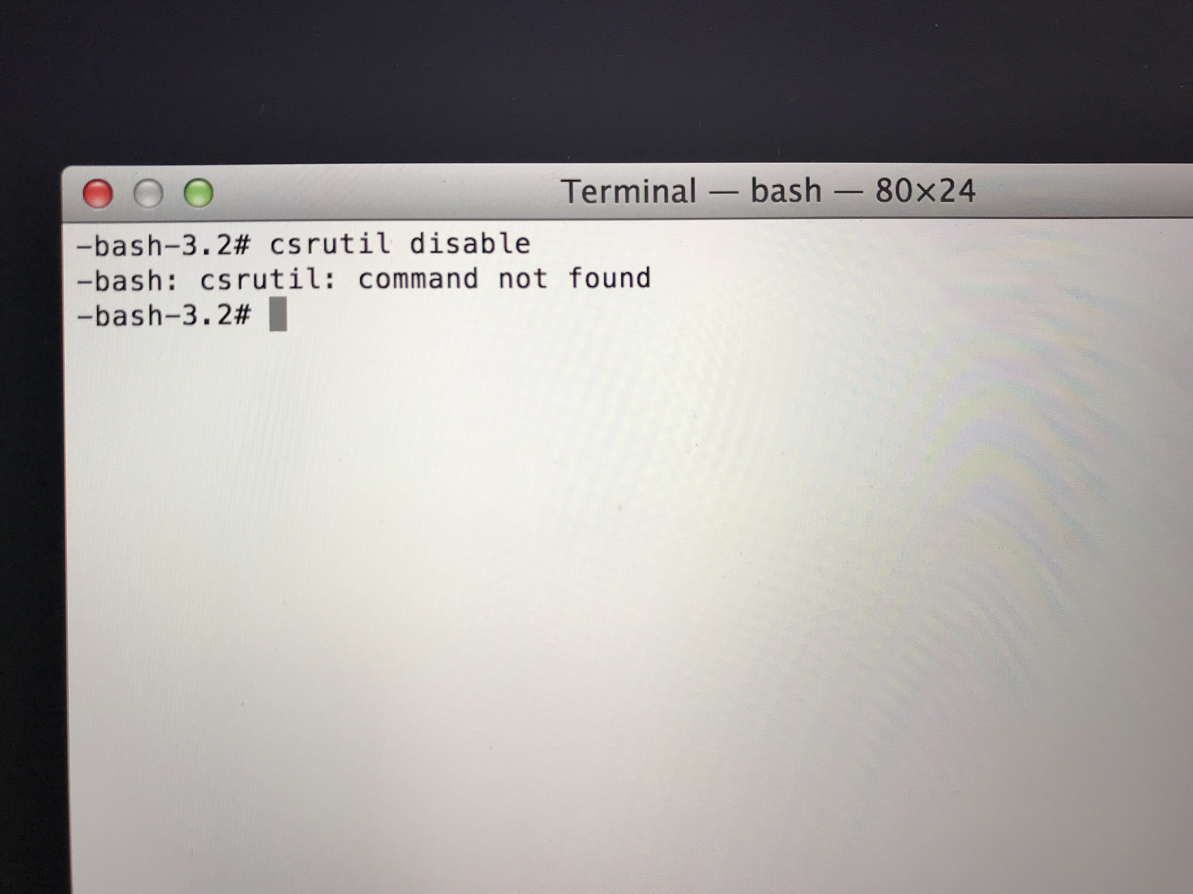

Hi,
I've been experiencing intermittent shutdowns on my Late 2013 Retina 15-inch Macbook Pro.
I downgraded the OS to the default that came with the computer, 10.9.5 (Mavericks). The crashes happen way less frequently with 10.9.5 but they still happen.
I tried this solution in this thread https://outluch.wixsite.com/rmbp-crash
But I have a problem with step 3:
sudo csrutil disable​
My terminal doesn't recognize command sudo, and when I try to run it without sudo, my terminal doesn't recognize command csrutil.
Any suggestions?

Hi,
Any suggestions?
If you are still running Mavericks (OS X 10.9.5), then you are too old for SIP.
SIP was introduces in OS X 10.11 (El Capitan), so no csrutil command until then.
So, no SIP on your system. SIP prevents most modification to system files. You don't have SIP, so it's not protected to the same level. All you should need is your normal admin user, or if that doesn't allow what you need, then enable your root user. Make your changes, disable the root user, and you should be OK.
But then, that may not help your issue, but it's worth the try, and might help.

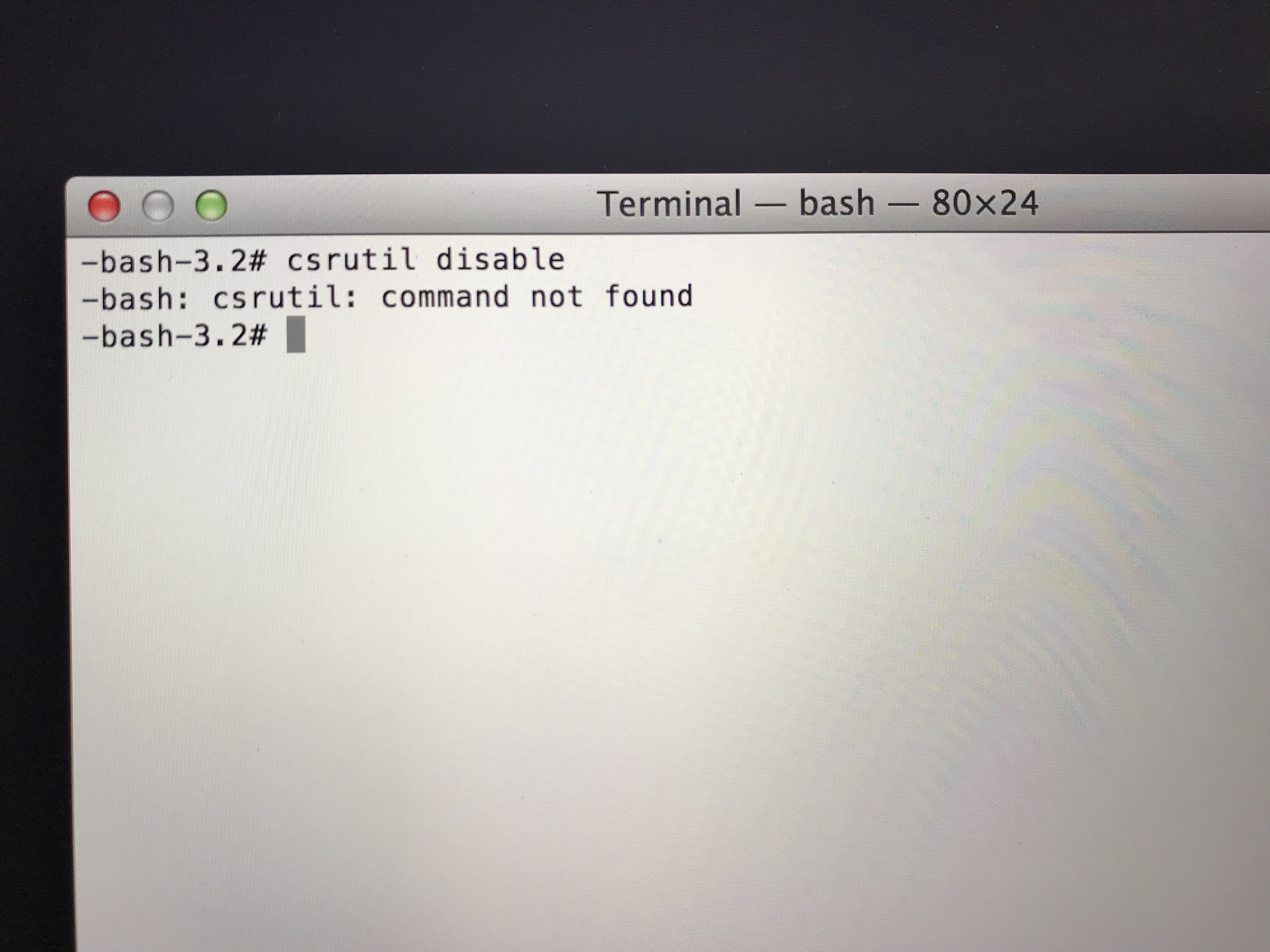

Hi,
Any suggestions?
