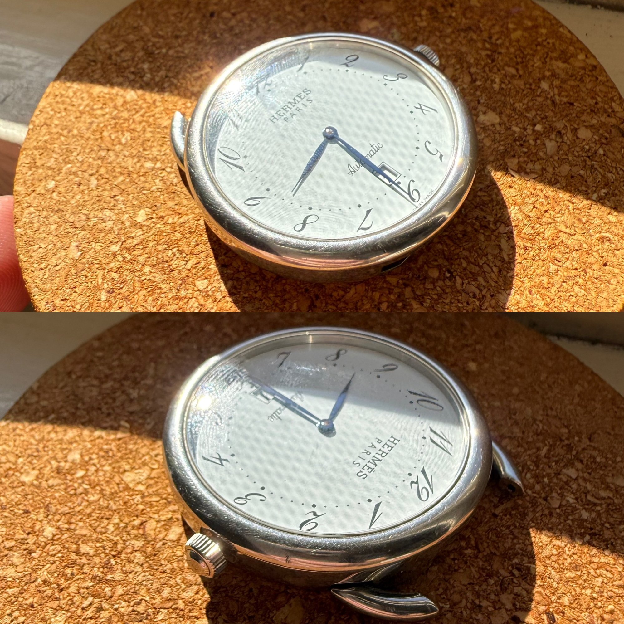

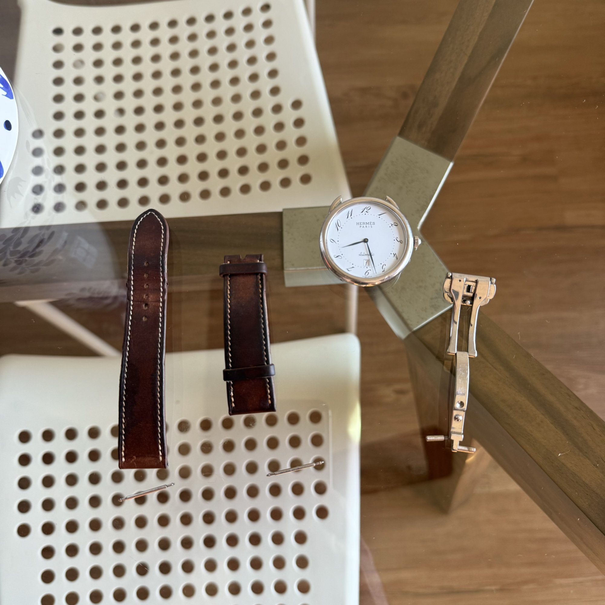

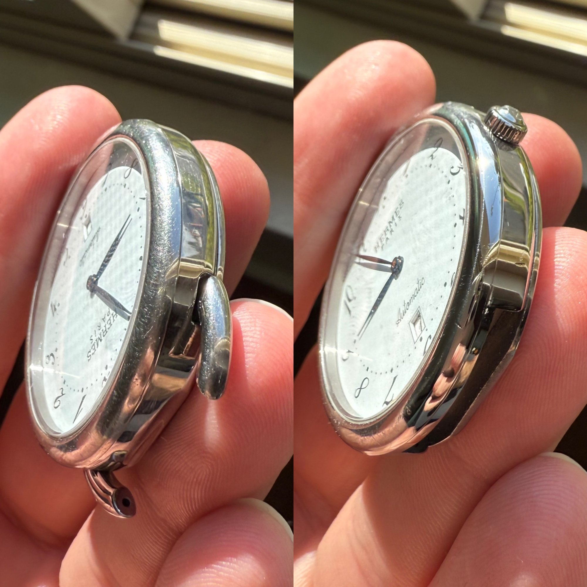

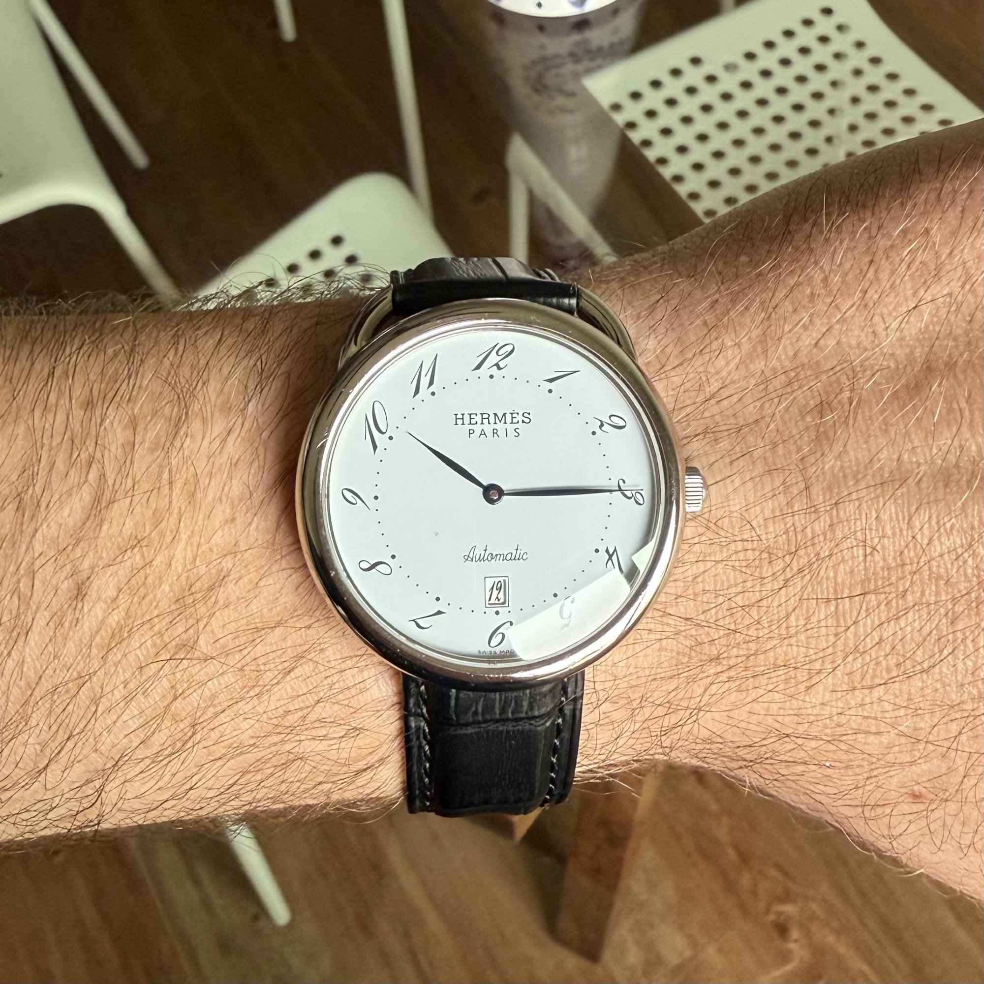

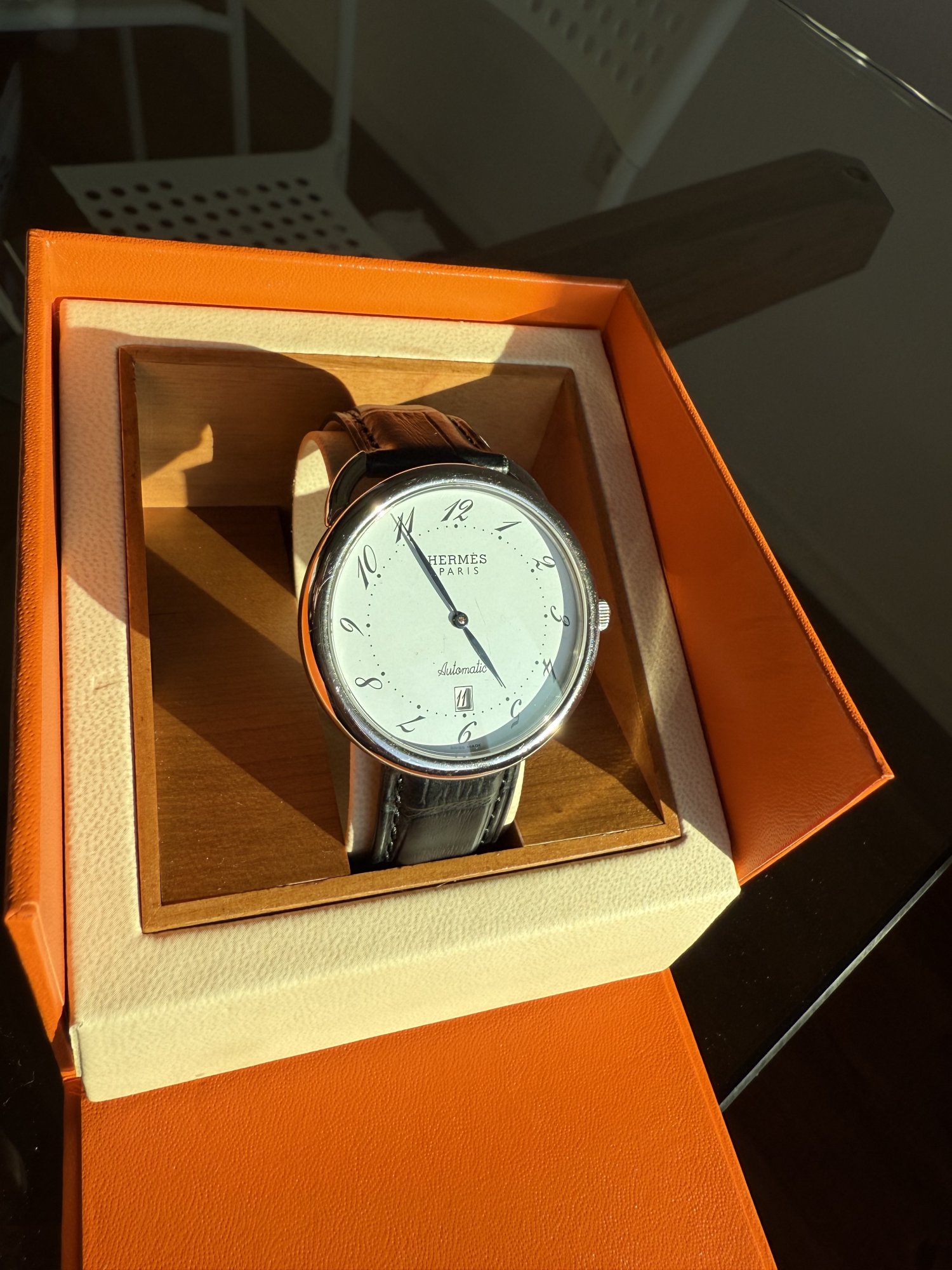

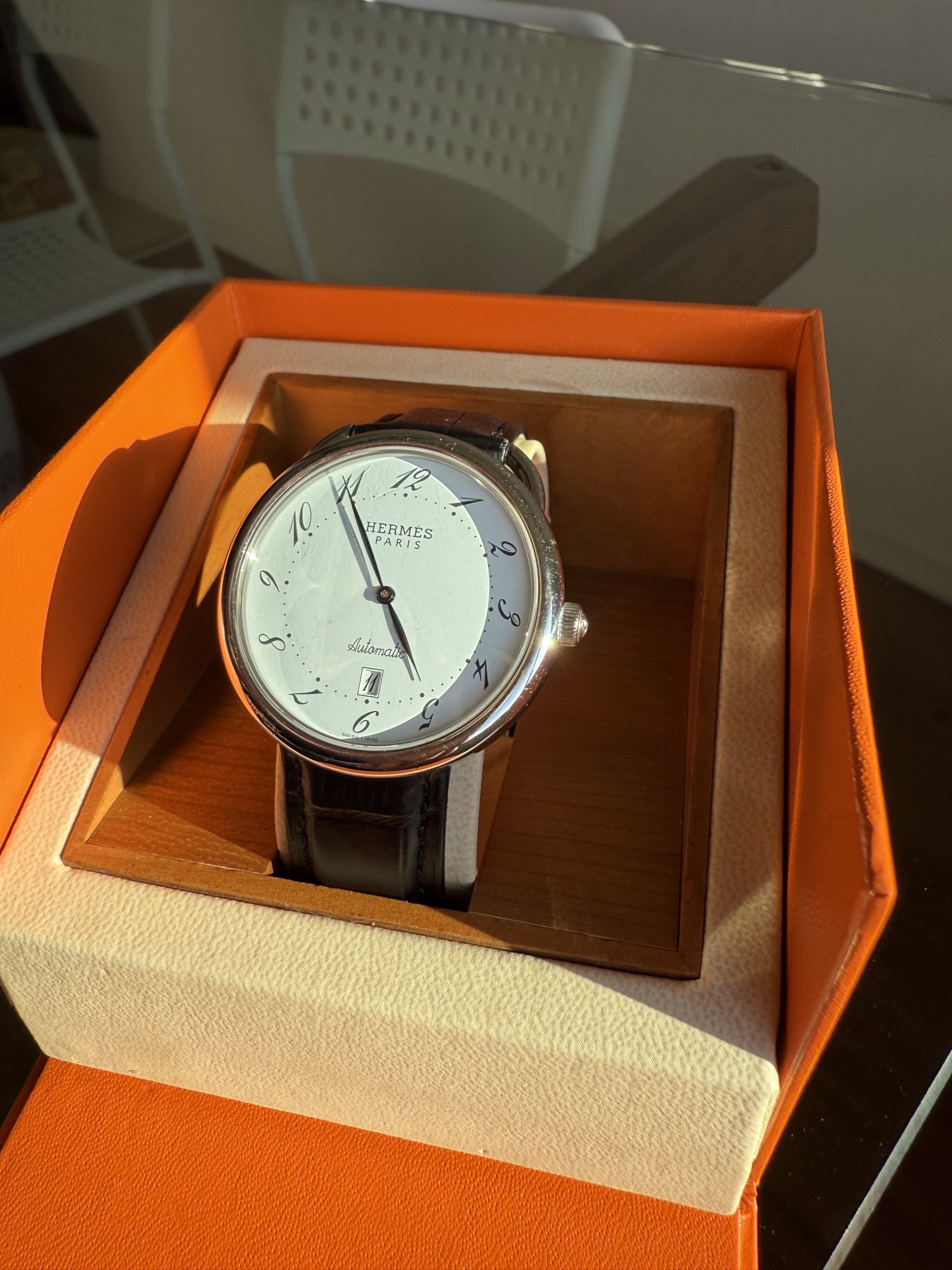

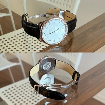

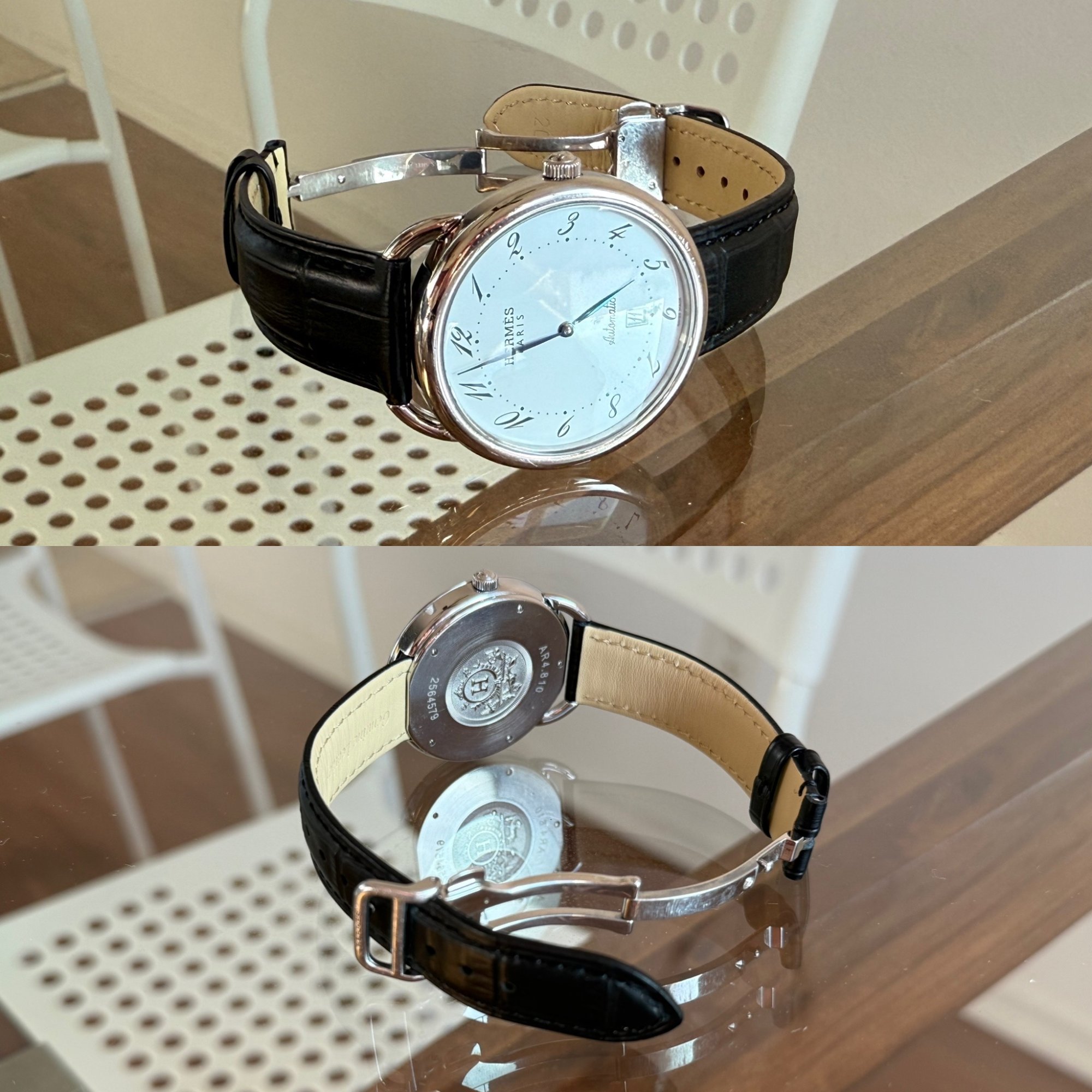

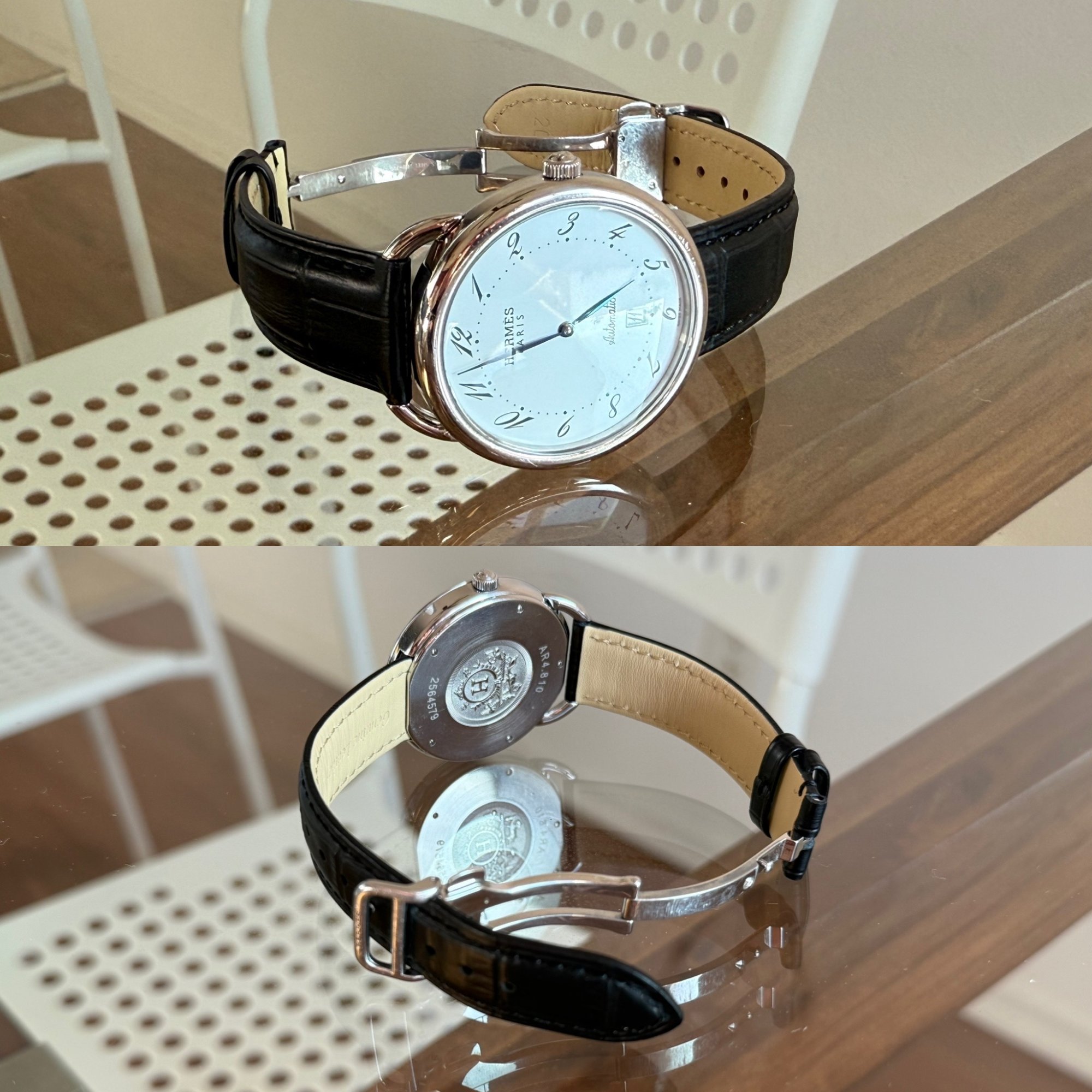

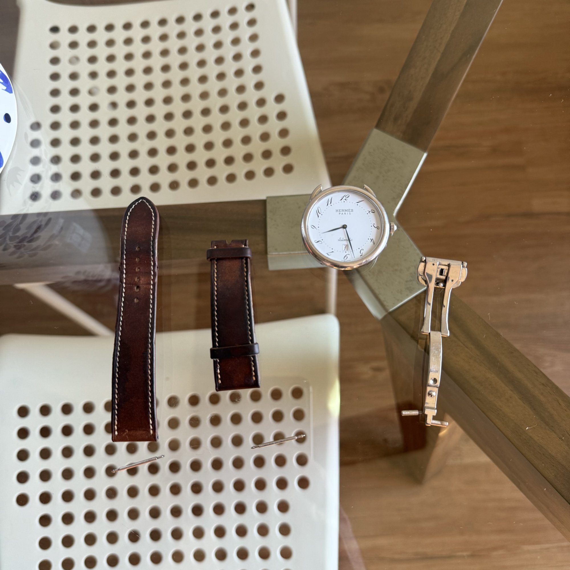

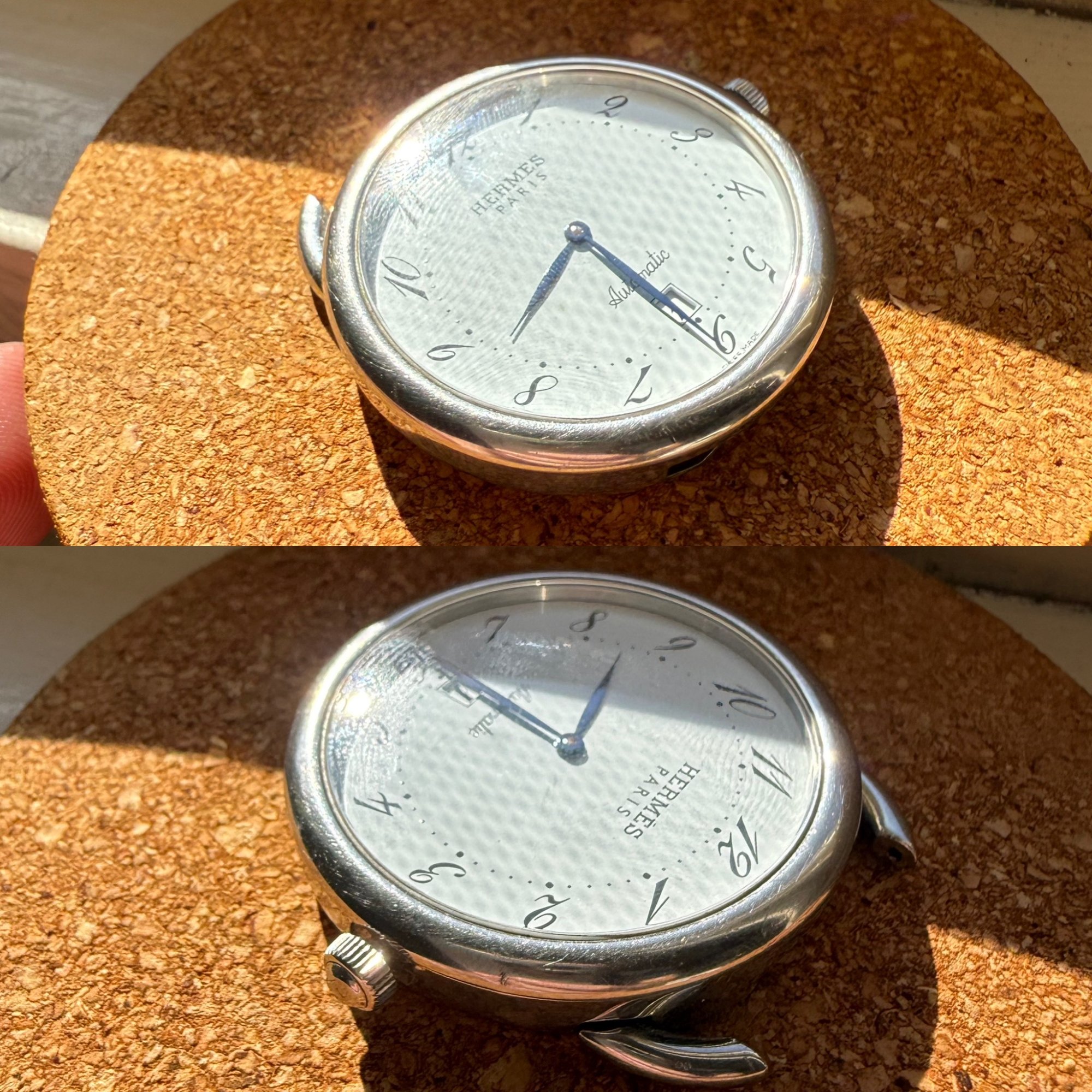

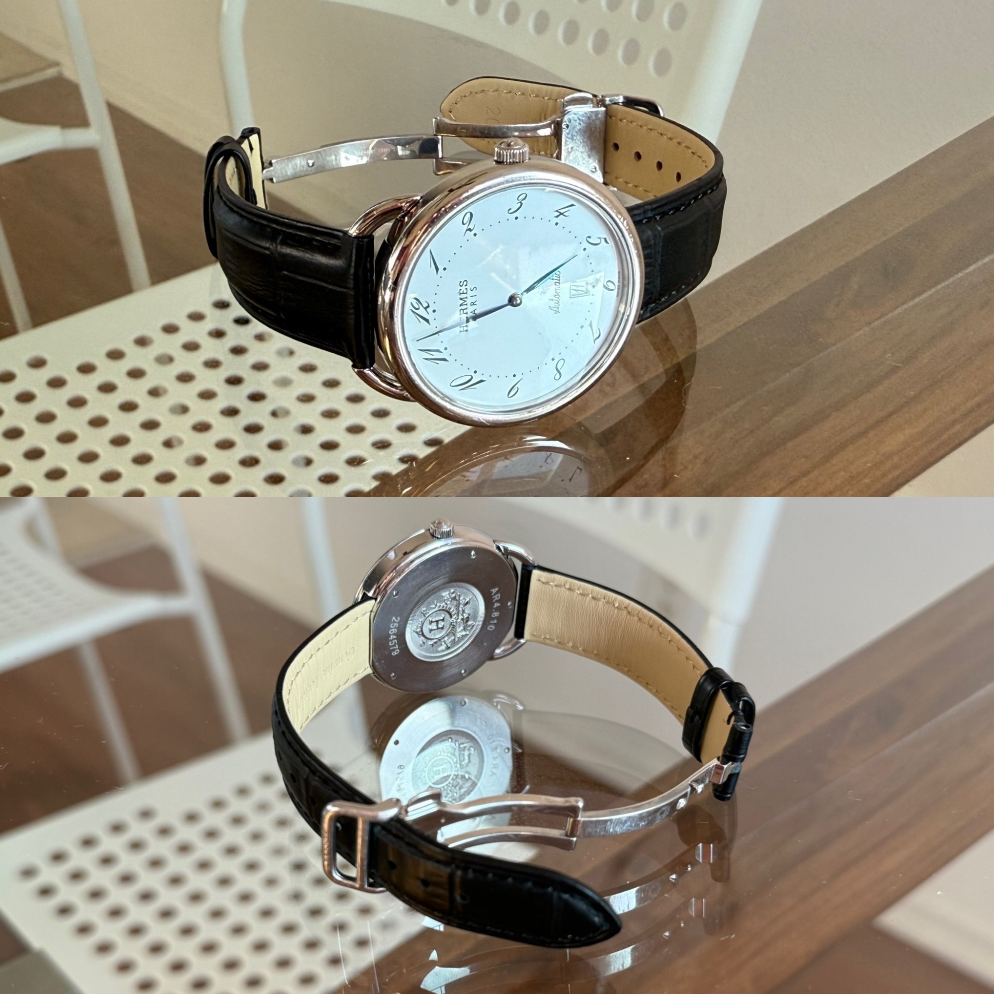

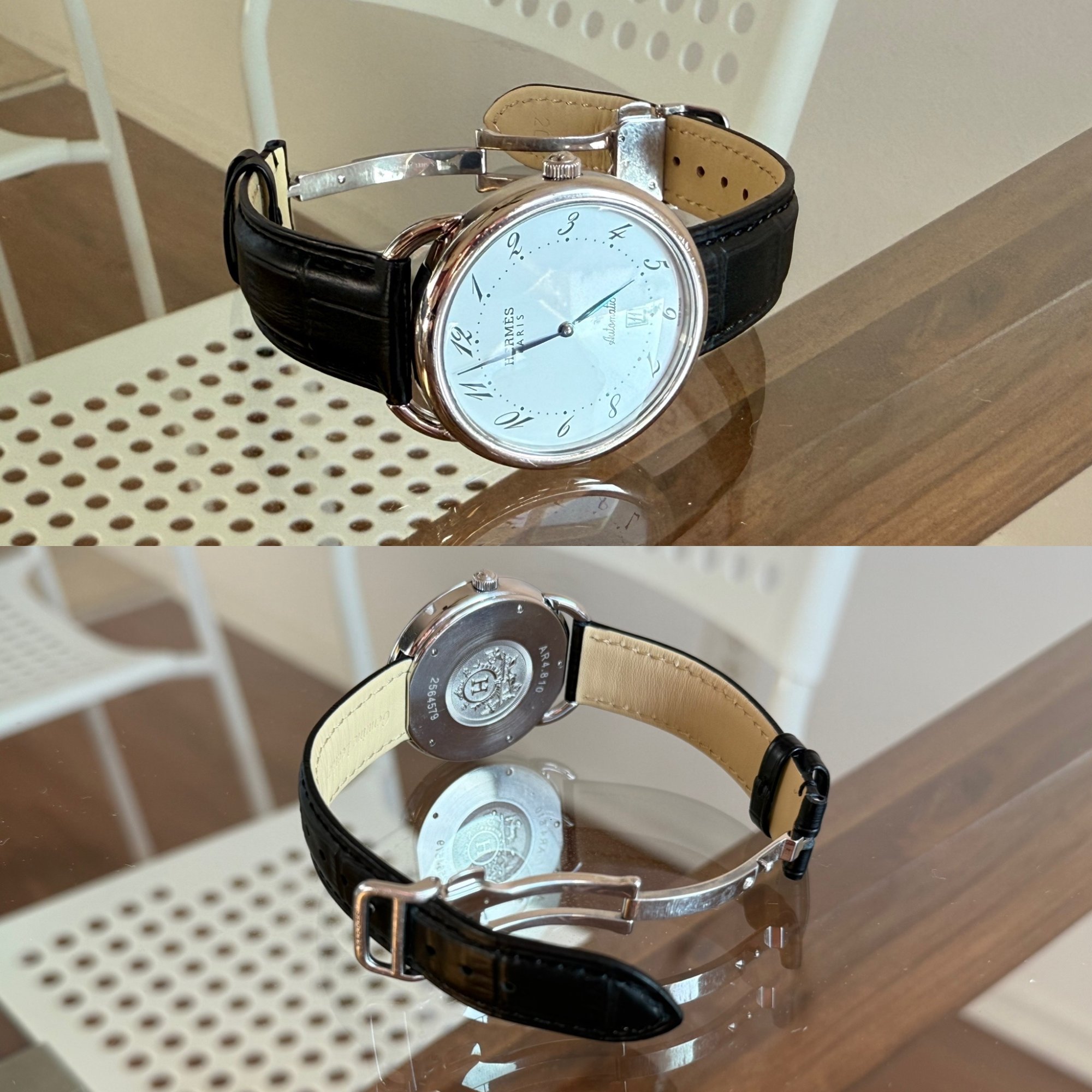

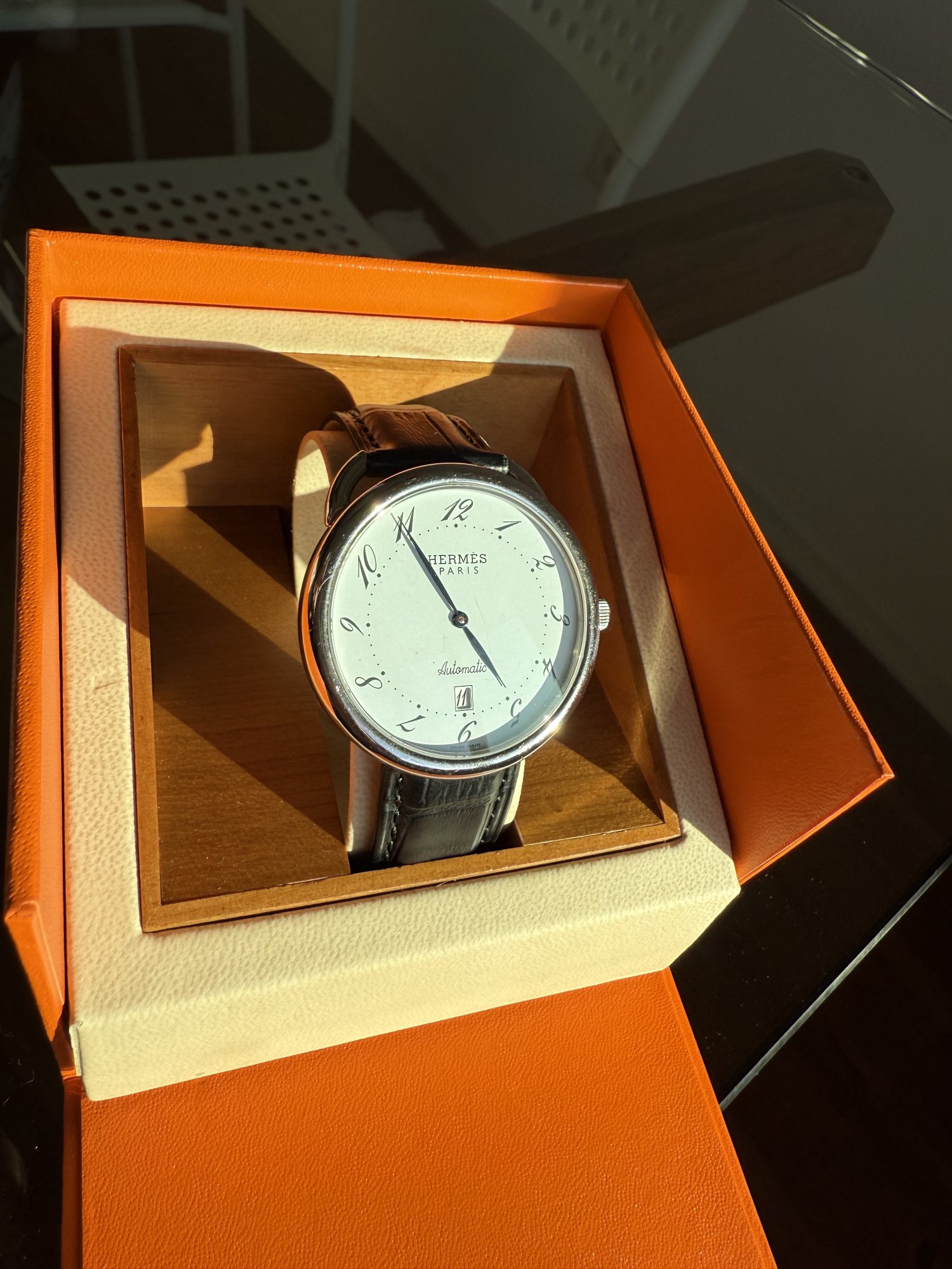

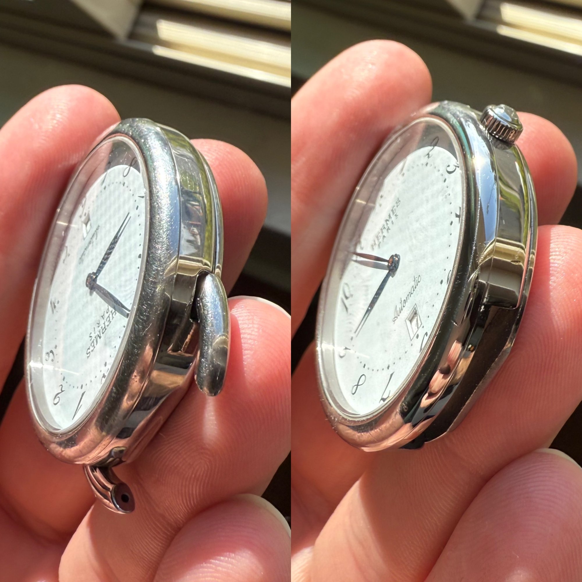

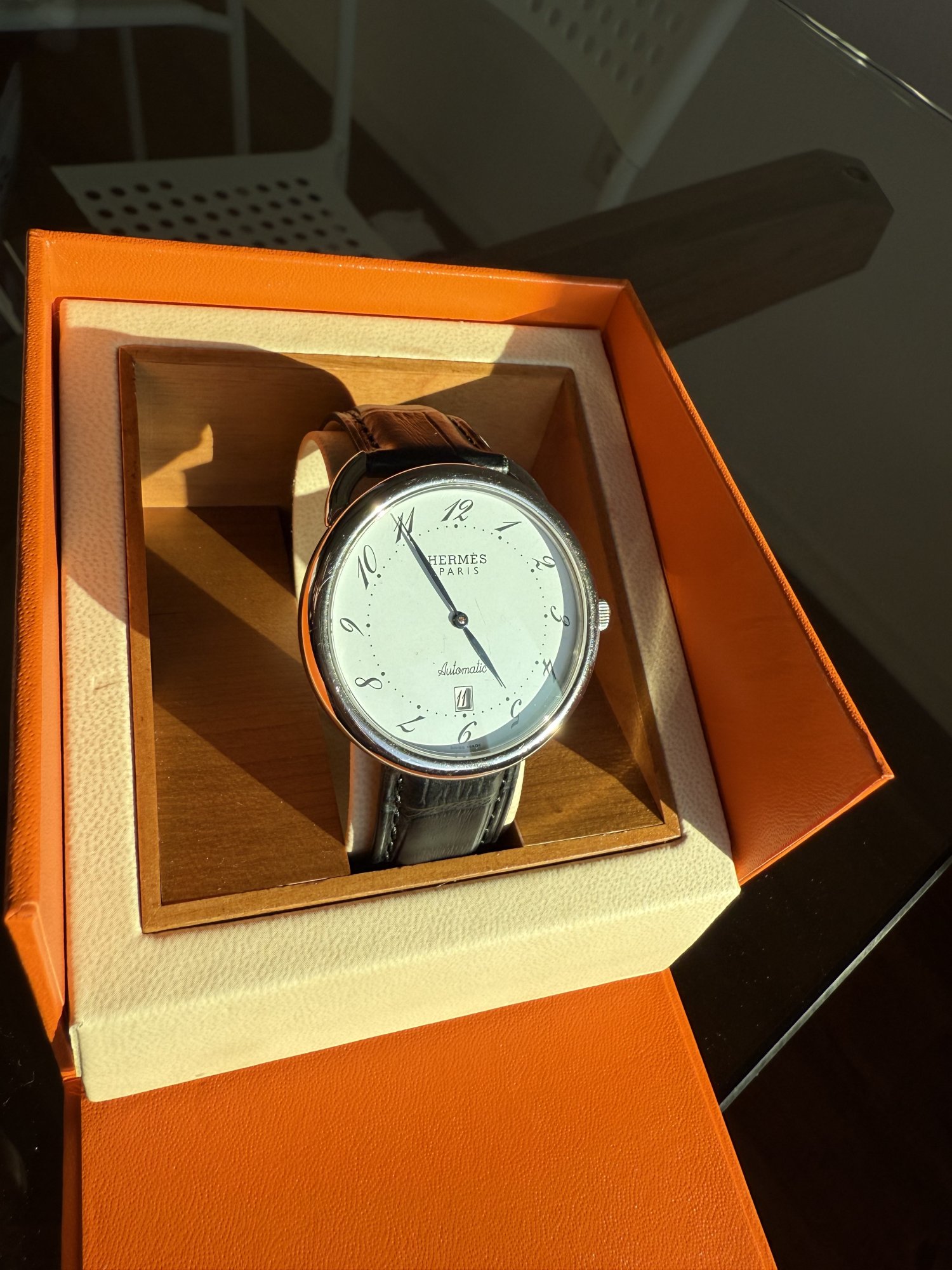

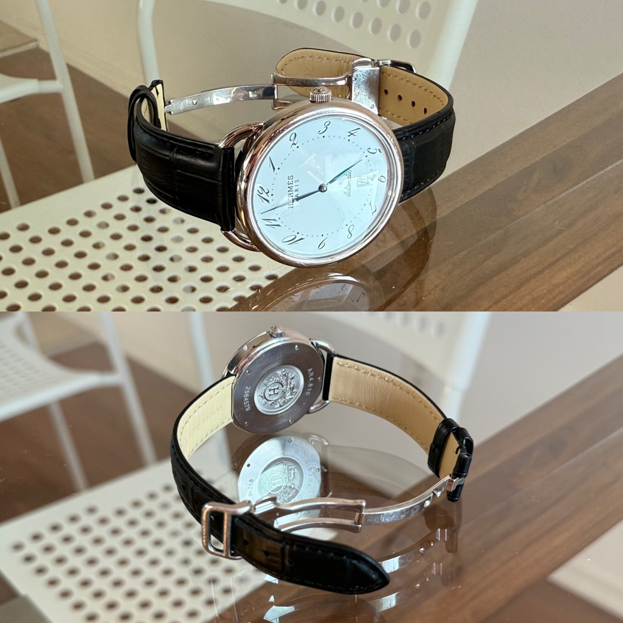

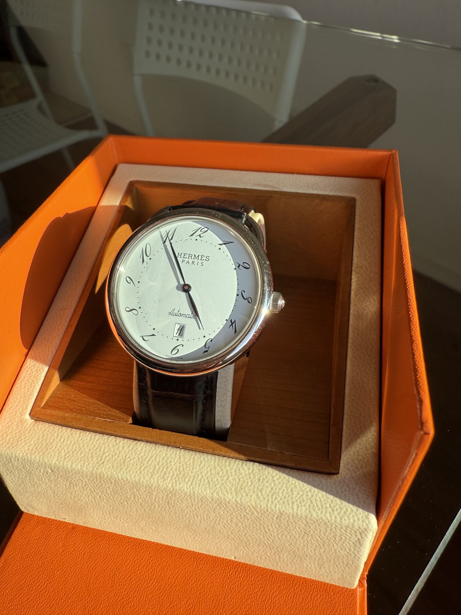

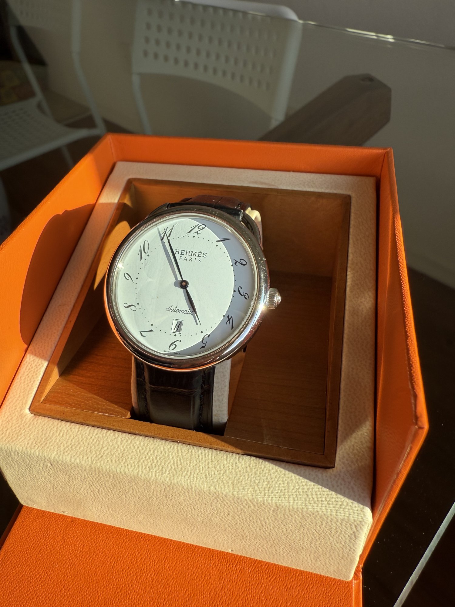

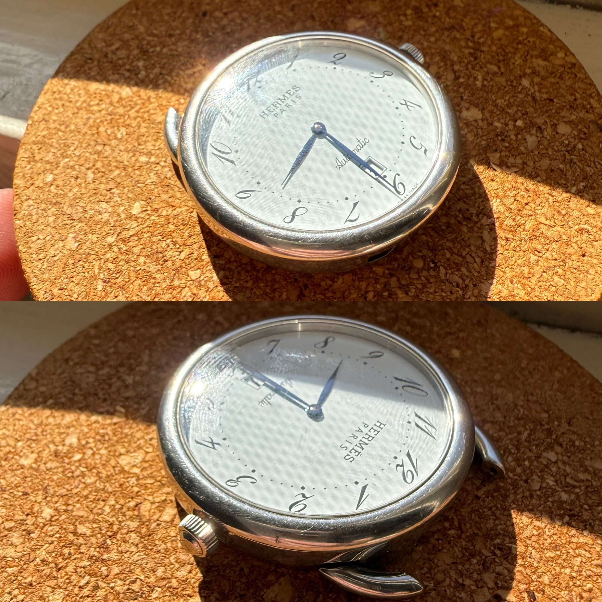

A bit off topic, but I thought you guys might enjoy it anyway. I polished it up the same was I polish my Apple Watch.
First, I sanded the heavily scratched areas with 2,000 grit sandpaper. Many deep scratches were close to the crystal, so I let some character remain.
Then, I used a Dremel on level 2 with felt polishing tips along with Autosol to remove the sanding marks and the majority of wear & tear. Moved onto cape cod cloths, and polished to the final brilliance with a traditional jewelry polishing cloth.
Going to alternate the classic Hermes with the digital Hermes from now on! Also, this is a temporary strap until I decide what to swap onto it.

Wow. I didn't know Apple Hermes bands work with traditional Hermes watches. This is great!
… depending on the size (lug width) of the Mechanical, of course.

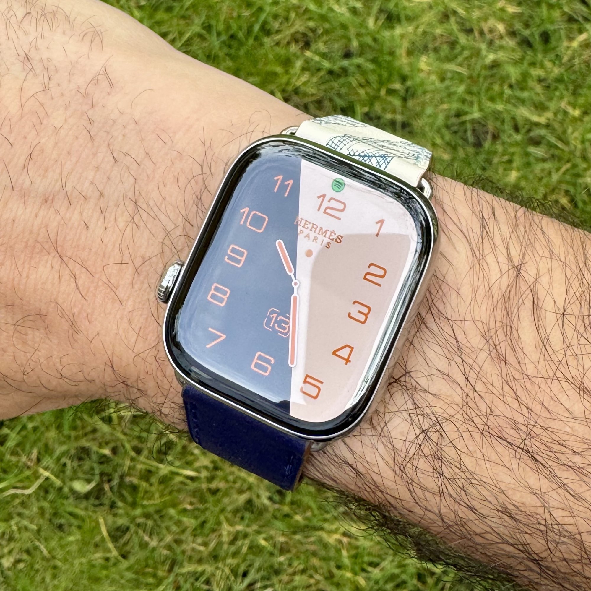

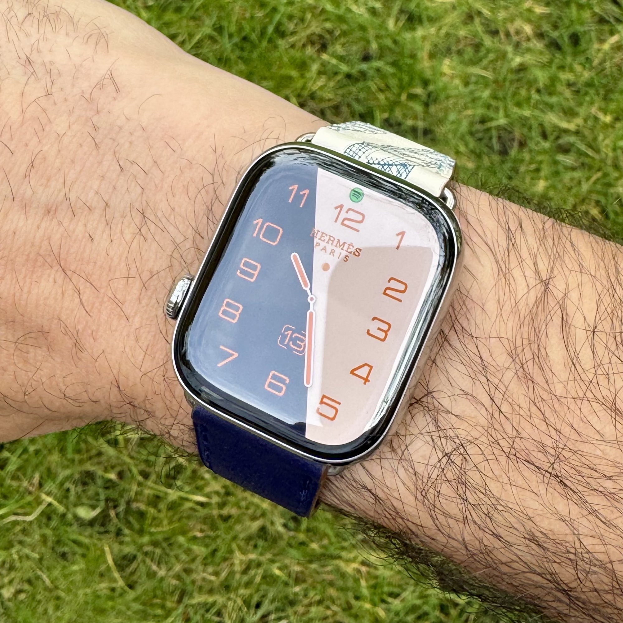

Like the watch face. Is that available on the s10?
This is indeed one of the color combinations, available for the "Hermes" dial. But it looks too bright on that photo due to the reflection on the glass. What I just discovered myself: On a new setup you have to add the colors from previous years manually to get the bi-color dials. If you chose the color, scroll down, and add all the "old" colors at the +-Sign.
