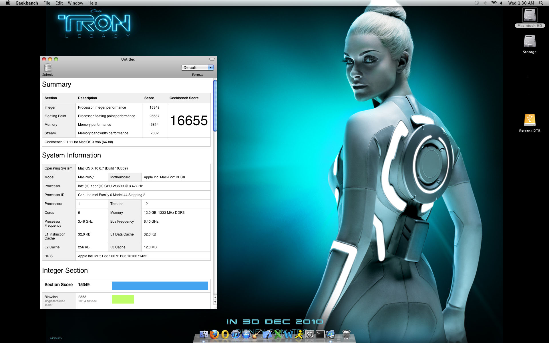

10000 base quad 15500 my hex mod a 55% percent jump.
you will get a score of 16655 with the w3690. a 66% increase
https://forums.macrumors.com/attachment.php?attachmentid=278853&d=1301474509
