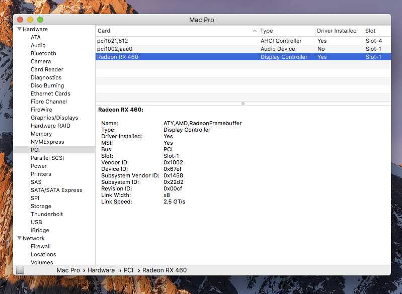

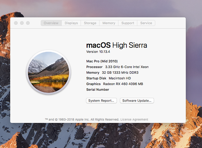

Great News! Sleep is back and working in the latest MacOS 10.13.4 update!!!!
Also, "About this Mac" now correctly shows GPU model as "Radeon RX 460...."
And, in System Report... PCI information now shows PCI devices without showing an error message when a non-EFI GPU is installed...
Great job, Tim!
