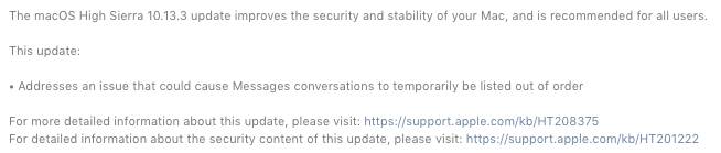

Although, I'm sure there are some who are not disappointed about their messages being listed in order, now.

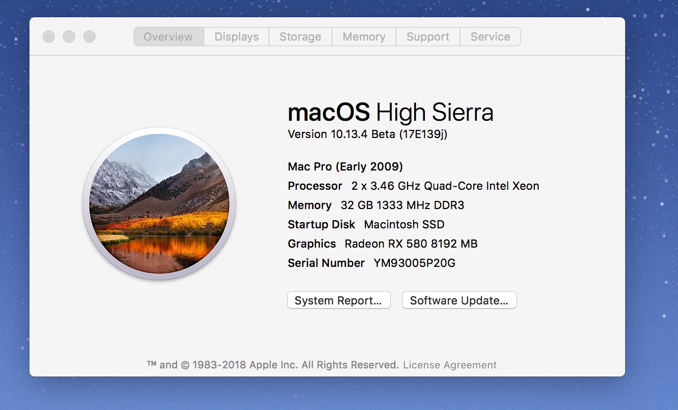

I tired changing the port numbers in the 10.13.3 9500 kext plist file, this had previously fixed the sleep issue for me in 10.3.2 and the supplemental update, unfortunately it didn't work for me this time.
I updated to 10.13.4 Beta 1. Sleep is working perfectly again without any kext/plist edits. My mac is also reporting my graphics card as an Rx 580. All is right with the world again.

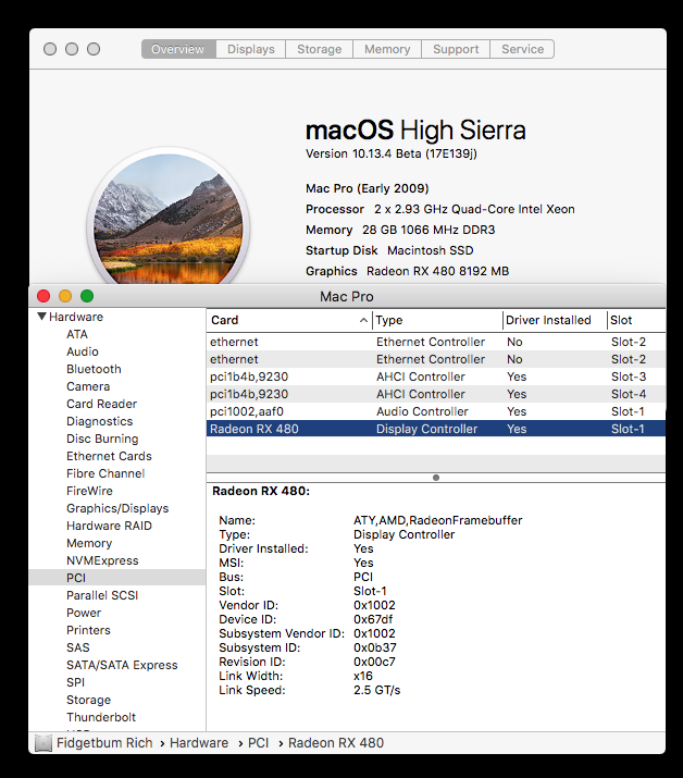

On 10.13.4 my Sapphire RX480 8GB is correctly identified and audio output is working.
How about 'Non Sapphire' RX580 GPUs? Do they get identified correctly after the 10.13.4 update? I have a MSI RX580 8G (Reference gpu) in my cMP and waiting for this issue to get solved before HighSierra upgrade.
It works for all RX 580's I belive. I have a MSI RX 580 GamingX in mine.
