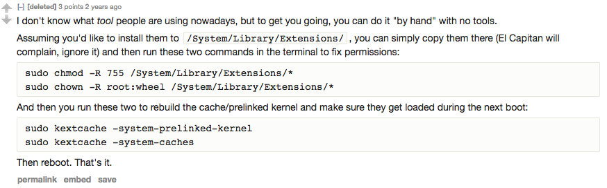

Ok. I'd like to learn how to manually set the kext permission correctly. This way I'd learn something instead of having an app do it for me. But, it is confusing as hell and I can see why an app, like, Kext Utiiity is handy. But, I'm not giving up, yet. Does the commands below ring any bell?
Do you think the above screenshot are the steps to manually set the kext permission on terminal?
That looks correct to me.
CoOl! AlRigHt! iT wORkEd!!!
Those manual terminal commands did the trick for my RX460 after changing the CFG_FB_LIMIT to "3" for my particular card.
Sleep works, again! And, seems to be fully-working.

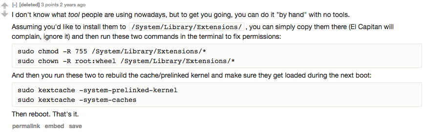

UPDATE:
I re-enabled SIP and I am back to square one.
I guess you have to disable SIP for it to keep working, huh?
That's expected. And this is why I asked in post #58
https://forums.macrumors.com/threads/high-sierra-10-13-2-broke-sleep.2093595/page-3#post-25598654
When SIP enabled, any unsigned kext will not be loaded. Once you modded a kext, it's no longer signed by Apple, therefore, the kext should not be loaded. AFAIK there is a command to only disable the SIP kext signature check, but I personally never use it, and I don't really care, I always keep my SIP OFF. Up to this moment, SIP didn't really protect me from anything. All it does is just preventing me to mod my Mac (make it work better, like what you are doing now).
Reactions: foliovision
