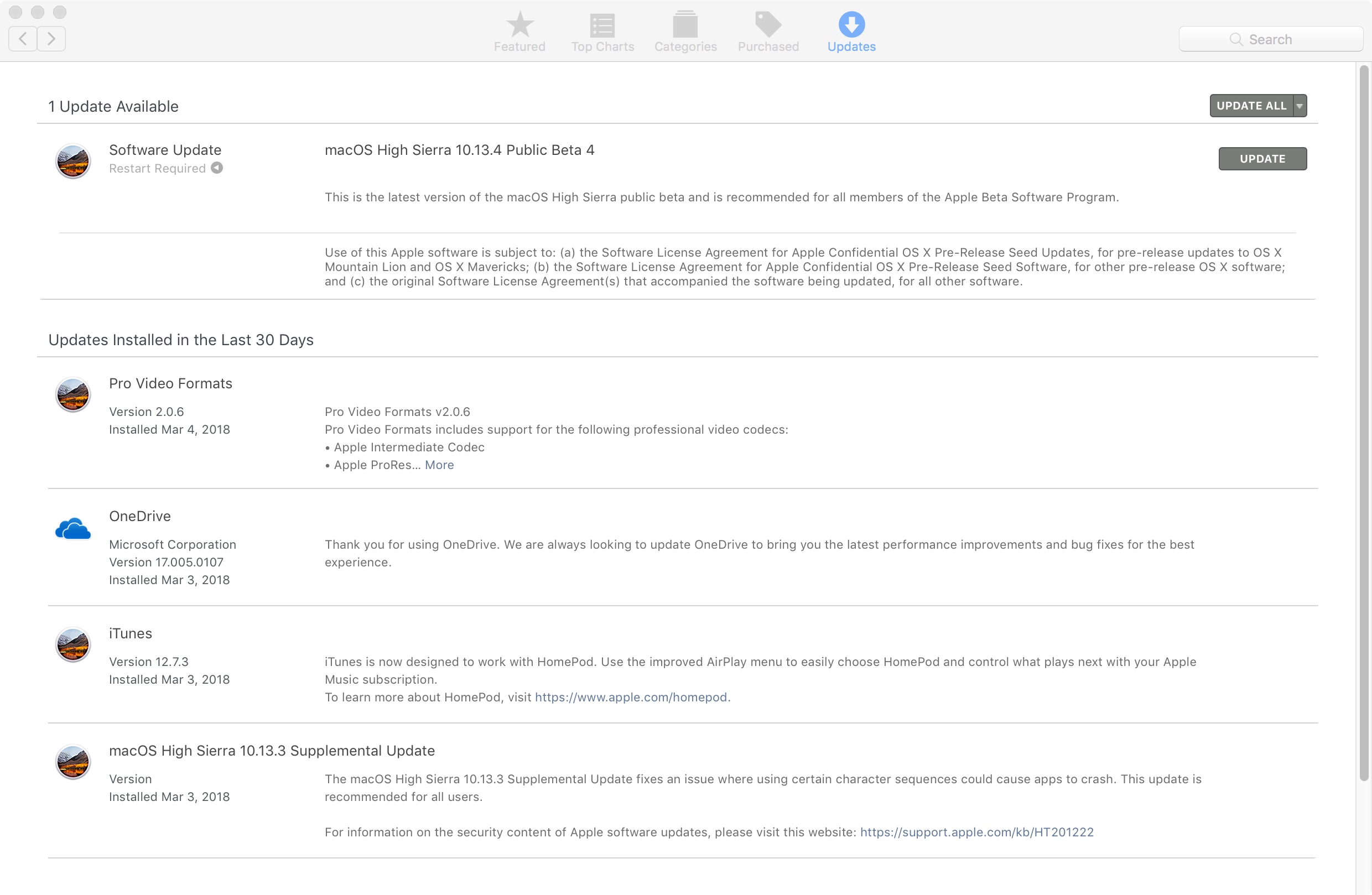

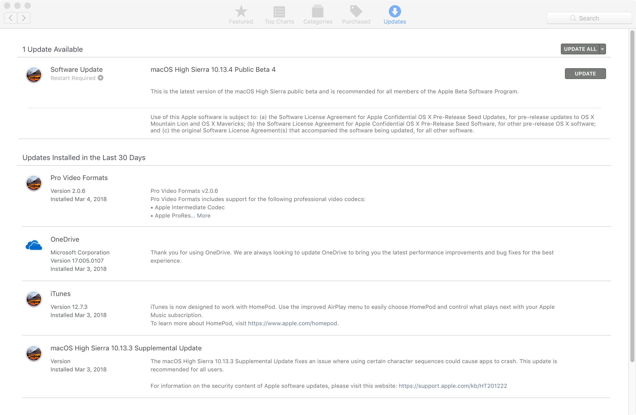

That’s definitely the supplemental update version. I’m guessing you’re right in assuming that update is causing this.
From everything I’ve read, looks like I was wrong in assuming the supplemental update would be included in the recovery when I reinstalled 10.13.3.
You could try to reinstall 10.13.3, don’t install the supplemental update, then install the beta utility and hopefully that will trigger the beta to show up.
Confirmed. Reinstalled 10.3.3 w/o the supplemental update and PB3 is installing as we speak.
Avoided the first few Beta's and went in on .4 and it has transformed 10.3 from a buggy thing to a slick running thing.
Night and day difference for me. Pleasant surprise.
Same here and it seems a bug to me since 10.13.3su is build 17D102 and 10.13.4 PB3 is 17E150g.
I've reported it to Apple with the Feedback app.

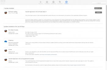

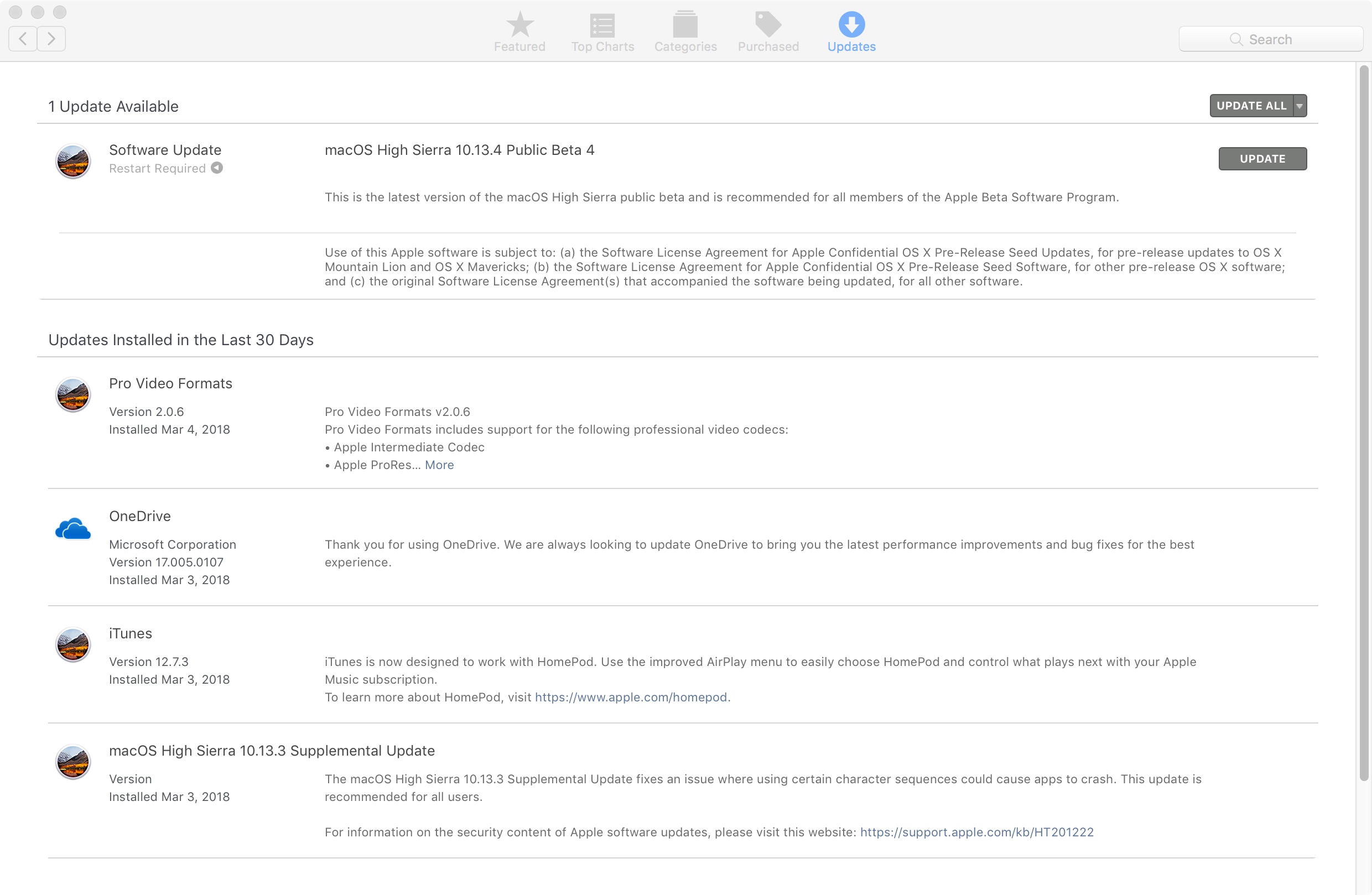

Save your time and efforts, 10.13.3. SU is not the cause of the problem as you see in the image.

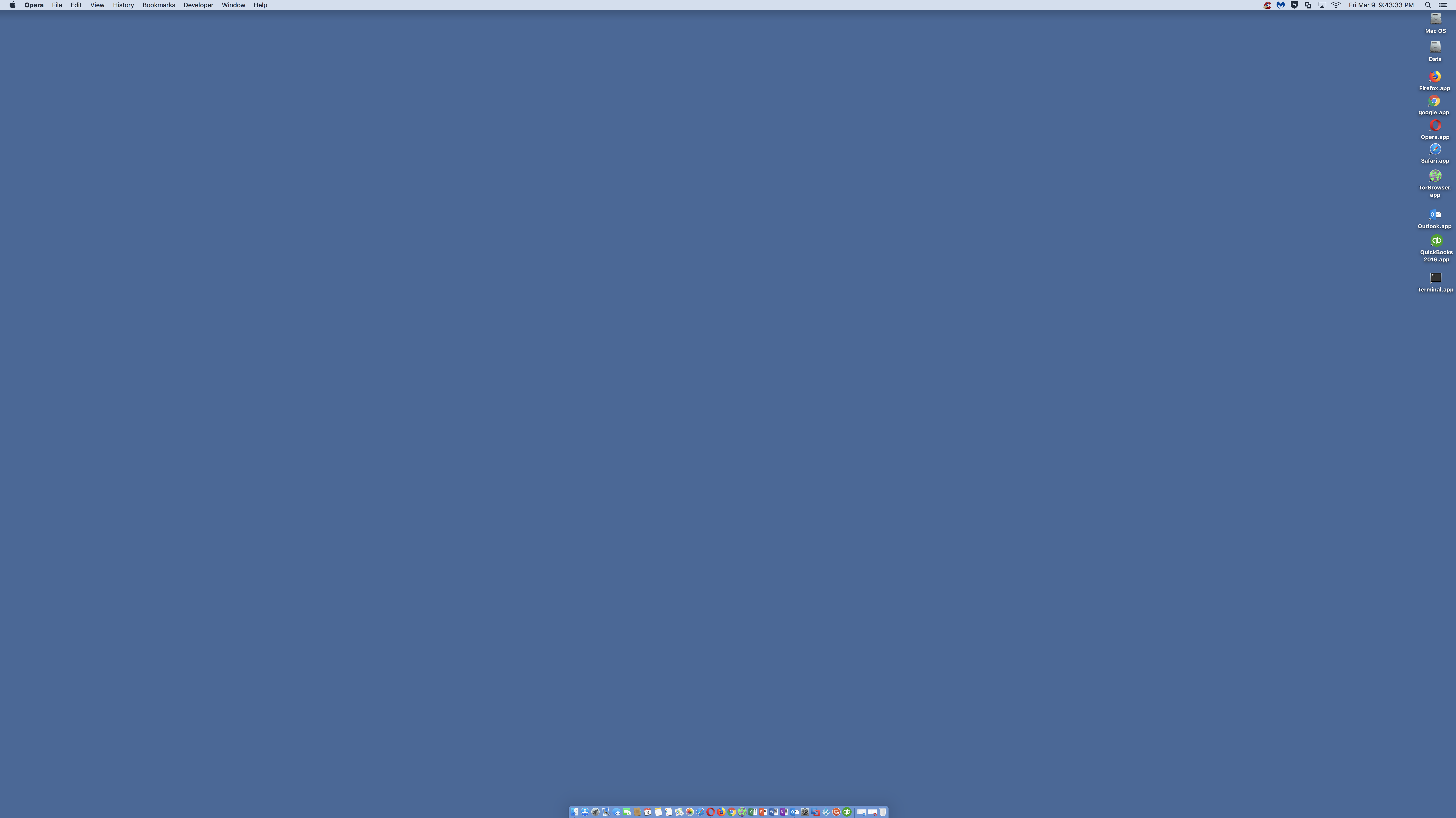

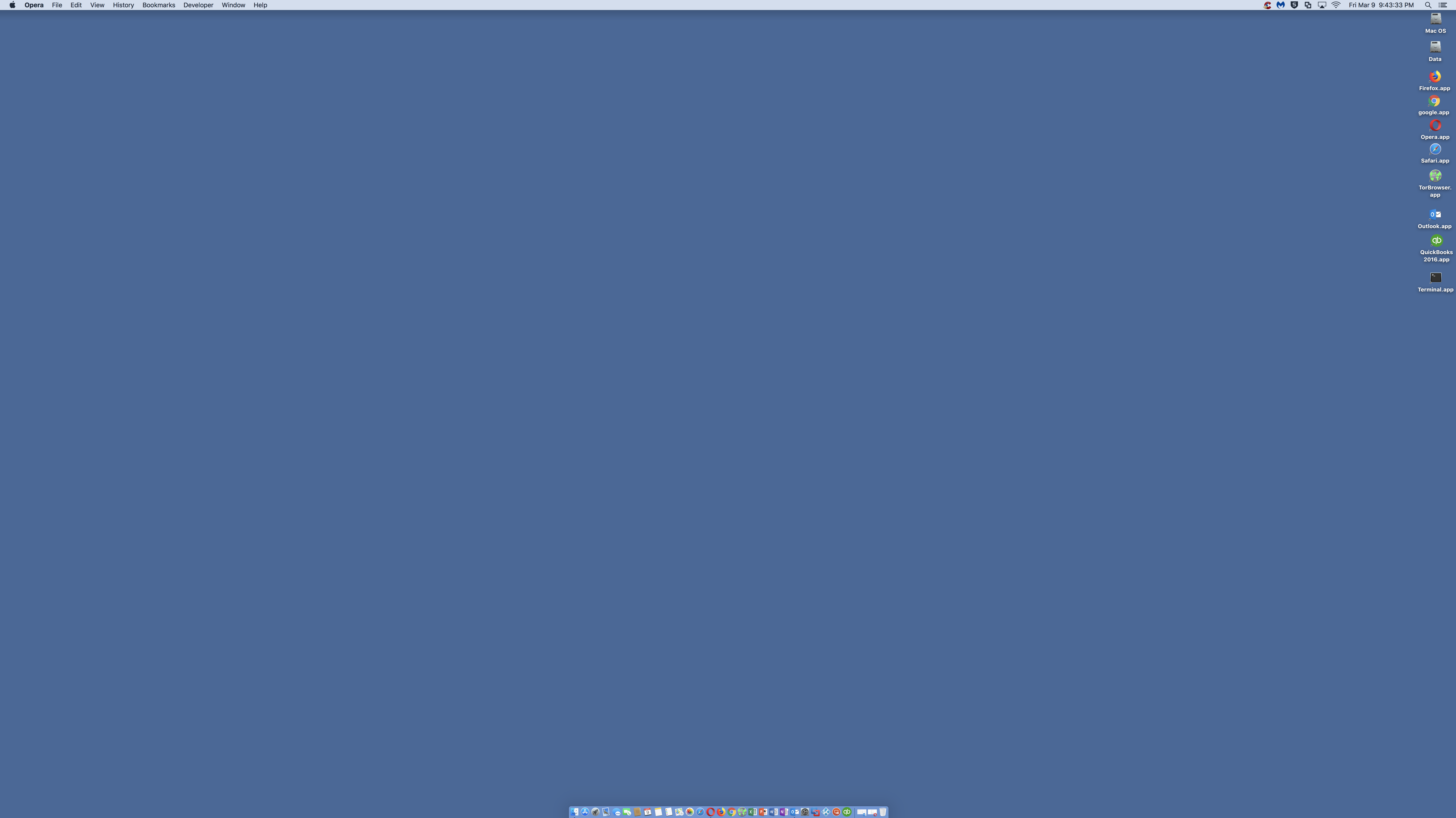

so i need help, I been having this issue since Beta 2 installed, my preference for desktop Icons do not stick, if i made my icons small and also enable the hard drive icons to be displayed on the desktop, after restart the ICONS are crazy big and my hard drive icons dis appear and i have to reconfigure them? Can someone help me maybe edit some config file or delete .plist file and fix this issue? anyone else having this issue? maybe its just my machine or something?but i cant stand it anymore, every damn reboot icons need to be redone and setup the way i like it....
How it should be and then it defaults back to default, so its some settings file thats corrupt probably.!
