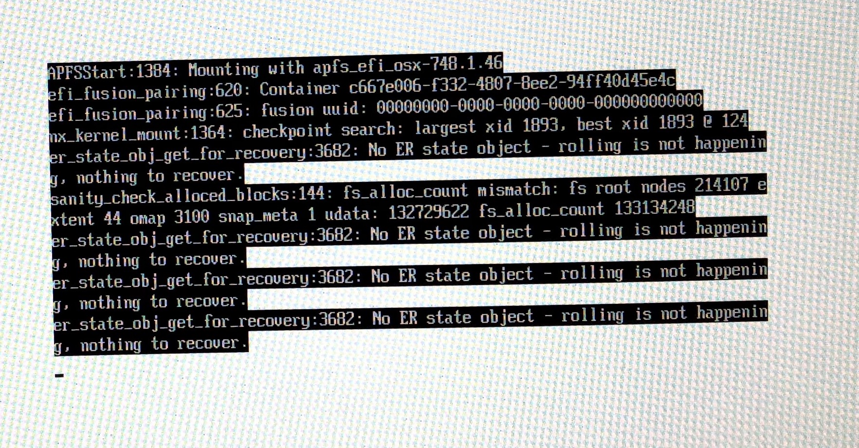

I do see a block of text at the boot screen which appears to include something about APFS, it goes by really quick

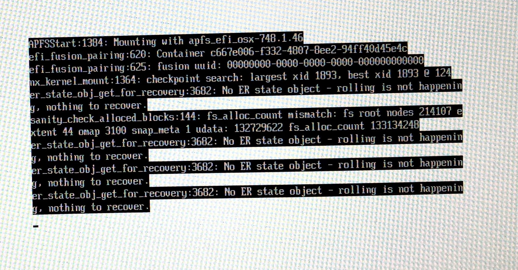

Managed to snap a pick...
I am seeing that block of text as well on a 4,1->5,1 with a MVC-flashed 980. Did some googling to no avail. Ran disk first aid, no change. It appears if I boot from the HS drive, or if I hold Option/boot or boot into recovery mode.
WARNING: I attempted to zap PRAM and the machine got stuck in a boot loop when attempting to boot from that drive, even in safe mode. I reformatted the drive (EVO 950) back to Extended instead of APFS and am rolling back to 10.12.6 for the time being. The text was gone when I booted from the 10.12.6 backup.
Reactions: dabotsonline
Seeing the same text snippets here on boot and right before the apple appears... had the same with 10.12 once running filevault (different text)... anyone knows more?
