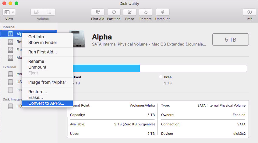

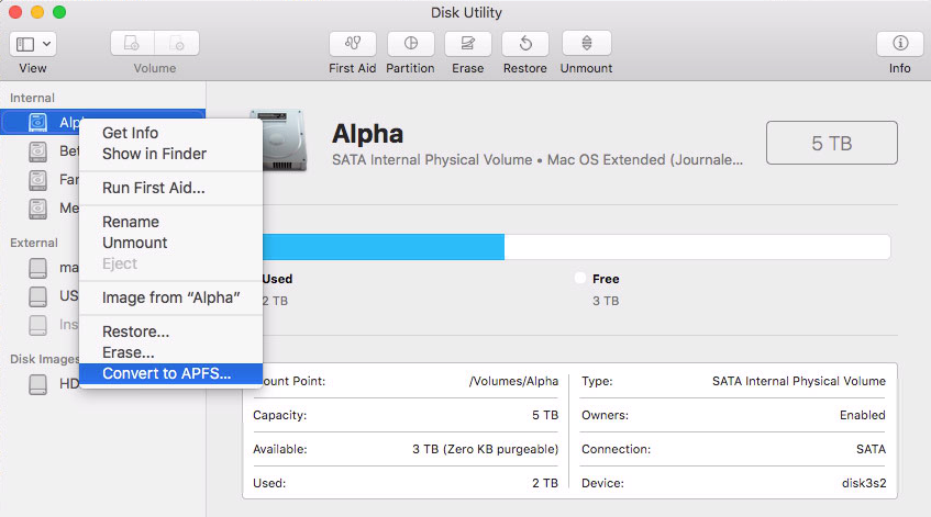

Poking around in Disk Utility, I see I have the option to convert my spinning disks to APFS. Has anyone tried this yet? Is this something worth doing?
Reactions: dabotsonline
Yeah, I still have a Mac Edition 680 I swapped in for the upgrade.
As an update for people who find themselves in the same position (installing fresh from USB, firmware update ‘shut down’ button does nothing) the fix seems to be running the installer from an existing macOS installation. Once the firmware update has run, a USB clean install should work as expected.
Definitely worth doing.
I believe the reason Apple didn’t do this automatically during the OS upgrade is because it takes so long to do.
People’s upgrades with multiple non-SSD disks would have taken hours and hours to complete.
There’s nothing stopping you setting the time aside and doing the upgrade manually however.
Yeah im a little lost, what benefit would putting APFS on spinners be?
There are a few benefits granted to SSDs running a more modern file system like APFS, but the majority of features APFS provides are benefitical independent of the type of media your boot volume resides on.
