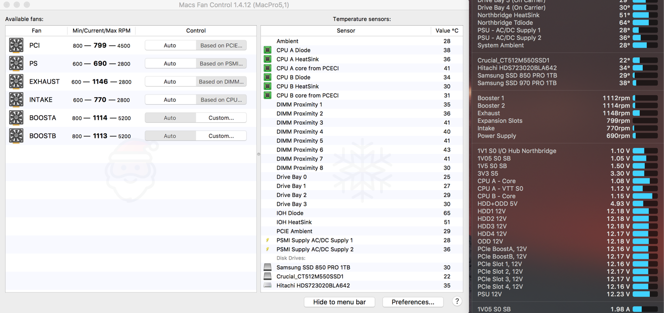

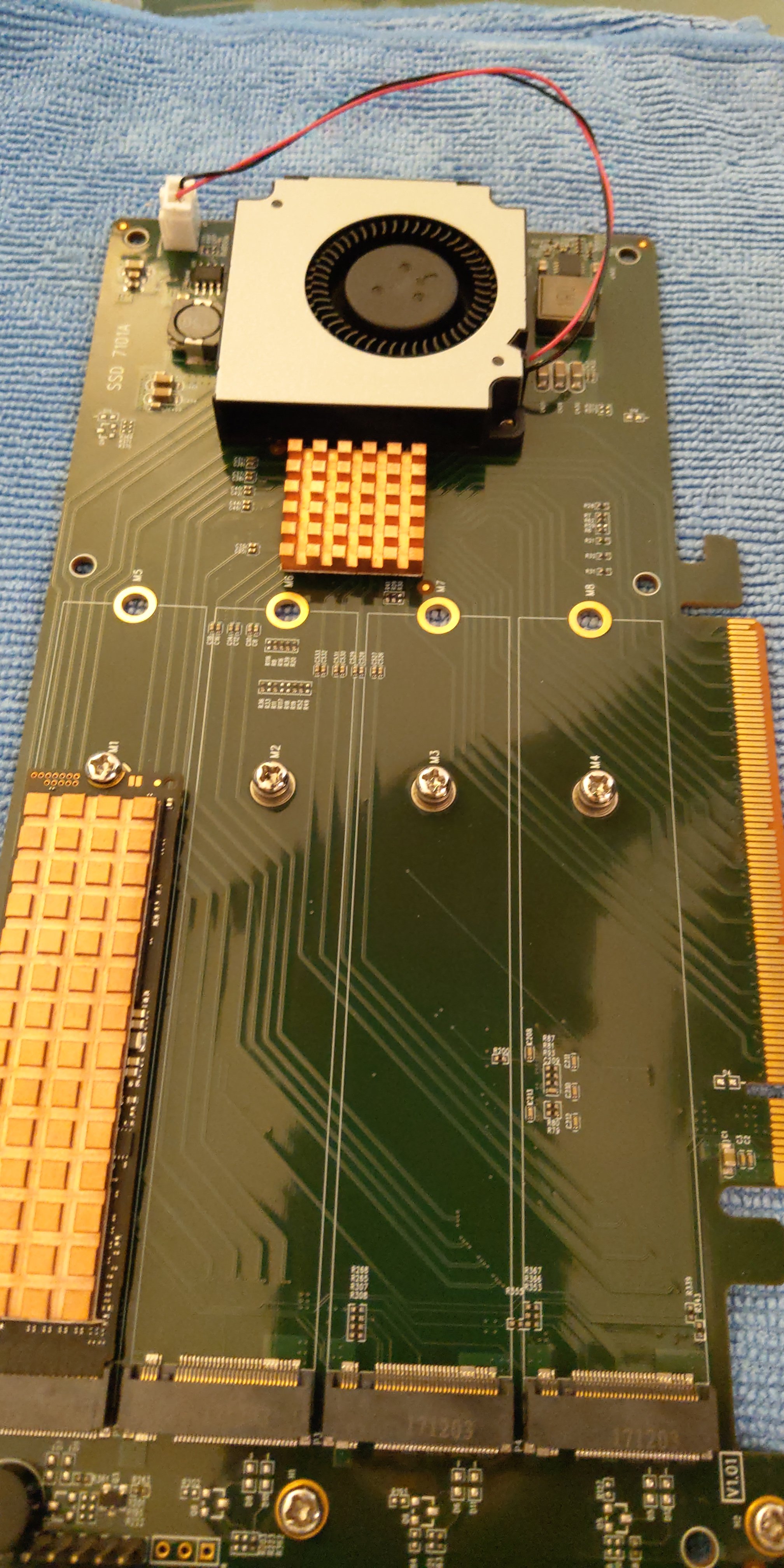

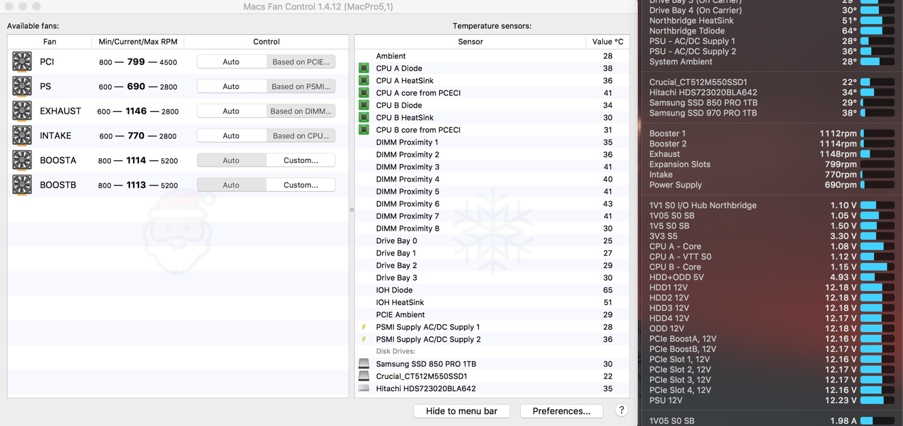

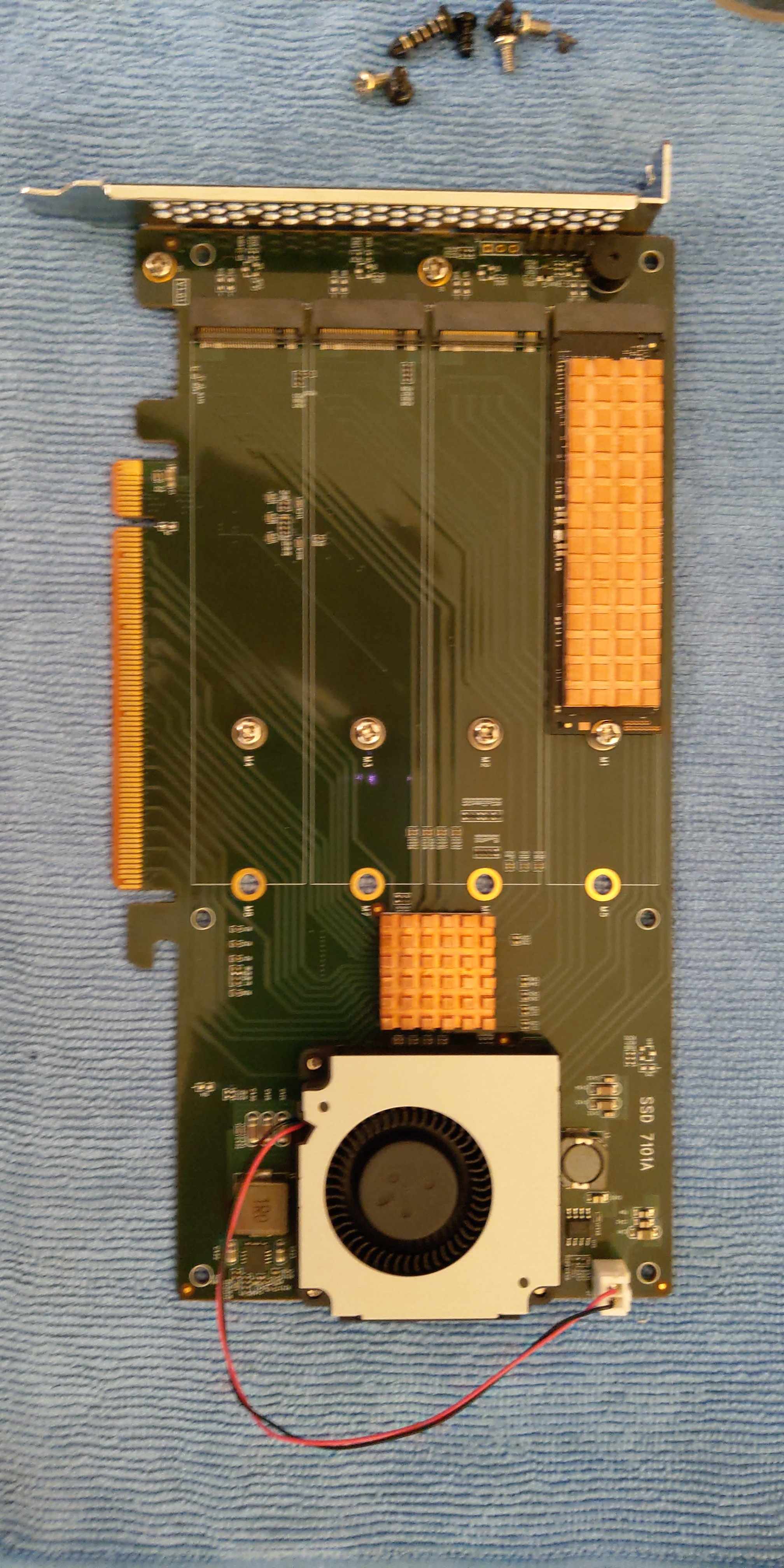

The replacement fan was delivered this morning - BFB0512HA-C @ 32.5 dBA ordered directly from Digi-Key ... BFB0512MA-C @ 28 dBA is on backorder but is expected this week and I am getting that too.
After wiring the 2-pin power plug and replacing the small heatsink I had installed earlier with a 22mmx22mmx4mm pure copper heatsink for better heat dissipation, PCIe ambient and NVMe drive temps have dropped by 8 degrees celcius under heavy write load and at a higher room ambient temp!! Fan sound is acceptable and on par with the system fans in comparison to the card's noisy factory fan =)
Previous results without fan but with small heatsink
PCIe ambient @ 33~34C and NVMe drive @ 38C peaking at 46C under heavy writes with the PCIe fan spinning at 1000rpm and room ambient temp at 25C
Current results with new fan and heatsink
PCIe ambient @ 29C and NVMe drive @ 36~38C peaking at 41C under heavy write with the PCIe fan spinning at 800rpm and room ambient temp at 28C
and finally some photos
View attachment 812584 View attachment 812586
Happy Holidays!
Edit: corrected Digi-key link
Update: Shifted the NVMe drive from slot 1 to slot 2 so it's in the path of the airflow which resulted in a drop in drive temperatures to 33~34C under normal use and 38C under heavy writes. I recommend slots 2 and 3 for optimal drive cooling. Updated post to reflect new temperature ranges.
Question for you: With the Highpoint SSD7101A installed in your classic Mac Pro, what RPM speed do your PCI and PSU fans spin at without the use of Macs Fan Control?
