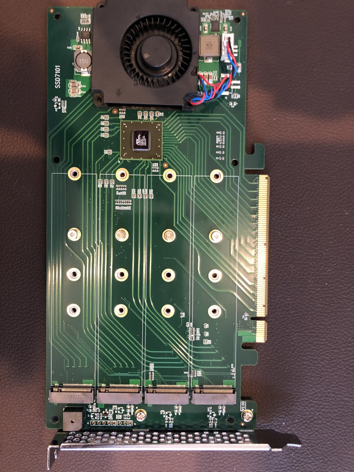

Thanks for the tip! I've ordered it for both my my 7101's!
Installing the replacement Delta Fan from DigiKey was a easy and it completely eliminates the whine generated by OEM fan. I hacked it in within 5 minutes using a pair of scissors, a lighter, some tape and a screwdriver and will clean up the install with heat shrink tubing over the weekend.
Thanks again for the tip.
While this is not a silent solution, the fan easily blends into the ambiance created by the MacPro's internal fans. Additional heat from the reduced airflow is more than worth the benefit of addressing an obvious oversight in the original design.

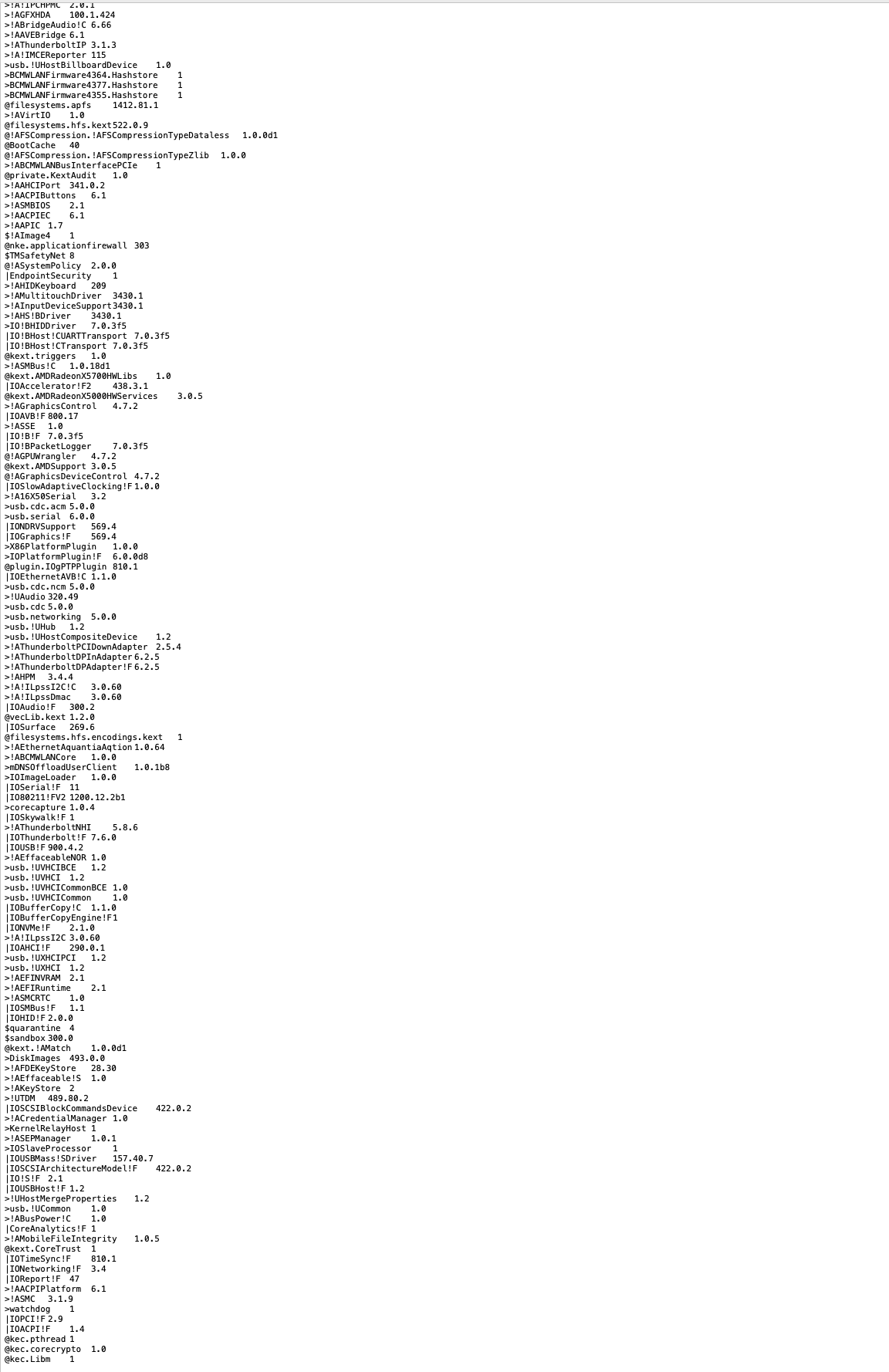

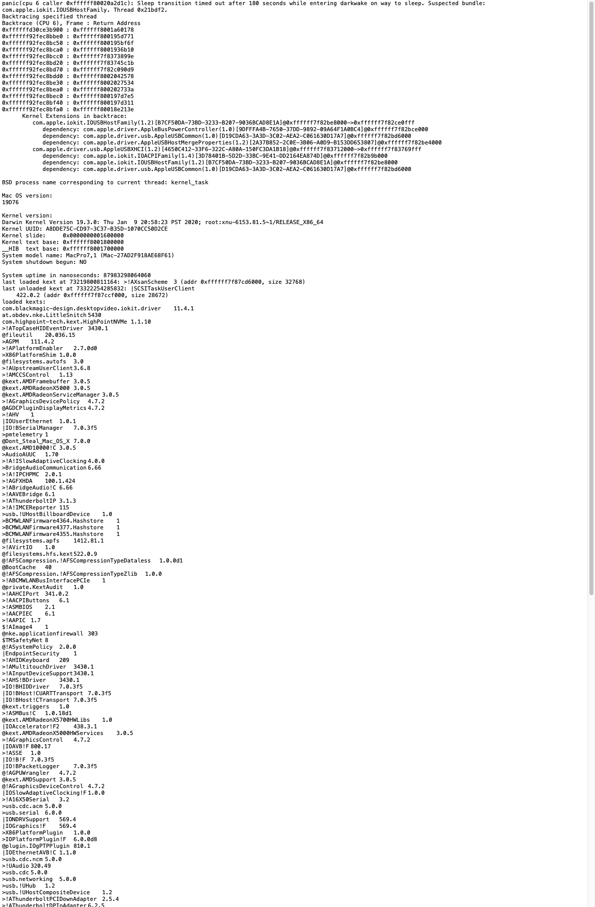

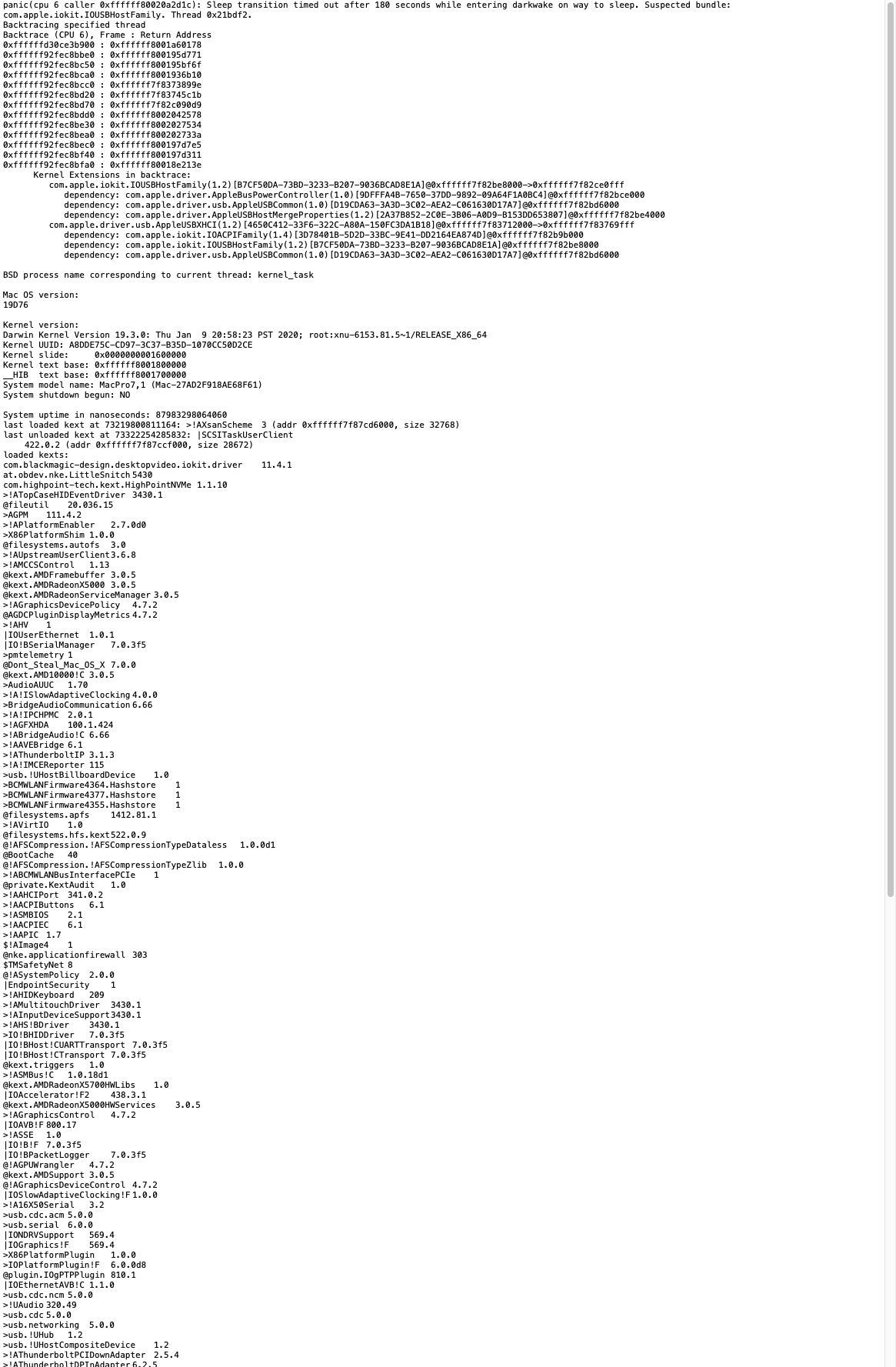

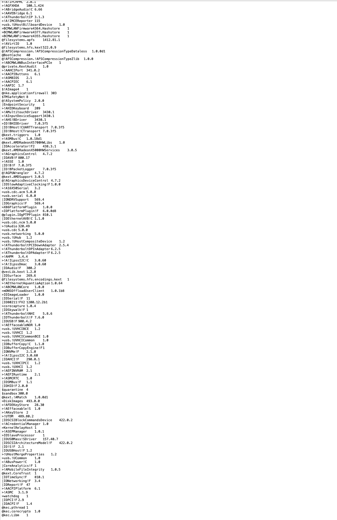

Here is the system readout after the kernel panic when the computer goes to sleep. Is anyone able to let me know what this means?

USB related, SSD7101A-1 has no USB bus or nothing that connects to USB.
My error log is almost exactly the same. Even though it mentions the USB IO, it has to be related in some way to the Highpoint as both of us have the same issue when the Highpoint is installed. I removed my Highpoint and no more panics for a couple of days of continuous use.
Looking at the top of the report, it seems somehow related to Power Nap as it references "darkwake."

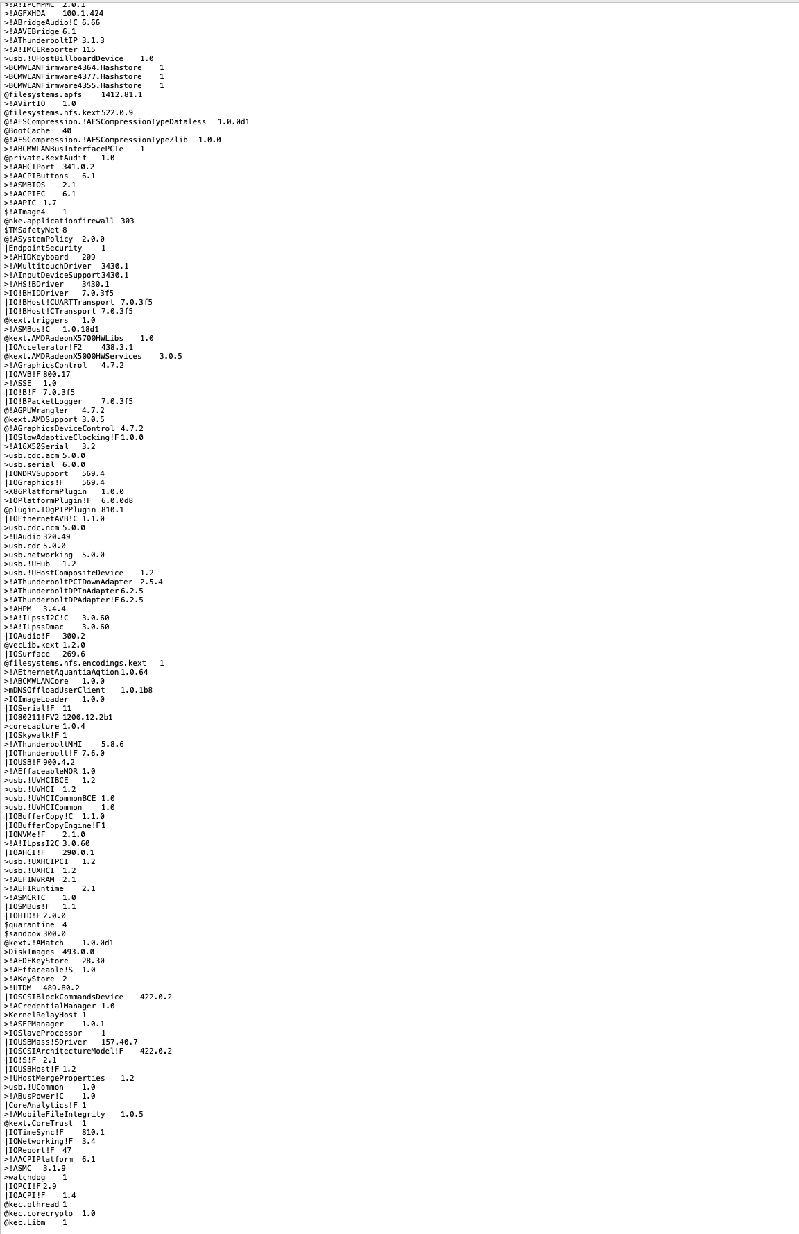

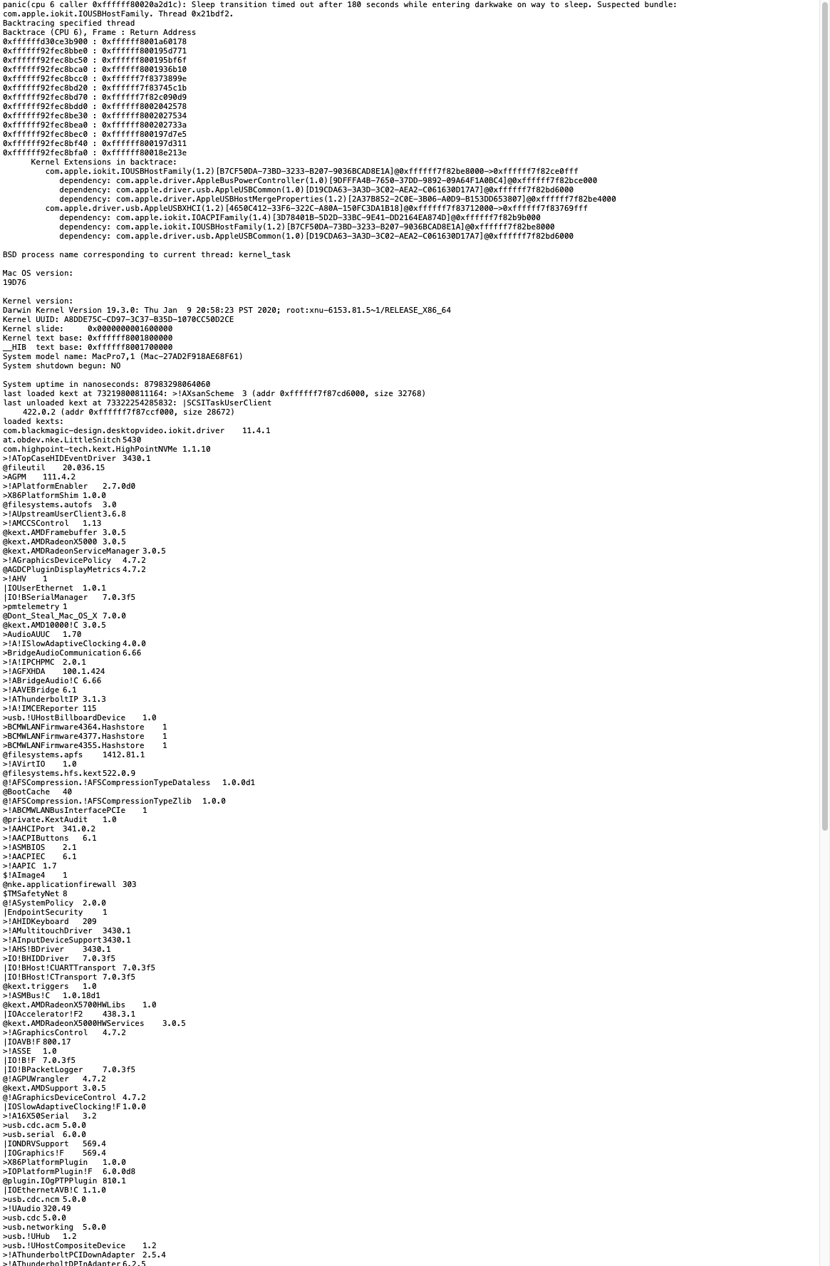

Highpoint SSD7101A Still Crashes Mac Pro
I'm sorry to say that, even after removing the driver and WebGUI, the Highpoint card crashes and shuts down my Mac Pro. Disappointing.

Since my last post, I
- Reenabled full security via T2
- Disallowed booting from external drive (both using the Security Boot Manager in Recovery mode)
Sadly, that did not work and the system shut down at sleep again. I will now disable Power Nap and see if that makes any difference. If not, I will remove the card from my Mac for the last time and just get the Sonnet 4x4, which has been running beautifully in Slot 4 over the past few weeks.
Here is the latest panic report:
mp_kdp_enter() timed-out on cpu 20, NMI-ing
mp_kdp_enter() NMI pending on cpus: 0 1 2 3 4 5 6 7 8 9 10 11 12 13 14 15 16 17 18 19 22 23 24 25 26 27 28 29 30 31
mp_kdp_enter() timed-out during locked wait after NMI;expected 32 acks but received 2 after 11398855 loops in 1596000000 ticks
panic(cpu 20 caller 0xffffff8009840991): "IPI timeout, unresponsive CPU bitmap: 0x4000, NMIPI acks: 0x0, now: 0x0, deadline: 1791426663148, pre-NMIPI time: 0x1a119599492, current: 0x1a13726fc6a, global: 1"@/BuildRoot/Library/Caches/com.apple.xbs/Sources/xnu/xnu-6153.81.5/osfmk/x86_64/pmap.c:2909

BSD process name corresponding to current thread: usbd
Boot args: chunklist-security-epoch=0 -chunklist-no-rev2-dev
Mac OS version:
19D76
Kernel version:
Darwin Kernel Version 19.3.0: Thu Jan 9 20:58:23 PST 2020; root:xnu-6153.81.5~1/RELEASE_X86_64
Kernel UUID: A8DDE75C-CD97-3C37-B35D-1070CC50D2CE
Kernel slide: 0x0000000009400000
Kernel text base: 0xffffff8009600000
__HIB text base: 0xffffff8009500000
System model name: MacPro7,1 (Mac-27AD2F918AE68F61)
System shutdown begun: NO
System uptime in nanoseconds: 1792932175406
last loaded kext at 55588840931: com.getdropbox.dropbox.kext 1.10.3 (addr 0xffffff7f903d0000, size 49152)
last unloaded kext at 216033452930: >!A!ILpssGspi 3.0.60 (addr 0xffffff7f8a155000, size 45056)

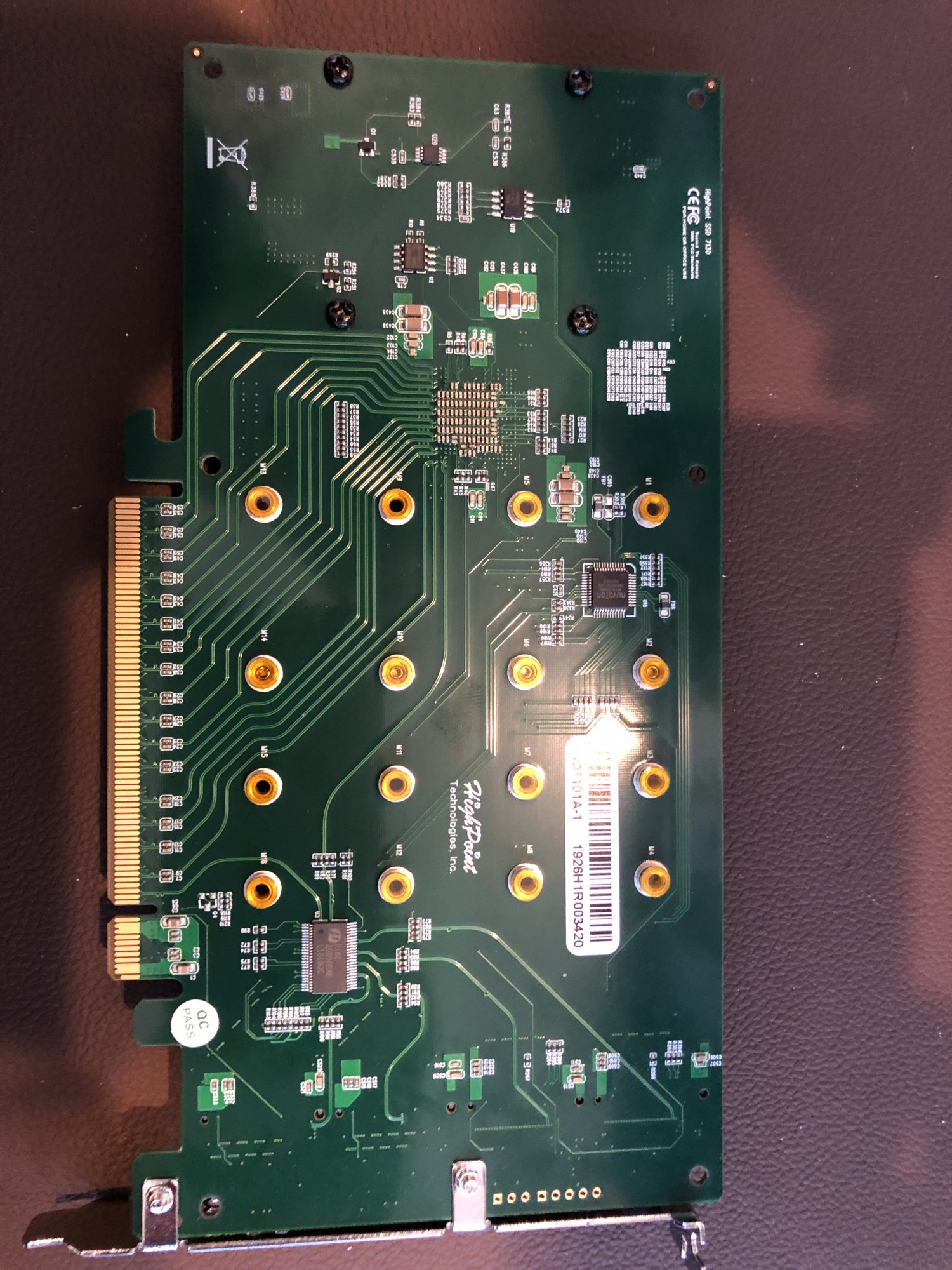

Final Update
As mentioned above, I tried disabling Power Nap and set the computer to sleep. Within 30 seconds, it powered off by itself with the High Point card loaded. No change, unfortunately.
I removed the High Point SSD7101-1 and was able to put the computer to sleep normally with no issues.
The High Point SSD7101 is going back to Amazon and I will order another Sonnet 4x4, which has been rock solid on my Mac Pro.
FYI, here is the specific card I had.

Thanks a lot for the update, I was considering that card which I can get next day from Prime here, glad I didnt buy it.

@Theophilos - thanks for your posts and pictures. Sorry to hear about your troubles with the HP card. I'm glad I decided to wait and go with the AMFELTEC squid (and pay more - still waiting for it as it out of stock). Hopefully, you'll have more luck with the Sonnet card - where are you going to buy from anyway? It's out of stock everywhere!
Hundreds of people here have SSD7101A-1, I have one for around a year, some people even have MP7,1 with two SSD7101A-1 without any problems. We know of two cards DOA in the past and two people with MP7,1 problems, one of the two is an open box, it's a very low reported quantity to think that the card is problematic in any way.
The issue is that I dont want to deal with returning it, and when I look at the HighPoint website I see no obvious mention of macOS support so that already didnt fill me with confidence. Also it seems like quite a few Mac Pro user dont use sleep so they might not have noticed that particular issue.
I've seen zero report of problems with the Sonnet 4x4 and they officially support macOS, so it just seems way safer... Which sucks because I can get the HighPoint in < 24hrs, and the Sonnet is out of stock everywhere I looked... (I'm not in the US)
I'll make due with some cheap PCIe adapters for now probably, I dont need the PCI slots yet.

Hi everyone -
I have a 7101A in a new 2019 Rackmount Mac Pro. Unfortunately one of the NVMes I bought has died (rather have that happen now then when there wasn't a load of stuff on it)
I can see in the HP Web GUI its slot 3 that's dead but is the slot order 1-4 from the top of the card (furthest away from the PCIe connector) or is it 1-4 from the bottom closest to the PCIe connector?
Unrelated I'm generally happy with speeds (approx 7600/7000) but I'm wondering if the speeds I'm seeing to many of those saying they're getting 10k + is NVMe dependent? I have the card in slot 5 (x16), using HP drivers and web gui), RAID 0 512 chunk size, APFS non-encrypted as presented to Mac OS but I'm still topping out around 7600 MB/S as see in BMD speed test.
I'm using 4x2TB Sabrent Rocket NVMes (The PCIe3 ones not the newer PCIe4s)
Thanks
