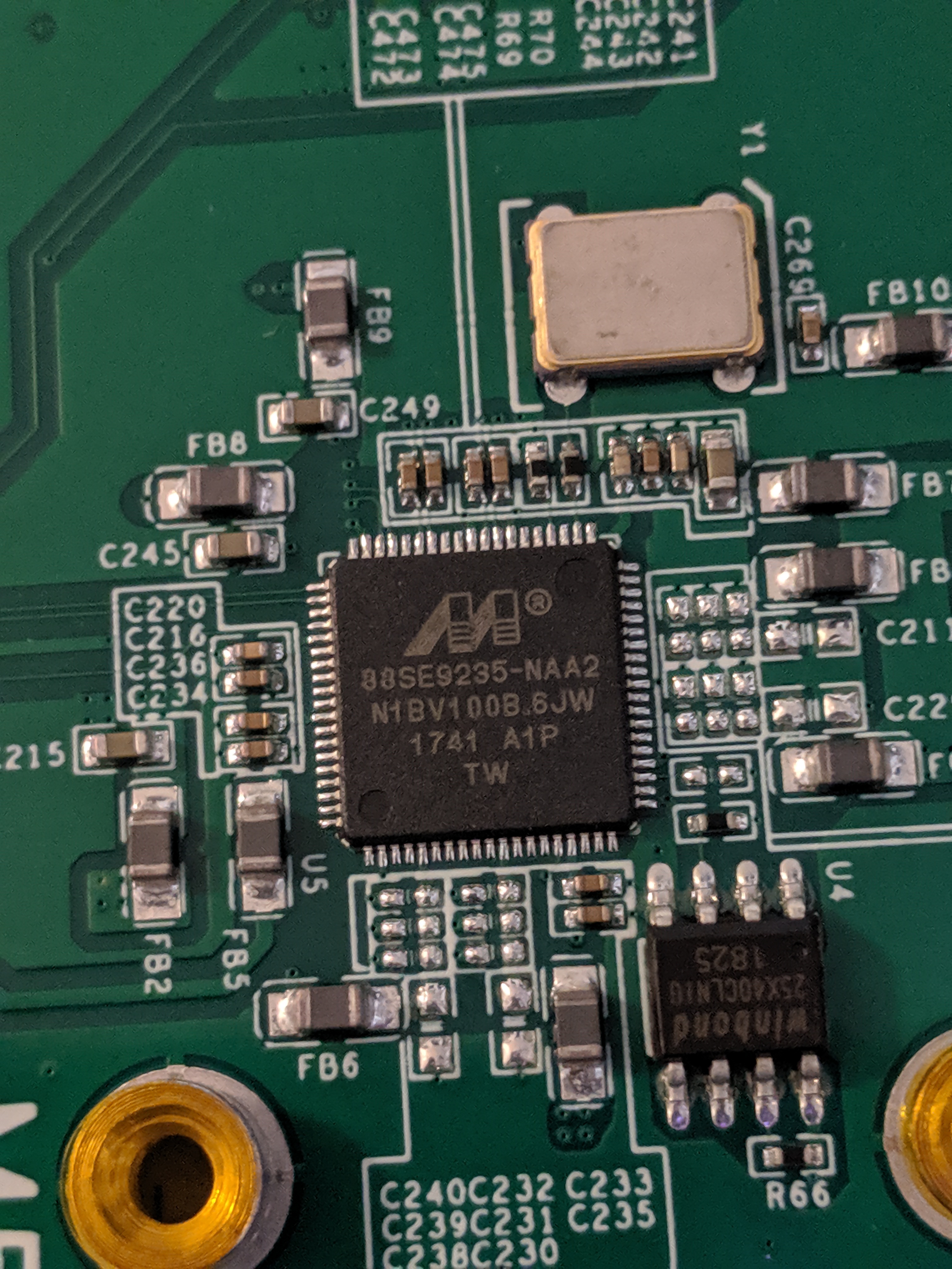

The 7102 used a Marvel controller with Highpoint subsystem vendor id (1103). The 7103 uses a Highpoint raid controller with same subsystem vendor id. Maybe it's a Marvel controller with modified vendor ID? I think we need a picture of the 7103 raid controller.
It is a Marvel controller, I'll take a photo now and post it.

Here is the Marvel controller:

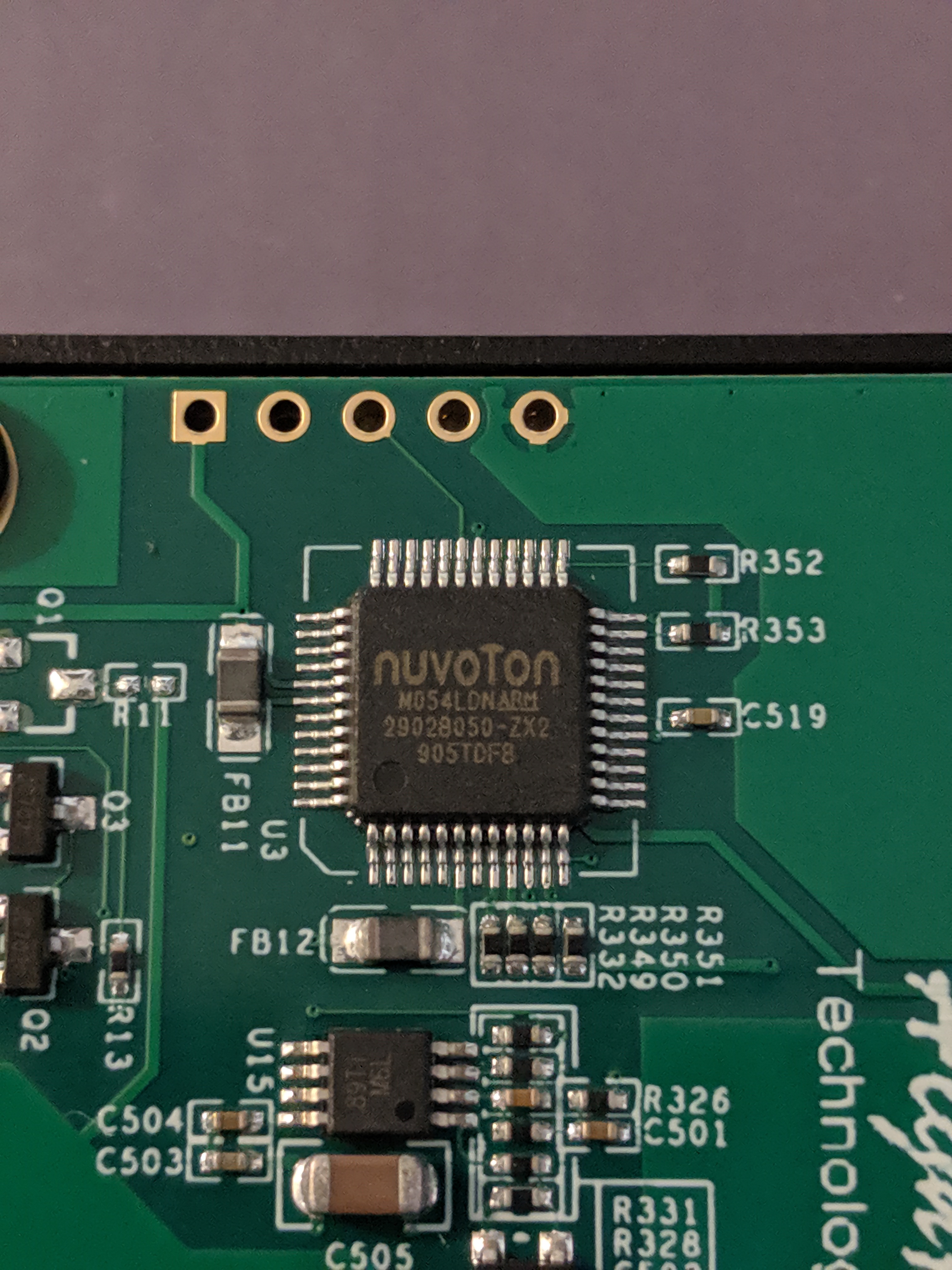

Here is a component: m054ldn
Target uses: Security/Alarm, Temperature Sensor, Motor, etc. They could be using this as a RAID alarm, temp sensor, oscillator for timing or even an A/D converter via PWM. (I'm just guessing, maybe you know).

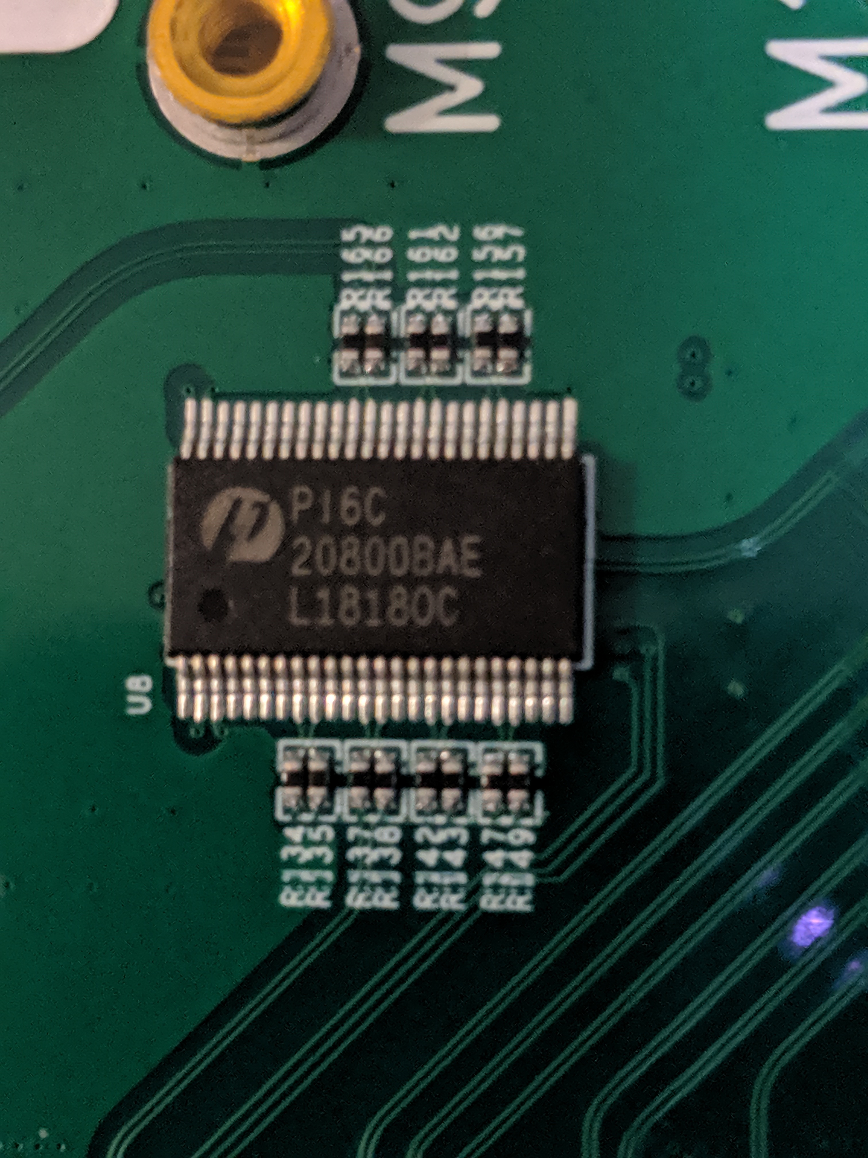

The other component I noticed is some sort of semiconductor made by Pericom. I cannot find a bom on this particular model but I did find other similar variations of p16c:

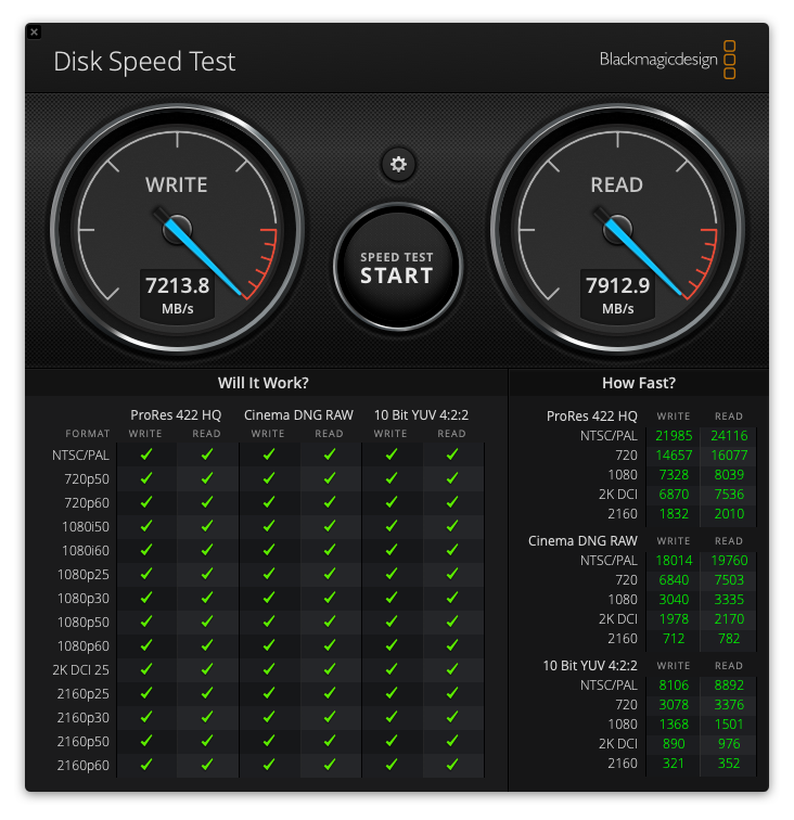

I uninstalled Highpoint SSD7101A driver and webGUI then created a RAID 0 array (x3 Addlink S70) using Disk Utility. Speed tests results are slightly slower than with Highpoint RAID. Just under 4000 MB/s read and write. Something isn't right. I have to order NVMe heatsinks so I can test this with the Squid. Also, two of the drives are still identified by Apple RAID Assistant as "HPT DISK 3_x Media." This is very annoying, Highpoint change the physical root name (drive title)? I'm confused about that. There has to be a way to correct this. Initialize is not an option and it only lets me erase.
Interesting.
The 7102 uses the Marvell 88SE9120 R3.0 One-Lane PCIe 2.0 to 6 Gbps SATA and PATA I/O Controller
The 7103 uses the Marvell 88SE9235 R1.1 Two-Lane PCIe 2.0 to Four-Port 6 Gbps SATA I/O Controller
For the fan (judging by the terms Motor and PWM)?
Change the 1 to an I and you get PI6C20800BAE.
According to the pcitree.sh output, one of the drives is connected to the second PEX 8747. I wonder if that changes performance? You can try a trial version of SoftRAID to see how it compares, once you solve the problem below:

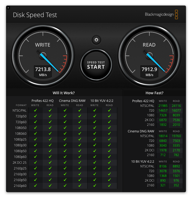

I bought a fourth 1TB 980 Pro today to add to my SSD7103, mainly because I experienced NVMes not being visible if installed in the top slot (where the printed instructions I got said to start installing them). Turns out you actually need to start at the bottom (slot 1) and now I can 'see' all four. Just for grins, I checked the W/R speeds:

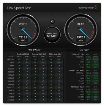

I just got my SSD7103 yesterday. With 3 from 4 ports currently populated - it all works really well. I'm operating in driverless mode ("transparent to the operating system") and making my RAID volumes with SoftRAID.
