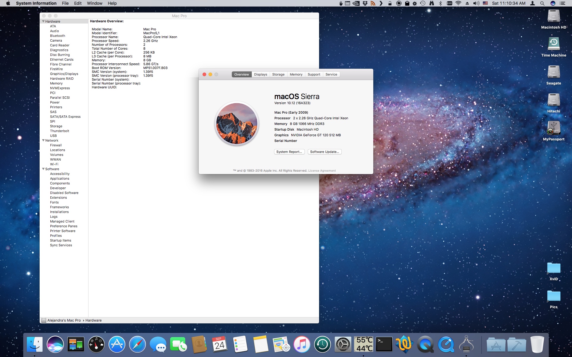

Just flashed an Early 2009 to Mid-2010 (4,1 to 5,1) by using the app and a mounted firmware image.
Had to install a base OS X 10.9 Mavericks to the HD/SSD first. Then copied the app and firmware to the desktop, ran the app.
The app created a RAMDisk then rebooted, I held down the power switch until it flashed, saw the flashing thermometer fill up,
Rebooted, then ran the App Store and downloaded Sierra, ran the upgrade, easy as pie! Sierra installed but as others have said it's still identified as an Early 2009 in About This Mac, but System Information says it's a 5,1.

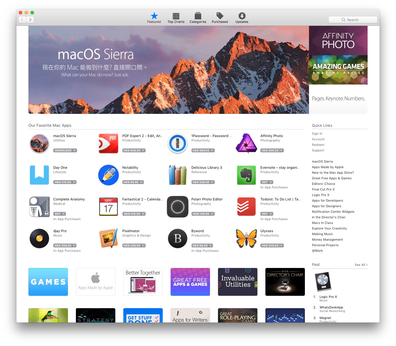

Do you see Sierra in the app store in the purchased section?
I no, I guess we need a hack to receive updates?
It's not an "update", it's a new OS, like a new app. You have to download it by yourself. e.g. just click the Sierra banner will lead you to the download page.
Yes, I know. After I downloaded Sierra it was not in the purchased section.But problem solved, now it is there.
Update: I can see it in the purchased section of the app store in El Capitan, but not in Sierra.

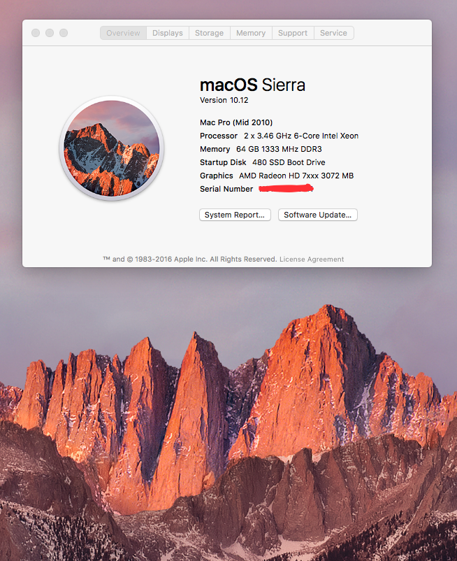

I have a mid 2010 MacPro, 5,1 with a Sapphire HD 7950 running at 4k, which means during boot I don't get the initial boot-up screen. And this morning after upgrading my MacBook Pros to macOS Sierra, I decided to "trust things" and went ahead and upgraded my MacPro. Everything went well until the first reboot, which after a brief pause of nothing, went to a glowing gray screen. Then panic set in but I calmed myself down and said it just that normal boot-up phase where I see nothing and now it's taking a little longer time because it is finishing the upgrade process. But it took way much longer than I thought it should and I was just about to do very "stupid stuff" when it rebooted a second time and came up to normal login screen. That was close! So for those of you who have a similar graphic adapter arrangement, please be patient. It will actually work!
If you mean that you have the Sapphire HD7950 Mac Edition card, and the 4K 60Hz make you can't have the boot screen. I think it's better to set the screen to 4k 30Hz (or even 1080P) to get the boot screen during upgrade. I usually leave my 7950 at the PC ROM, because I occasionally boot to Windows, and crossfire will crash if boot with the Mac EFI ROM. However, I alway flip the switch back to Mac EFI before any system upgrade. I don't want to do any stupid stuff because I didn't see the screen (and actually I can, if I do it correctly).
Yeah I am aware of the boot limitation but was not aware that switching it to 30Hz would reveal it. Thanks for that tip and I will keep that in mind next time I do an upgrade. It was a very unpleasant experience being in that uncertain state of doom :)
