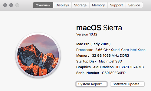

Interestingly, even though we're 5,1 flashed it says "Mac 2009" not "Mac 2010" anymore in the system info window.
It never did say"2010" did it? That doesn't change but the "model identifier" in the System Report>Hardware will say Mac Pro 5,1.
