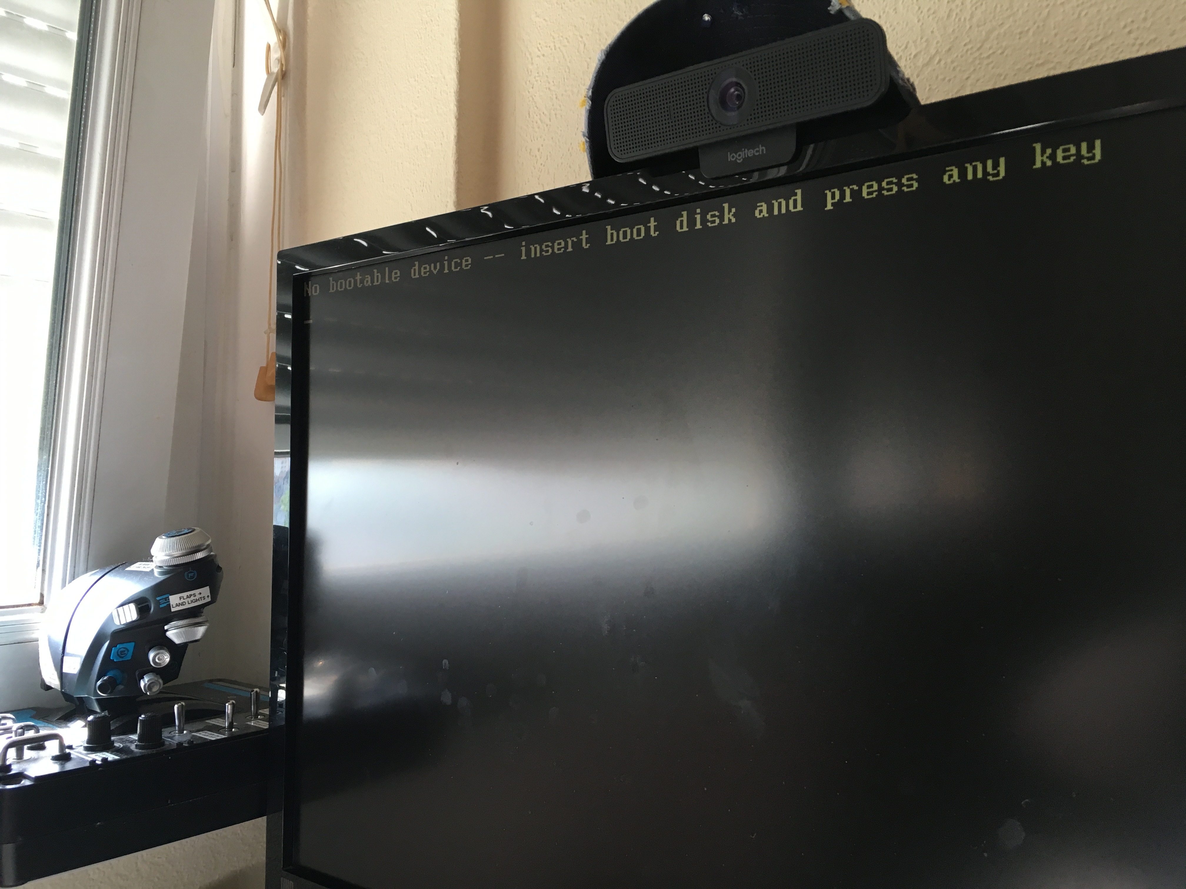

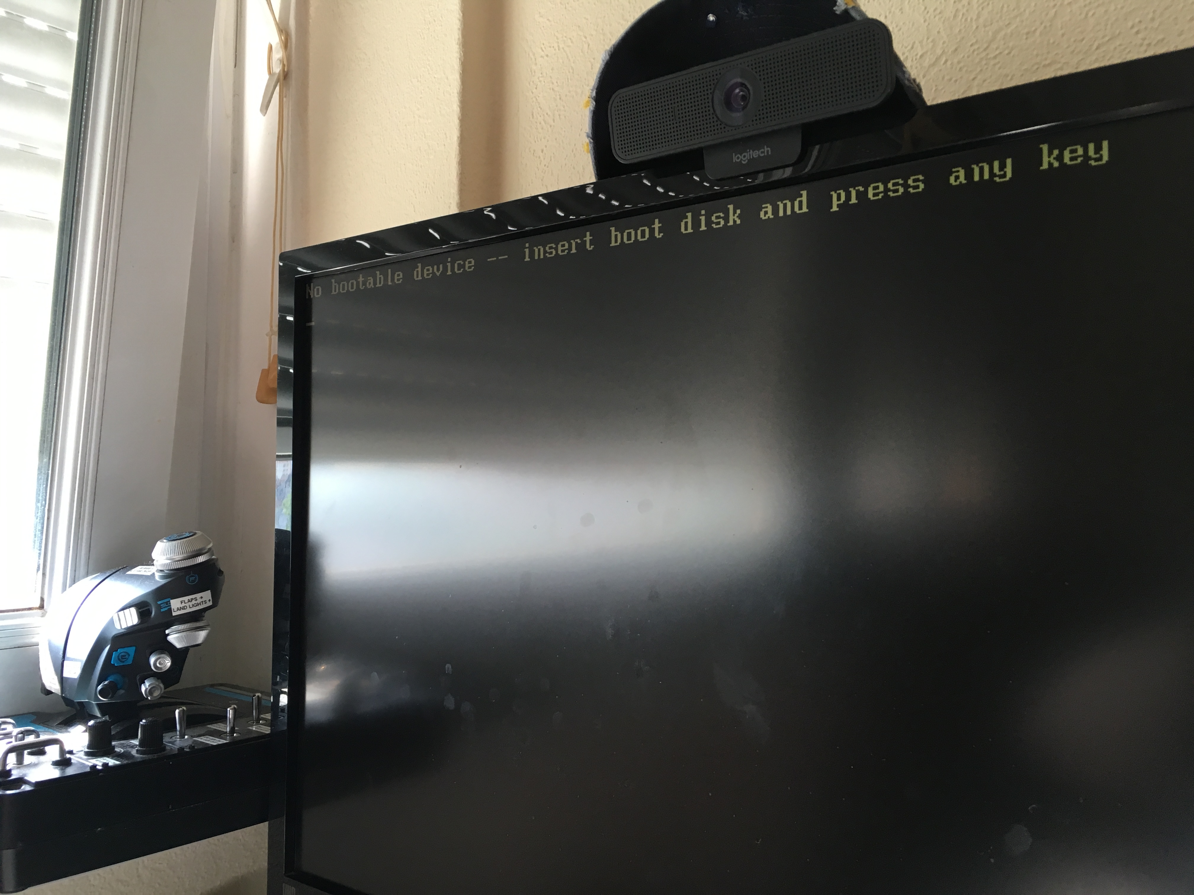

can’t figure out yet, but look:
i’ll test again tomorrow, but this was displayed on a non mac efi gpu:
That's the broken Windows partition activated the GPU in basic mode.
Try remove the Windows hard drive and check if you can still see those text.
except the windows partition is not broken.
i can access it blindly with alt and all to the right, and uefi win will boot.
but if i choose windows boot in mac os startup pref i end up with the no bootable drive screen - which must be the legacy bootloader.
if legacy bootloader can activate basic gpu mode, why a legacy windows bootloader wouldn’t be able to do it?

I'm going to dig into this by switching windiws drive to normal sata drawer and trying to put a non bootable drive to the optical bay
In that case, Windows is broken, otherwise, you already booted into Windows.
And Windows can activate the GPU, but not any other boot loader.
Technically, if the initial Windows boot process can activate the GPU, then we can use similar method to active the GPU as well, but the problem is how?
Can we only extract that part, and then make a boot loader to let us choose booting between macOS and Windows? I don't think so.
Is there any other boot loader? Yes, e.g. rEFInd. However, as I said, we still can't figure out how to make it activate the GPU yet.
Those text means you are already in the Windows booting process, but somehow failed to locate the Windows system files. That's it.
I will be more than happy to see that your GPU can shows some text without Windows help. Please set Windows as the target boot drive, shut down, pull out the Windows drive, then boot again. You should see absolutely nothing on the screen. If there is any text, that will be a great news for us.

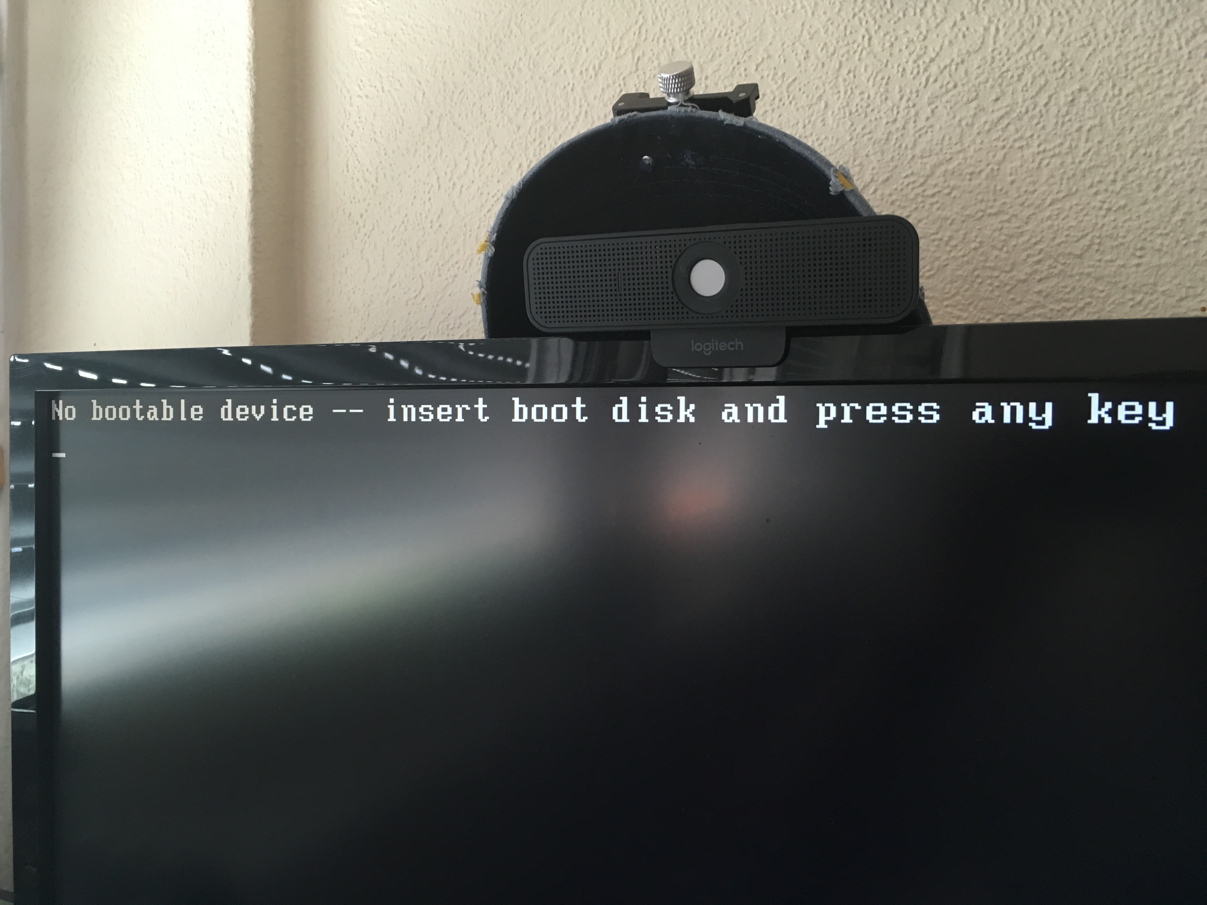

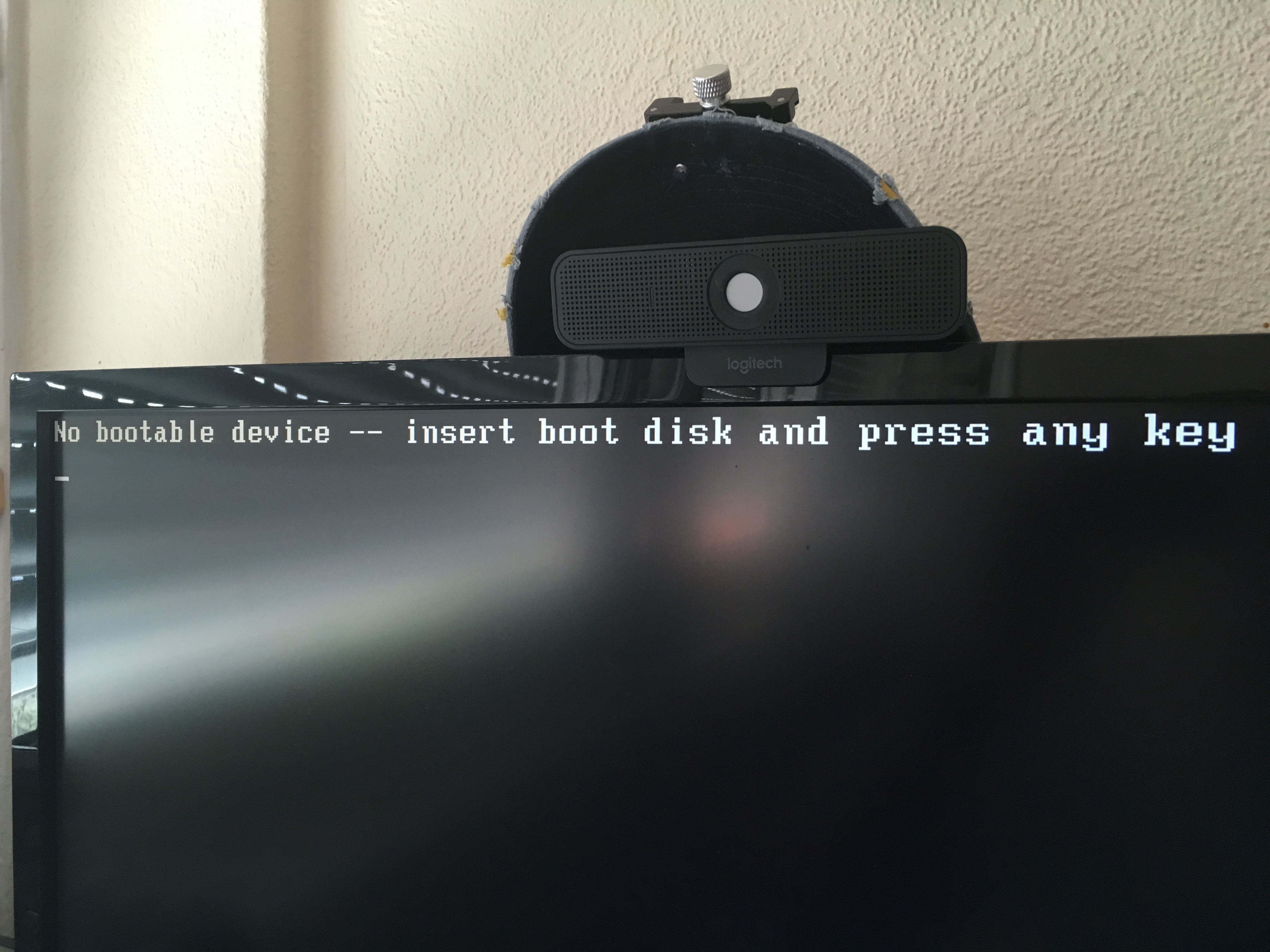

Well,
Just tested
removed windows ssd from optical bay, not any other dd in optical bay
drawer 1 and 2 my MacOS fusion drive
drawer 3 windows ssd
drawer 4 my main volume clone

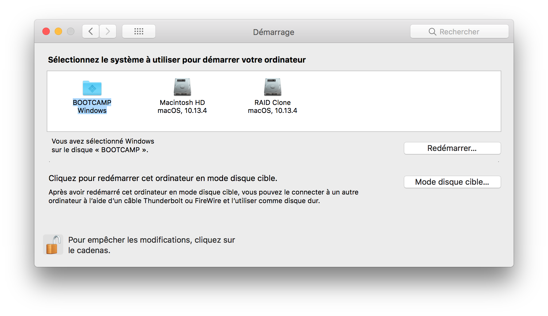

system pref -> startup disk choose bootcamp
reboot
same black screen "no bootable device"
I remove bay 3 (win ssd)
reboot -> same black screen "no bootable device"
i put back my game data hdd in bay 3
had to reset pram to go back to my main fusion drive
SO:
1) this message display on screen doesn't come from either bootloader (MBR) or Windows as it shows even if disk not in here
2) i still think this is because bootcamp try to find a legacy mbr on the mac pro and not an uefi boot partition as in more recent mac, that is why the emulated legacy bios say that.
BUT
the emulated legacy bios can display something on non mac efi GPU.
if i can make more test, just tell me :)

I have to confirm that my windows install is definitely not broken. starting windows with alt at boot (blindly of course) or with win ssd as the only ssd just workd and launch my windows (uefi install)

It's good to know that.
So, the process may be like
1) Computer start with Mac EFI (no boot screen for non Mac EFI GPU)
2) if go to macOS, then nothing will shows until GPU driver is loaded.
3) if go to Windows, then the system will fallback to emulated legacy BIOS. At this stage, the GPU will magically activated.
However, if this is true, not sure if we can utilise this function.
because until we choose Windows, the Mac won't give us the emulated BIOS.
But this is still a great finding, and thanks for proving me wrong. Learn something new today. :D

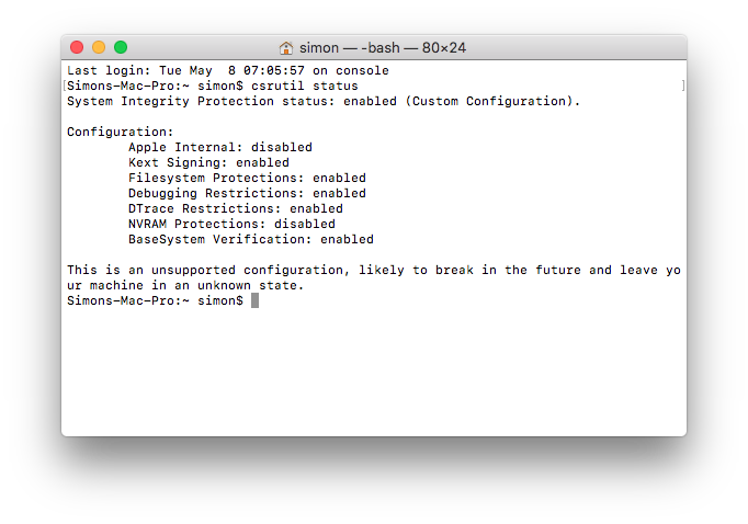

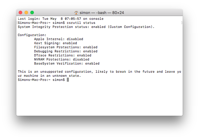

What are the long term implications of leaving SIP disabled permanently?
Has anybody tried Boot Runner? This appears to work as an overlay on the MacOS login screen, so should get around the problem of not having boot screens. It also works with SIP enabled.
https://twocanoes.com/products/mac/boot-runner/
For BootRunner you only need to disable NVRAM write protection.
csrutil enable –without nvram​

Hi, unearthing the thread. Just to tell you i finally managed to have a working windows boot drive with my vega 64 (even though i can't have access to all the sapphire features from their strixx software...?
My only problem is switching from one os to the other
From windows if i choose reboot to osx - i reboot to winwin
From High Sierra if i choose reboot to bootcamp - i end up with a no bootable device, insert boot disk.
my win ssd is in optical bay 2
tried installing my gt120 in slot 4 but i end up not being able to log in to osx due to distorted image on the gt120 (hdmi to the screen + DVI to hdmi adapter)
in the end... the gt120 is useless to me and i can't switch os... how did everyone with high sierra win 10 1709 did?
edit.
for win to mac the issue seems to be SIP, but even with csrutil enable —without nvram i get same issue - strange. because of mac pro bootcamp version i was also thinking about the way HS boot (preboot volumes etc..) that may differ from before. but even on hfs+ i had same issue.
for mac2win i also think it’s the bootcamp version who is looking for legacyboot instead of uefi boot.
It seems to work best if you have Windows installed in the 1st SATA hard drive bay. Don't select bootcamp from the startup disk pane in MacOS system preferences because it will point to a partition on the Mac boot drive that does not exist. Select the MacOS boot drive as the startup disk so it always starts up in MacOS. Only start Windows using BootChamp or Boot Runner. To switch to MacOS from Windows simply restart from the Windows menu. Do not use the Boot Camp control panel.
ok i’ll test that, but bootchamp or boot runner usage means disabling SIP, right?
If it helps I took a look at both Boot Runner and BootChamp. I thought I would like the idea of going to a screen where I could select my boot drive, but in reality I'm lazy and the extra steps annoyed me. I've settled on using BootChamp and I'm more than happy with the results.
Reactions: MisterAndrew

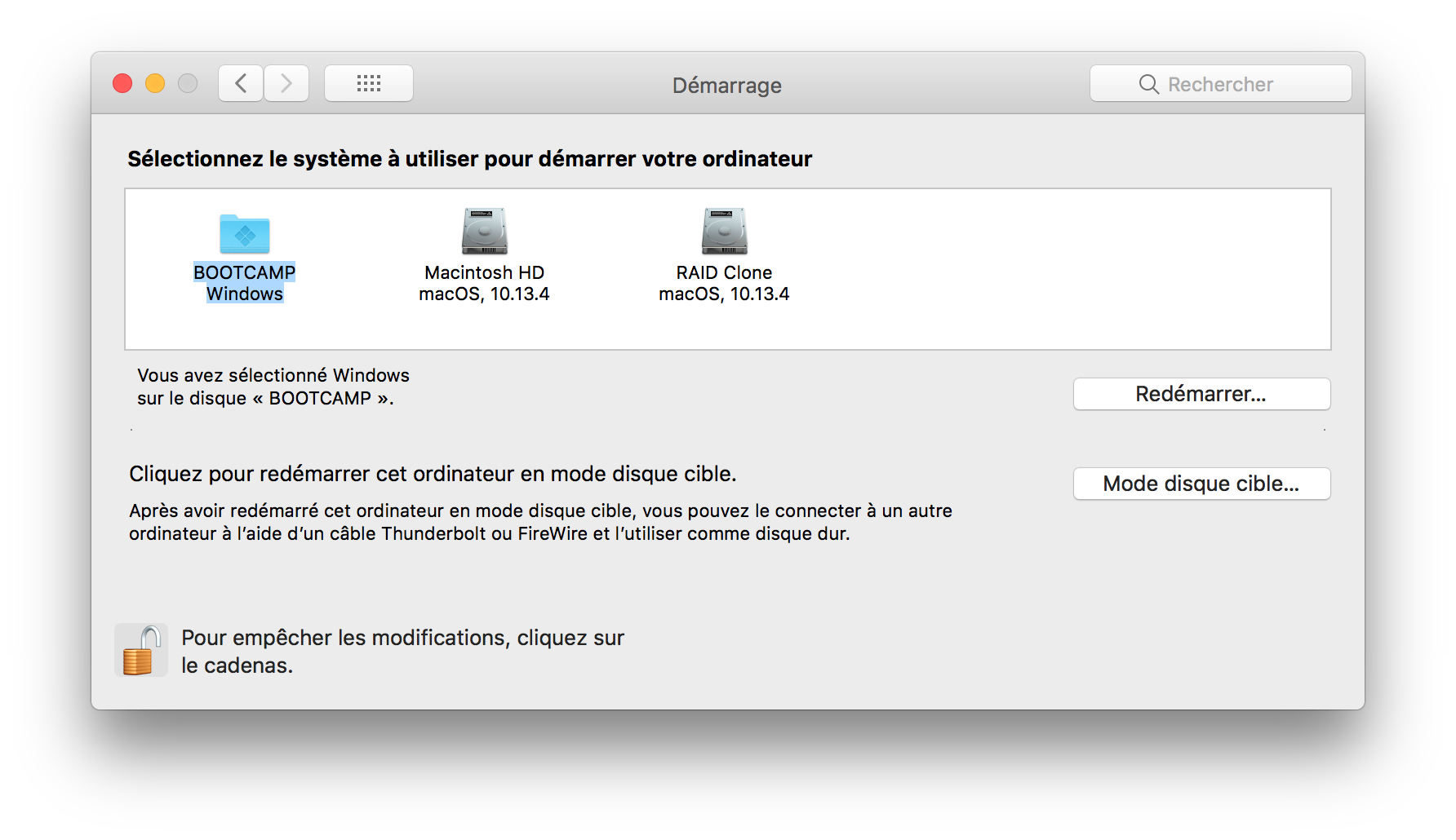

Select the Mac boot disk in macOS in Startup Disk in system preferences. It should say “You have selected...as the startup disk”. Then it will always start into macOS. You can do it from Recovery Mode if you’re not able to boot into macOS. It’s all in the first post of this thread.
Well that is pretty much what i did, but again, i am going to try again
just setted up win ssd in bay one, my fusion in bay 2&3 and to be sure i disconnected my boot clone in bay 4
i booted in recovery, setted SIP without nvram, setted may fusion as main boot drive.
i hope we agree this is good config.
now i will try what you said by booting win from bootchamp and booting back after and see if i get back to my mac boot drive.

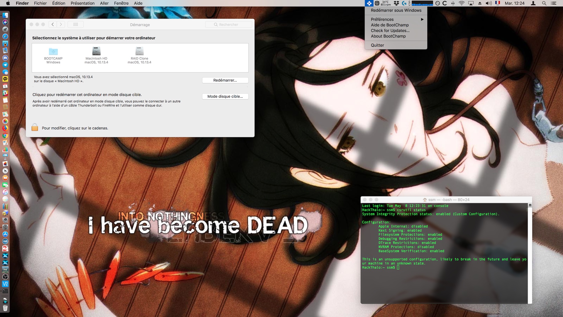

finally managed to do it.
the recognition of my Logitech K811 BT kb in both MacOS and Win10 was a terrible pain in the ass
now i am testing Boot Runner, but i may find also this solution not very useful. i think i have an idea on how to make this more simple and efficient, need to take a look at boot champ source to see how it works to select the drive and tell it to reboot
So. As a utility to reboot to Windows partition whe nalready in my session, BootChamp is a good thing. I totally approve.

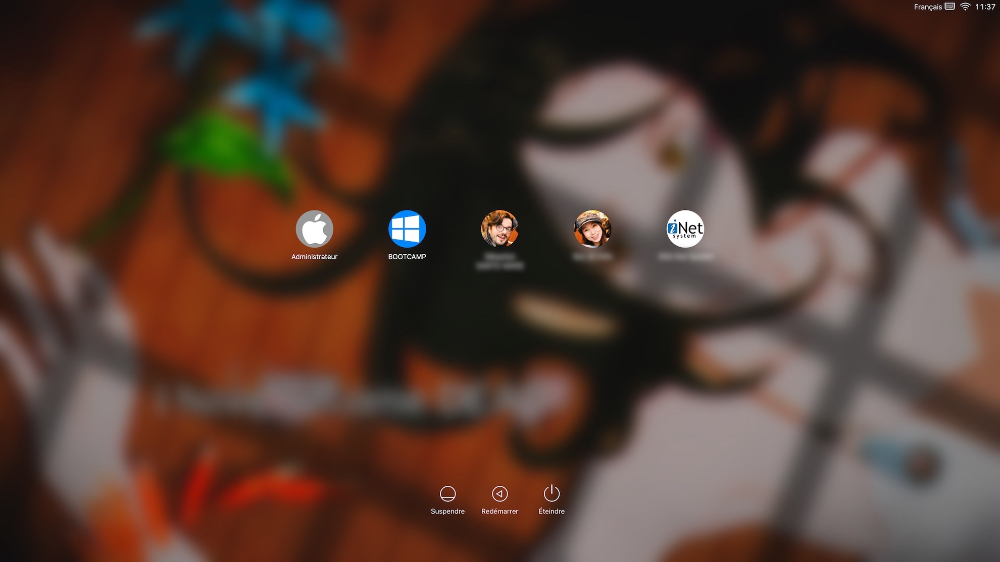

Boot Runner is too heavy for me and not very elegant.
So i am working on something to make this more elegant to reboot to bootcamp right from login screen with just one click.
It should look like this in the end:
So When Win10 is having its update multi reboot episodes i don't have to login to reboot. as Boot Runner but less heavy in my mind. hope i'll be able to do this as i want.
If some are interested, i'll try to keep updated on my progress...

Even need few more seconds to boot to the login page (compare to normal boot loader). But with a SSD, this is not a big problem.
However, I don't know how to do it in the light way. All I can think of is using the native stuff.
e.g. Open a new account called "Windows 10". And then auto run bootchamp when login to that account in order to reboot the Windows. But that will occupy lots of space due to require a new user account.
This looks interesting.
with a limited skeleton, a launchd at login and the good script, i think it could be not too heavy.
