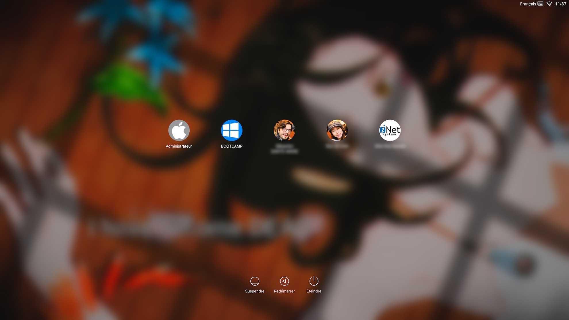

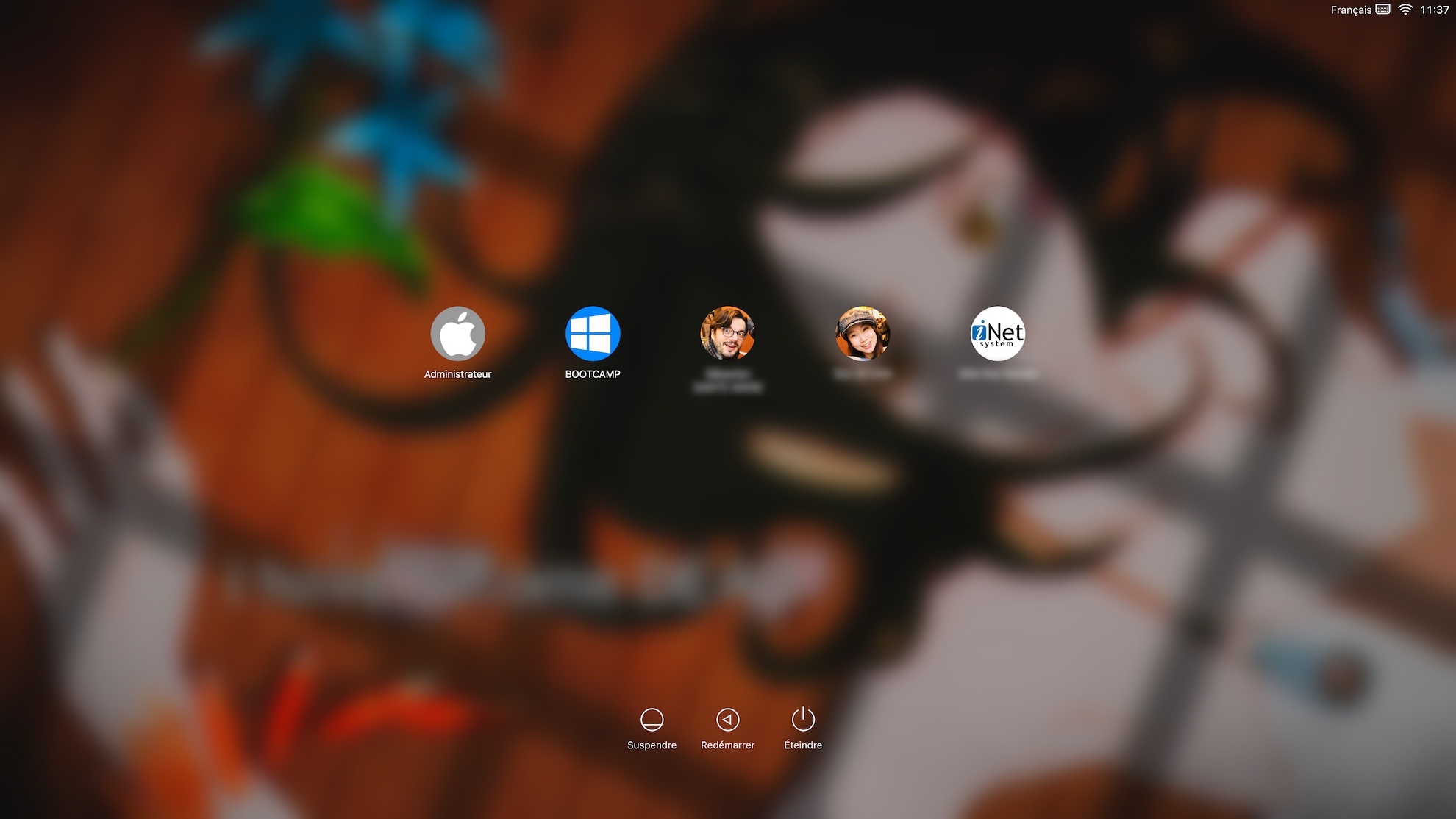

So i am working on something to make this more elegant to reboot to bootcamp right from login screen with just one click.
It should look like this in the end:
So When Win10 is having its update multi reboot episodes i don't have to login to reboot. as Boot Runner but less heavy in my mind. hope i'll be able to do this as i want.

So, i just tried my proof of concept for what i want to do, and here is how i want it to look like.
This was done with an Applescript so i had to have a passwordless admin user wich is clearly not good :)
But at least i know the commands i need and i can go to a "Launchd" version wich i expect, will be more secure and deployable.
