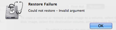

Hmm.. Still getting the same error.
I went and tried another method using the same flash drive (link in 1st post in this thread), which I think is the same thing it's just a script and it seems to work fine now. No idea what the problem was.
Let me do some digging.
UPDATE TO ALL GUIDE USERS: IF YOU ENCOUNTER THE SAME ISSUE AS ABOVE, PLEASE USE THIS ALTERNATE METHOD:
[URL="https://forums.macrumors.com/threads/1409416/"]OS X Mountain Lion - Alternate Flashing Method[/URL]

I'm also getting a error at the very end. After the whole copy process.
I will try anyway, and see if it works :) Using the 1.st method.
Edit: the installer seems to be working fine with 4 min to go. No bad arguments here!

The source should be the mount point of the DMG, not the DMG itself.
Sorry, but you're wrong. If you restore the 'Install OS X Mountain Lion' app to your media, it doesn't boot. If you restore the InstallESD.dmg, it works perfectly fine, and boots.
Depends on how you do it. The folks getting the errors are doing it incorrectly, which is why my comment was specifically on the problem NOT the guide itself.
The valid ways:
1. Source: DMG, Destination: Flash Drive (The brand name and capacity)
2. Source: Mounted DMG "Mac OS X Install ESD" Volume, Destination: Volume on the Flash drive.
The valid ways:
Oh, okay. I was confused. Those are the correct ways, and the way I list in my guide.
