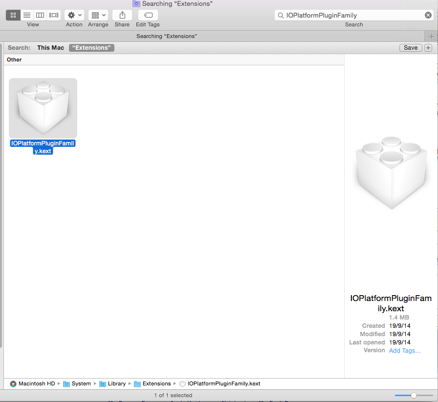

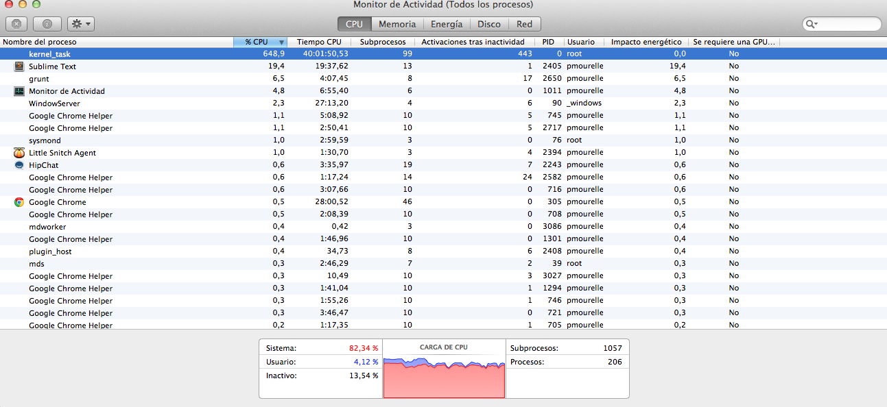

This solution totally works. Thank you so, so, so, so much!!!
Just see the difference in the attached images (before & after).

Okay, I seem to have solved the kernel_task PCU drain using this method I stumbled across on the web.
1. Go to About this mac under the apple in the upper left and click on More info
2. Click on system report
3. make a note of what it says after Model Identifier
4. go to your master drive – System -Library – Extensions – IOPlatformPluginFamily.kext -Contents – Plugins – ACPI_SMC_PlatformPlugin.kext – Contents – Resources – find the name from step 3 and move it to a folder that you can find again if needed.
3. Restart and you’re done
I hope this helps.
