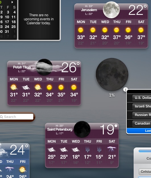

Also noticed that the widget takes a while to refresh. Also, found a weird bug tonight. I live in Israel and for some reason while tonight it's almost the new moon, in Jerusalem it shows full moon. I tried to refresh the location but it wouldn't help. I attach the screenshot here.
Thanks! The widget defaults to showing the full moon whenever it isn't provided with proper data. This is how the original widget was coded as well. So if you're seeing the full moon specifically, that's probably what's going on.
If it starts showing other moon phases which are wrong, please let me know.
Believe it or not, tonight Jerusalem and Petah Tikva exchanged the moon phase. Now it's full moon in PT -
Whoops! In that case, ignore what I said yesterday—this is a bug, it must be some kind of rounding error from when I convert the moon phase.

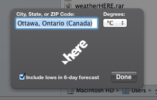

Stittsville, MI only. Not Canadian Stittsville. It's still shown as Ottawa.
Not that I don't appreciate your job, I admire it! Just reporting what is up there.
Ah, okay, sorry! Out of curiosity, what happens if you type in your street address?
Lipizzaner St. returns Ottawa, ON.

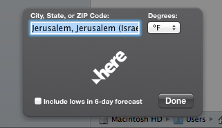

The widget is working differently on Mavericks and High Sierra. On Mavericks Jerusalem returns HaKnesset on the face and Ottawa returns Healey's Heath on the face while it's Jerusalem and Ottawa on HS.
I will update on how quick it would refresh itself on Mavericks.
For some reason the first day has already changed itself to FRI under Mavericks while it still stays THU on HS.
It seems that the results for Stittsville on Mavericks are also different from HS.
Update: The widget updates pretty quick on Mavericks compared to HS, however I noticed that the temperature given is different on either OSes. On HS it states 29 C for Jerusalem while it's reporting 33 C on Mavericks.

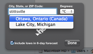

Edit: I just had another thought. Do me a quick favor—on both machines, delete Library/Preferences/widget-com.apple.widget.weather.plist, then reboot. It may do nothing, but I wonder if it's pulling in saved data from the old version.
Edit2: Grr, and I can't seem replicate your issues in High Sierra. :( Everything works fine, down to the HERE logo on the back...
It worked beautifully, thank you! HaKnesset still stayed for Jerusalem, however typing in "stittsville" in the search field, while choosing Ottawa for the only result in the list now gives Old Stittsville on the face! Refreshes very quick. Checked on both machines. The temperatures are the same for each city. And the HERE logo on HS machine is located correctly now. Sorry for panic.
UPD. It does use the address to find the nearest spot, pretty cool feature!
