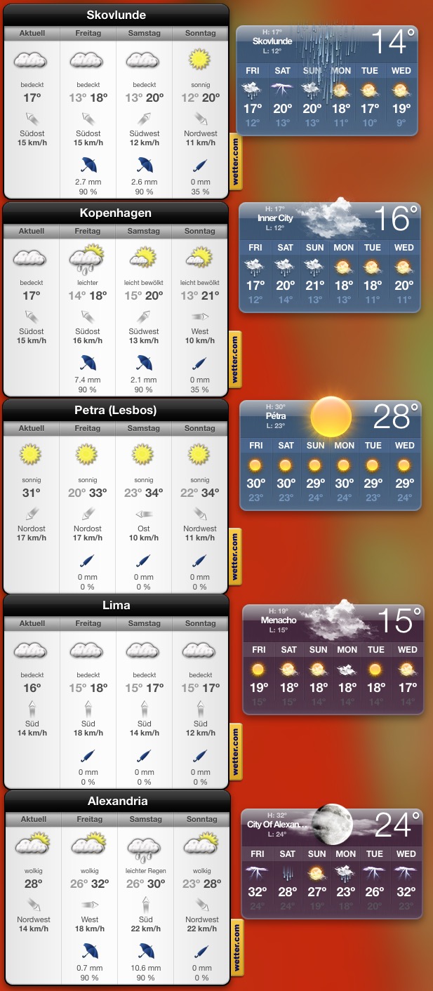

I have included a screenshot of the widget working alongside the "wetter" widget, which I like for windy reasons (but otherwise not - for instance it's a day behind!), but what I like the MOST is your stubborn, stubborn dedication!

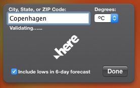

well, one day later it stopped updating. I tried the cmd-R, but no.
Maybe it has to do with the API, but I am not competent to find faults here.
Or maybe it was caused by me clicking the old weather widget, which was still in the widget window - "just to see what would happen"?
I have since deleted all preferences to do with the "weather" widget, logged out, but to no effect.
Anybody?

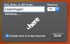

Did both.
Endlessly validating.
I have it working in Lion, Mavericks and Mojave. Are you sure you inserted APIs correctly (in right places) and just those that are needed? The installation and code injection for macOS below and above OS X 10.9 differ. Your issue looks similar to the one I was having in Lion when I was creating my worker with Cloudflare service for remapping HTTPS to HTTP, and the code had a typing error (introduced unintentionally in the process of coding) which was a missing whitespace between variables storing these URL schemes. The result was "Validating..." forever until the syntax was corrected. If you run 10.9 and newer you don't have to create a worker with Cloudflare (if you did).

The fact that it worked at first is odd. Did you put in your own API key or did you use the one built into the widget?
Edit: Oh, I can replicate! It's not just you! If you already have a location set, everything works, but if you try to set a new one it gets stuck on "Validating..."
Something has changed on HERE's end, because I certainly didn't do anything.
I'm going to hope this goes away on its own in the next few days, which it might. Otherwise I'll find out what's the matter.
^ It looks like the aforementioned "Validating" issue is gone as of this morning. So, it was just a temporary blip with HERE's API, nothing to worry about!
