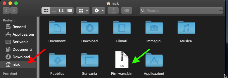

Ok, my number written on machine is MX25L3205D so I saved it on Home folder like on pic right?

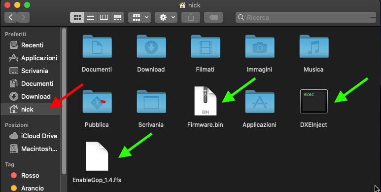

Ok I've done all, miss only the ultimate point 5.
