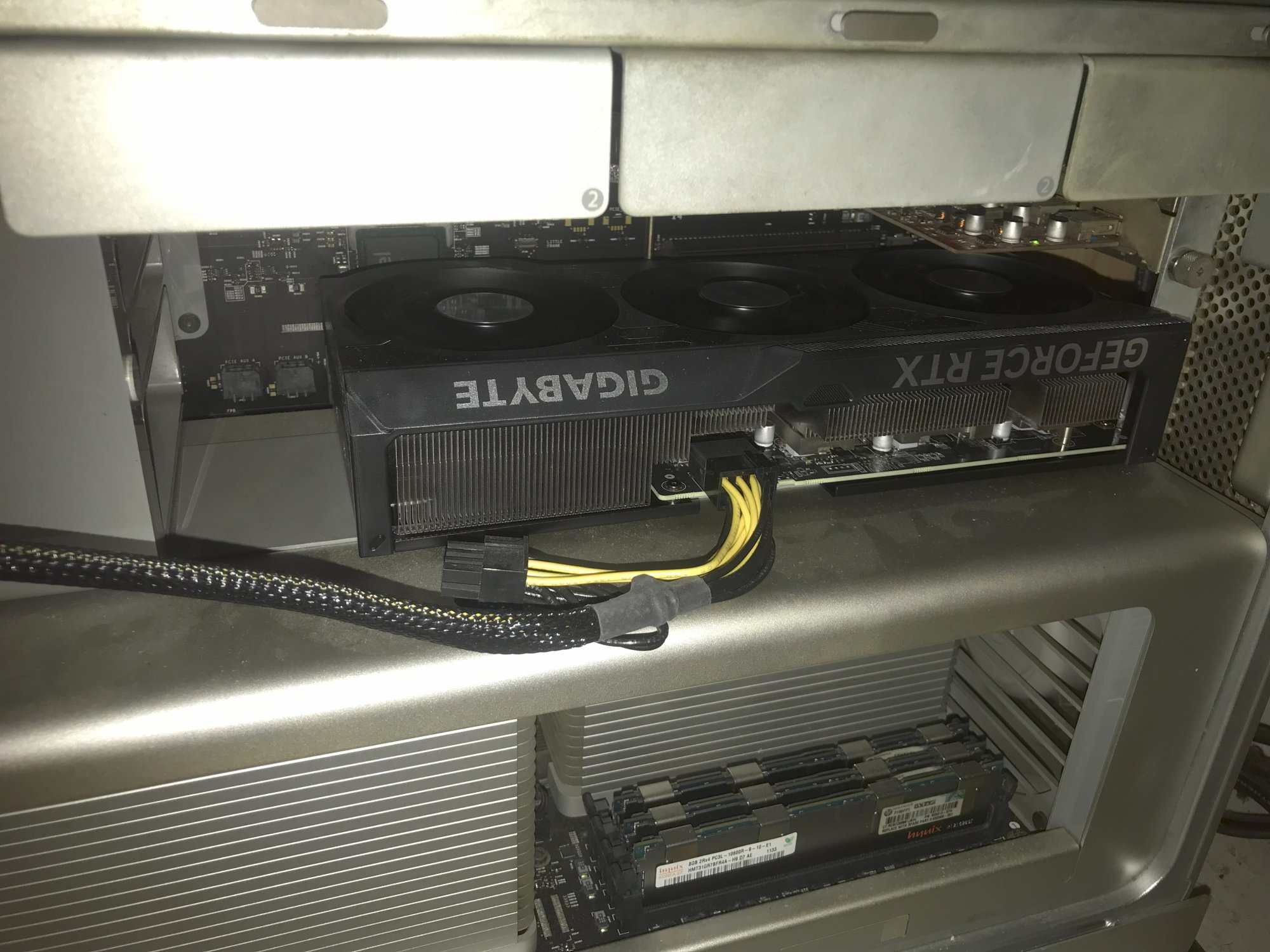

I ended up buying the Gigabyte GeForce RTX 4070 Windforce OC 12GB VGA (GV-N4070WF3OC-12GD). It's 261mm long, which makes it easy to mount on the MacPro 5.1. The maximum length of the Macpro slot is about 310mm, so any card under 300mm should be fine.

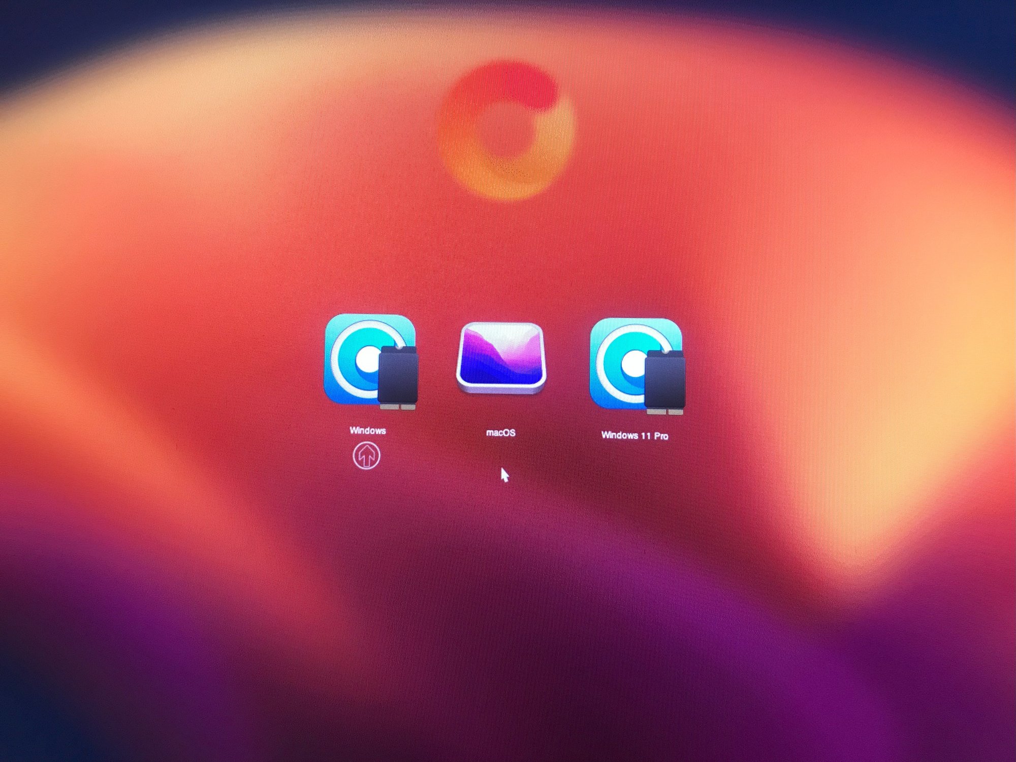

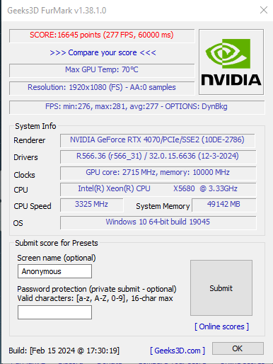

I installed and tested Furmark, the maximum temperature is around 70 C. Runs well on Win 10 + Win 11
