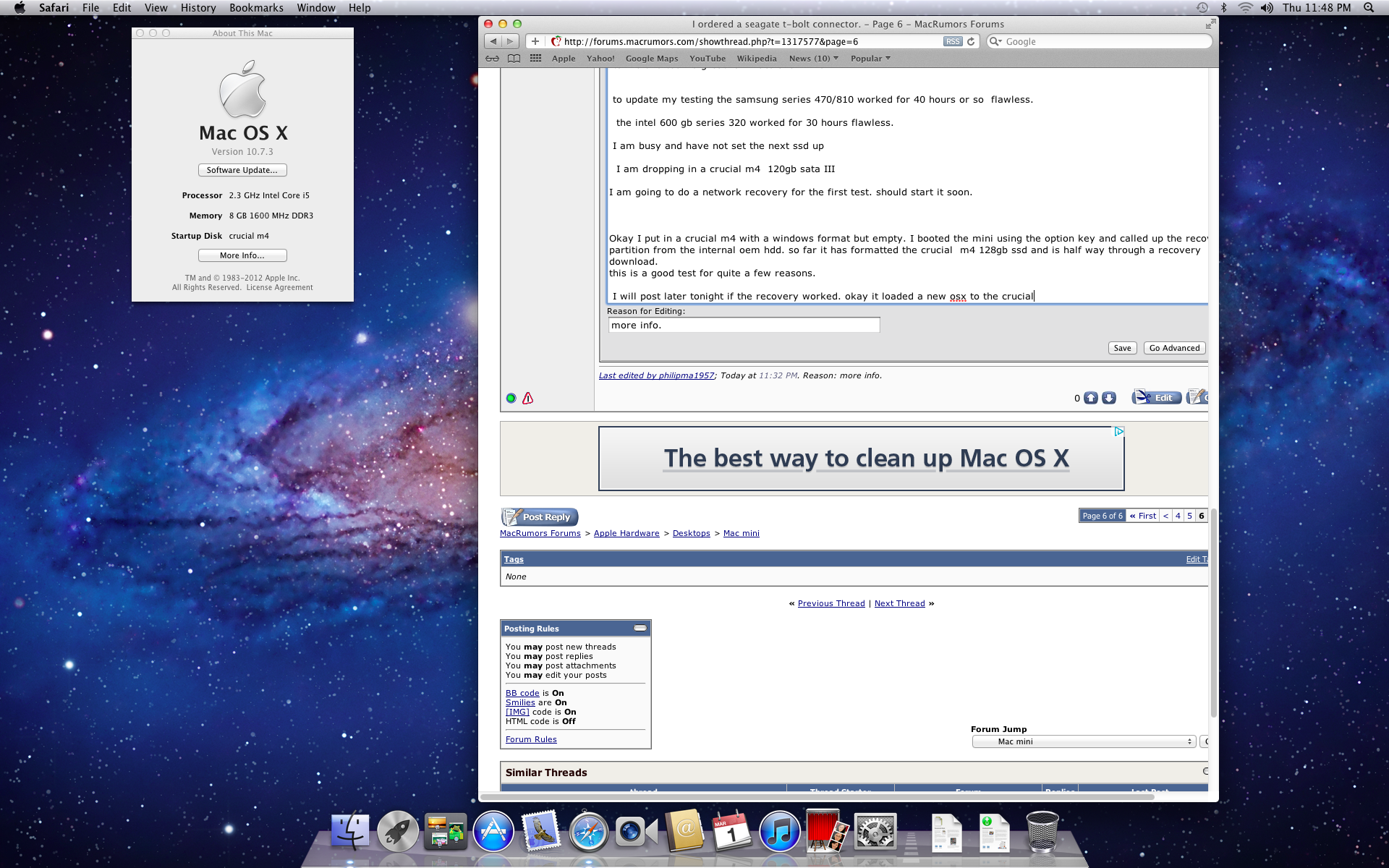

I am dropping in a crucial m4 120gb sata III
I am going to do a network recovery for the first test. should start it soon.

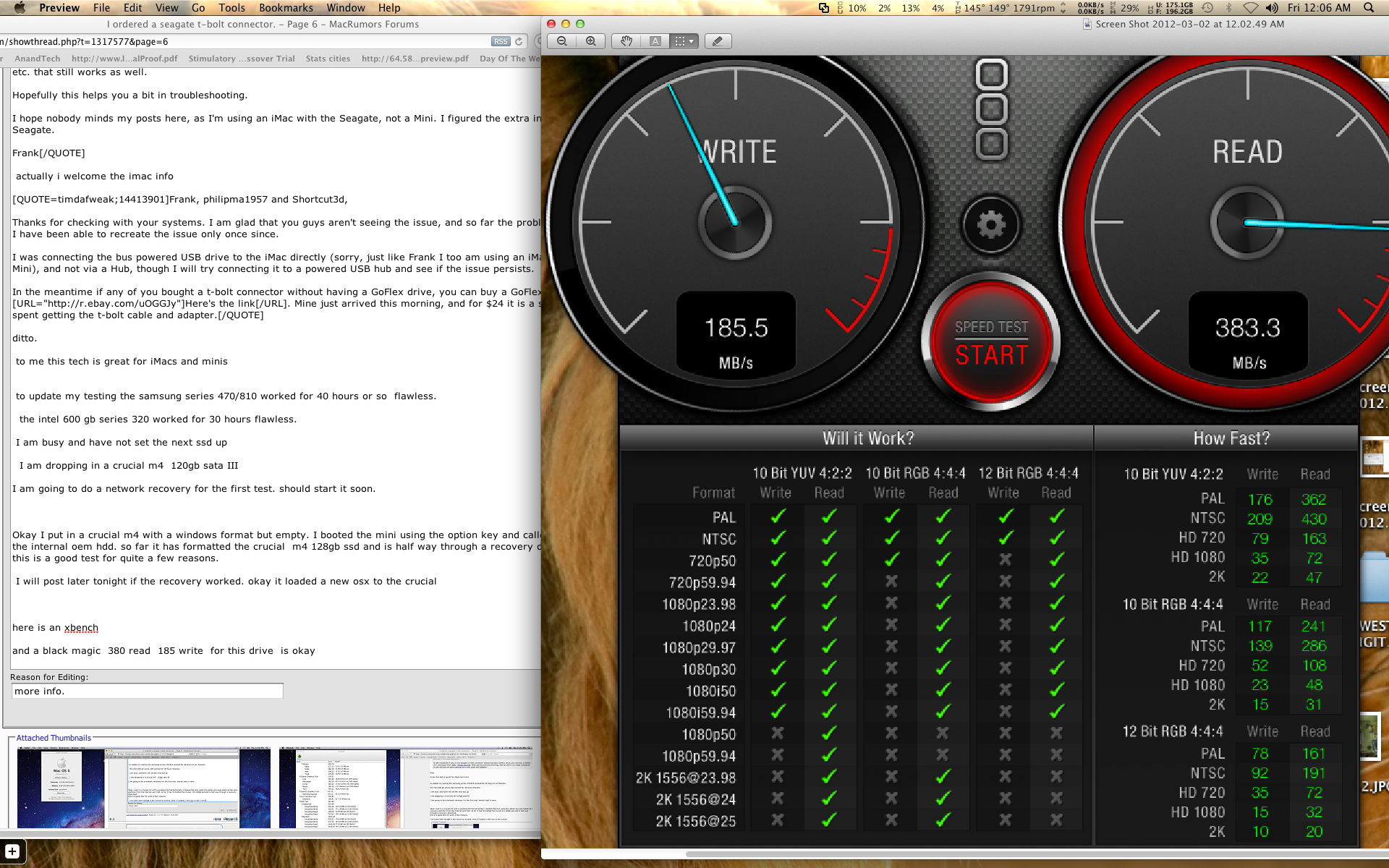

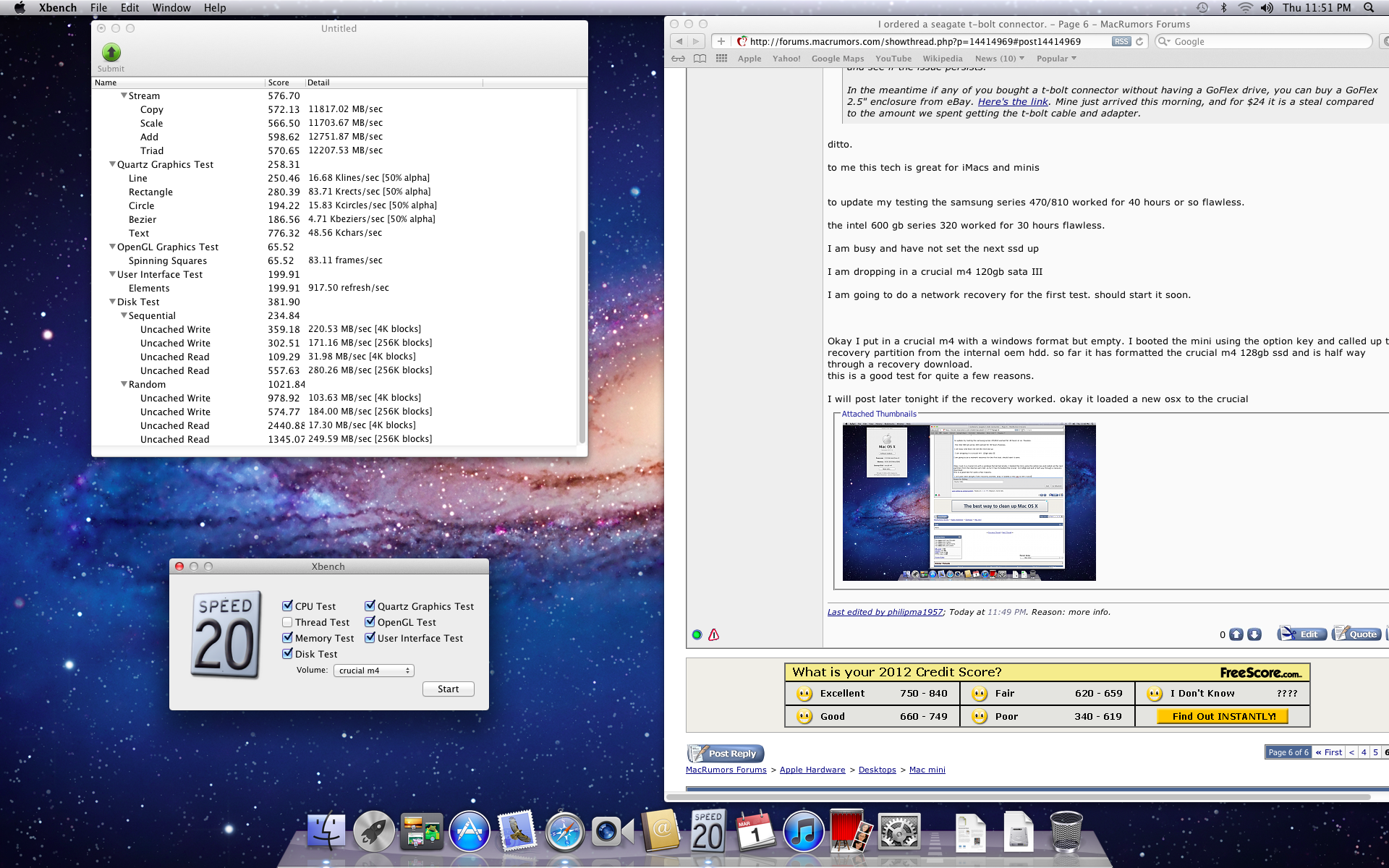

Okay I put in a crucial m4 with a windows format but empty. I booted the mini using the option key and called up the recovery partition from the internal oem hdd. so far it has formatted the crucial m4 128gb ssd and is half way through a recovery download.
this is a good test for quite a few reasons.
I will post later tonight if the recovery worked. okay it loaded a new osx to the crucial

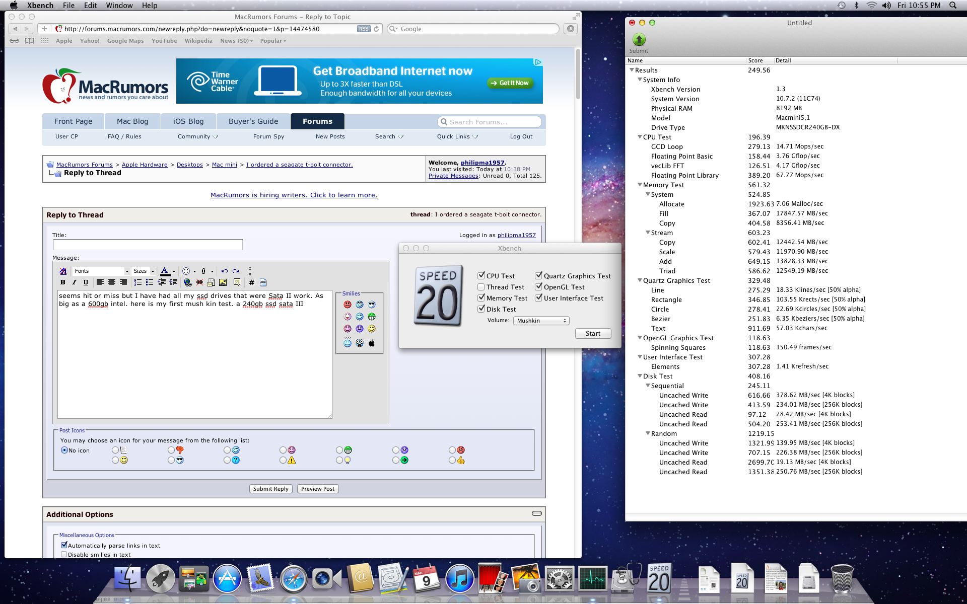

here is an xbench
and a black magic 380 read 185 write for this drive is okay
crucial specs it at 500 read 175 write see link and read for the 128gb.
http://www.crucial.com/pdf/Tech_specs-letter_Crucial_m4_ssd_v9-22-11_online.pdf.
I will run this for about 40 hours. so far it seems like the seagate has improved since the mini did the 1.6 firmware.

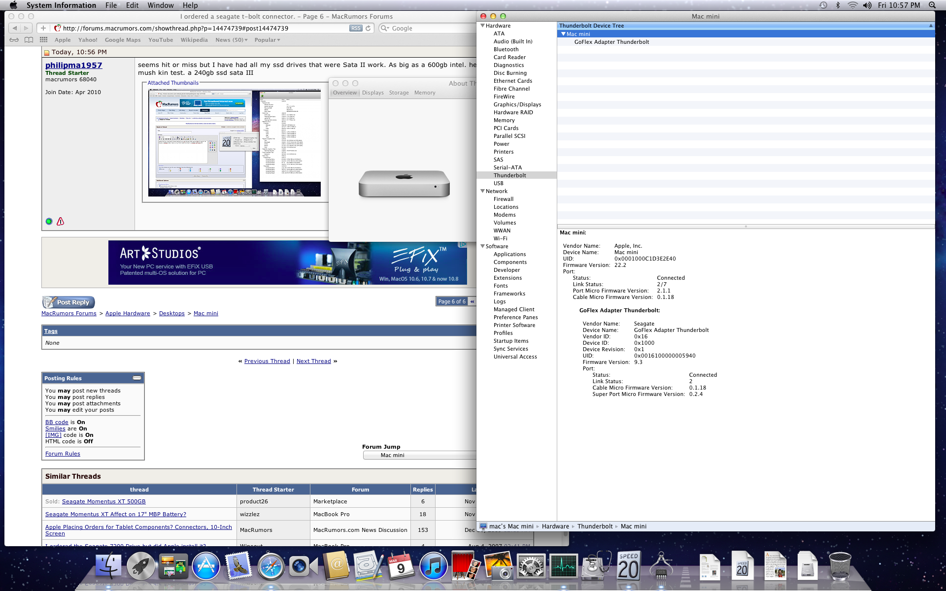

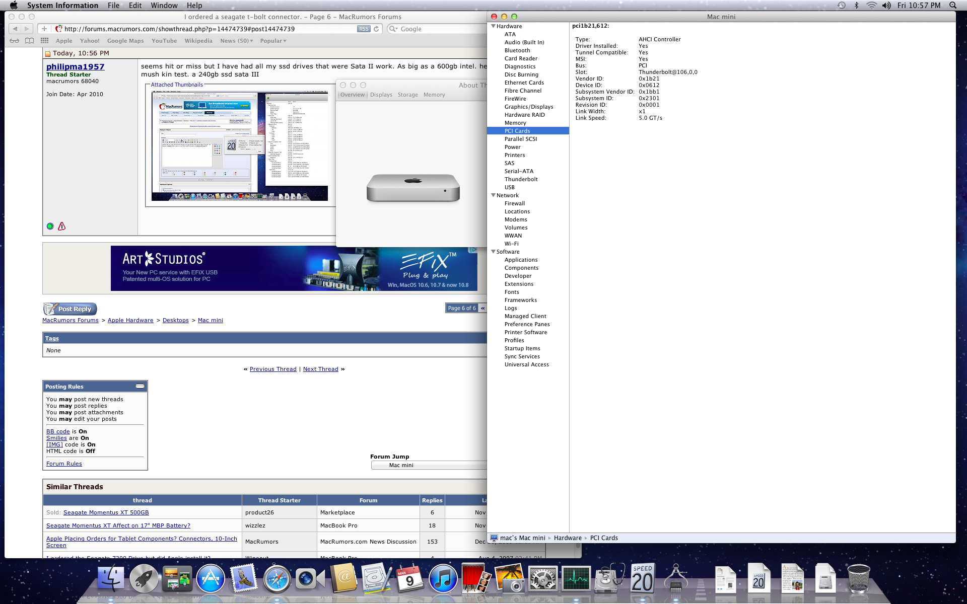

480GB OWC Mercury Extreme Pro 6G
I decided to test the 480GB OWC Mercury Extreme Pro 6G in the Seagate Thunderbolt GoFlex 2.5" adapter. The 408GB OWC Mercury Extreme Pro 6G was originally installed in a 2011 15" MacBook Pro 2.3GHz Quad-Core Intel i7. I removed the drive from the internal MacBook Pro 2.5" drive bay and replaced it with a 256GB Samsung 830 SSD HFS+ format and empty.
Initially, I had trouble using the Mac bootloader (hold option) to select the 480GB OWC Mercury Extreme Pro 6G installed in the Seagate Thunderbolt GoFlex 2.5" adapter. Not a good sign. Eventually, I got a clean boot. Things were looking up, I could access all the folder, iTunes, Safari, etc. Then I tried to do a large incompressible copy (Transformers Dark of the Moon Blu-ray converted to 720p m4v H.264) weighing in at 6GB. It copied to the temporary internal 256 Samsung 830 impressively quick (the Samsung 830 was showing its power with incompressible data). Next, I tried the reverse copying from the 256GB Samsung 830 to the 480GB OWC Mercury Extreme Pro 6G. The OS locked up immediately giving me a beach ball.
For reference, I had similar failed with the 512GB Samsung 830 on the 2011 Mac mini 2.7GHz Dual-Core Intel i7 and on the 2011 15" MacBook Pro. However, one combination of Apple Thunderbolt Cable and Seagate Thunderbolt GoFlex 2.5" adapter did successfully pass the test on a 2011 Mac mini server.
Similar to other people's experience, the smaller 240GB and 256GB SSDs do not have trouble.
An additional note, small file copy does not seem to be an issue.
On personal note, I am very disappointed in the Seagate Thunderbolt GoFlex 2.5" adapter because I was looking forward to RAID performance in a small, self-contained, portable package.

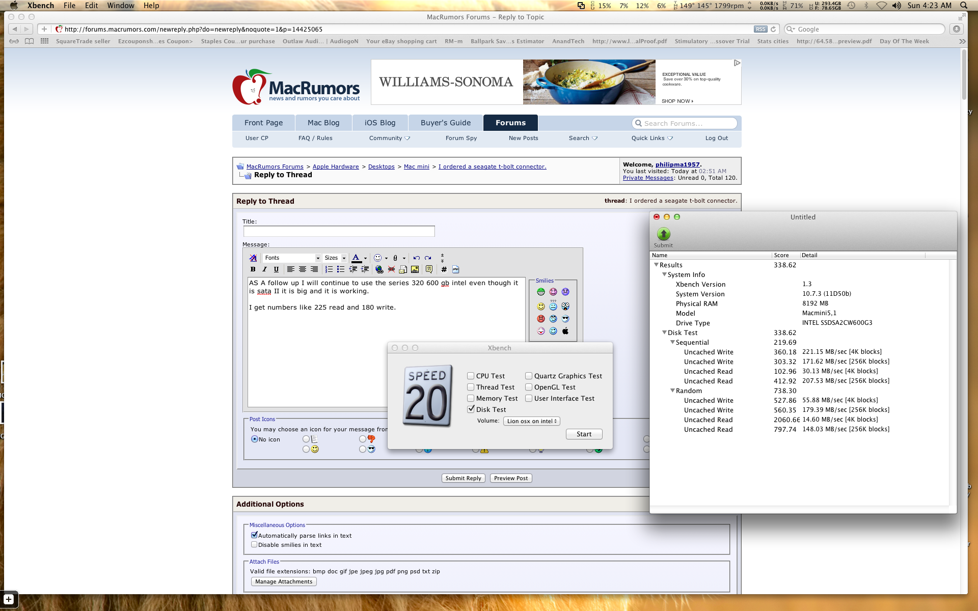

AS A follow up I will continue to use the series 320 600 gb intel even though it is sata II it is big and it is working.
I get sequential numbers;
like 225 MB write and 180 MB read.
along with random 4k numbers :
of 55 MB write and 14 MB read

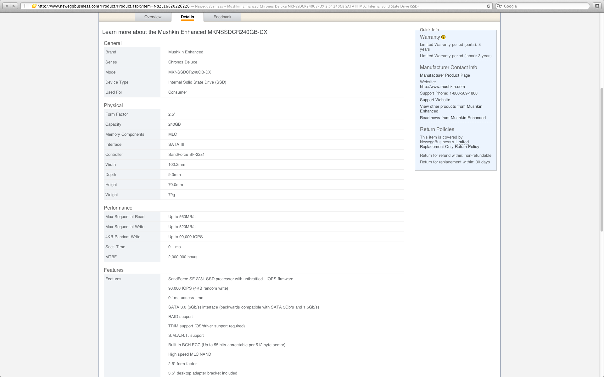

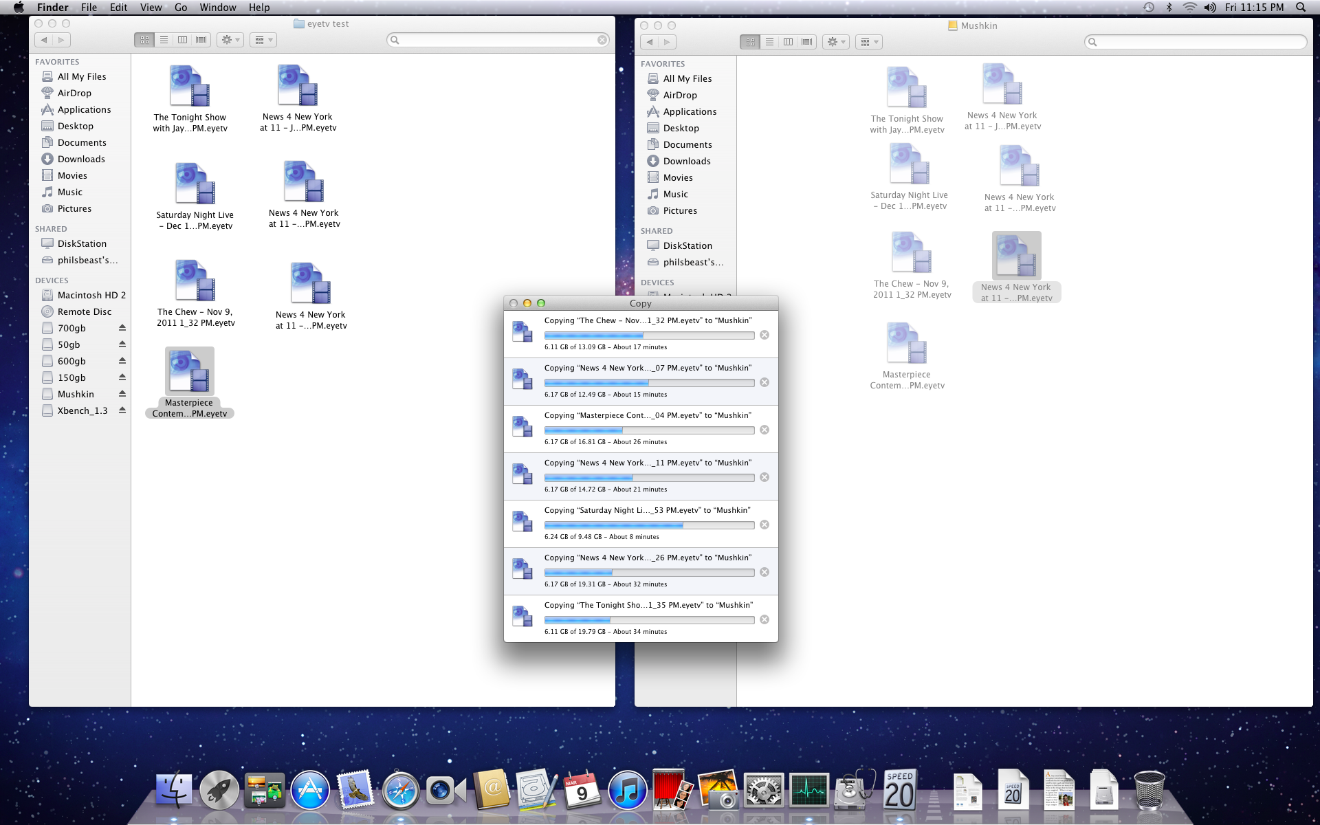

really is a shame as the darn thing works great with my SATA II series 320 600gb intel. I am going to run it with a 240gb series III mushkin ssd today. Has a sandforce controller and is a new ssd never formatted or used. I had to do a lot of clean up first I hope to start testing in an hour or so.

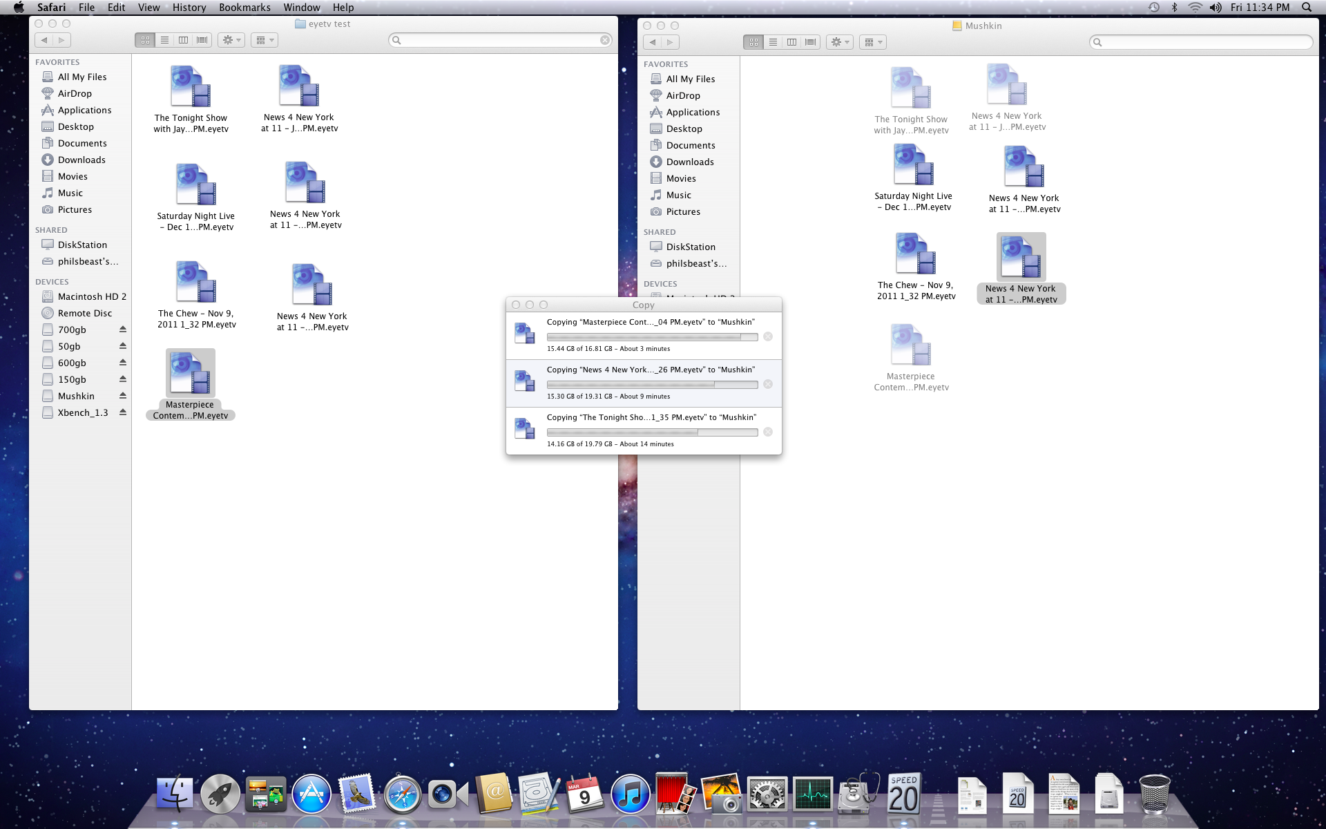

I will format this for mac. I will copy large eyetv files to it 18 gb in size. this seems to be the acid test.
this is the drive.
http://www.neweggbusiness.com/Product/Product.aspx?Item=N82E16820226226

here is my first mush kin test. a 240gb ssd data III on xbench
here is the second test 7 big files on a mass copy so far so good. but this is from the internal 5400 rpm hdd. still it is a complex task. almost done
