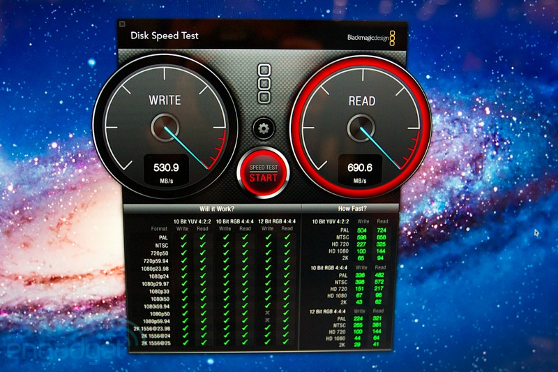

HMMMMM all bets may be off.....
for $599 you get 4 gig at a 700 read and 500 right plus the ability to daisy chain and no need for the Seagate t-bolt! WOW this seems like a great investment. But my question is how is this possible via HDD and not SSD's??
http://www.engadget.com/2012/03/15/western-digital-mybook-thunderbolt-duo/#continued
that test uses at least 2 units maybe 4 units. one unit is 599 a pair of 2tb hdds so if it is 4 sets cost is 2400 not 600. still for fast storage at 600 it is less then the lacie the lacie 4tb is 649. also remember that test for long write and reads. not osx and programs.
the ideal setup for a mini may be one of those and a seagate adapter. run those for large fast storage and run the t-bolt for osx. more and more this gear is showing that the mac pro is not long for the world.

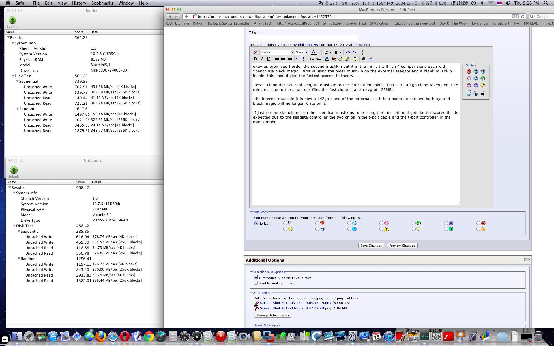

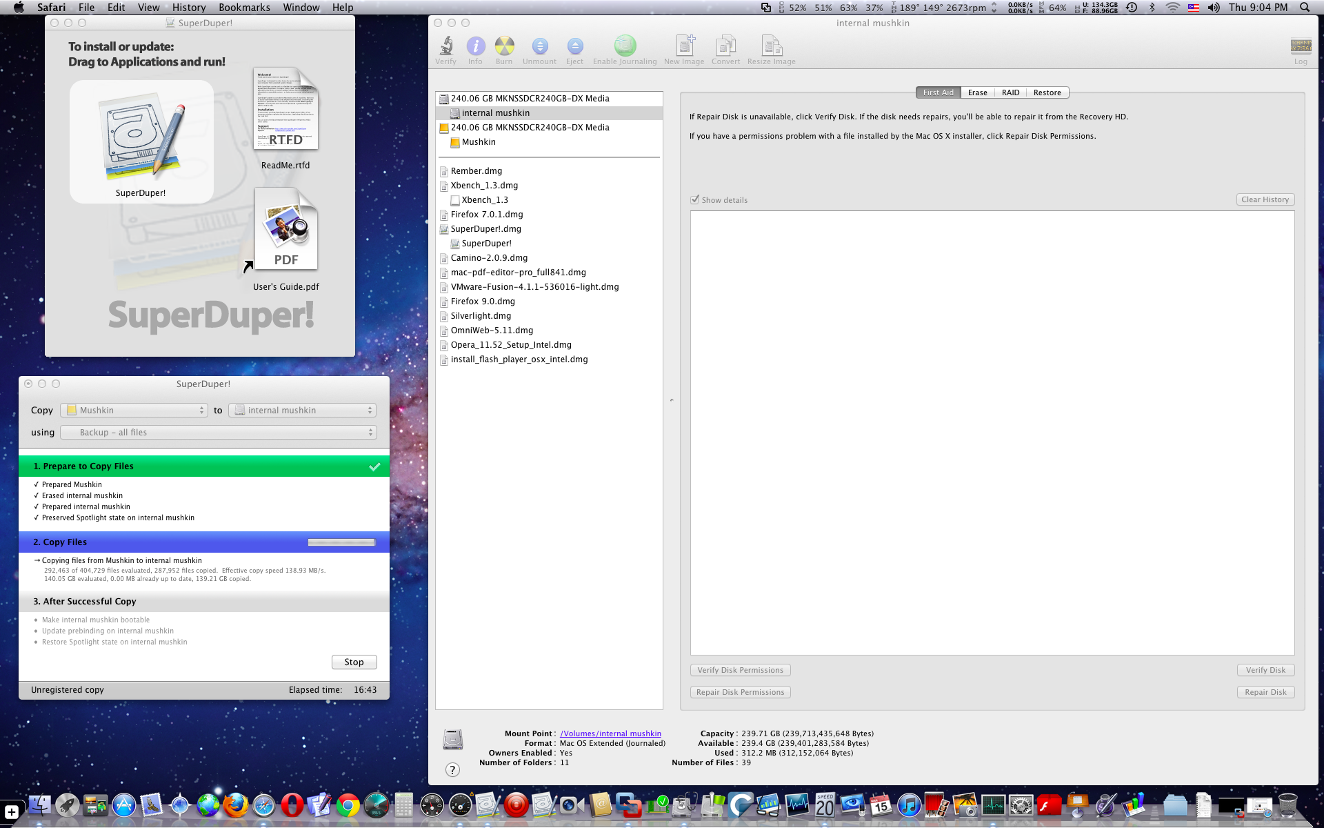

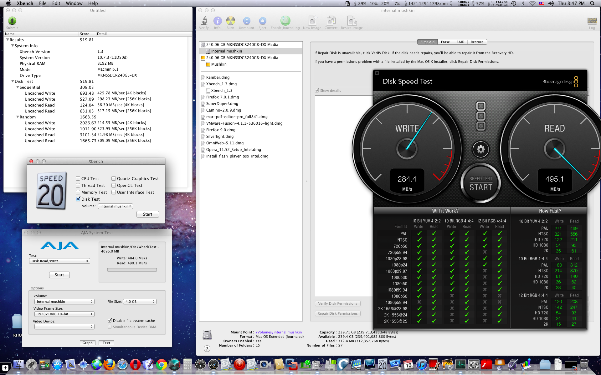

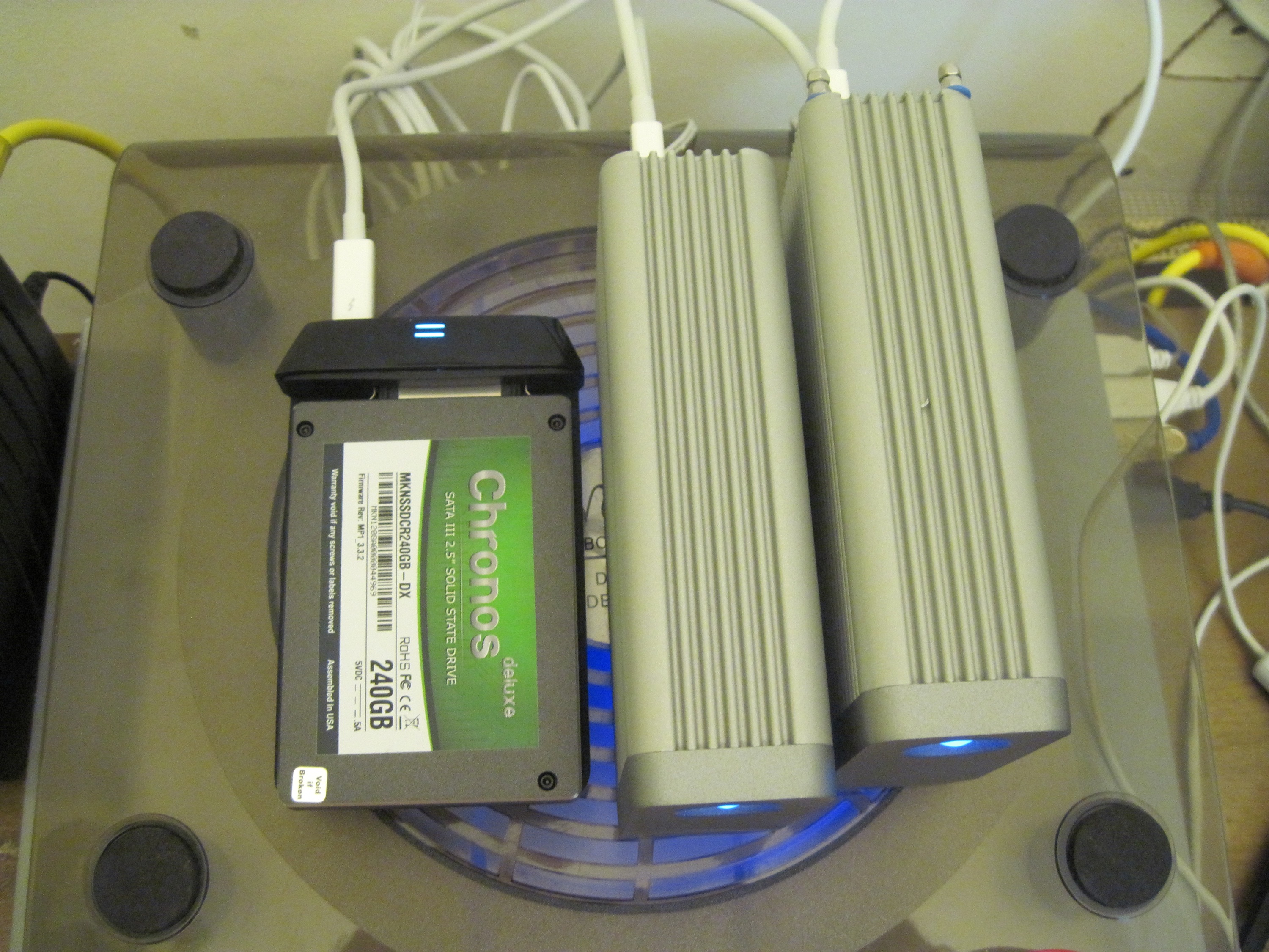

okay as promised I order the second mushkin put it in the mini. I will run 4 comparisions each with xbench aja black magic. first is using the older mushkin on the external seagate and a blank mushkin inside. this should give the fastest scores, in theory.
next I clone the external seagate mushkin to the internal mushkin. this is a 140 gb clone takes about 18 minutes. due to the small osx files the fast clone is at an avg of 133MBs.
the internal mushkin it is now a 142gb clone of the external. so it is a bootable osx and both aja and black magic will no longer write on it.
I just ran an xbench test on the identical mushkins one using the internal mini gets better scores this is expected due to the seagate controller the two chips in the t-bolt cable and the t-bolt controller in the mini's mobo.
this shows the slowdown quite clearly.
next test I will erase the external mushkin and run all 3 tests.
