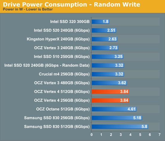

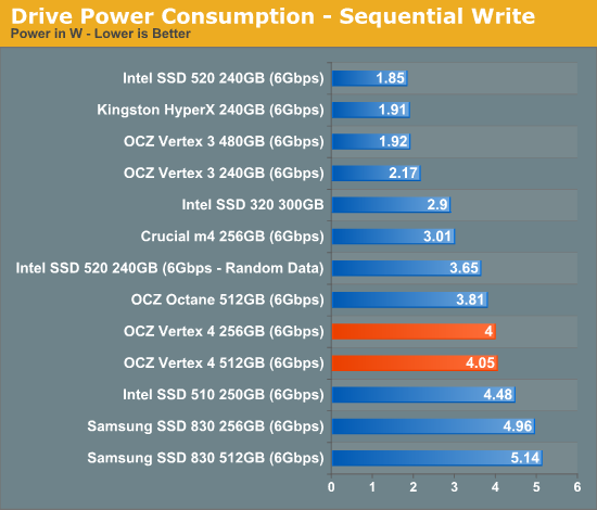

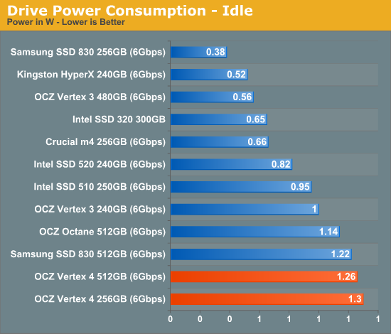

So I think I found the reason that the Samsung 830 512GB doesn't do well in the Seagate Thunderbolt Adapter, non-desktop version.
Anandtech did a review of the newly released Vertex 4 and I noticed in the graph that the Samsung 830 512GB had some MASSIVE power consumption. The Samsung 830 256GB also had some MASSIVE power draw as well as times.
