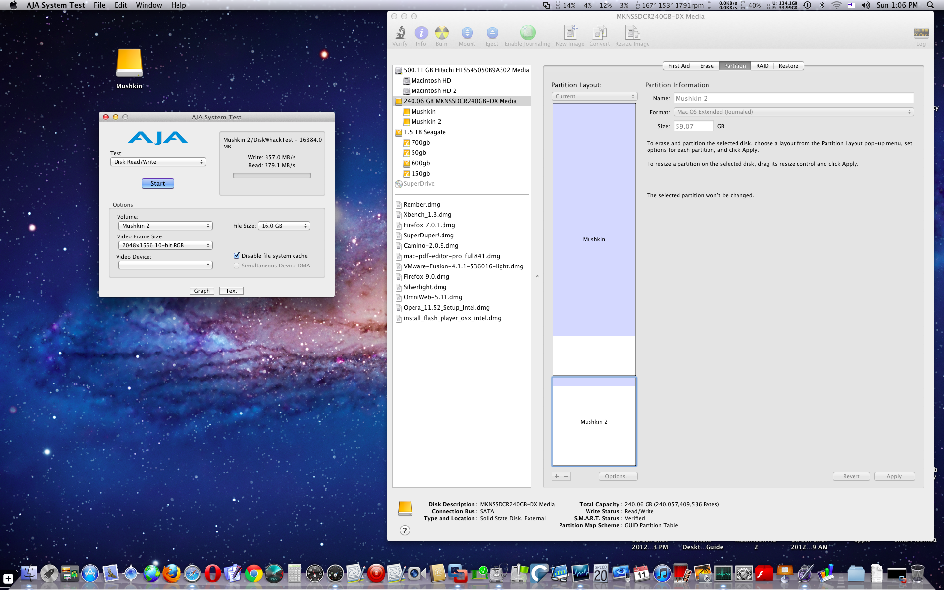

to mods please forgive double post. due to more tests. the mush kin has fast speeds on this test. not 500mbs.
here is an aja speed test once again really fast true sata III speeds not what the mushkin advertises but good.
I would have to say so far this mushkin is the fastest largest ssd that works well with the seagate. I paid 278 for it at newegg and 100 for the seagate and 50 for the cable total of 428.
and it is 240gb 1 dollar less then the new elgato ssd and twice the size. and 40 percent faster.

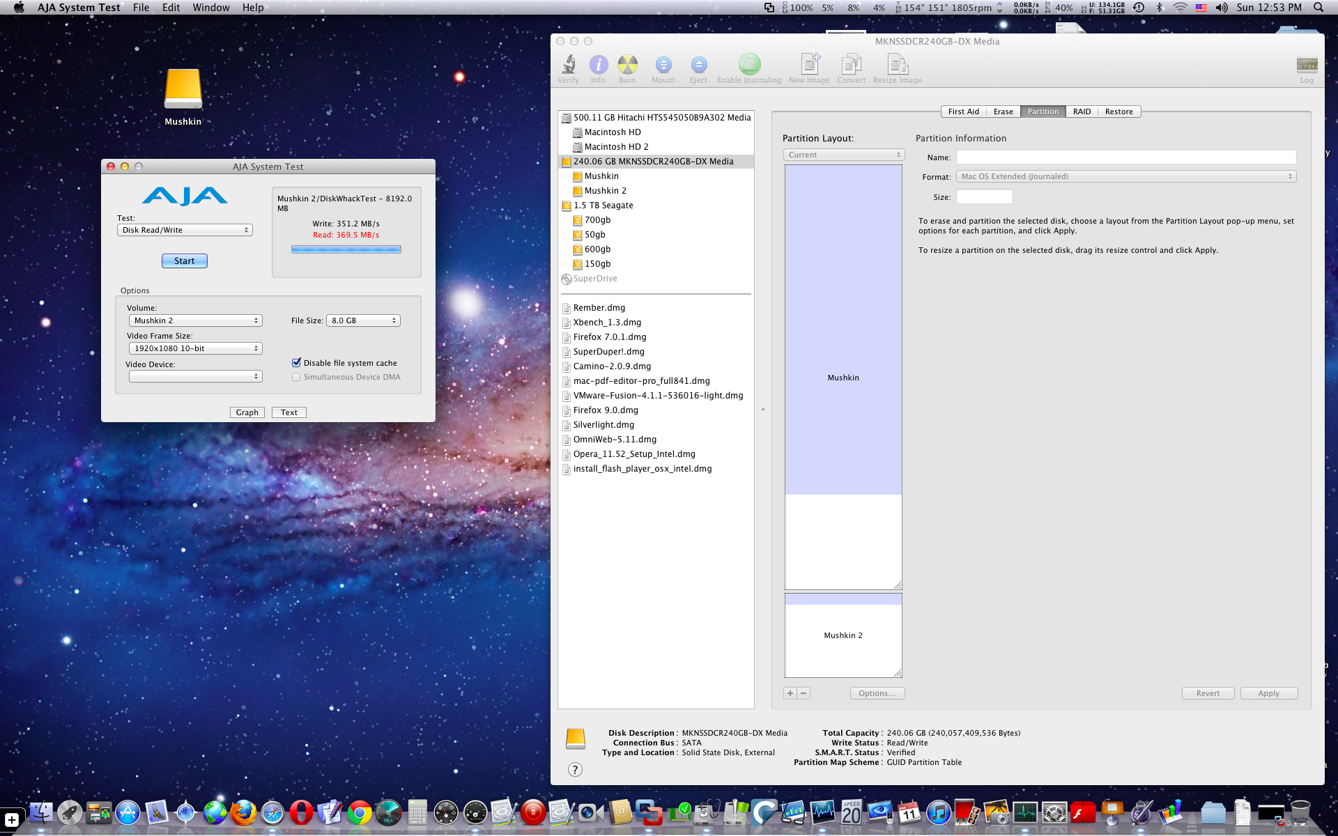

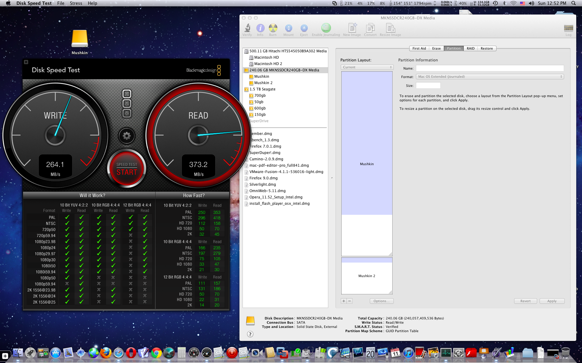

There has to be a bottle neck..... That should be faster then that.
the reason is the testing can't be done on the drive if it is the boot drive.
so the actual program is not on that drive it is on a slower drive.
The best way to get a full speed test would be if my internal was a mushkin and my seagate was a mushkin. then I could use the internal to test the external and the external to test the internal. when the cpu is reading the program on either ssd to test the other ssd you would get your truest results.
I do not have 2 mushkin ssd's to do the test that way. besides the numbers clearly show the seagate can exceed sata II speeds for read and write.
the aja numbers both exceed 315MBs for read and write.
those numbers only count for long file copies or hd video filming.
for most of us the 4k random read write numbers are the key.
the best I could do to make it faster was partition the mushkin into a 200gb and a 40 gb set of partitions. the 200 gb had the osx and the 40 gb was empty this speed the results up a bit but it still not a true real world test. aja did improve on the write speed from 317 to 350 .
still the soft ware was on the mushkin not the internal 5400 rpm hdd. thus the increase in speed.
write speeds of 350 with read speeds of 360 are smoking fast and in reality the ssd is most likely exceeding those speeds only if you are doing long file copies.
as 1 last test I made the empty partition 60gb on the mushkin and the osx is 180gb this sped the test up a bit more. 357 write and 379 read.
I wish I had a second ssd to do the test perfectly.
use the out side to test the inside and the inside to test the out side. this would give the max results and would show if the internal interface is faster or slower then the seagate.

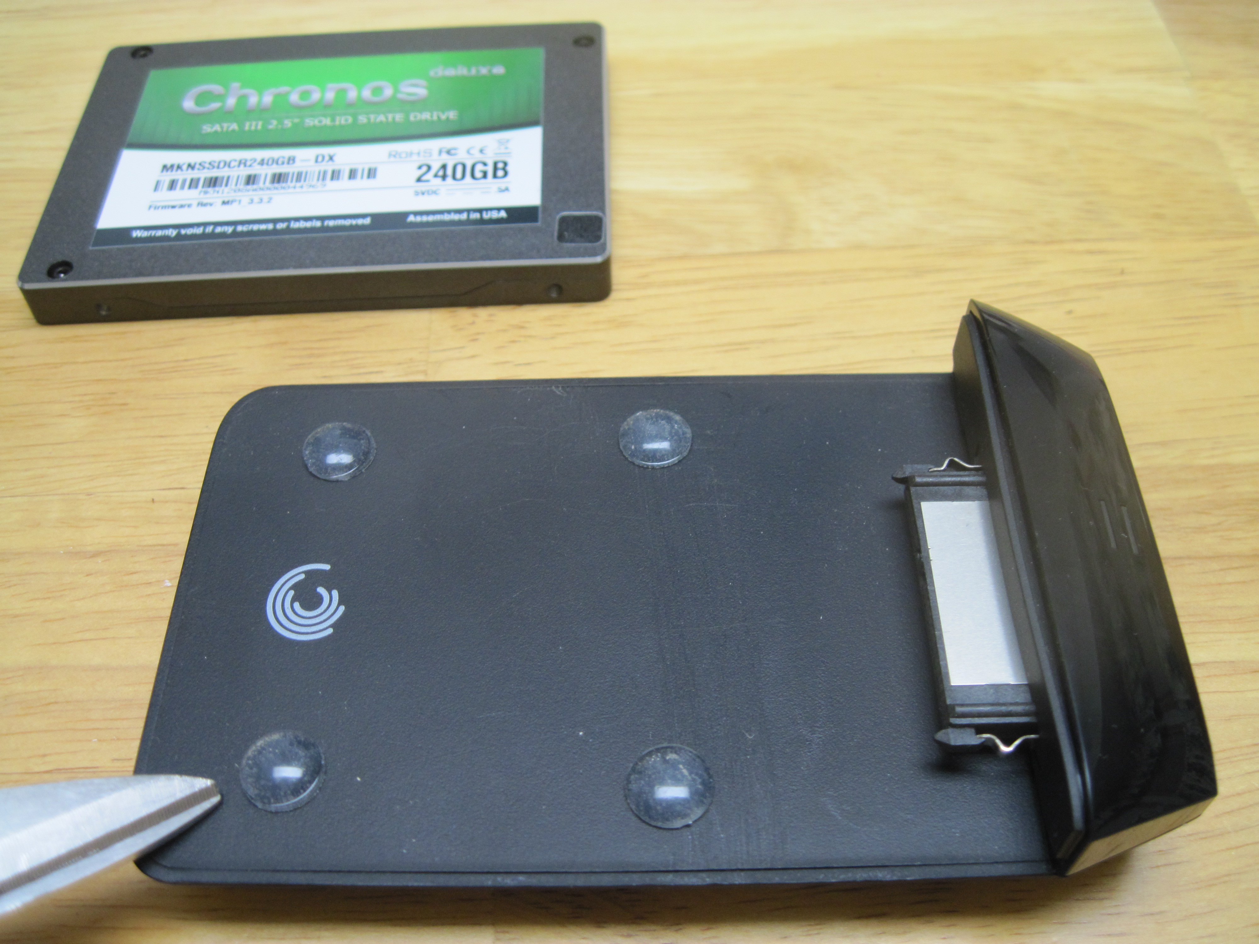

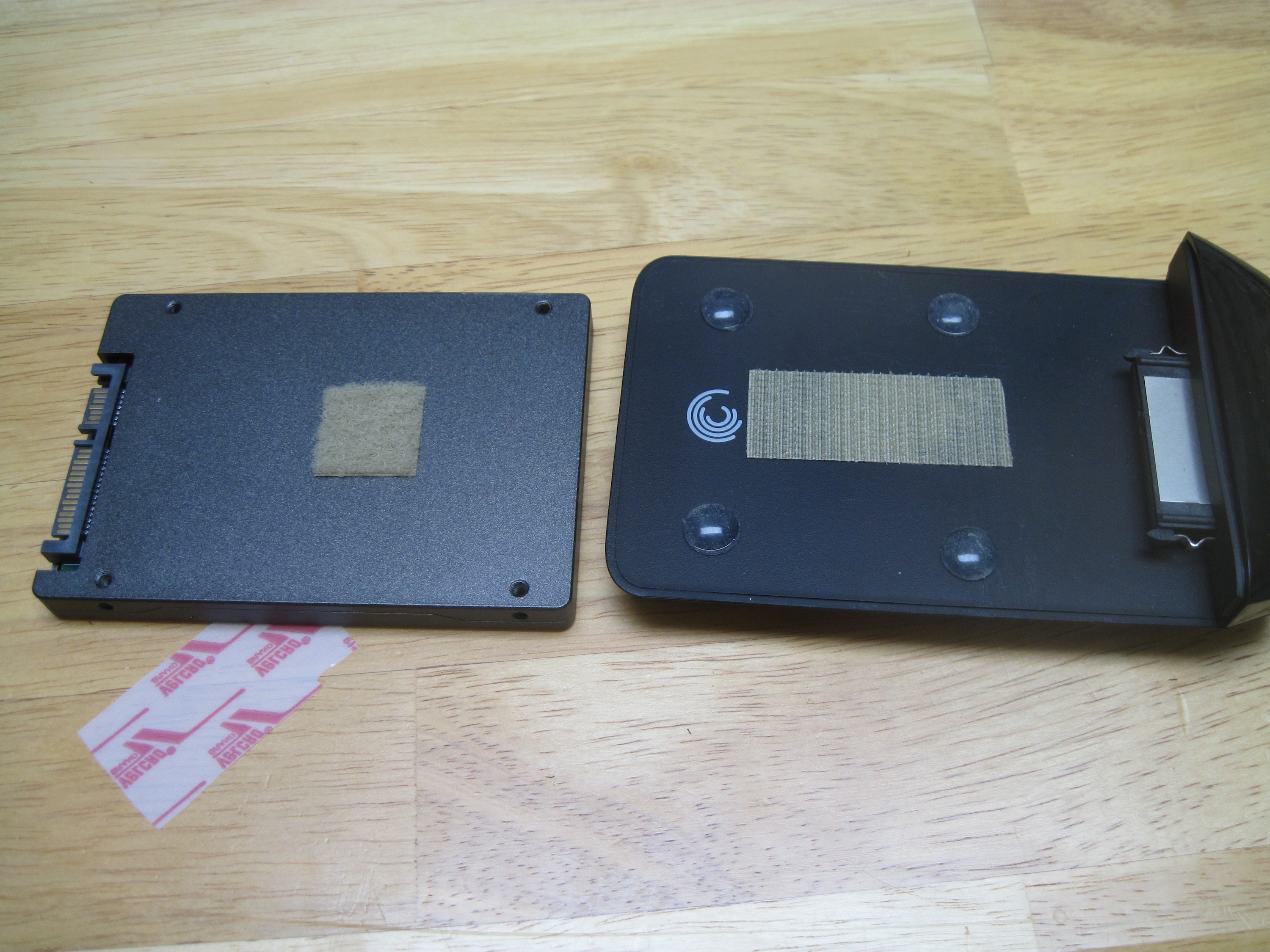

I am using 4 small rubber feet.
Plus a small velcro patch.
(velcro is hidden).
I will post a photo later.

If I understand you correctly, the boot drive is the seagate ssd right? Or no? And what your saying is that the slower hdd that has the testing software is hurting the speeds of the ssd when being tested?In real world computing are you saying even though the test show 300+ that when pulling files to and from the ssd it would be more like the speed the mushkin is rated to be? Like I said I would love to go this route and not have to mess with or lose a hard drive in my mini for an ssd if I could go this route, but to me it,s pointless to spend alot on a ssd to not have full speed, that's why I'm so curious as to how much loss of speed there is using the seagate route. If you have a 20% loss or more I guess I just have to put the ssd in the mini
No you are not interperting me correctly. Or I am not writing it clear enough. The various ssd speed tests that are being used are not giving you a true picture of the real speed of the ssd.
the mush kin that I posted is smoking killer fast .
It is as simple as that.
The only way to test if the seagate is slower then the internal connection is use 2 identical ssds. that are fast enough to exceed 400 MBs like the mush kin can do under the right setup.
If some one wants to lend me a mush kin that is the same as mine I will do the the tests.
remember max speed (500MBs) is in theory not practice. and even if the ssd is 10 percent slower in the seagate then the mini or the iMac the external hookup is easy and can be moved in your pocket from work to home and used on different iMacs mac minis etc.

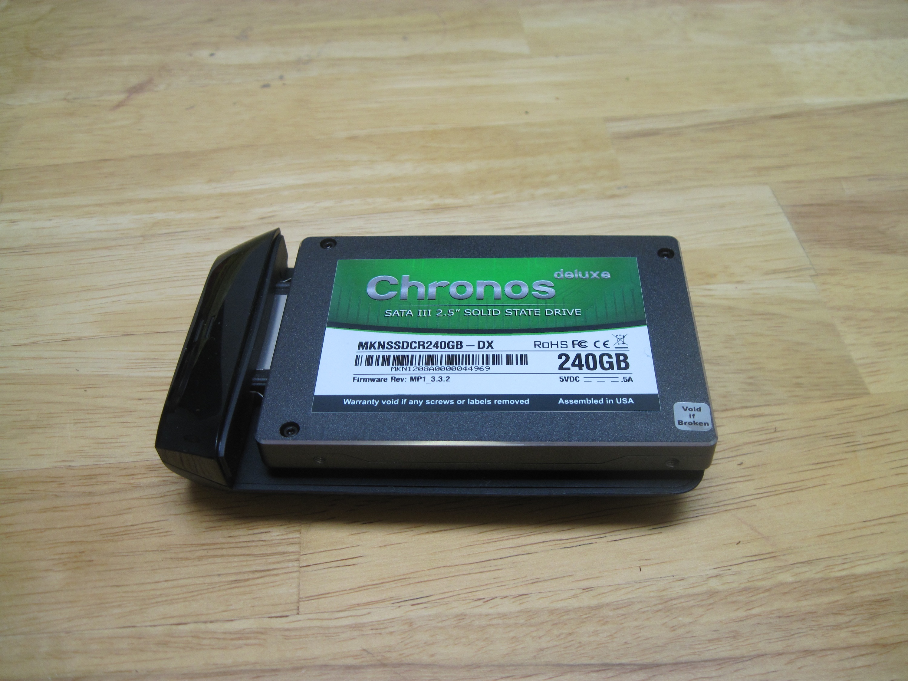

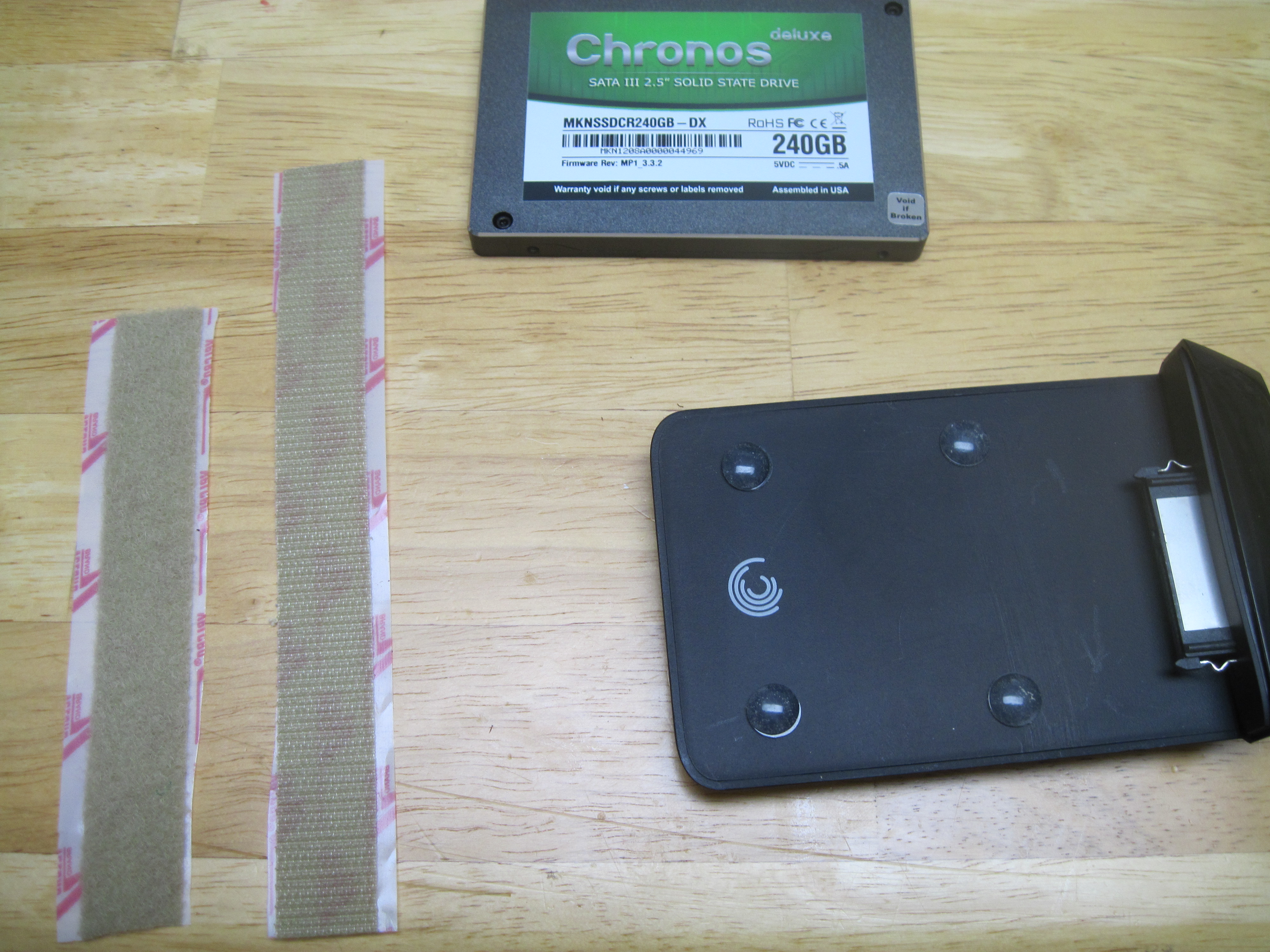

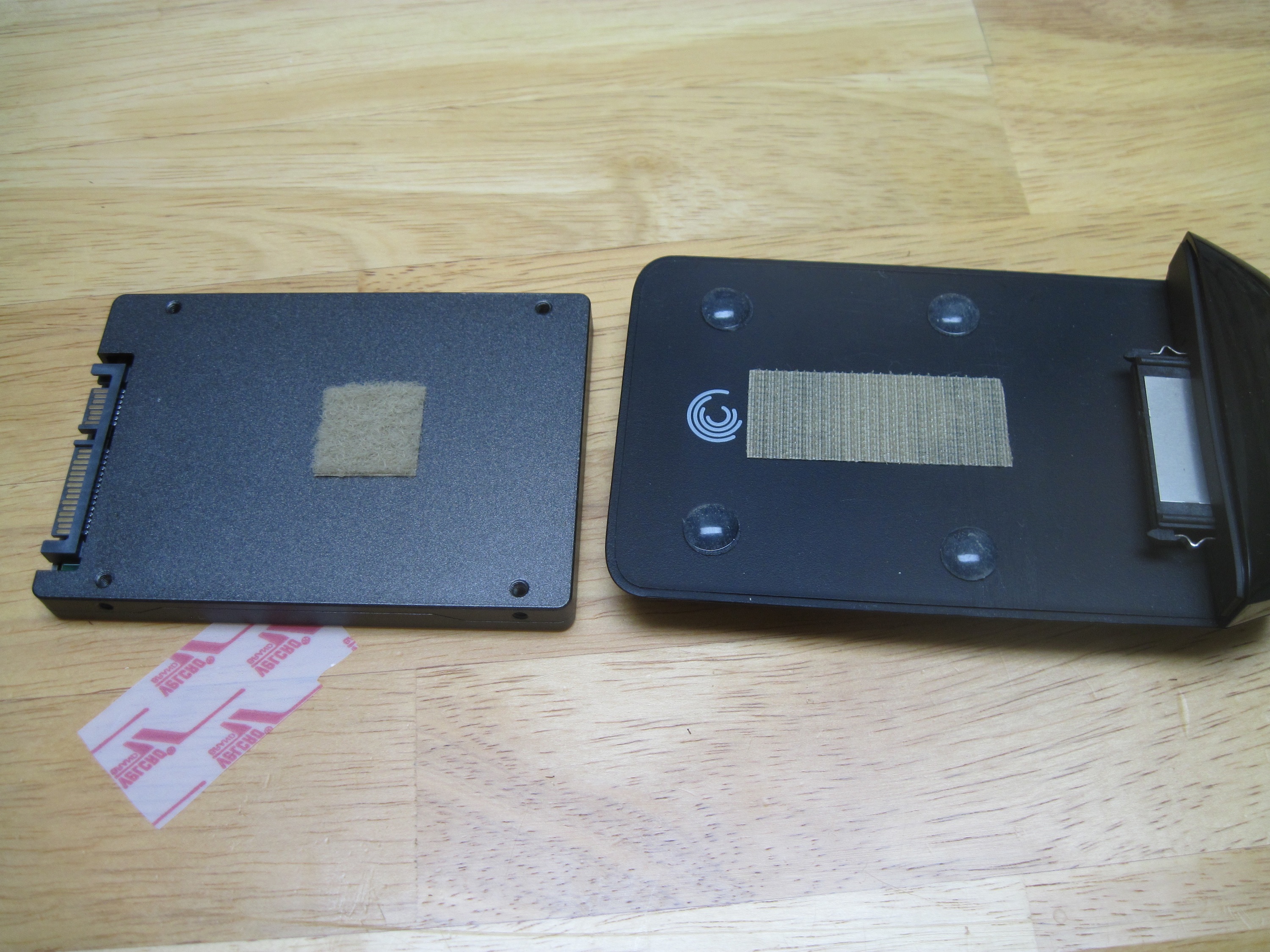

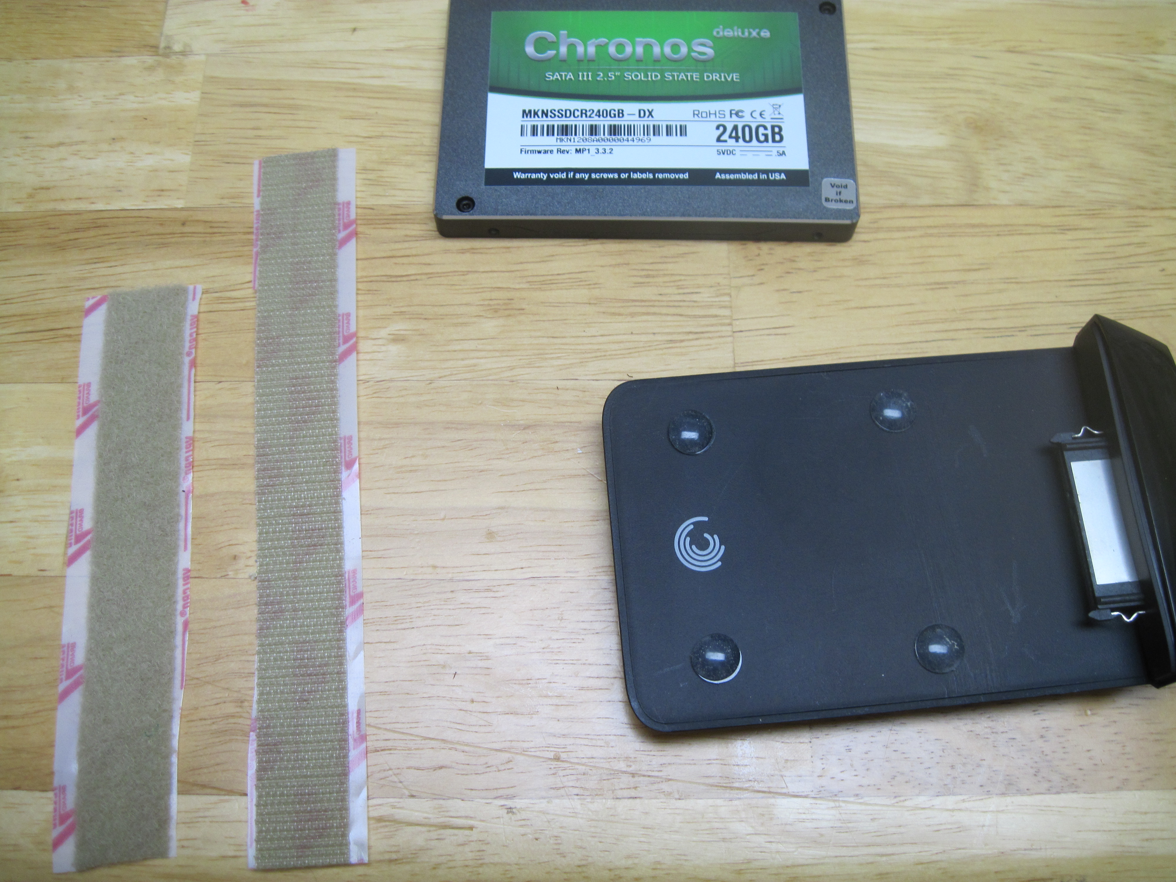

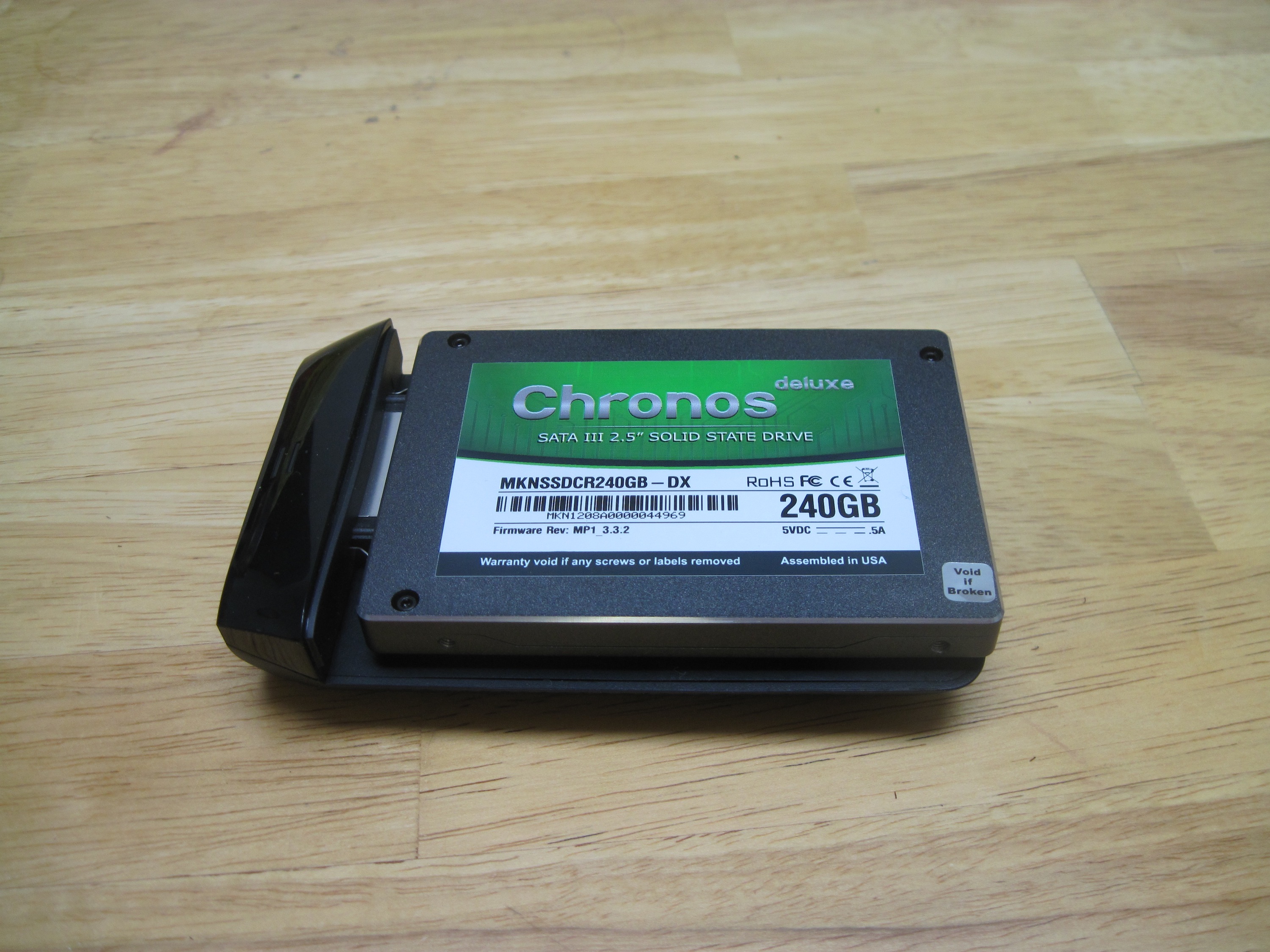

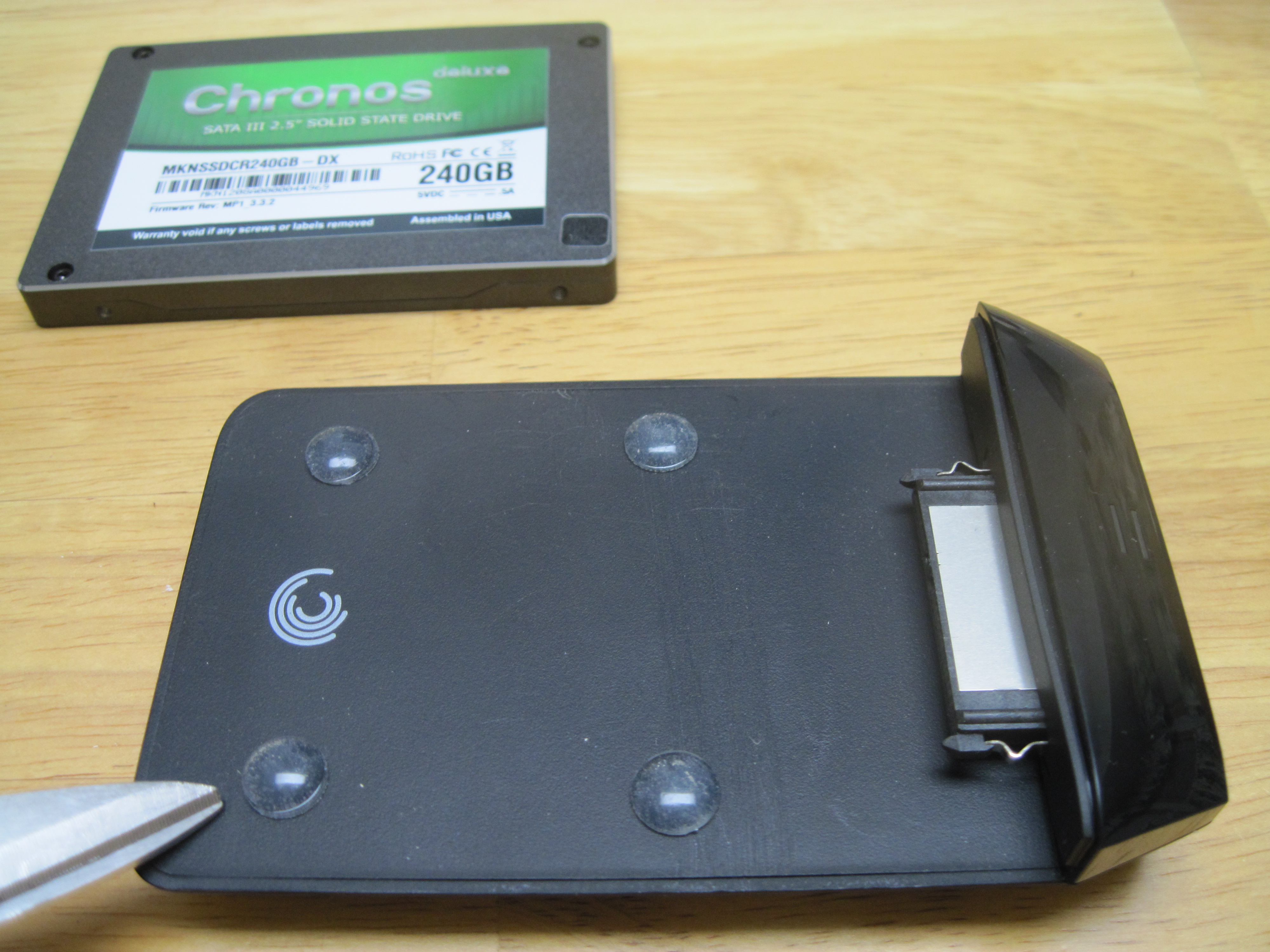

these 5 photos show how I have chosen to mount the mushkin ssd.
four small rubber bumpers. plus some velcro.
so this item cost under 450 keeps warranty.
iMac wants 600 more for a 256gb ssd that is slower.
this would not void your imac warranty your mac mini warranty.
mac mini server wants 550 to keep one hdd and swap in a 256gb ssd.
the high end mac mini with discrete gpu wants 750 more to bump the hdd and add a 256gb ssd.
so this saves money is fast and easy to do. All my testing has been with base mini and server mini.
others have used this gear with the other two types of models it works really well with the correct ssd.

Philip.
Your method for filling the gap between the drive and the adapter using the bumpers looks good. And the use of velcro is a good idea to secure the drive.
I took a much simpler approach. I took a small stack of business cards and I found that eleven business cards is the right number for me to fill the gap between the drive and the adapter.
I then cut the business cards so that their length matches the width of the adapter. Then I cut the cards in half lengthwise.
The drive is supported at one end by being connected to the adapter, and it is supported at the other end by a stack of business cards cut to size. I like the idea of supporting the drive at both ends while leaving a space in the center because the drive does get warm with use.
My drive sits on my desk untouched. So this works very well for me.
