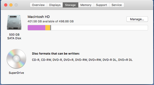

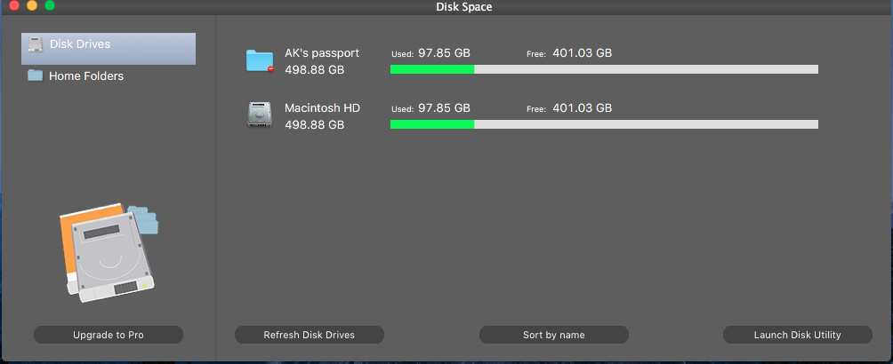

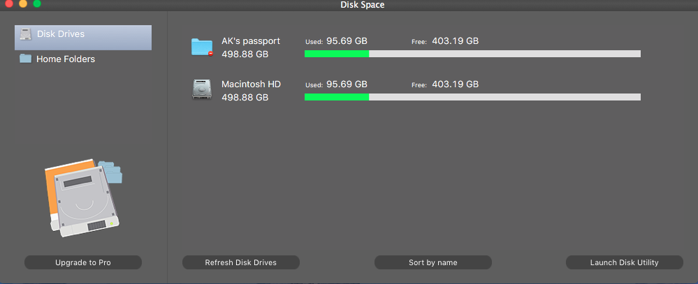

I've got a little bit of good news about my issue. Yesterday, as an idea, I downloaded the disk space app because I couldn't read the about my mac information about my HDD. When I ran it, I was pleasantly surprised I actually got a reading from the aforementioned new app (from the app store, not a third party app)
I don't know how much time I have left until my MBP goes down again. However, I think I can get help ordering the right part in terms of SSDs soon. (I'll mention that you all recommend that I get a SSD.) Who knows, maybe I'll even go to the store and get it and save on shipping and handling.)
I'm actually surprised on how little of space I have taken up on my broken HDD. I have now had it for a little over four years now and this is the biggest problem I have had with it. (So, I think.) However, the battery life is kind of pathetic, I have to charge my MBP every night or keep it on charge while I use it. When do you all change your battery? Should I buy a new battery just in case?

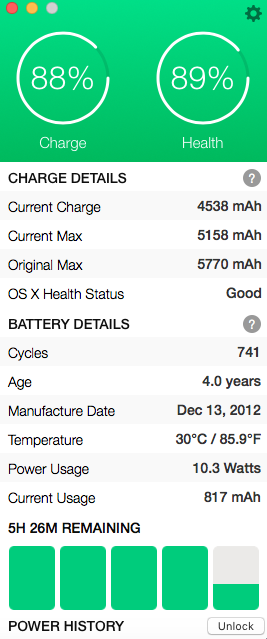

To me, my battery seems OK since it has just under 90 percent of battery life for being "old". (Not my words.) I'm only posting this to ask a question about the battery. If I go back sometime in the future, what will replacing the battery actually do, it won't bring back my HDD to full functionality. It won't improve the speed. Will it? (I've never replaced the battery, so this will be good to know in the future.)
If you're recharging the battery more often than in the past, there's two likely reasons. 1) The battery is becoming less capable or 2) your computer is putting more demands on the battery. The data that your computer is putting out indicates that your battery is still pretty capable so I would look at whether your computer is using more power than it has in the past. Possible reasons for that include: 1) newer Mac OS's may require more power; 2) some software you've installed uses more power; 3) websites you visit may require more power or 4) your HDD, in it's current state, may require more power (so yes, we may be back to the issue of the HDD). If you're planning a visit to the Genius Bar, your battery issue is something that they could effectively address in person than any of us can online.
One thing you can do is open the Activity Monitor app and while you're not doing anything, see what the graph is for the various components. There's one for energy usage. The computer does various housekeeping chores when it's not actively being used so don't be alarmed if you see periodic spikes in activity. If you're seeing a lot of activity while it's not being used, that could indicate some software or hardware is the reason why you need to charge the battery more often.
To answer your question about the battery, in it's current state, I think a new battery may mean you have to charge less often. That's about it.

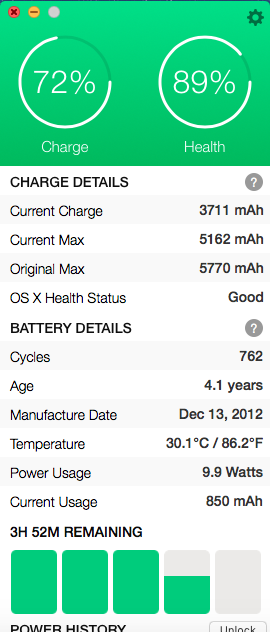

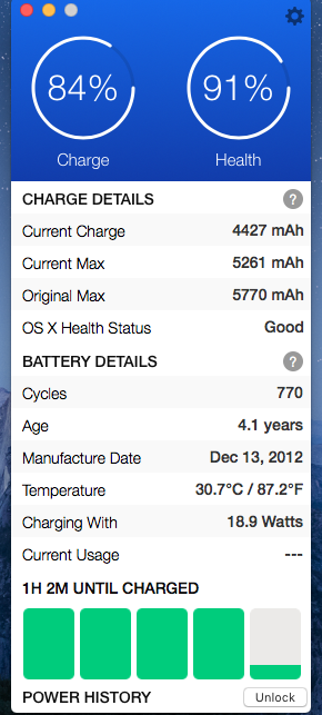

A 2% capacity improvement since last Tuesday? So I was just thinking, what is the health? Is it the battery or the overall MBP. I've never replaced the battery and maybe when I make my appointment and go in for it, I'll show the technician the battery screenshots. Is there anything else I should keep my eye on? I know that the "About my mac" is all screwed up sometimes. (The bar graph. Sometimes I can tell what's on it and other times it's all greyed out. It's stuck on "calculating" most of the time. (Like now.)) The diskspace app gives me a reading, though, According to that, I've only used 96.79 MBs out of 498.88 GB hard drive. The original one.
Battery capacity dropped considerably since the last post with the picture. I'm not able to take it in yet, but if I were to show the screenshots of the battery monitor and it's capacity to the technician, how likely is my problem all battery related. I think I included a battery picture before I made my first appointment when the bracket was replaced.
I've never replaced my battery and the sudden drop in capacity is quite surprising. (4%, 91% to 88%.) I'll check again tomorrow and see what the reading is when it's fully charged.
It's not unusual for battery stats to fluctuate some. A technician can perform a test designed to look at detailed health info on the battery. To me, it sounds like the battery probably isn't your problem. The Apple Hardware Test and a SMART test can confirm this or start to rule out the more likely causes, which you can do on your own should taking it in not be practical.
You've mentioned going to the Genius Bar in the near future. If you go there, you can just give a short explanation to the technician of your concerns and they'll take it from there - they have their own tools and methods to determine the battery health. As I mentioned earlier, going through this process is also almost certainly going to result in a better diagnosis than any of us can do online.
All of that being said, I'll give my opinion that it's very unlikely that your earlier problems were due to the battery since your battery issues seem to be recent.
