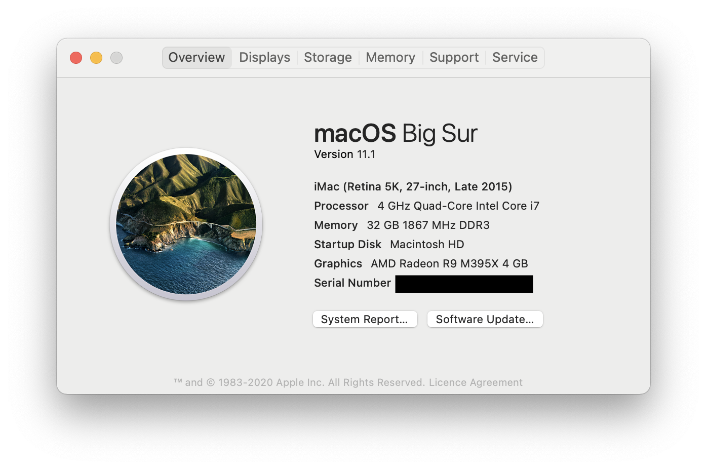

Just curious, is your machine a 4ghz i7?
Yes it is!
