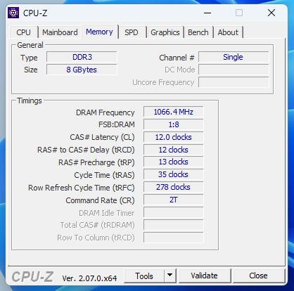

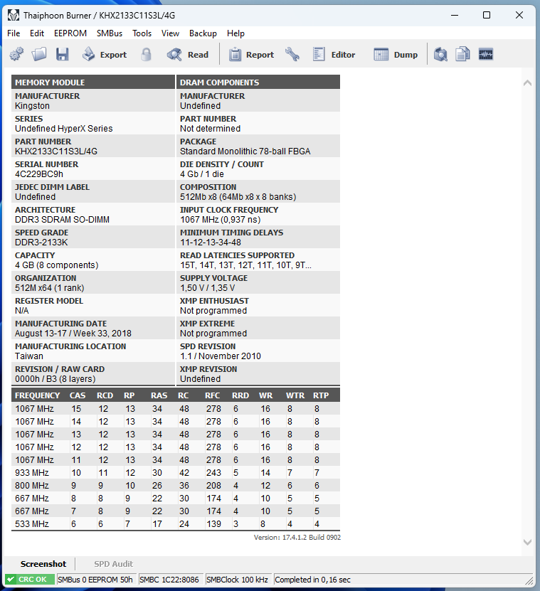

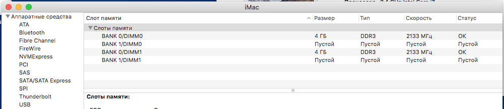

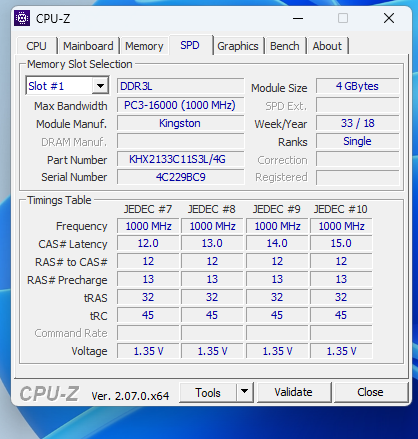

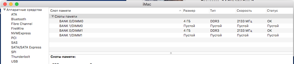

Test ok! Ram memory 2133 Mhz

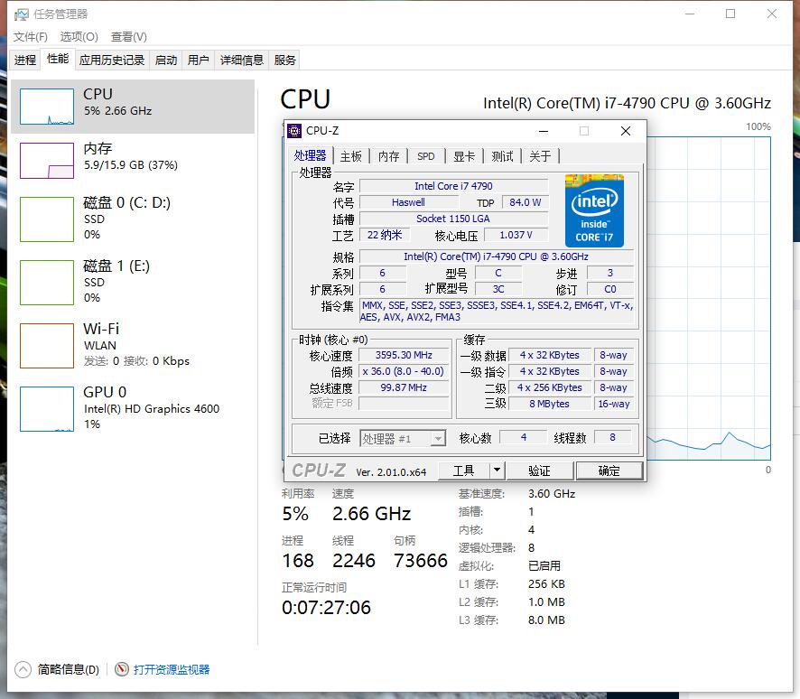

I want to buy an i7-4790K processor.
But I don't know how to properly modify the BIOS. Who can properly modify my BIOS for i7-4790K? :)
  • iMac27.bin.zip
Reactions: DCBassman
If you want to buy it for the machine in your signature, you can't. Wrong CPU socket. And no Mac of any description, as far as I am aware, plays well or even maybe at all with -K suffix processors.
  • Wow
Reactions: idenis42
@idenis42 your socket is LGA1155, and the machine is designed for Sandy Bridge processors. You might rewrite firmware for Ivy Bridge processors, third generation, but there's no way to use Haswell 4th gen in that machine, which is LGA1150.
Reactions: idenis42

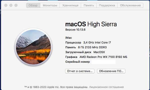

Hi guys! Me again.......... In one iMac 27 2011 I have putted AMD WX7100. All OK. After that I started to patch the iMac firmware. In a certain moment, the NVRAM became corupt and I can not boot without Command-Option-P-R. I have tried all. Restored default firmware on both. Different firmware on WX7100. Changed memory. Sonoma and Ventura..... Different OC, OCLP. Maybe you can help me. Thanx!
What's not working for you? Send a photo
After NVRAM reset (Command-Option-P-R) I can boot to Ventura/Sonoma. But if I reboot again, I have KP. And I need to reset NVRAM. Meanwhile I reinstalled the genuine graphic card and all is OK. So, the culprit is WX7100. I will program it with CH341A and see if any changes. I'll keep you updated.

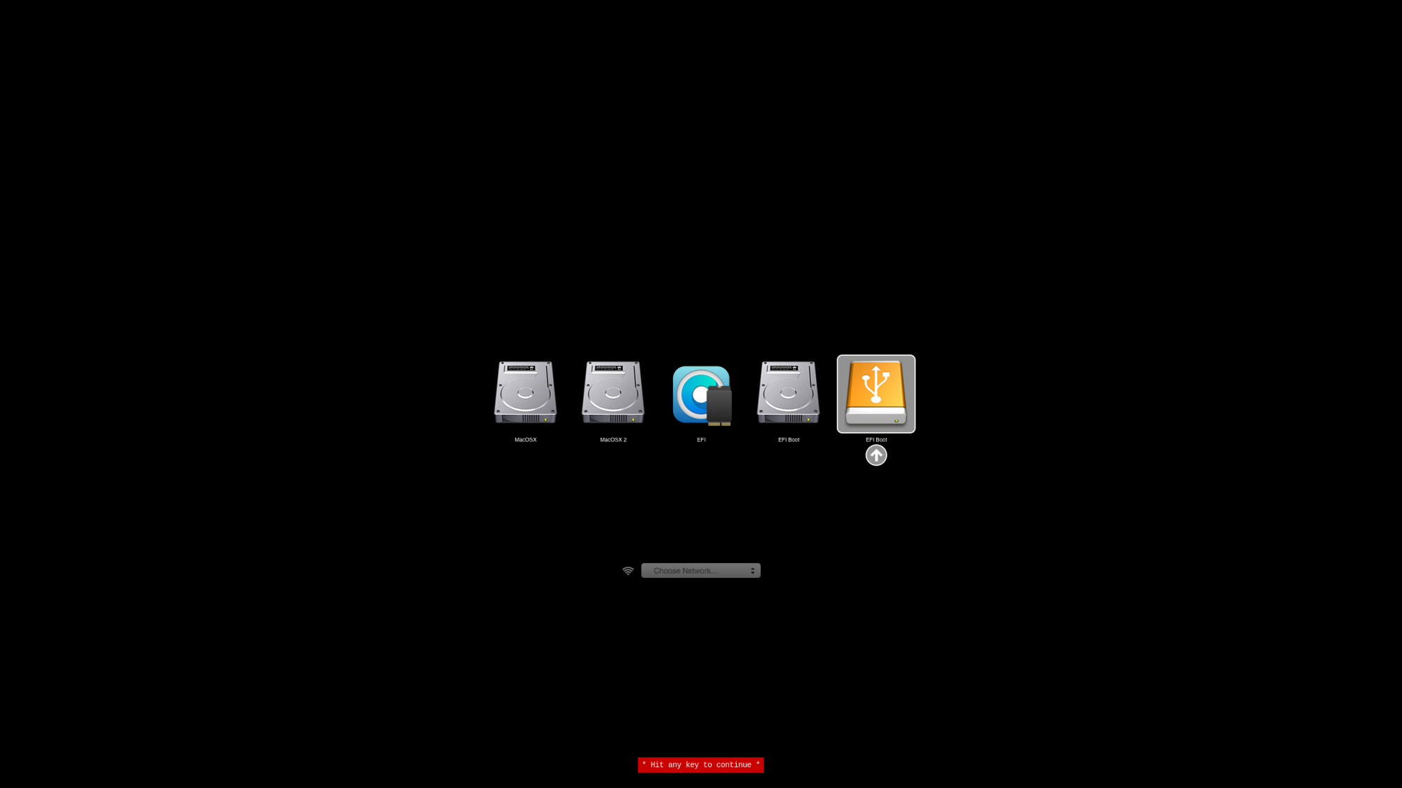

I installed the CrScreenshotDxe.ffs driver in BIOS
I was able to record a screenshot using the LCtrl + LAlt + F10 buttons.
