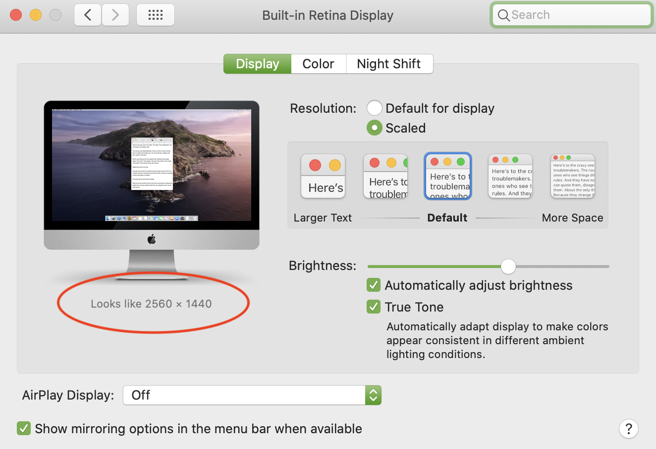

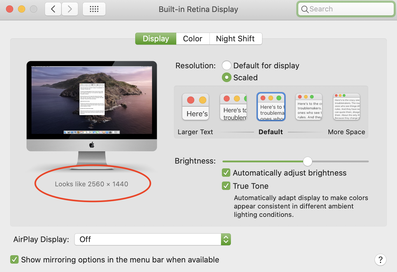

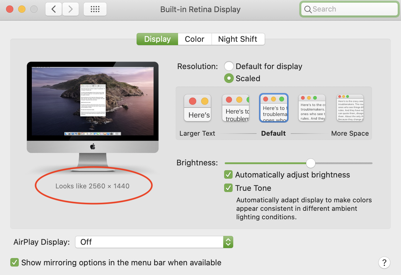

The default scaling for the 5K iMac is 2X. See screenshot below. This means it maps a traditional (non-retina) 2560x1440 desktop to a 5120x2880 resolution screen.
The tradeoff in using a different scale factor, is that everything looks bigger ("Larger Text"), or smaller ("More Space"). The default scaling is usually the best balance for most people.
There is no noticeable resolution loss by using a different scale factor, that I can see, although Apple says: "Select “Default for display” to automatically use the best resolution for the display" and "Using a scaled resolution may affect performance."

If you change the option to the "More Space" setting, then what does the "Looks Like" resolution then change to?
All the way to to the right on "More Space" says "looks like 3200 x 1800"
The five options are
1600x900 - scaled 3.2x
2048x1152 - scaled 2.5x
2560x1440 - scaled 2x (default)
2880x1620 - scaled 1.78x
3200x1800 - scaled 1.6x
None of them scale 1:1, if that is what you are wondering
