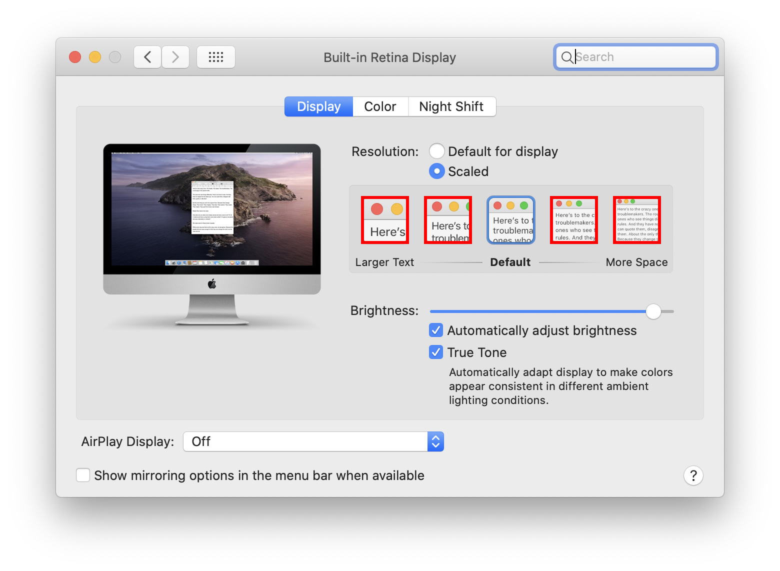

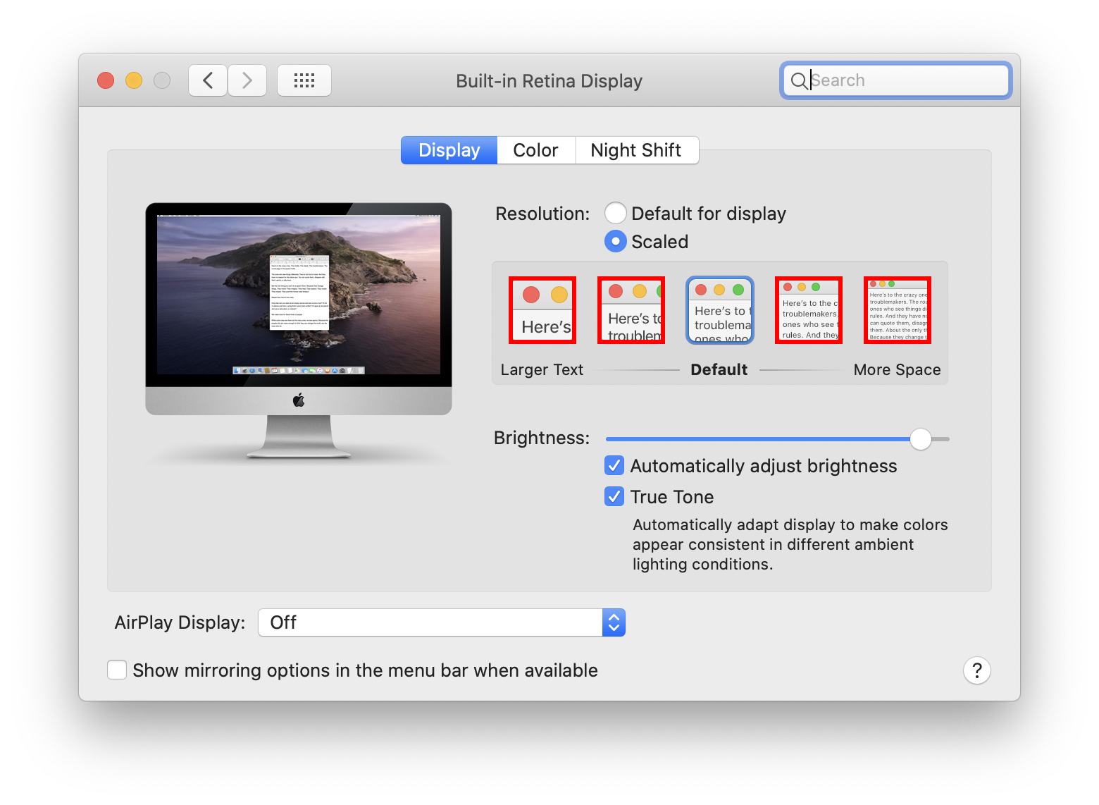

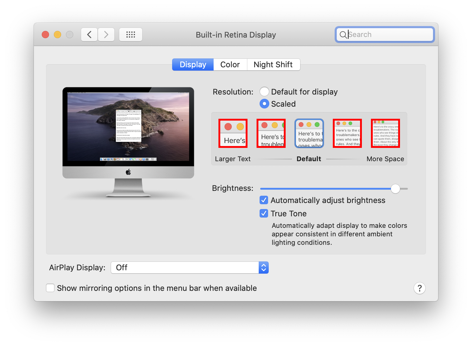

THIS IS THE FIX for now... implement this and the world can turn again... Switch to any scaled resolution other than default! Pick any one of the red boxes and get back to living again. How hard is this?
Does not fix the corners.

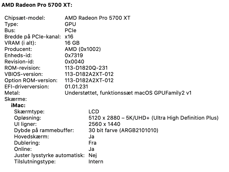

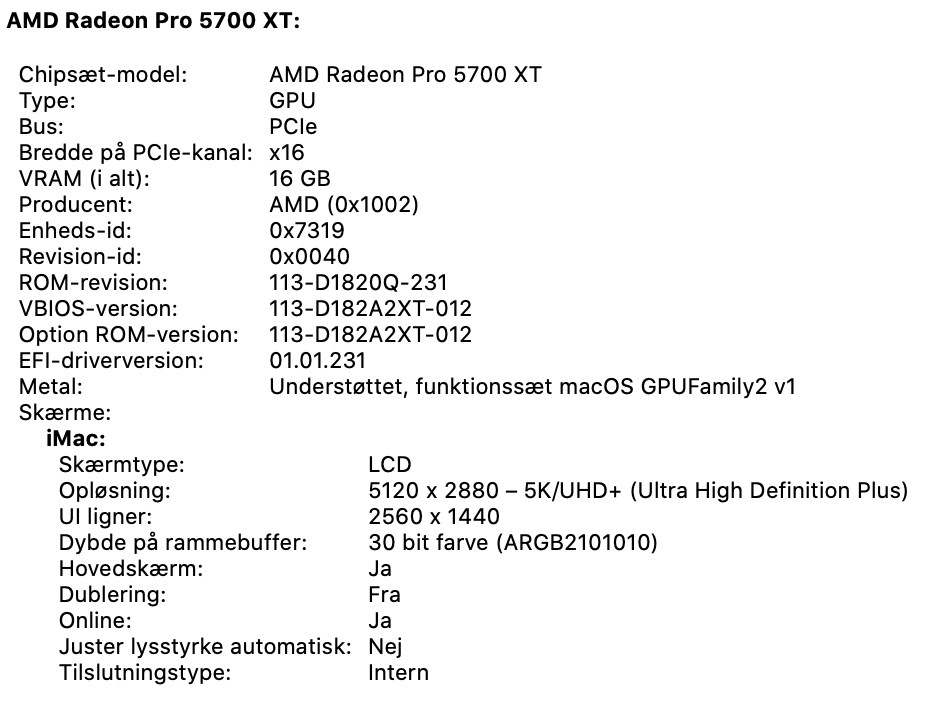

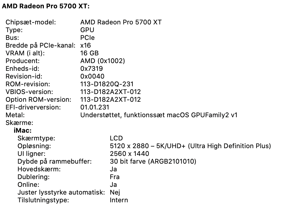

Received on Aug 27th. Here's the system report (and in danish - but I guess you can deduce what's what)
Reactions: kkh
...but why does it say 0.5x resolution in the "UI ligner:" line?
That's how retina screens work. While your maximum screen resolution is 5120 across, the UI itself is scaled up to render the same as it does on a 2560 screen. That way the UI components remain the same predictable size across various machines. You can change this with Scaling (or Skaleret). Most people leave it at default, afaik.
